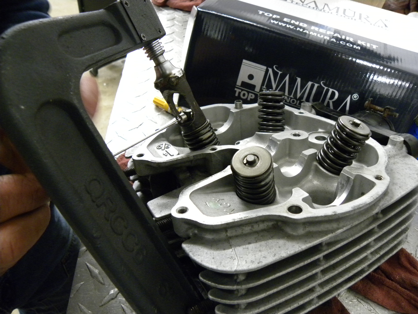

Recently we ran into a 2002 HONDA XR400R that we wanted to replace the seals on and didn't have a valve spring compressor.
So, Jason at Dirt Brothers showed us how to make one CHEAP!
Ingredients:

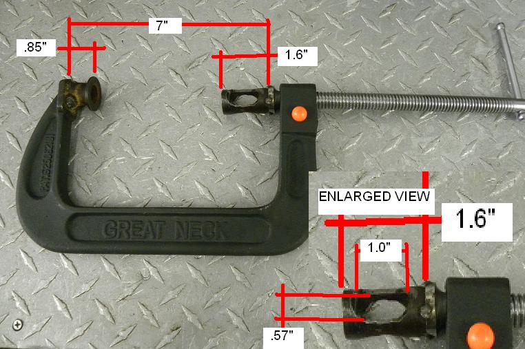

(1) Large C clamp, in this example we used a 7".
(2) swing arm bushings or some pipe .86" OD or there abouts.

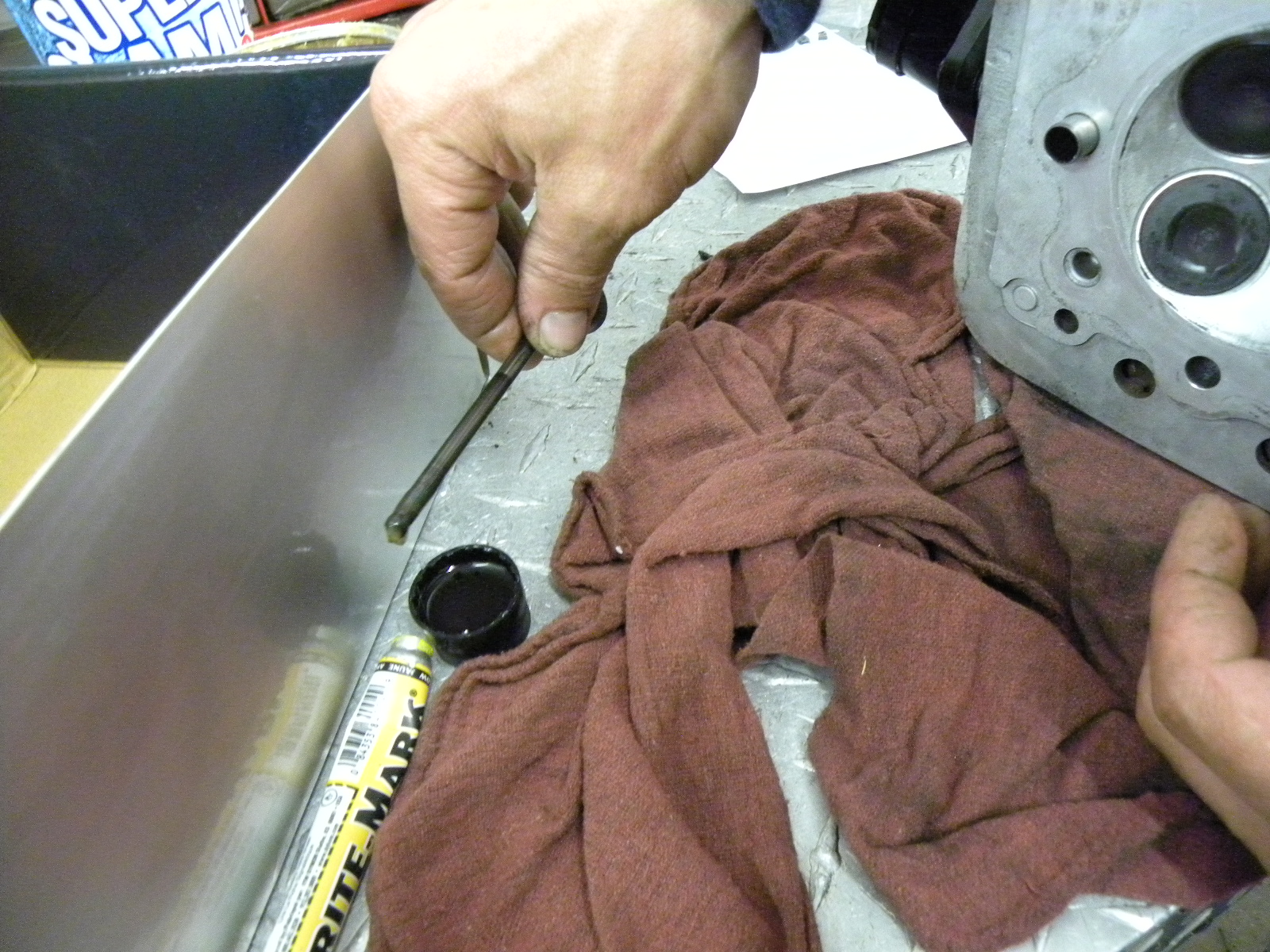

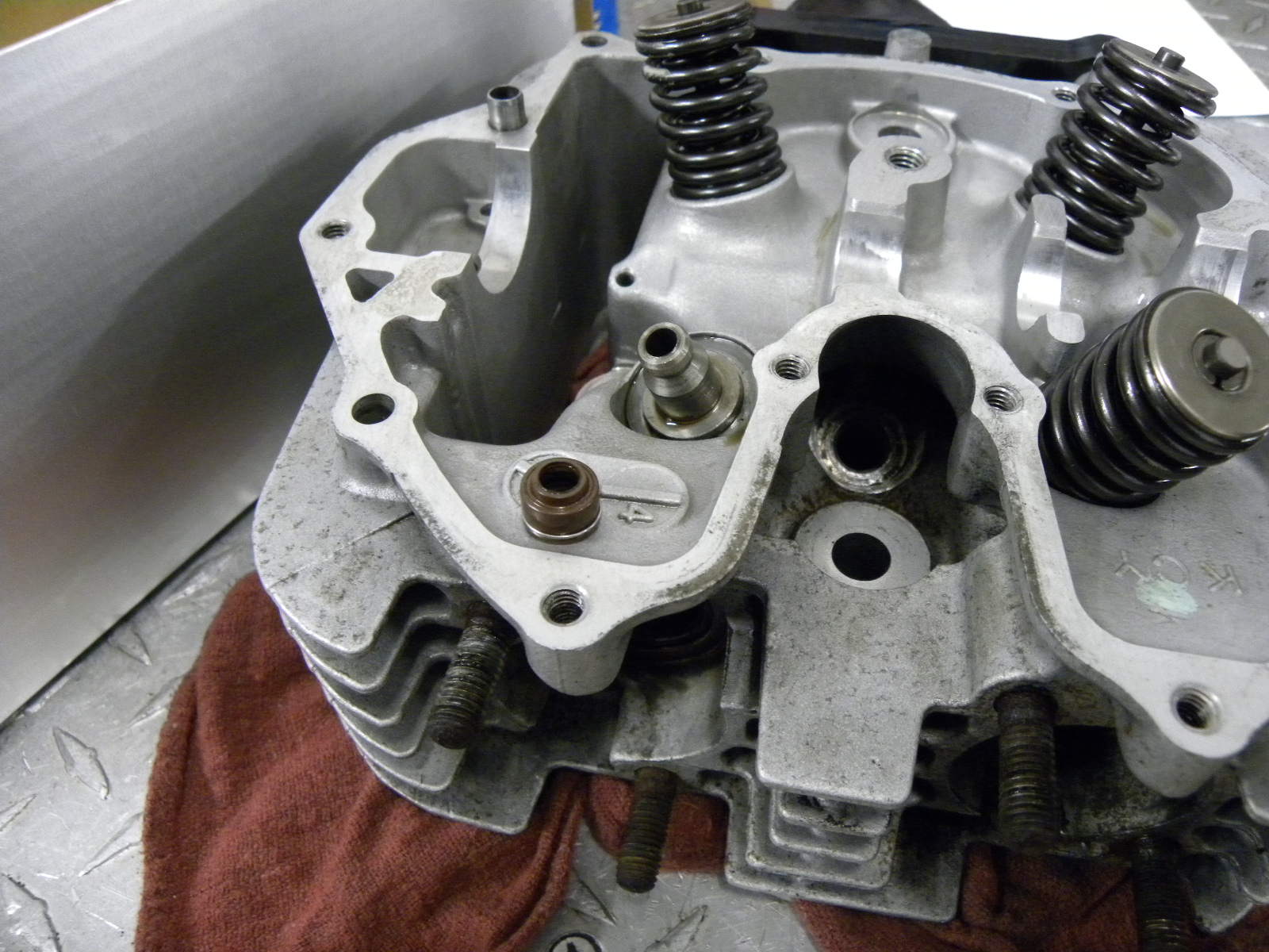

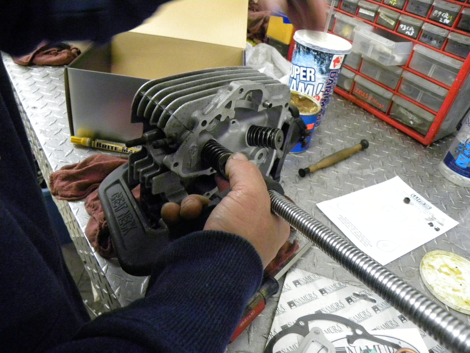

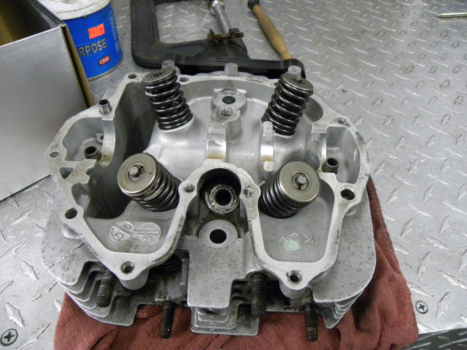

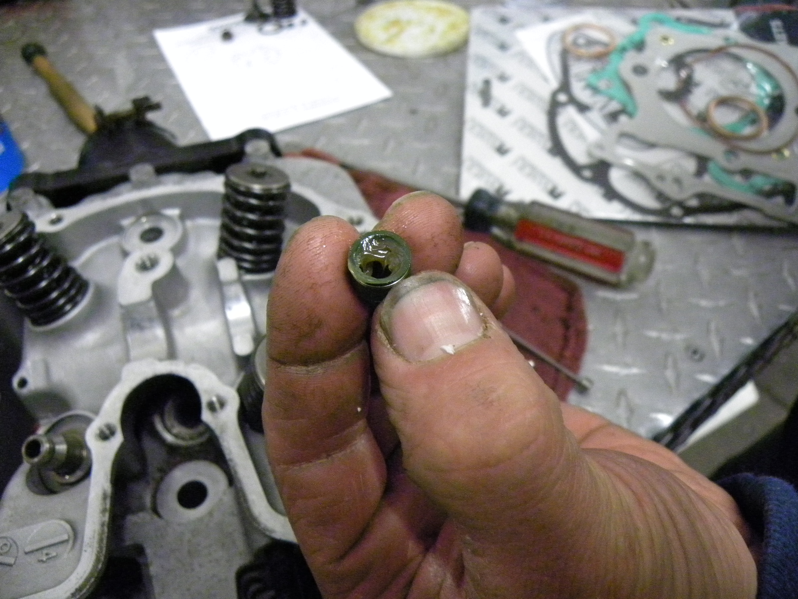

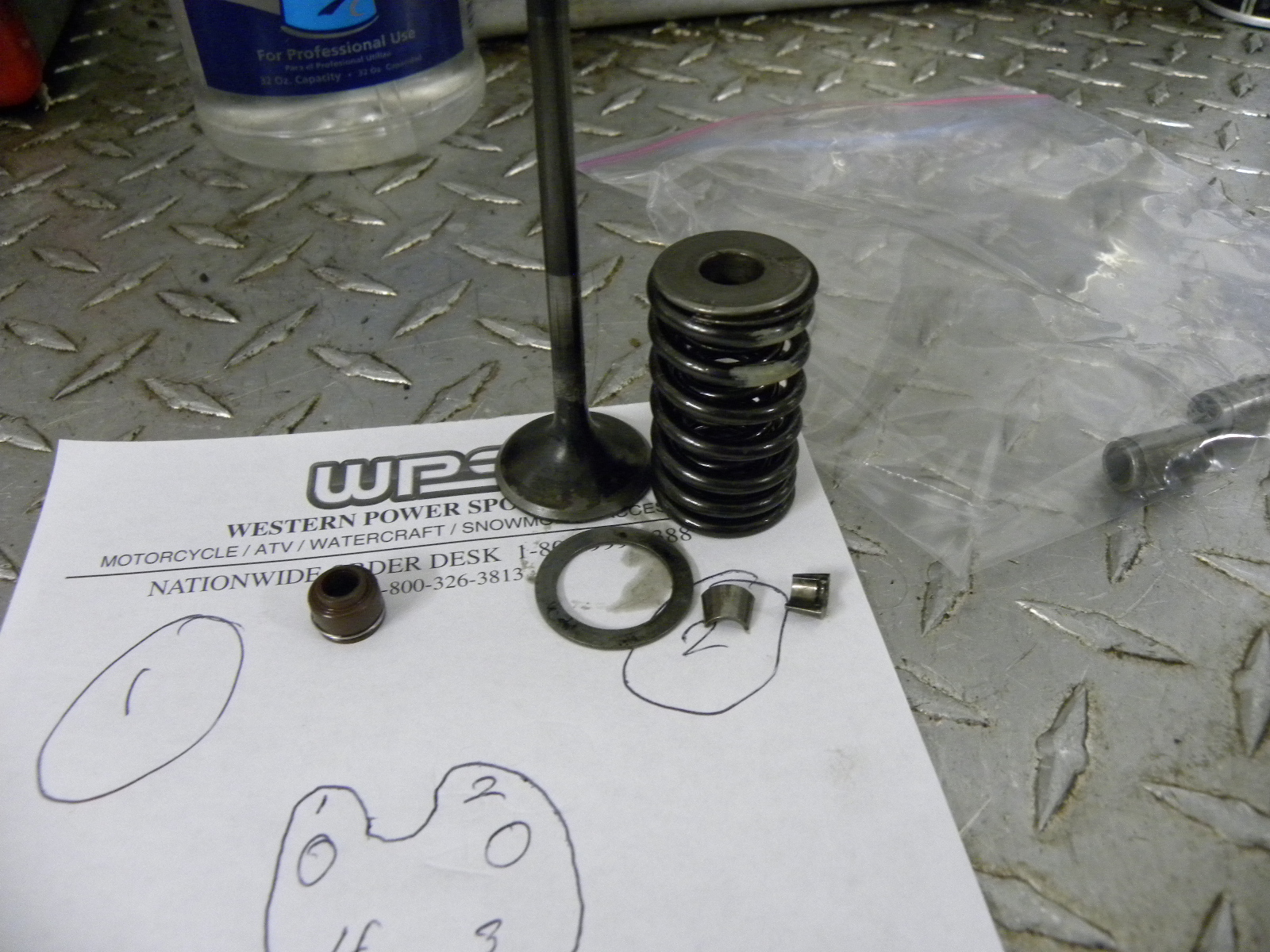

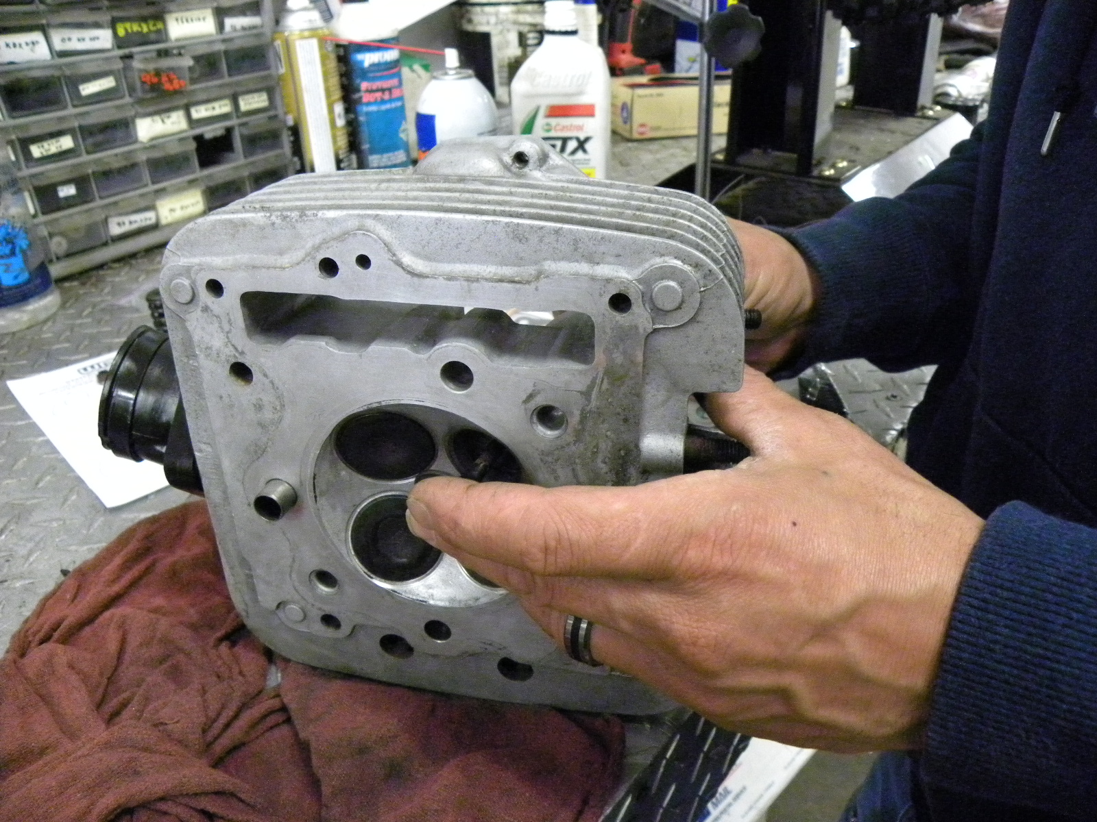

While we had the head apart we replaced the seals and tuned up the valve and seat faces.
This is not intended to show you how to rebuild a head, it is intended to show you how to make a valve spring compressor and save some bucks.

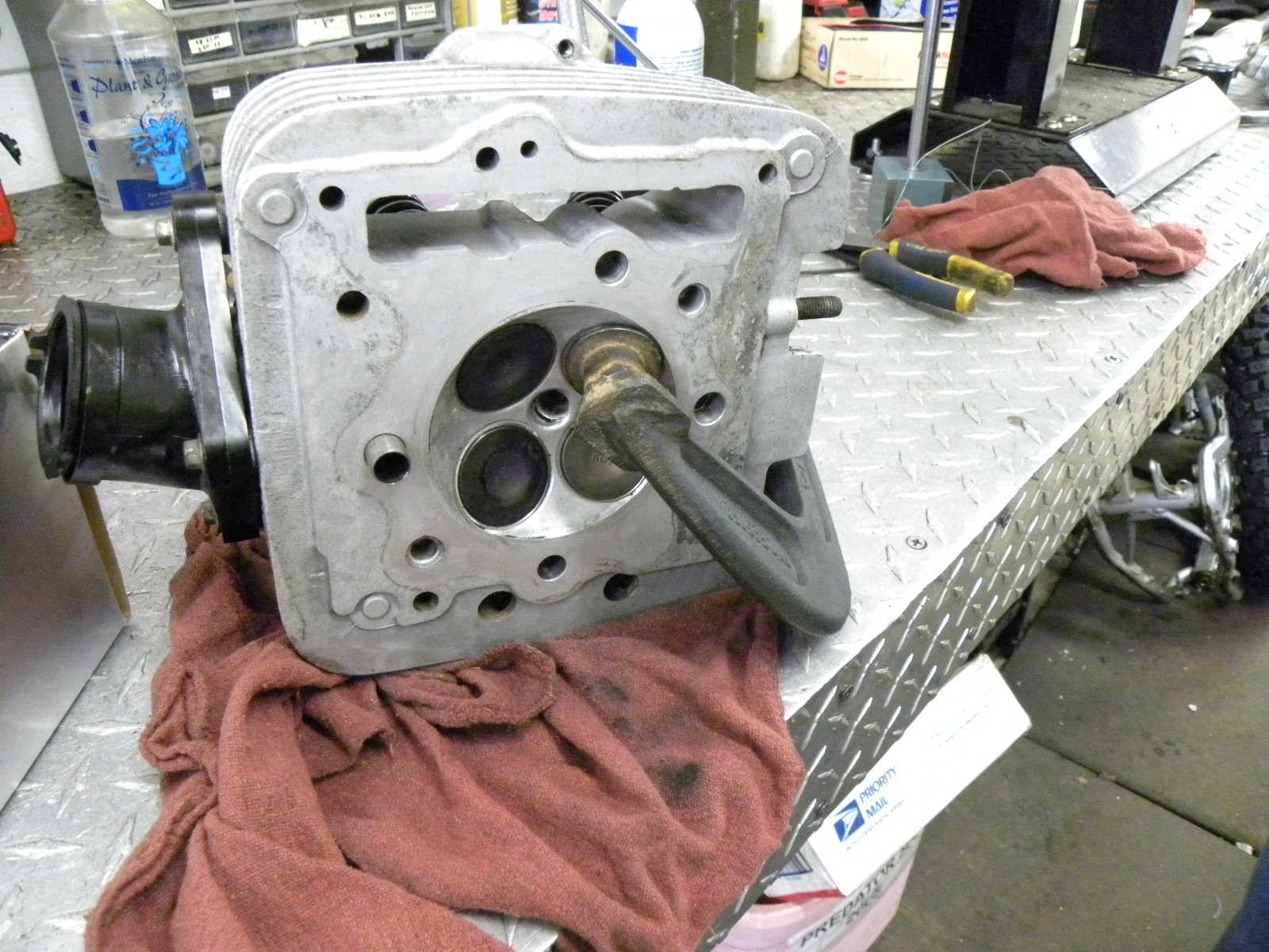

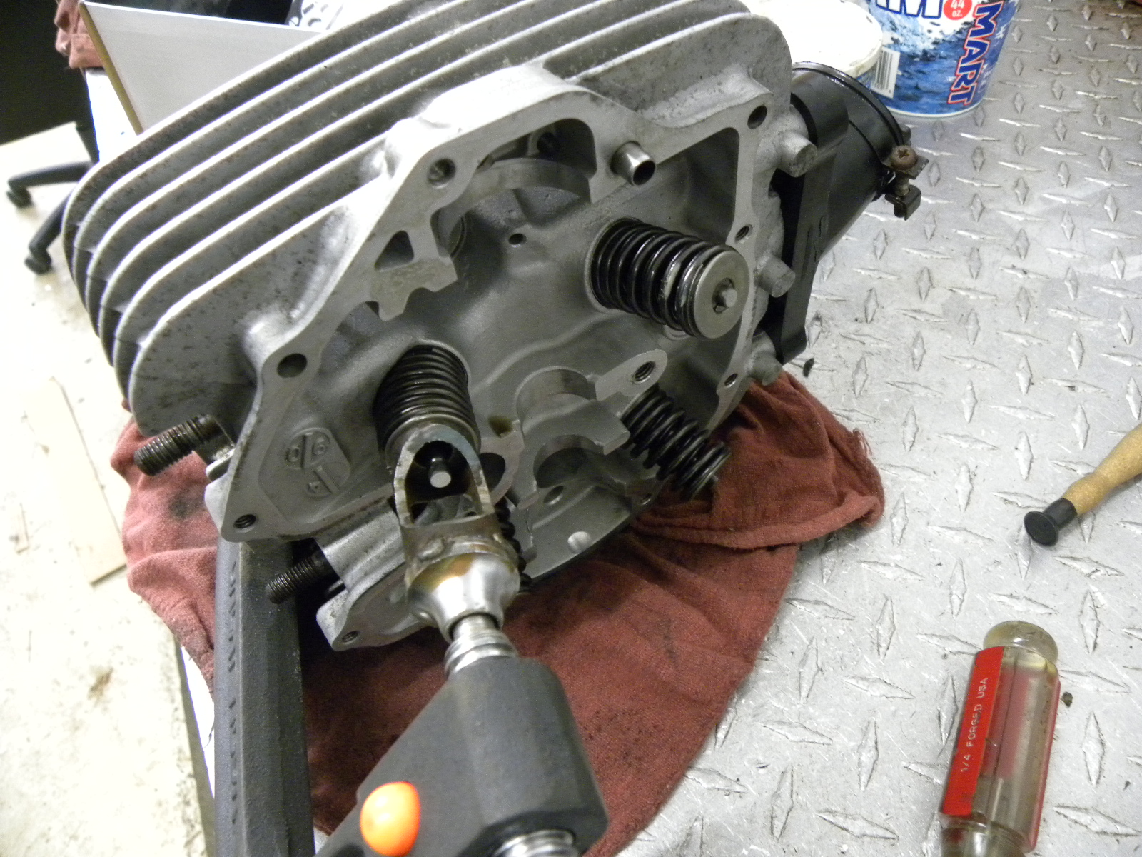

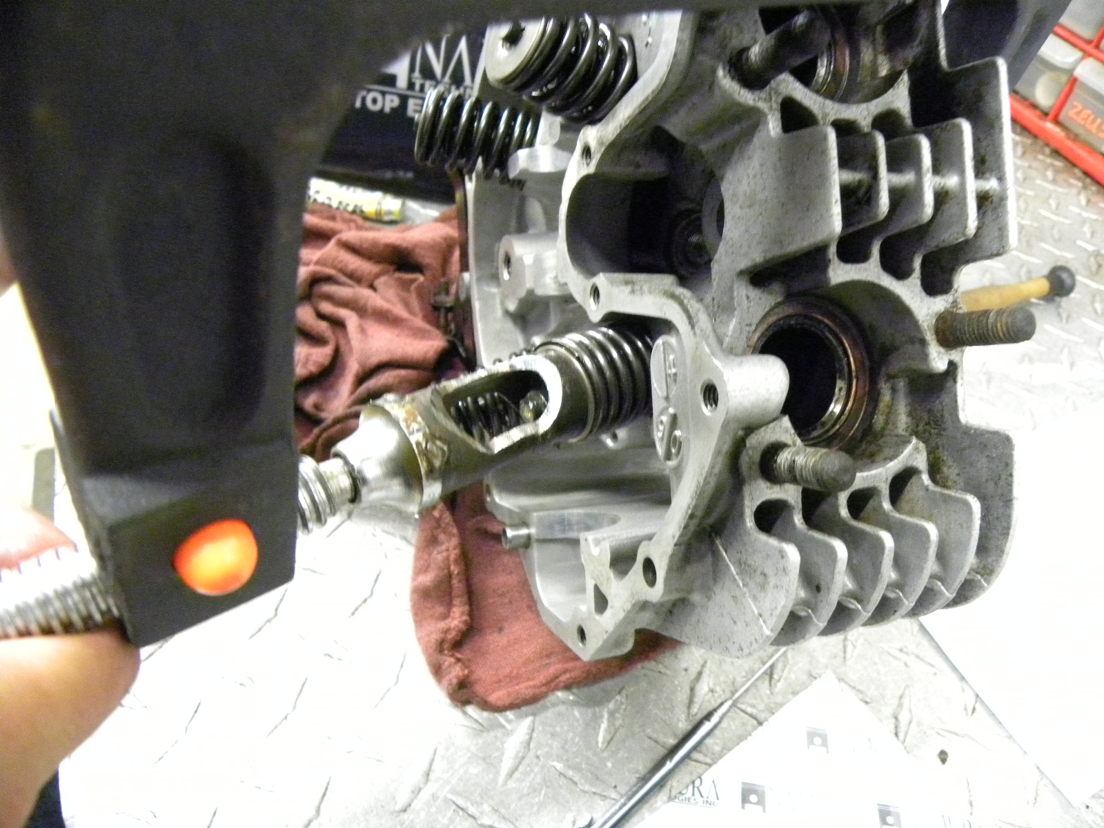

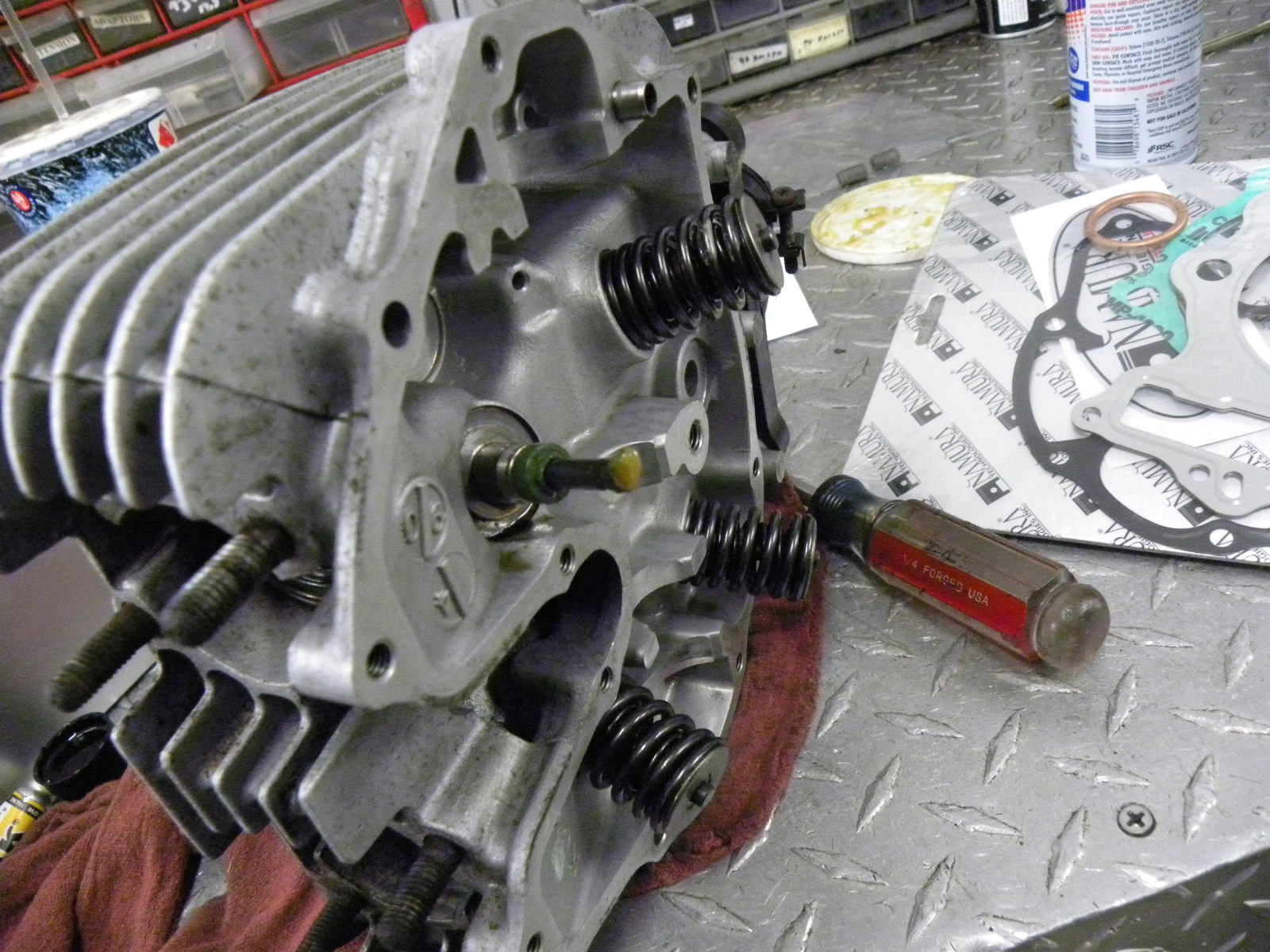

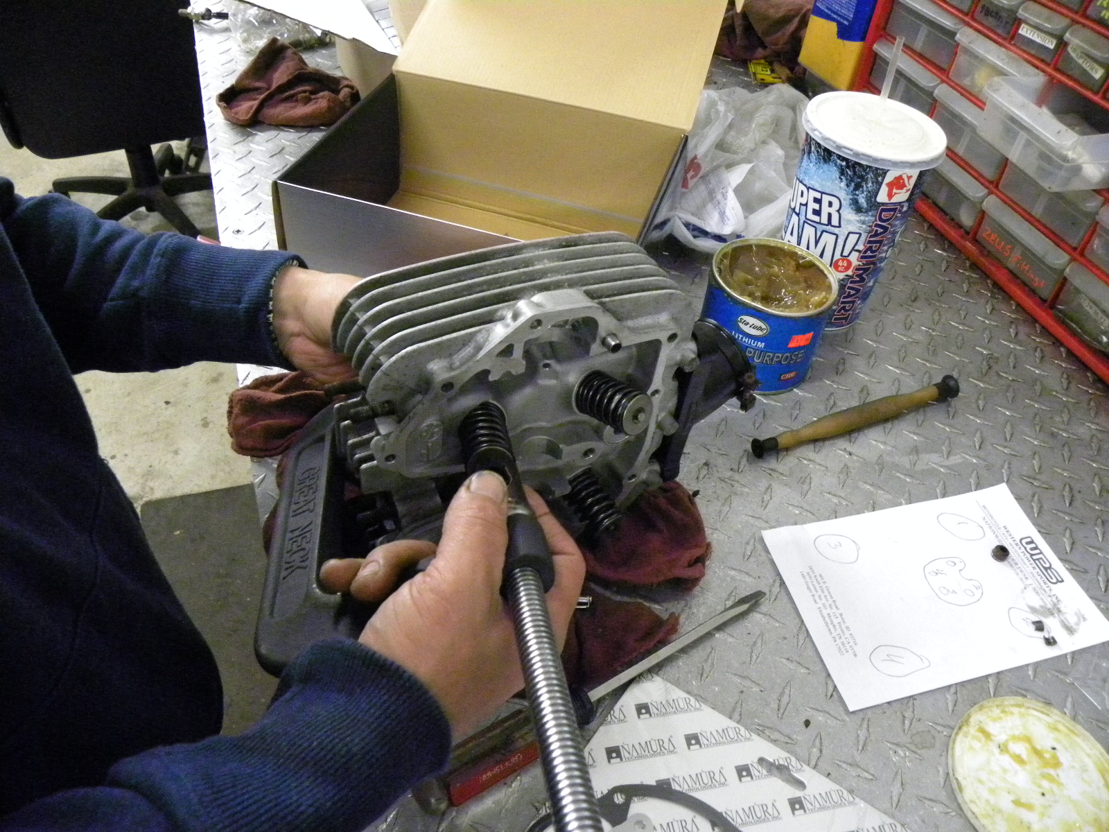

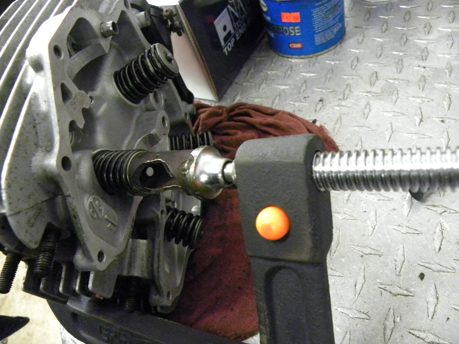

Here's some pics of how it works.
All done.
The tool worked perfect and we ended up with a really good running XR400.
