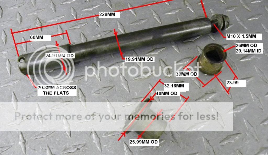

| 1999 | 250 CR | 86871 | CAGIVA HUSQVARNA 5A1 AX50217 – 86870 | ZCGCR2502XV06#### | MIKUNI TMX 38MM ID – 44MM OD – AIRBOX SIDE 57.5MM ID, 62MM OD – LENGTH 85MM | 1999 | 250 CR | CU1672 5F30 800072886 KOKUSAN DENKI | IG 3815 7L17 | FP8156 65787 | 908 - SCFMA 31 - 98 / 909 SCFMA 32 – 98 – CHROME OD 45MM – C/L 36.25” (921MM) – UPPER 53.9MM - LOWER 57.9MM - BRAKE MOUNT C/L TO C/L 60MM – AXLE MOUNTS 20MM & 25MM | 1999 | 250 CR | CLICK HERE FOR PICS AND MEASUREMENTS | HYDRAULIC | AXLE OD 20MM – BRG TO BRG 75.5MM – ROTOR OD 260MM, ID 120MM, BC 6 ON 135MM – 36 SPOKES | 1.6 X 21 TAKASAGO – 431 JAPAN 1098 | 1999 | 250 CR | CLICK HERE FOR MEASUREMENTS | AXLE OD 20MM – BRG TO BRG ? - ROTOR OD 220MM, ID 112MM, BC 6X ON 130MM – SPROCKET ID 136MM, BC 6X ON 156MM – 36 SPOKES | 19 X 2.15 TAKASAGO – 431 JAPAN 698 | 1999 | 250 CR | CLICK HERE FOR MEASUREMENTS | 1999 | 250 CR | ||

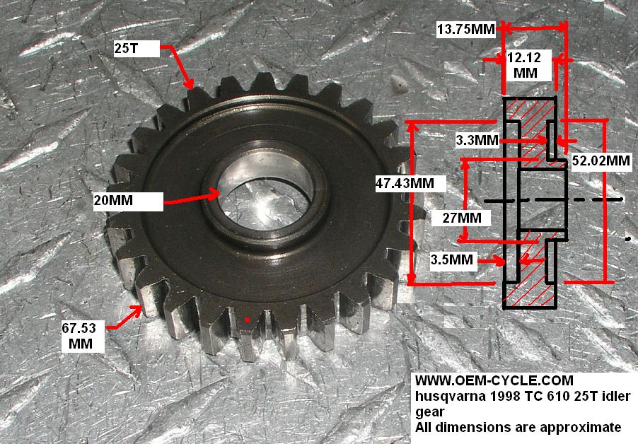

| 1998 | 610 TC | 1998 | 610 TC | A816 SCF MA12 9 & B815 SCF MA15 9 - 50MM CHROME OD - C/L 36 7/16" - BRAKE MOUNT C/L 60MM - AXLE CLAMP 20MM & 25MM | 1998 | 610 TC | HYDRAULIC | AXLE OD 20MM - OUTSIDE OF BRG TO OUT SIDE OF BRG 75.5MM - ROTOR OD 260MM ID 120MM - BOLT CIRCLE 6 ON 135MM – 36 SPOKES | 1998 | 610 TC | CLICK HERE FOR MEASUREMENTS | 1998 | 610 TC | 1998 | 610 TC | ||||||||||||||
