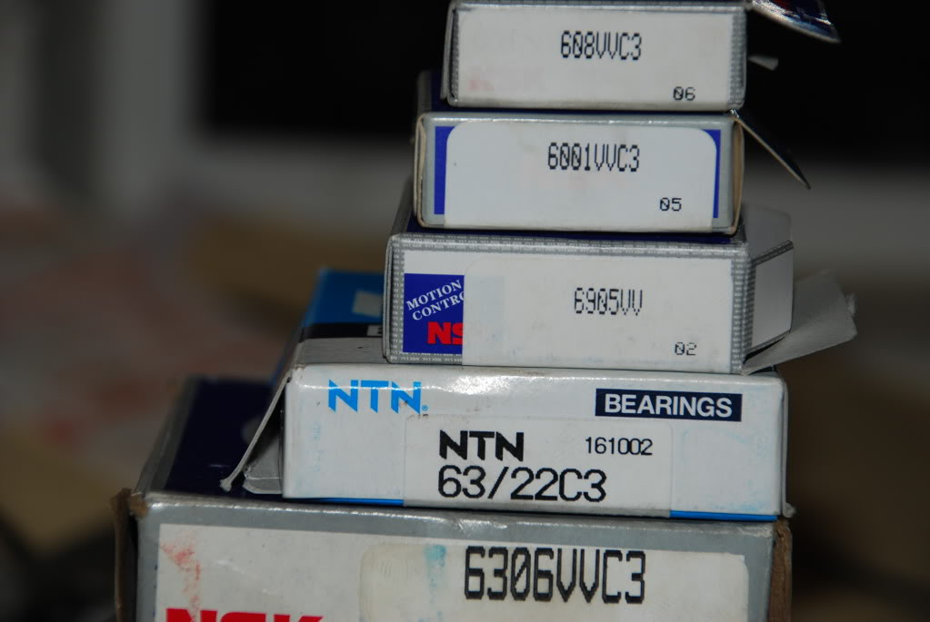

Okay here we go..
PAY CLOSE ATTENTION to what your bearing house trys to hand you.. I have to specifically ask for "the good stuff" or they will hand you a "made in korea, china, etc" garbage bearing.. Fine for most customers they get (electric motors).. but not me. USA made, Austria, etc for me only.... Ask the price differance between (rubber) sealed and non sealed bearings... somtimes the price differance is worth the added labor of removing seals and grease...
All numbers will swap between NTN, NSK, SKF..... ETC... timken runs differant numbers.. and all manufactures run differant seal coding so.. yea...
I will post the BEARING NUMBER only... NOT THE SEAL CODE .. as this is not neccisary.. (the VV part etc) But when you go to get your bearings.. you need all NON SEALED bearings, (or rubber sealed if you dont mind popping off the seals and cleaning out grease)..
You can get them in what ever "C" rating you want.. the C rating is the tolerance on the bearing... (for example the kips etc stock are C2).. I changed to C3 (looser, so it spins better)
After the part number etc, I will list a X# the # is how many you need for this section of the motor...
An example of the Bearing part number (so you can understand how to put all this together is)....
lets use the main bearings as an example...
My bearings are made by NSK.. the "Oficial part number) is 6306VVC3... to decode this... the 6306 is the bearing (size etc)... the VV is the seal code. (VV is doubble rubber seal) and the C3 is the tolerance spec.... (note on alot of C2 bearings. it wont bein the part number, as C2 is standard)
SO>.. going off this.. if you wanted a Main bearing that was NOT SEALED... and a C2 rating.. you would need a 6306 (yep thats it)... If you wanted a non sealed, C3 rated bearing.. ti would be a 6306C3 (somtimes listed as 6306/c3) all depends on bearing manufacture...
Hope this helps..
Main bearings.
(NSK) 6306 ( Not sure what OEM rating is, but I run C3 rated) X2
KIPS bearings
(NSK) 608 (Stock is a C2 rating, I run C3) X2
Water Pump
Clutch Pressure plate
(NSK) 6001 (Stock is a C2, I run C3) X1
Shift Drum bearing
(NSK) 6905 (stock is a C2 I run a C3) X1
Transmission LEFT CASE
(NSK) 6305 (I run a C3, OEM is C2) (replaces OEM part number 92045-1011) X1
(OEM) This is the bearing My bearing house cant get.. so OEM it is 92045-0013 X1
Transmission RIGHT CASE
(NTN) 63/22 (I run a C3, OEM is C2) (Replaces OEM part number 92045-1134) X1
(special note on this bearing... ALOT of the ones out there now have a Plastic cage... Request a metal one, and CHECK IT before you leave
I Just dont trust plastic cages in transmissions....)
