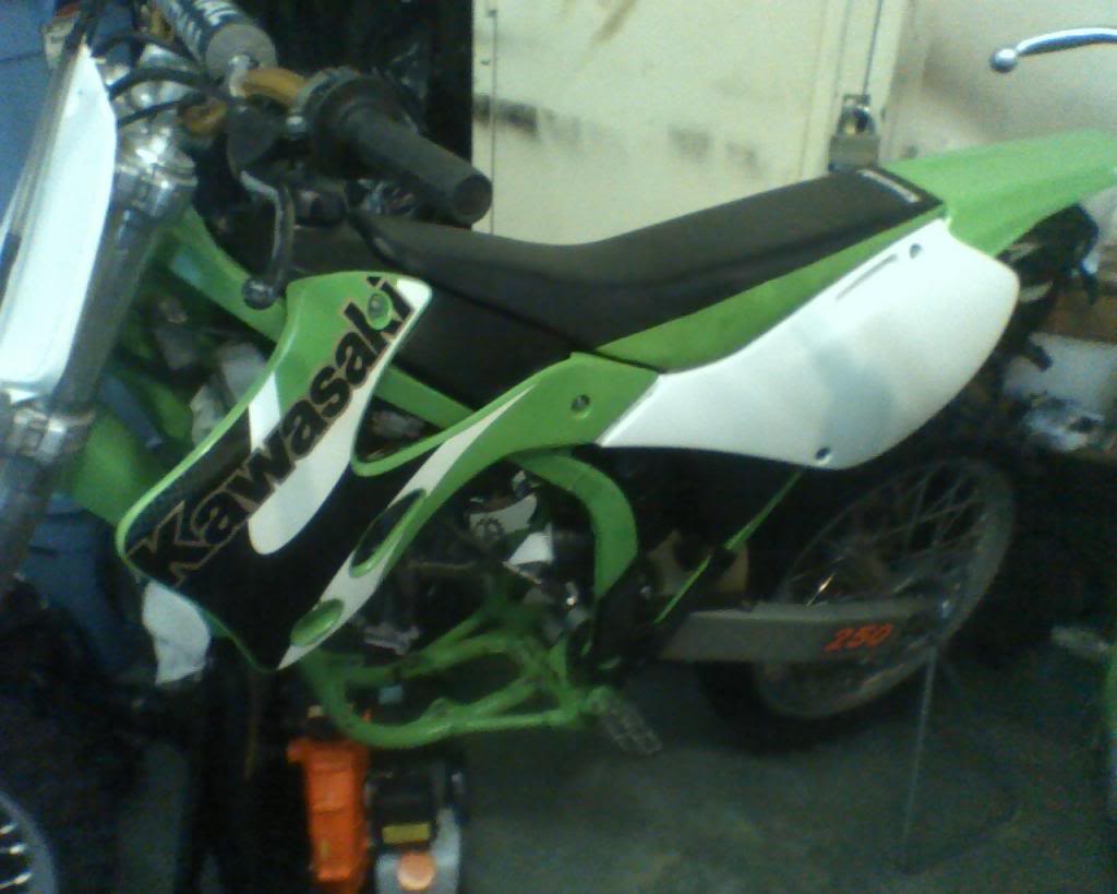

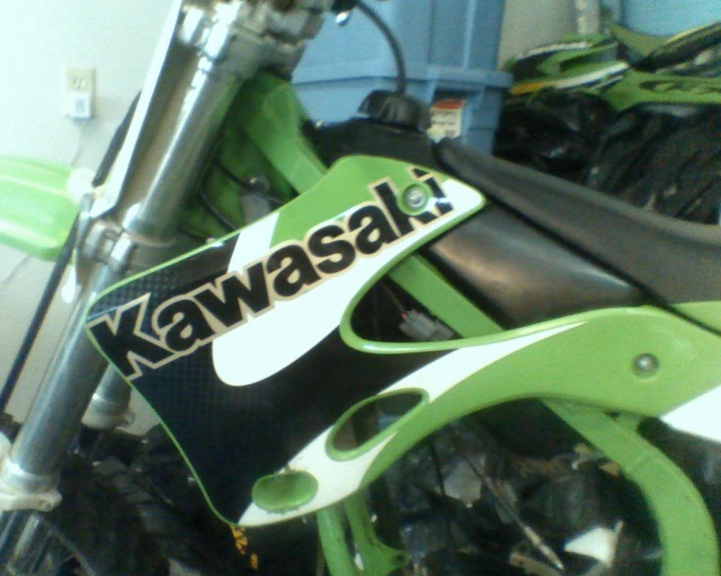

I got rid of those horrible One Industries graphics and seat,and got some OEM stuff to throw on.I even found brand new OEM 2000 shroud graphics to make that part of it "correct".
It's got 01 graphics on it now...and they may be for sale once it's done.

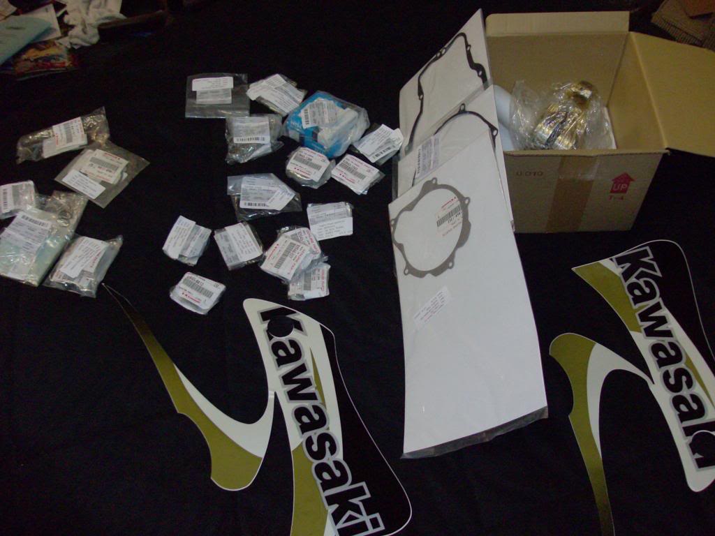

I've got every OEM bearing and seal,and brand new OEM crank,OEM gaskets,new OEM clutch plates,new kick shaft because the kid snapped the other one off flush with the case trying to kick it while it was siezed angry.This completes the bottom....for now.

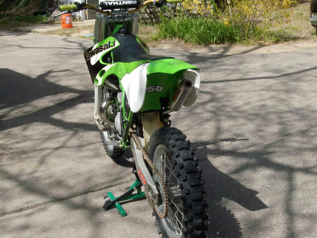

Alright,it's done,with the new plastics and correct graphics...sure,I could keep on spending just like any one of us could on things that I don't really need,(and I probably will here and there)...I ended up at just about $2900,and that includes the $200 I paid for it.I replaced EVERY single bearing/collar/sleeve through-out the chassis/suspension with all OEM stuff...it's very plush,even with my 215lb ass on board.I can see a 500 going in this chassis at some point....I love how it feels/handles.

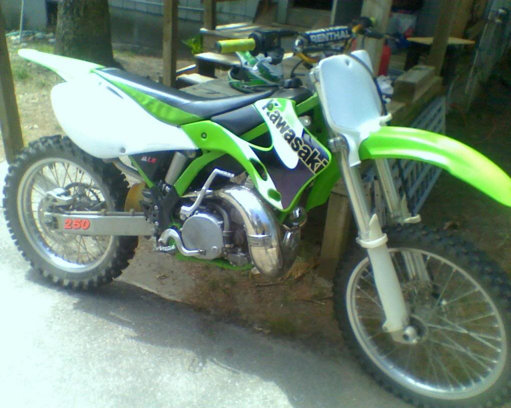

The goal was to make it look the same as the K5...it's close.

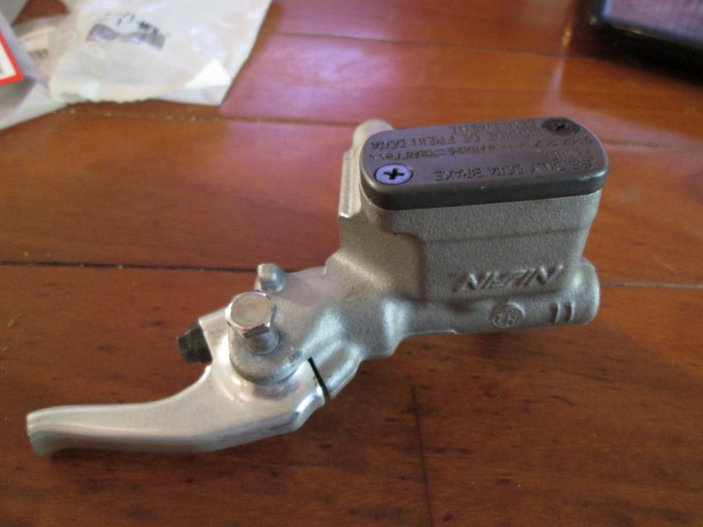

been almost 30 years since I bought red bike stuff...that was for my 83 CR125 back in '86.
just picked up this '12 CRF450 master for $40, and spent another $55 for a lever, rubber boot, banjo bolt and washers, for my 250.

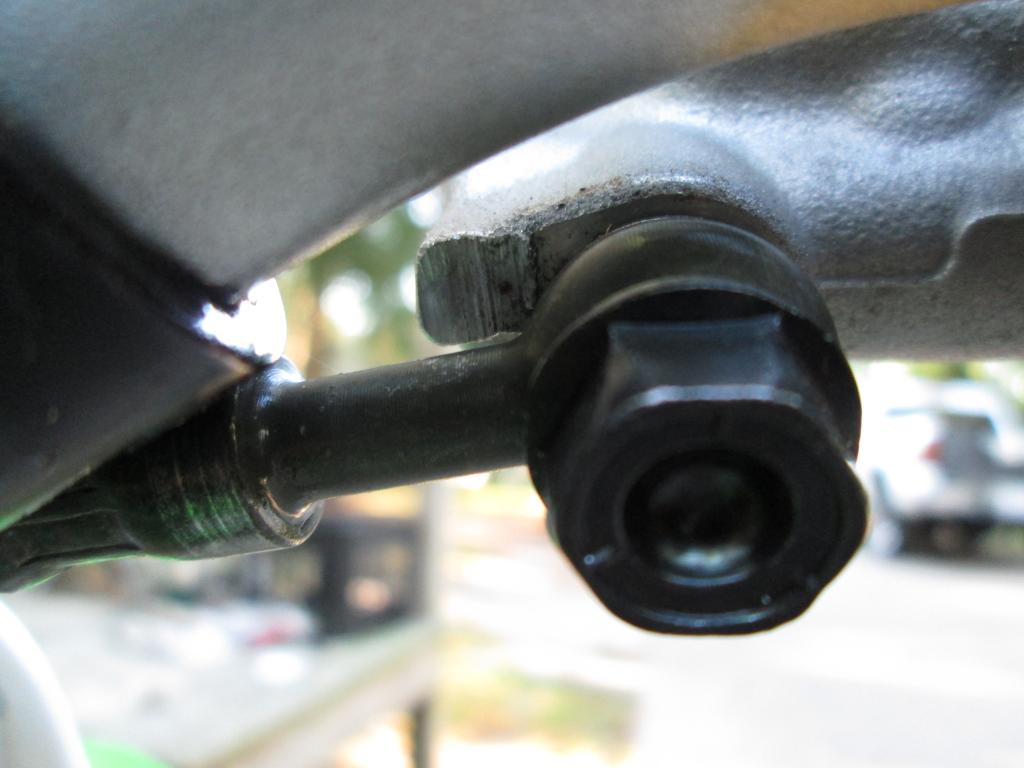

I don't know what I was thinking...or not thinking undecided....I should've done the Honda master update a year and a half ago on the 250...amazing how "touchy" it is now....exactly how I like it.
A very well spent $95!!
I did have to shave the guard off for the hose/banjo bolt location...I could've kept it on there, but it would've caused me to have to put a touch too much stress on the hose and threads for the banjo, which I don't want to put any stress on either one...so I slowly ground it off on the bench grinder...
this was removed...
