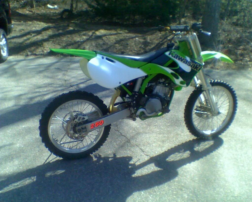

Well I guess it's time for a quick update on the Next Project.After getting the motor split apart,luckily everything was accounted for and no chunks of anything floating around....just the usual aluminum clutch plate debris.The big end bearing on the crank was ABSOLUTELY SMOKED!!....how this thing did'nt grenade and blow itself to smitherines,or at the very least, vibrate itself into a bare frame,is nothing short of a miracle. The kid admitted he had no idea how to mix the fuel....so you can just imagine there were probably times that it was 150:1...and judging by the amount of black spooge the packing in the silencer had in it...it was probably run at 5:1 at times angry.I got the cylinder sent off to Power Seal today.I'm guessing they'll have to go one,maybe two sizes bigger to clean up the scores in the walls....we'll see.
I got rid of those horrible One Industries graphics and seat,and got some OEM stuff to throw on.I even found brand new OEM 2000 shroud graphics to make that part of it "correct".
It's got 01 graphics on it now...and they may be for sale once it's done.
I've got every OEM bearing and seal,and brand new OEM crank,OEM gaskets,new OEM clutch plates,new kick shaft because the kid snapped the other one off flush with the case trying to kick it while it was siezed angry.This completes the bottom....for now.

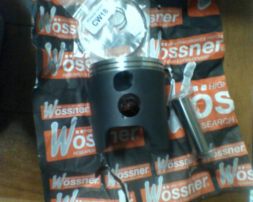

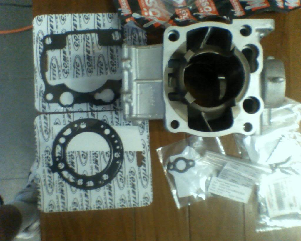

Got all the top-end parts last week,cylinder back from Power Seal with a nice shiny Wossner,Cometic head and base gasket,all other gaskets OEM.
Once I get the motor back together,I'll be pullin off the forks and shock and sending them up to Factory Connection for a complete rebuild/revalve...and then replacing every bearing through-out the whole chassis and wheels.A long ways to go still,but I should have it done by the begining of April.

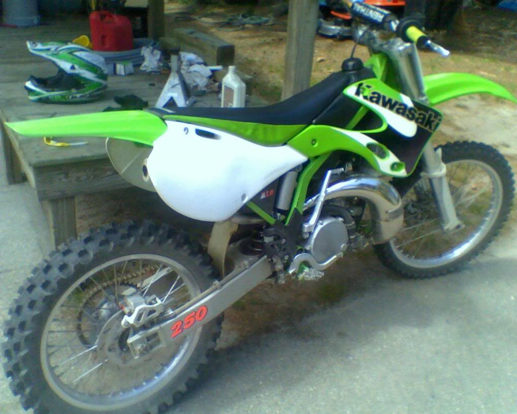

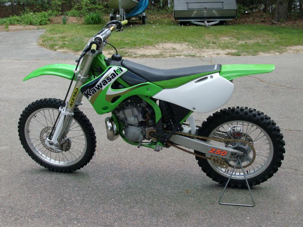

Well it's pretty much finished.Got it running last weekend after finding out my carb was'nt set up correctly.Once that was solved,it starts 1st kick cold or hot.I finished running the 1st tank through it this morning.
I still have a few minor cosmetic things I want to do it (like put on the 2000 graphics and some new plastics,etc,etc).I did'nt need to send out the suspension,surprisingly it works awesome,once I set the preload and played with the clickers,and put in all brand new linkage/swingarm bearings/sleeves....so there's a few hundred saved grin.
The thing rips!...compared to my 04 KX250...this thing puts it to shame!.I'm guessing it's because I had a Wiseco in my 04,and in this one I'm running the light-weight Wossner...allowing it to rev much quicker...just a guess huh.Right from the crack of the throttle til I hit 5th,it pulls hard,once it goes in 5th,it flattens out a bit,but unless I'm at Southwick,I don't have any tracks around here that'll need a wide open 5th gear.

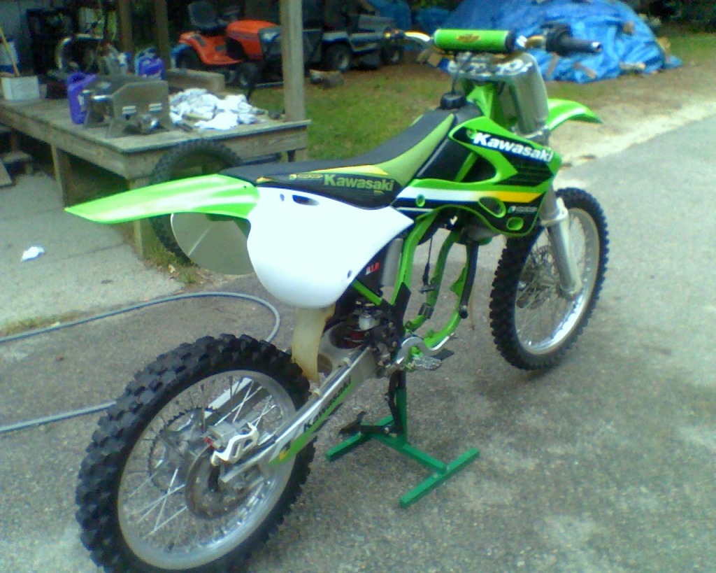

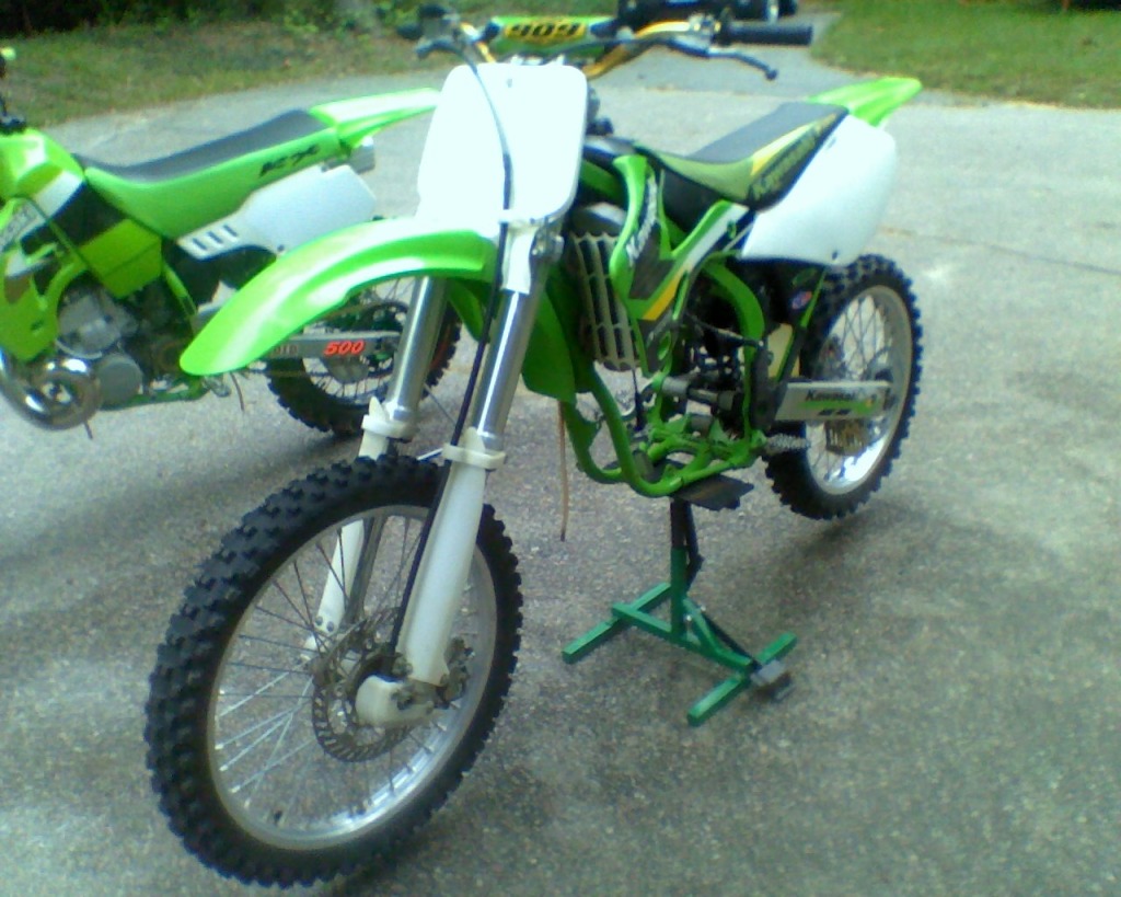

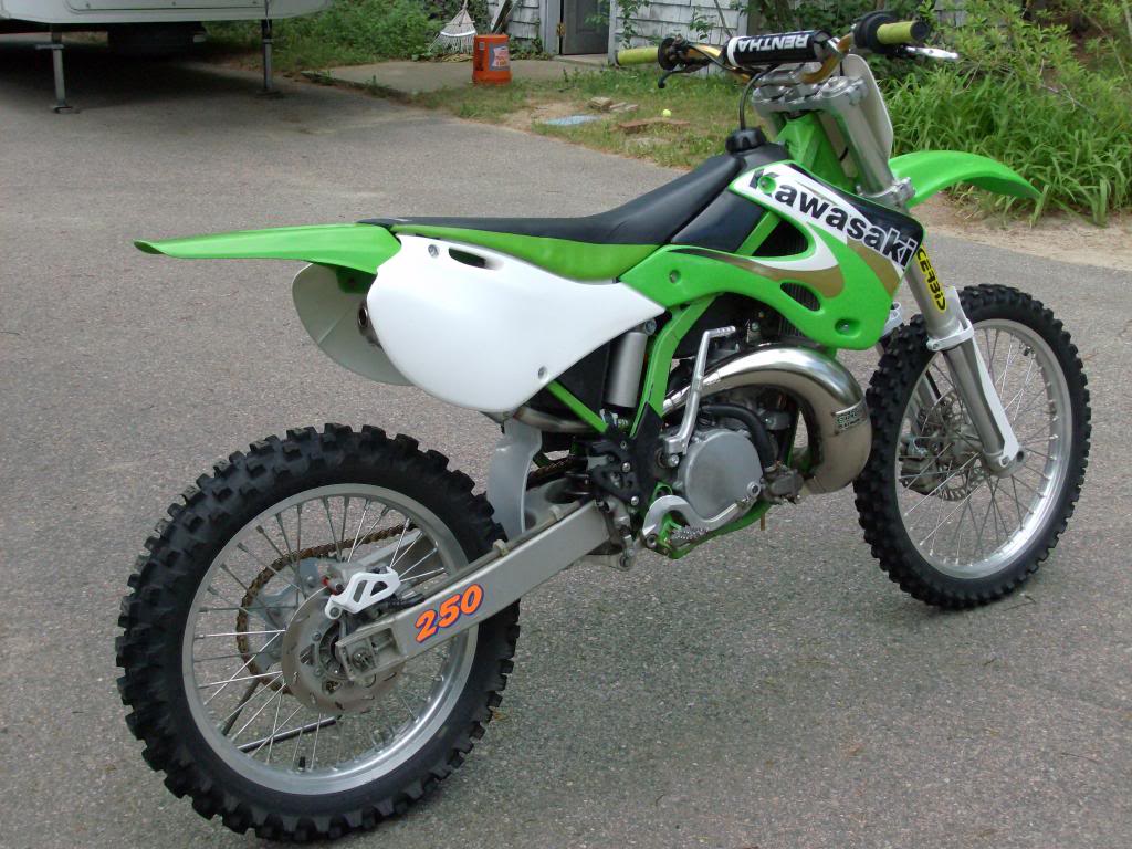

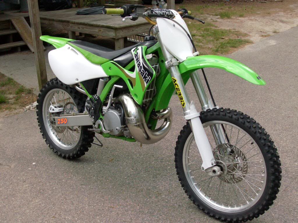

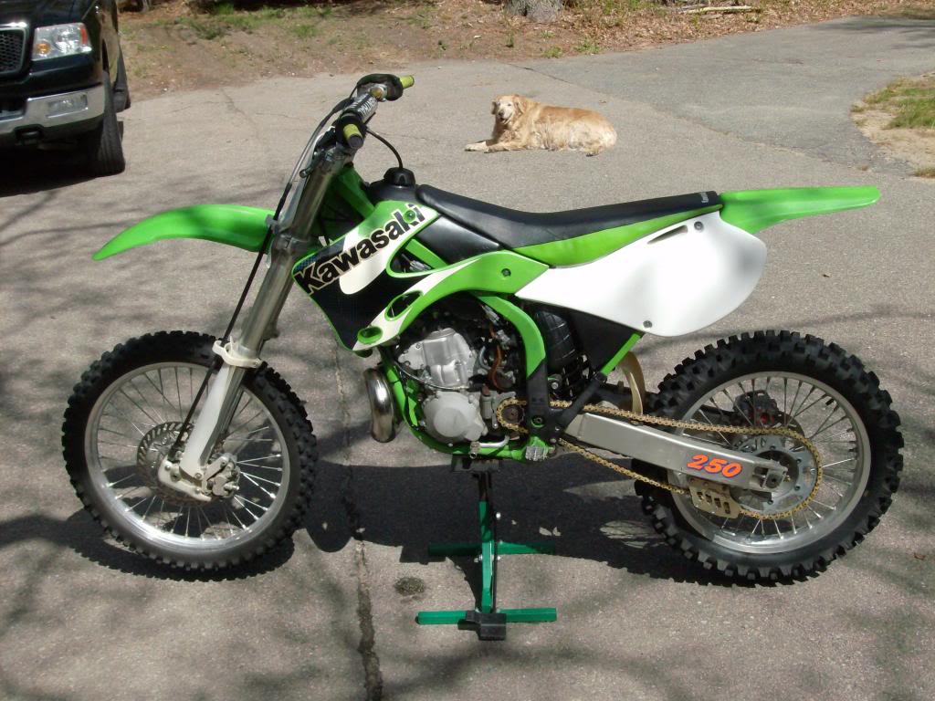

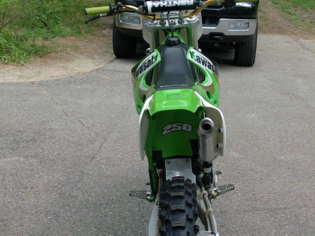

Alright,it's done,with the new plastics and correct graphics...sure,I could keep on spending just like any one of us could on things that I don't really need,(and I probably will here and there)...I ended up at just about $2900,and that includes the $200 I paid for it.I replaced EVERY single bearing/collar/sleeve through-out the chassis/suspension with all OEM stuff...it's very plush,even with my 215lb ass on board.I can see a 500 going in this chassis at some point....I love how it feels/handles.
Re: Foxx4Beaver 2000 kx250 build

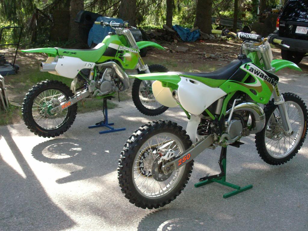

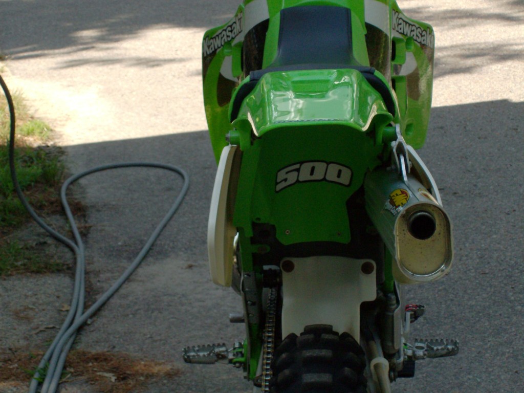

The goal was to make it look the same as the K5...it's close.

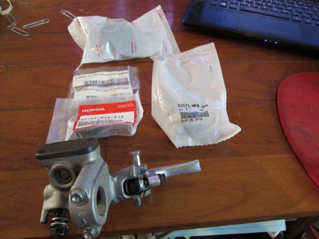

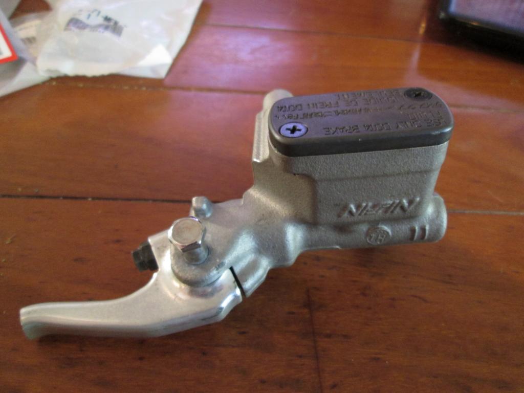

just picked up this '12 CRF450 master for $40, and spent another $55 for a lever, rubber boot, banjo bolt and washers, for my 250.

I don't know what I was thinking...or not thinking undecided....I should've done the Honda master update a year and a half ago on the 250...amazing how "touchy" it is now....exactly how I like it.
A very well spent $95!!

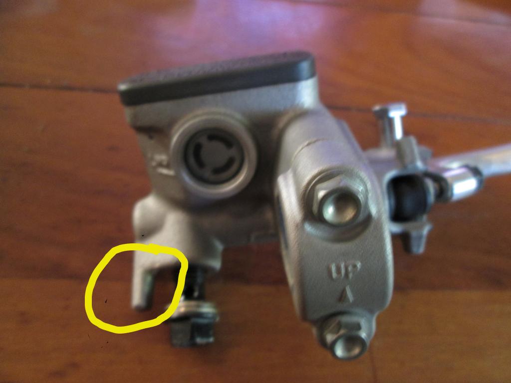

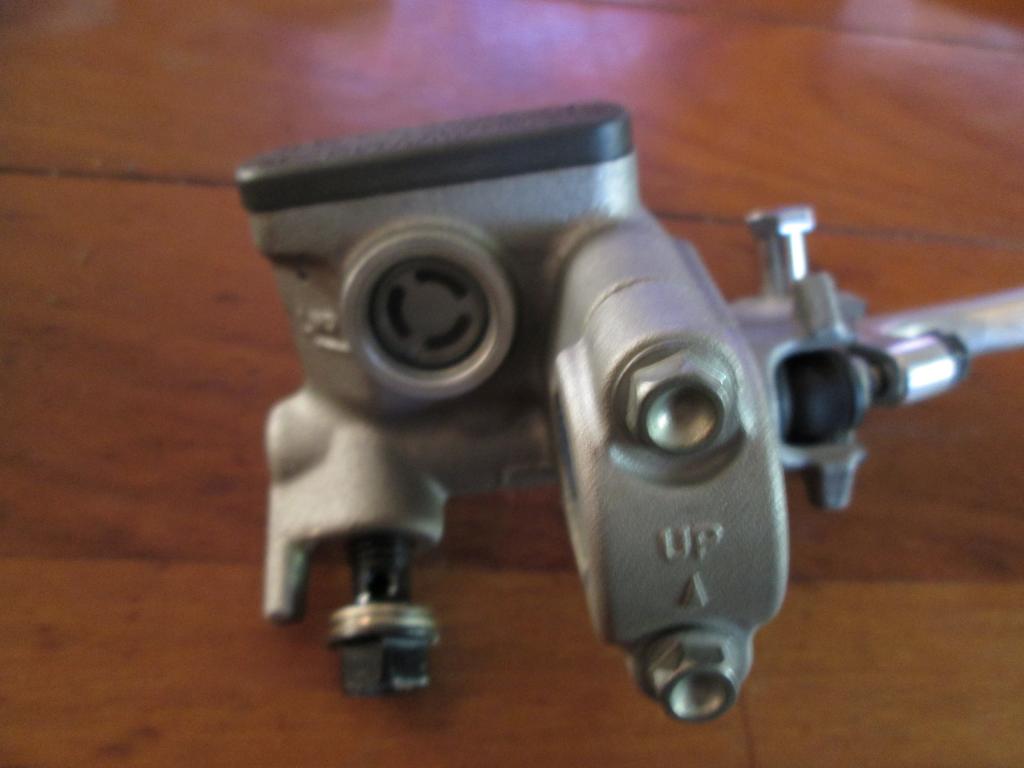

I did have to shave the guard off for the hose/banjo bolt location...I could've kept it on there, but it would've caused me to have to put a touch too much stress on the hose and threads for the banjo, which I don't want to put any stress on either one...so I slowly ground it off on the bench grinder...
this was removed...
