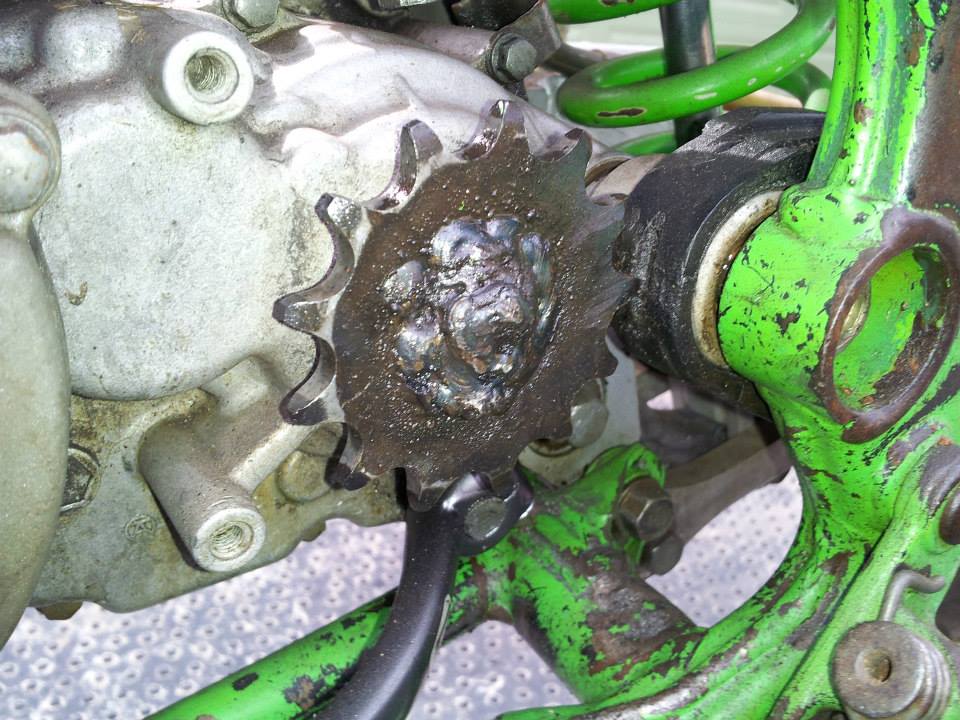

Check out that sprocket!
queen of spodes 89 kx125 1-5.jpg (114.38 KiB) Viewed 10314 times

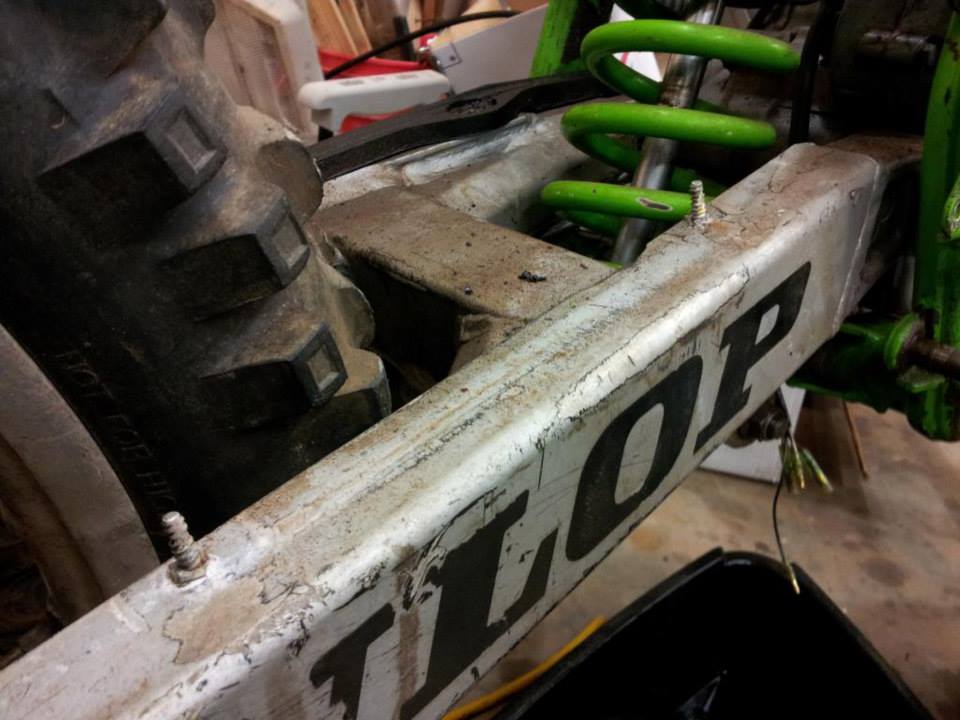

swingarm was dirty but serviceable
queen of spodes 89 kx125 1-7.jpg (71.53 KiB) Viewed 10314 times

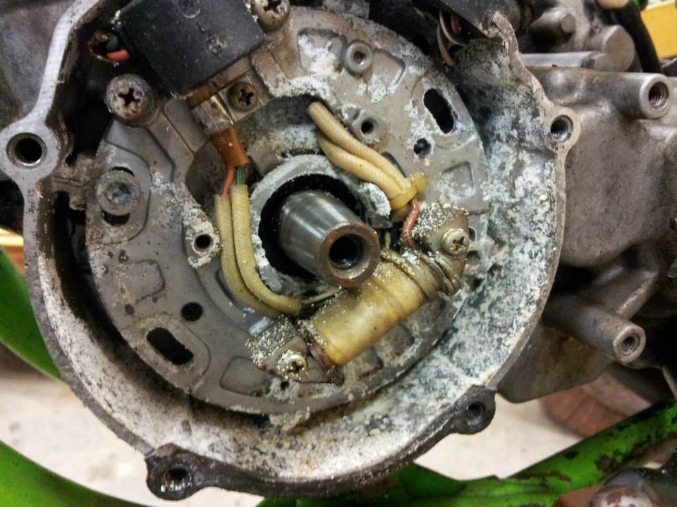

lots of corrosion here, but the bike put out a nice fat blue spark
queen of spodes 89 kx125 2-2.jpg (95.15 KiB) Viewed 10314 times

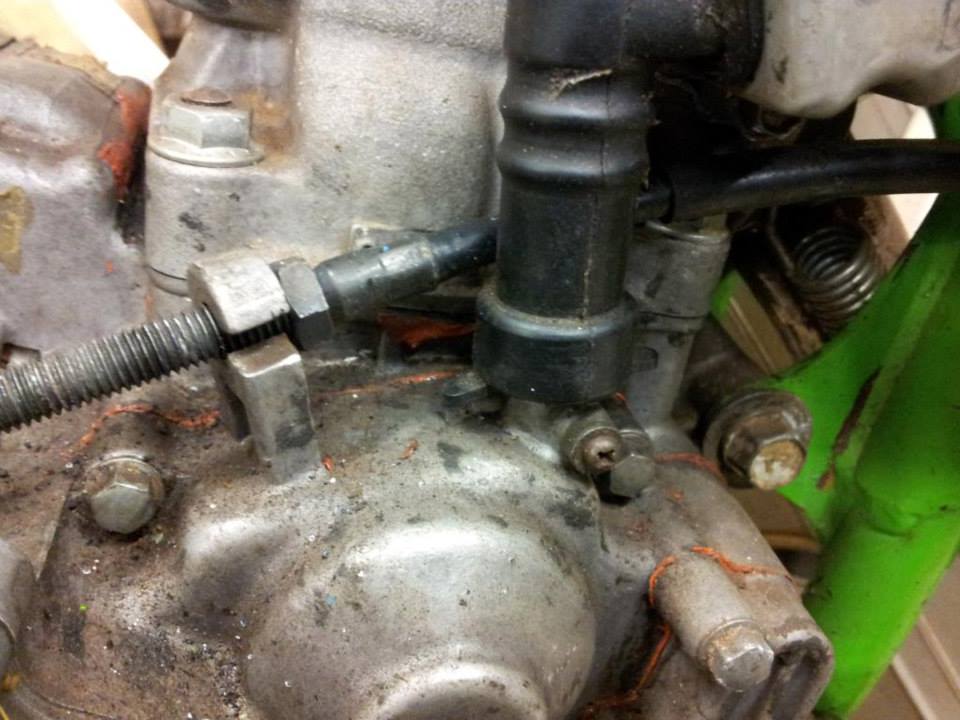

orange RTV, tell tale signs of shade tree mechanic
queen of spodes 89 kx125 2-3.jpg (77.55 KiB) Viewed 10314 times

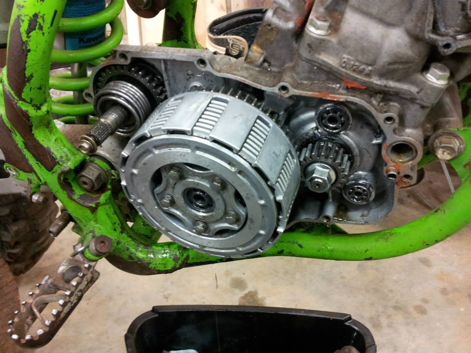

clutch pack looked pretty good considering the outside of the engine and frame
queen of spodes 89 kx125 2-4.jpg (93.73 KiB) Viewed 10314 times

had to grind down the sprocket welding to get the cases apart

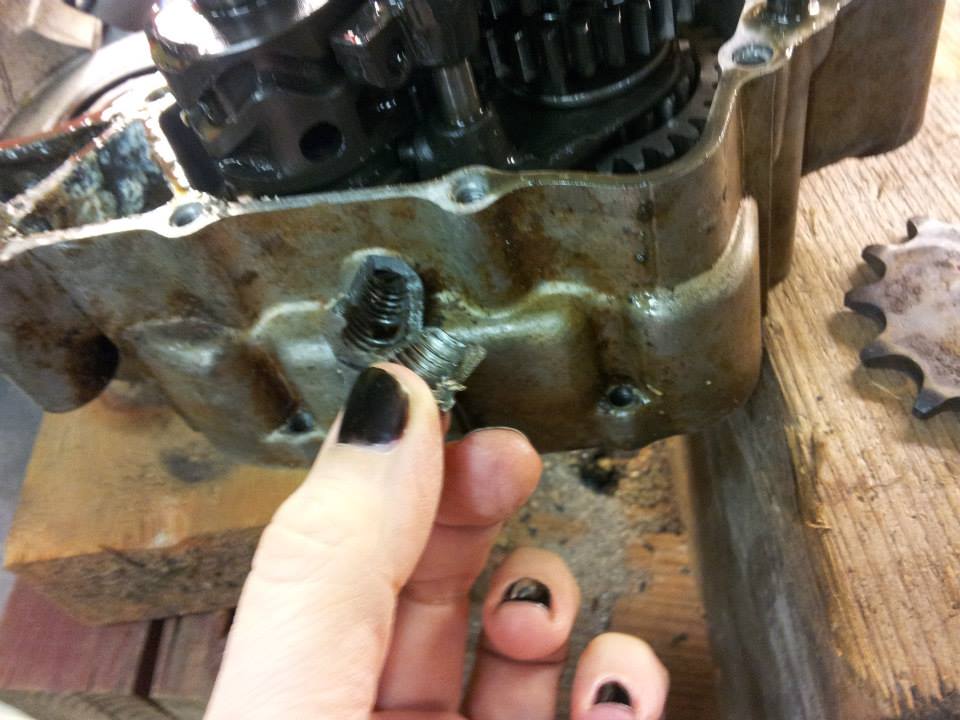

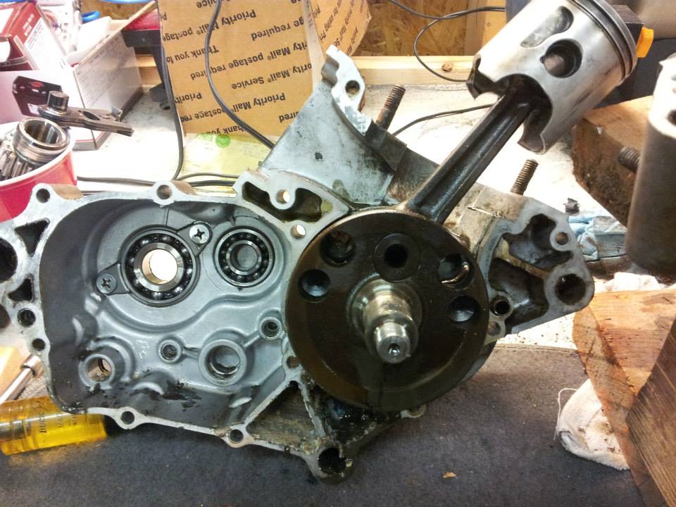

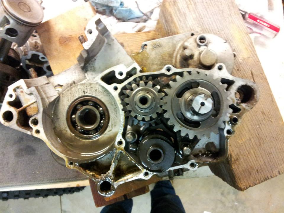

source of the oil leak - cracked drain plug threads. have to find some different cases...
queen of spodes 89 kx125 2-7.jpg (74.36 KiB) Viewed 10314 times
crank and rod looked ok and spun freely. sending it off to get rebuilt with OEM conn rod & bearing kit
queen of spodes 89 kx125 2-8.jpg (102.62 KiB) Viewed 10314 times

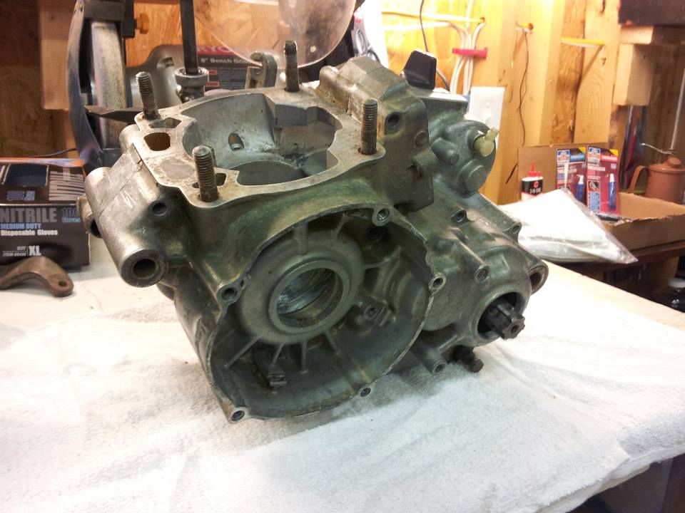

Found some cheap cases on Ebay.. they were painted forest green. The side I needed is in decent shape though, so I just need to get these soda blasted.
queen of spodes 89 kx125 2-9.jpg (77.56 KiB) Viewed 10314 times
queen of spodes 89 kx125 3-1.jpg (77.08 KiB) Viewed 10314 times
ok setting the engine aside for the time being...

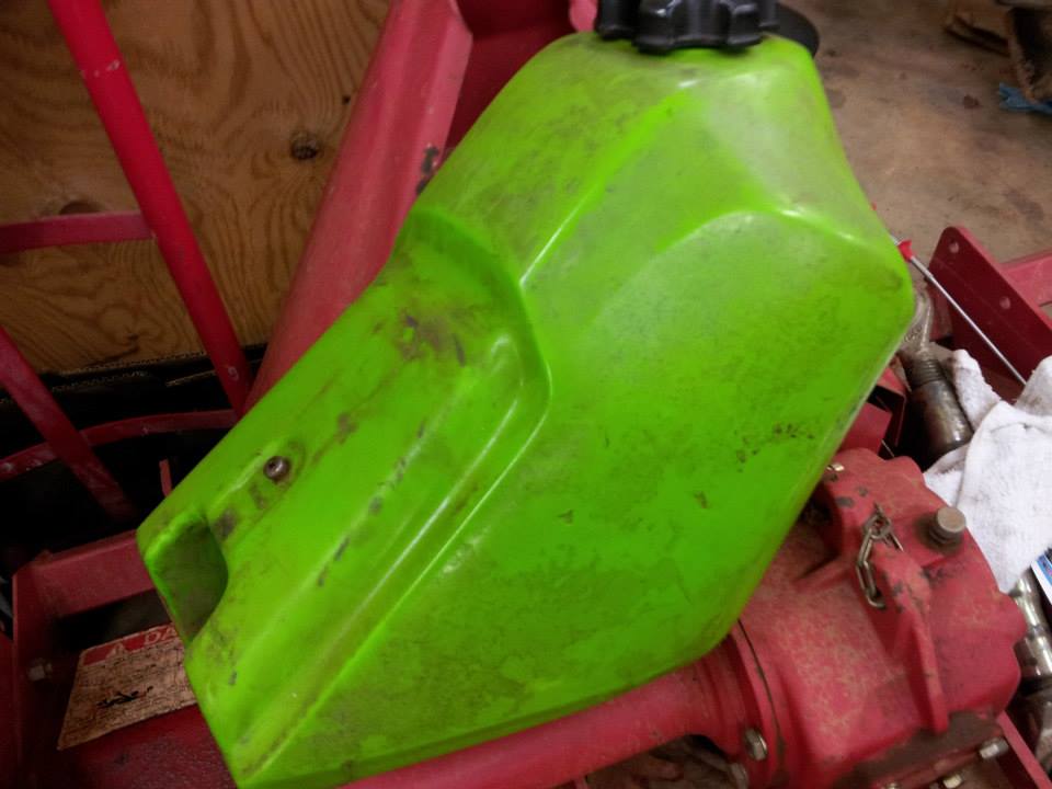

Here's the gas tank that came with the bike.. it was pretty grimy and a little stained. I picked up a nicer tank on fleabay (not pictured)

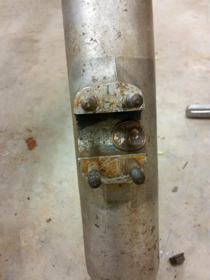

Ok so now I move on to the forks. More WTF goodness would be discovered...
89 kx's had the nice 46mm conventionals.. a lot of people ran these into the mid 90s (chunking the USD's that came on early perimeter frame KXs). good forks.
But look closely at the axle holder on the right leg. see anything?
queen of spodes 89 kx125 3-3.jpg (73.18 KiB) Viewed 10314 times
Let me enlarge that for you...
queen of spodes 89 kx125 3-4.jpg (72.84 KiB) Viewed 10314 times
Previous owner had a 87 or earlier front wheel mounted up.. those wheels had smaller axles.. so they used their "ingenuity" to make this penny spacer to hold the loose axle in the 89 legs.
queen of spodes 89 kx125 3-5.jpg (60.08 KiB) Viewed 10314 times
queen of spodes 89 kx125 3-6.jpg (69.55 KiB) Viewed 10314 times

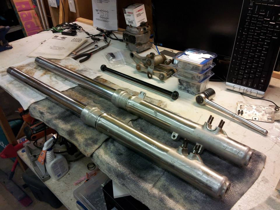

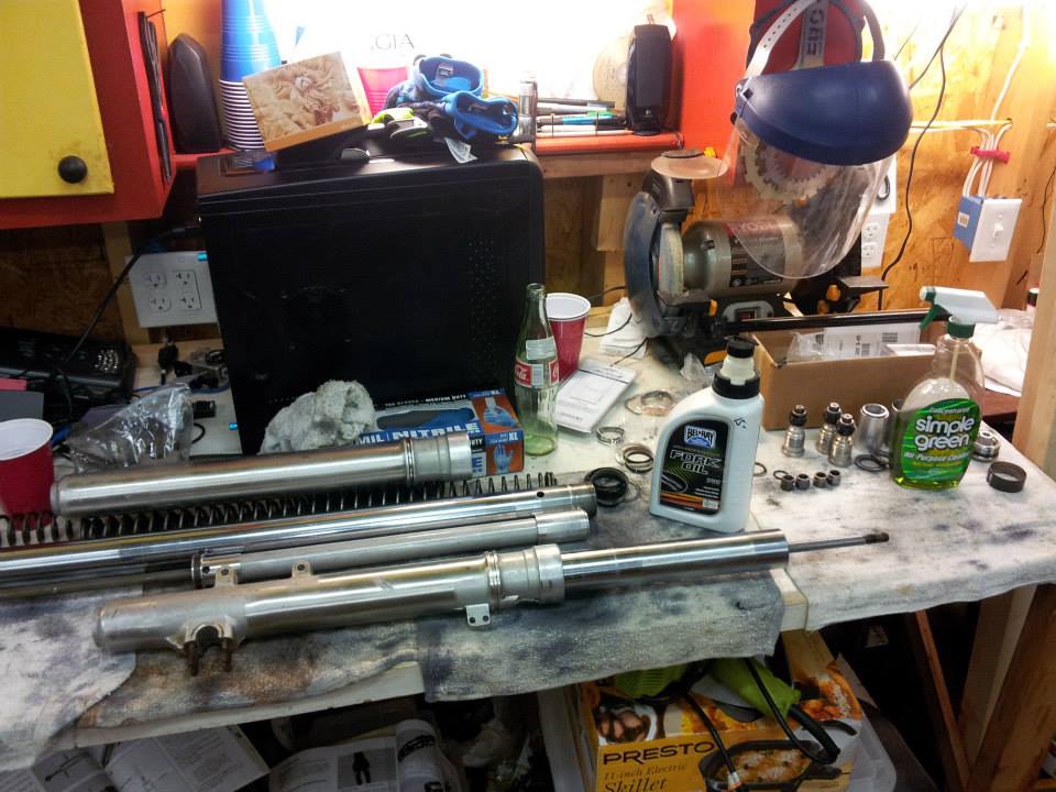

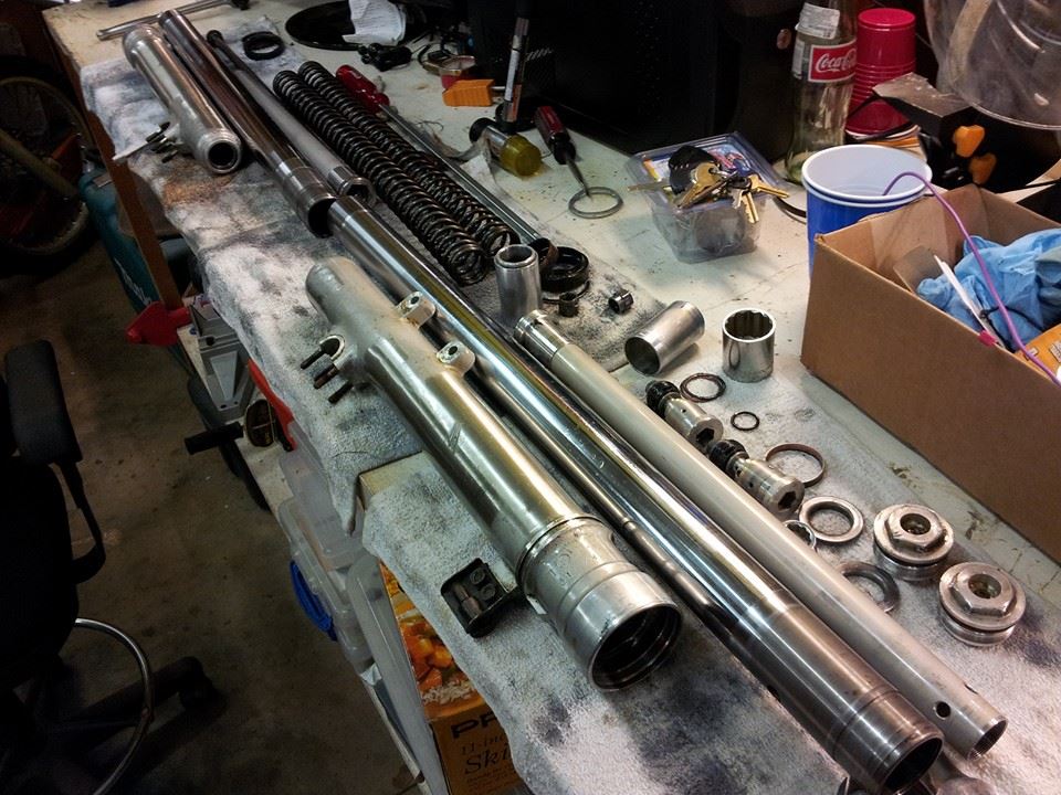

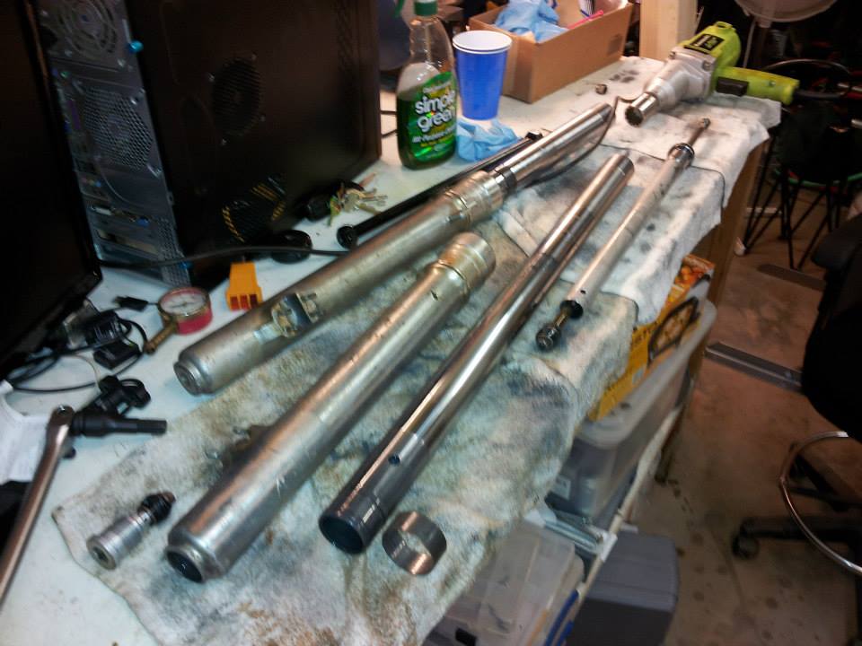

Got the legs off and disassembled on the work bench. NOTE I wrote up a how-to on this process - click here. You will need a special tool to get the legs apart. Follow this thread starting here.. I have pics of the tool and how it works just continue reading this thread.
queen of spodes 89 kx125 3-7.jpg (78.25 KiB) Viewed 10314 times
First set of forks in storage:
queen of spodes 89 kx125 3-8.jpg (79.57 KiB) Viewed 10314 times
Found a second set of legs that looked a LOT better - picked them up and broke them down too so I could pick and choose the nicer components from both sets
queen of spodes 89 kx125 3-9.jpg (133 KiB) Viewed 10314 times
Internals were pretty descent on both legs so I went with the ones that looked a little cleaner.
queen of spodes 89 kx125 4-1.jpg (98.46 KiB) Viewed 10314 times
Rebuilt and ready to install
queen of spodes 89 kx125 4-2.jpg (97.76 KiB) Viewed 10314 times

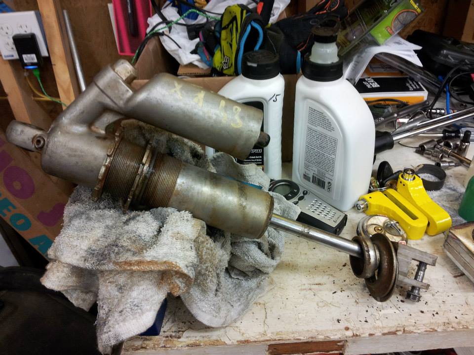

Posted: Sat Aug 23, 2014 8:38 pm

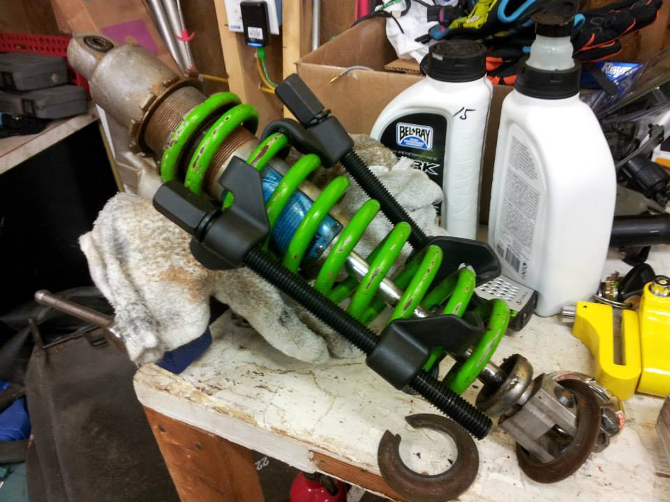

Shock looked crusty and abused. Removed spring and sent to a Race Tech service center here in GA.
ps if you have tips for a better way of removing the spring please reply & give details
queen of spodes 89 kx125 4-3.jpg (91.22 KiB) Viewed 10314 times
shock ready to be shipped off
queen of spodes 89 kx125 4-4.jpg (102.75 KiB) Viewed 10314 times
shock received back from Race Tech service center with next to no packing material inside. Shock was sticking out of the box when it arrived. I was not impressed after having spent about $250 getting it rebuilt.
queen of spodes 89 kx125 4-5.jpg (90.44 KiB) Viewed 10314 times
Need to get the original spring blasted and powder coated.. but thats for later.

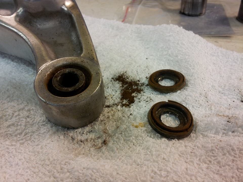

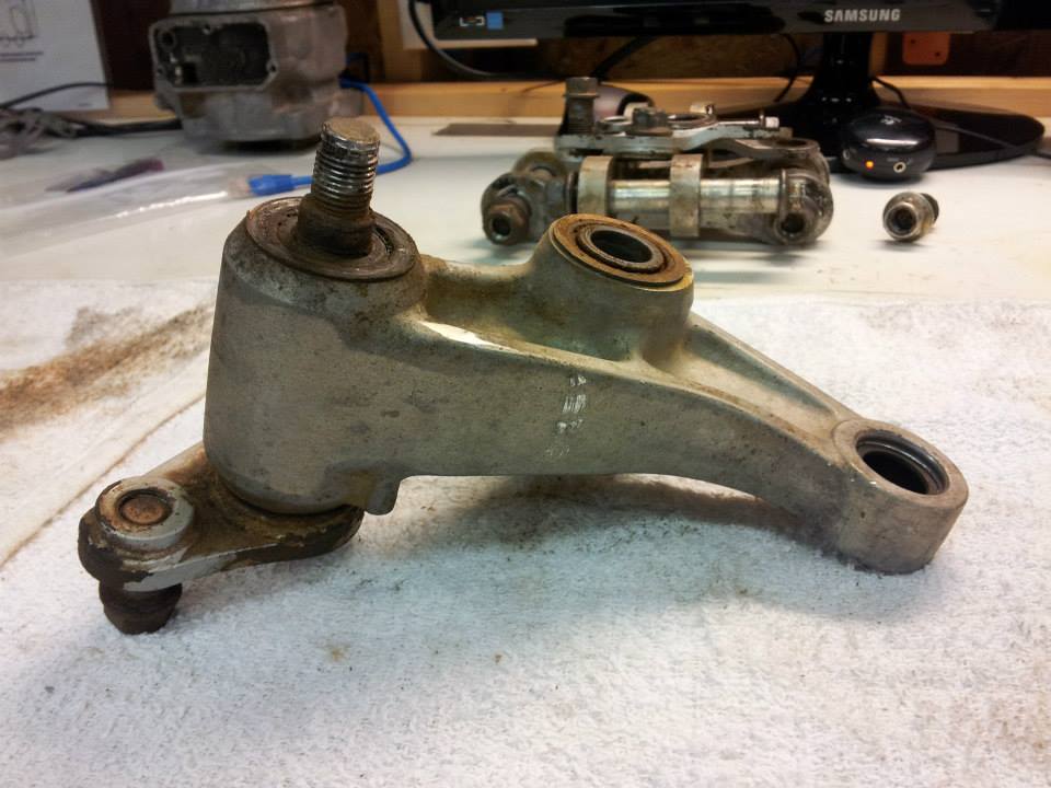

Linkage that came with the bike was frozen up pretty good.
queen of spodes 89 kx125 4-6.jpg (77.76 KiB) Viewed 10314 times

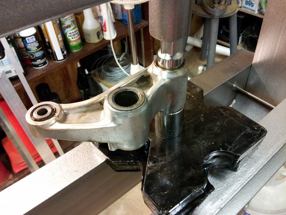

Luckily I spotted a set on Ebay that was fully disassembled. Good for rebuilding
Pressing out the bearing races
queen of spodes 89 kx125 4-7.jpg (124.72 KiB) Viewed 10314 times
Shock mount was rusted up pretty good.. had to press this little one out (wouldn't come out with my vice)
queen of spodes 89 kx125 4-8.jpg (88.76 KiB) Viewed 10314 times

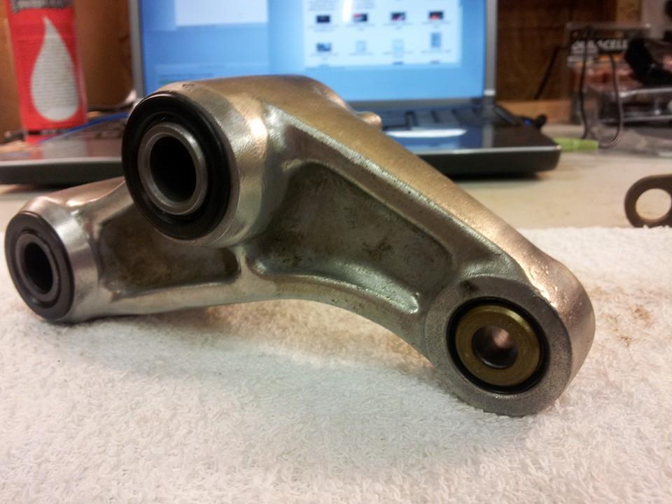

Got all of the bearings replaced and this piece is ready to go
