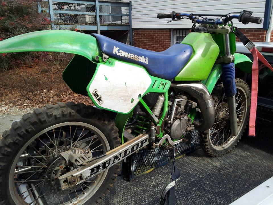

Earlier this year I bought a project bike not knowing what all I would get into. I've asked for some help along the way but thought I'd share a few pics of the bike before I got it and now that I am working on it.

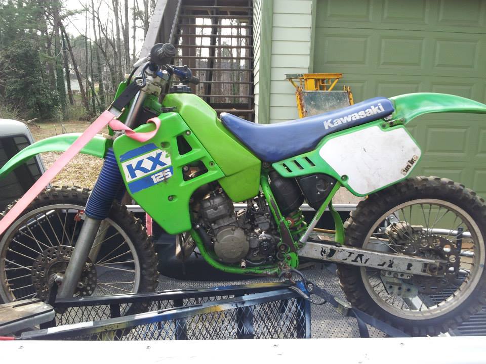

Here are a couple pics from a previous owner.. from what I learned this bike had been passed around to a couple people after being rescued from a bad owner. Nobody wanted to dive in, and after taking it apart I see why!
note the 88 graphics on the radiator shroud
queen of spodes 89 kx125 1-2.jpg (110.65 KiB) Viewed 10493 times
queen of spodes 89 kx125 1-3.jpg (126.16 KiB) Viewed 10493 times

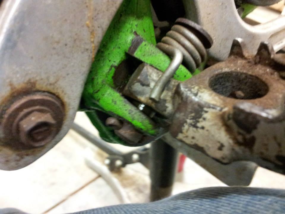

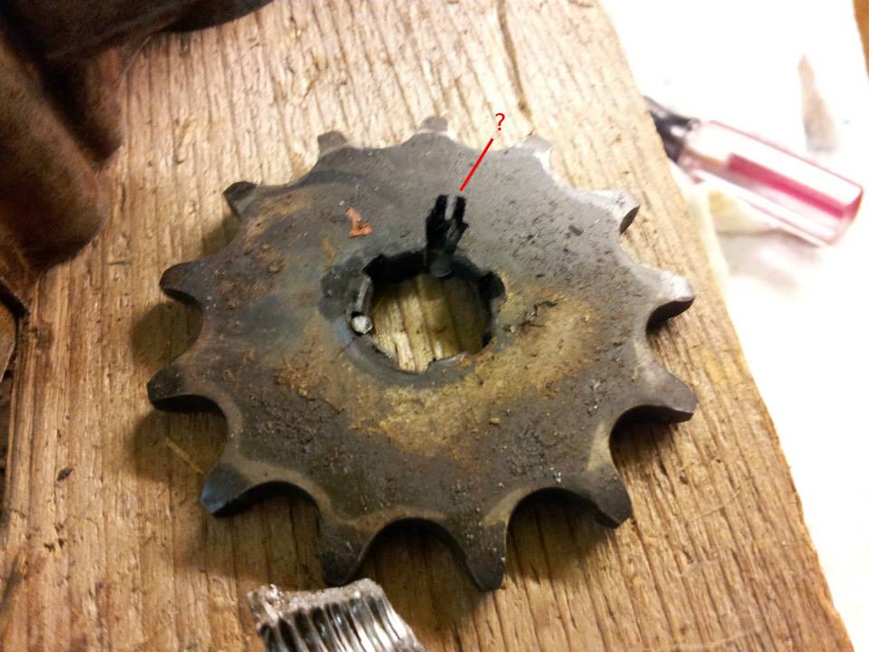

Check out that sprocket!
queen of spodes 89 kx125 1-5.jpg (114.38 KiB) Viewed 10493 times

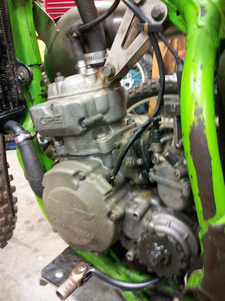

right side. engine was drooling fresh oil from somewhere...
queen of spodes 89 kx125 1-6.jpg (103.04 KiB) Viewed 10493 times

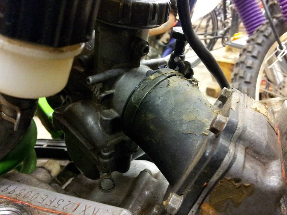

Carb & boot crusty
queen of spodes 89 kx125 1-9.jpg (79.81 KiB) Viewed 10493 times
queen of spodes 89 kx125 2-1.jpg (95.69 KiB) Viewed 10493 times

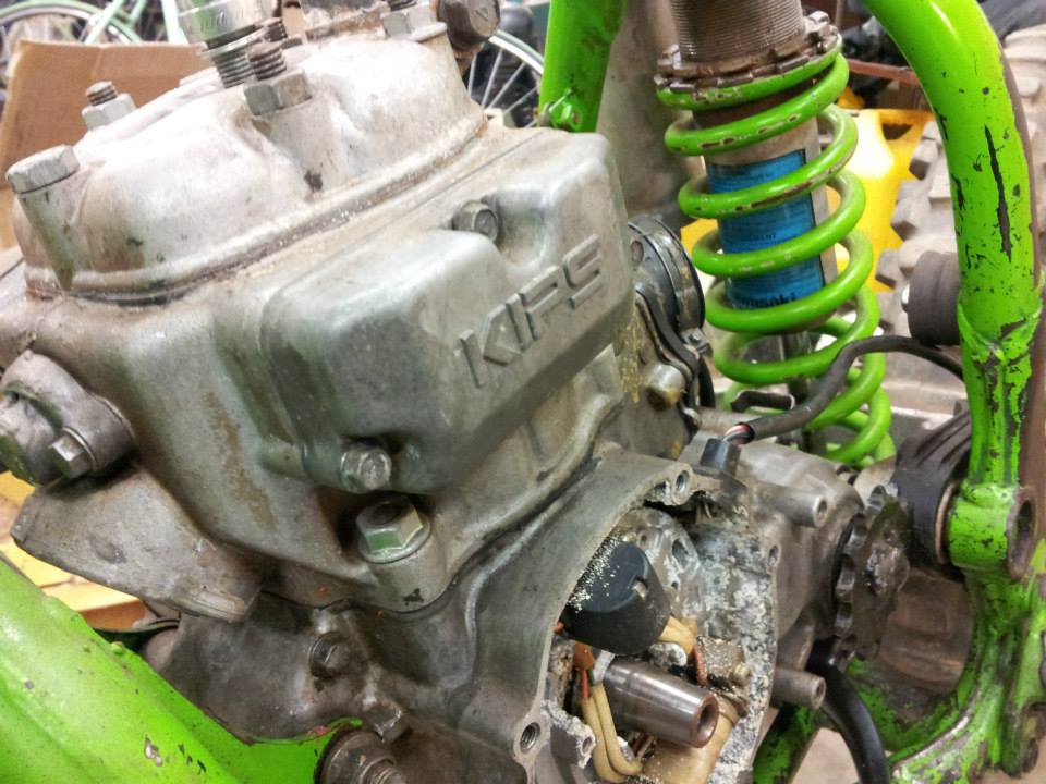

lots of corrosion here, but the bike put out a nice fat blue spark
queen of spodes 89 kx125 2-2.jpg (95.15 KiB) Viewed 10493 times
orange RTV, tell tale signs of shade tree mechanic
queen of spodes 89 kx125 2-3.jpg (77.55 KiB) Viewed 10493 times
clutch pack looked pretty good considering the outside of the engine and frame
queen of spodes 89 kx125 2-4.jpg (93.73 KiB) Viewed 10493 times

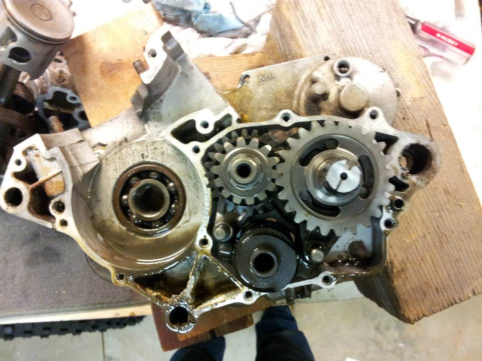

had to grind down the sprocket welding to get the cases apart
queen of spodes 89 kx125 2-5.jpg (92.03 KiB) Viewed 10493 times

source of the oil leak - cracked drain plug threads. have to find some different cases...
queen of spodes 89 kx125 2-7.jpg (74.36 KiB) Viewed 10493 times

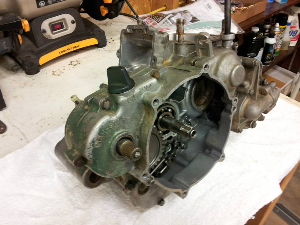

Found some cheap cases on Ebay.. they were painted forest green. The side I needed is in decent shape though, so I just need to get these soda blasted.
queen of spodes 89 kx125 2-9.jpg (77.56 KiB) Viewed 10493 times
queen of spodes 89 kx125 3-1.jpg (77.08 KiB) Viewed 10493 times
ok setting the engine aside for the time being...

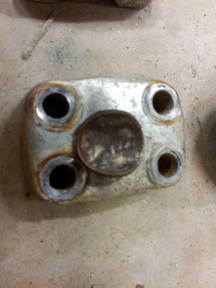

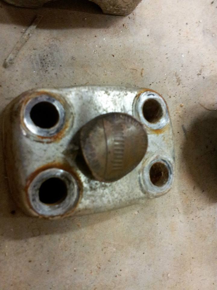

Ok so now I move on to the forks. More WTF goodness would be discovered...
89 kx's had the nice 46mm conventionals.. a lot of people ran these into the mid 90s (chunking the USD's that came on early perimeter frame KXs). good forks.
But look closely at the axle holder on the right leg. see anything?
queen of spodes 89 kx125 3-3.jpg (73.18 KiB) Viewed 10493 times
Let me enlarge that for you...
queen of spodes 89 kx125 3-4.jpg (72.84 KiB) Viewed 10493 times
Previous owner had a 87 or earlier front wheel mounted up.. those wheels had smaller axles.. so they used their "ingenuity" to make this penny spacer to hold the loose axle in the 89 legs.
queen of spodes 89 kx125 3-5.jpg (60.08 KiB) Viewed 10493 times
queen of spodes 89 kx125 3-6.jpg (69.55 KiB) Viewed 10493 times

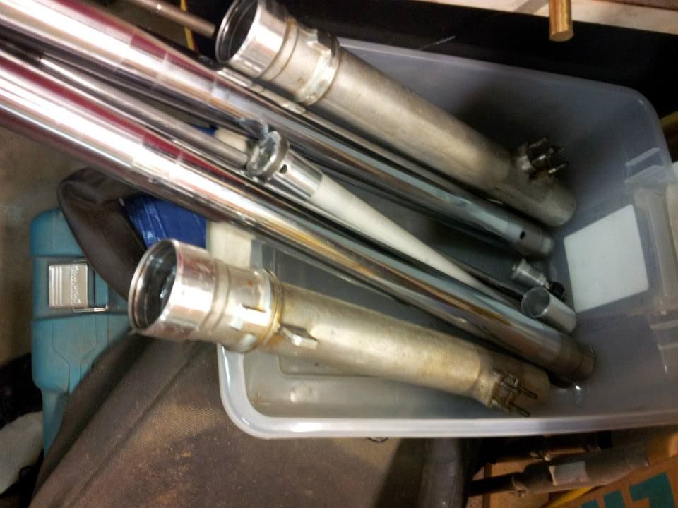

First set of forks in storage:
queen of spodes 89 kx125 3-8.jpg (79.57 KiB) Viewed 10493 times

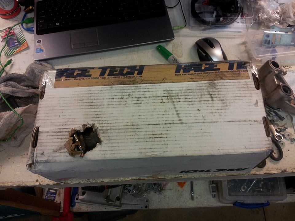

shock received back from Race Tech service center with next to no packing material inside. Shock was sticking out of the box when it arrived. I was not impressed after having spent about $250 getting it rebuilt.
queen of spodes 89 kx125 4-5.jpg (90.44 KiB) Viewed 10493 times
