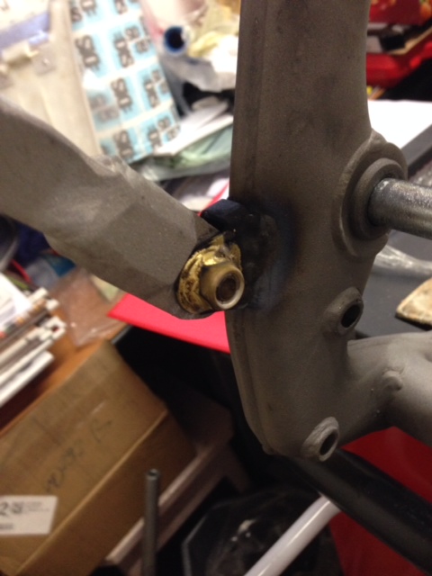

Some days ago I've bought a welding torch (is correct?) so I can make some repairs in my garage without spend money.
For first job I welded a flanged nut on the main frame where the original part lost.
Easy job but a mechanic takes a lot of money.

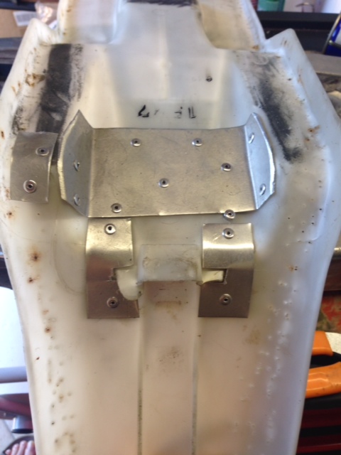

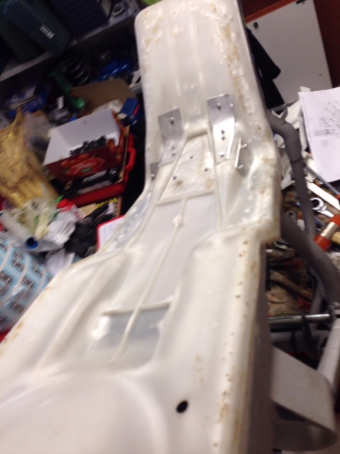

Well, one of the parts needs repair..the seat! Was broken.
I left the seat in the sun for about 30minutes (here there are about 30-35 degrees in the summer ...) to get the soft plastic.
I spent a half day for remove every clip, clean up the plastic (after 25 years...) and prepare for the repair.
For first I used a special glue, very strong with plastics. After I used a piece of alu 0,5mm thikness, cutted some parts and fixed with 3mm rivets.
Ok i'm an enthusiast not a professional but I'm happy for my repair. I checked many times but now it's good.
foto 2.JPG (87.05 KiB) Viewed 11261 times
foto 5.JPG (86.81 KiB) Viewed 11261 times
Now the seat is ready for a new cover.

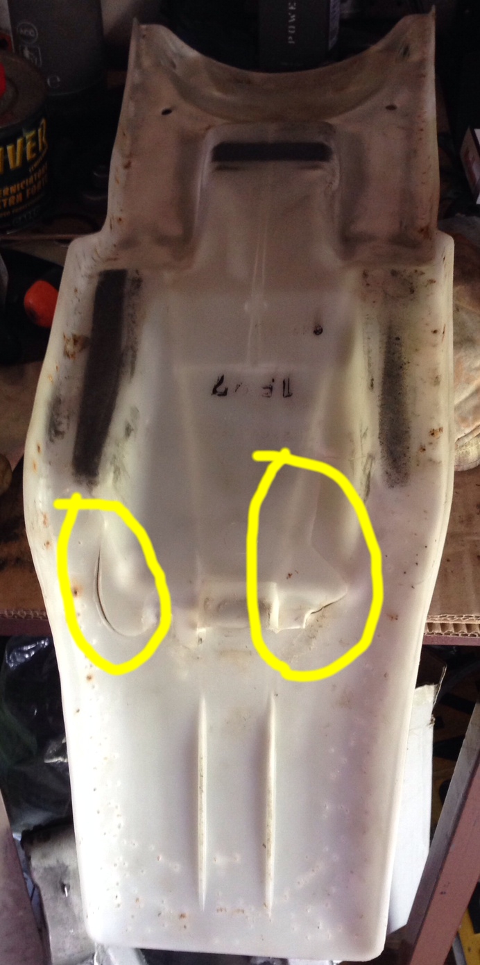

Re: Lukas 1990 Kawasaki KX500 rebuild in Italy
Posted: Mon Jul 21, 2014 6:15 pm
So, what is different in these photos?
FRAME PIC 1.JPG (62.17 KiB) Viewed 11252 times
