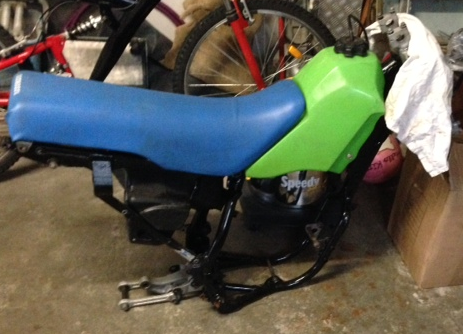

Here is after a little work.
Lukas 1989 kawasaki kx250 Italy 1.jpg (128.8 KiB) Viewed 11719 times
As you can see, he has sandblasted the frame.
He has some repairs to do including fixing some threads.
Also, his seat pan needs some work as well.
But, it's a good start.

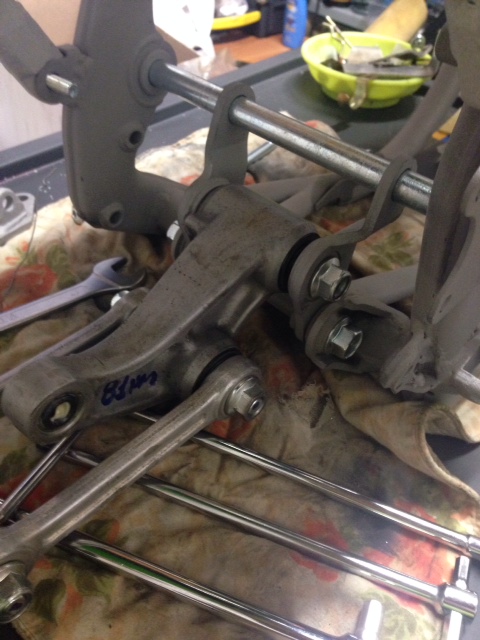

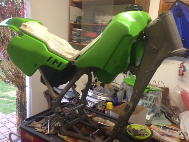

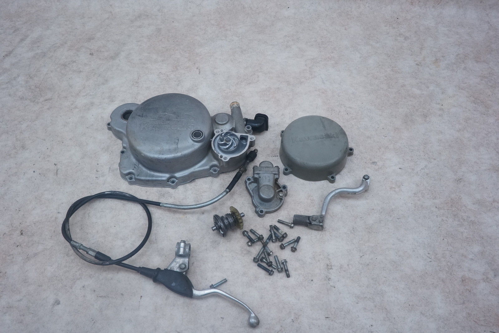

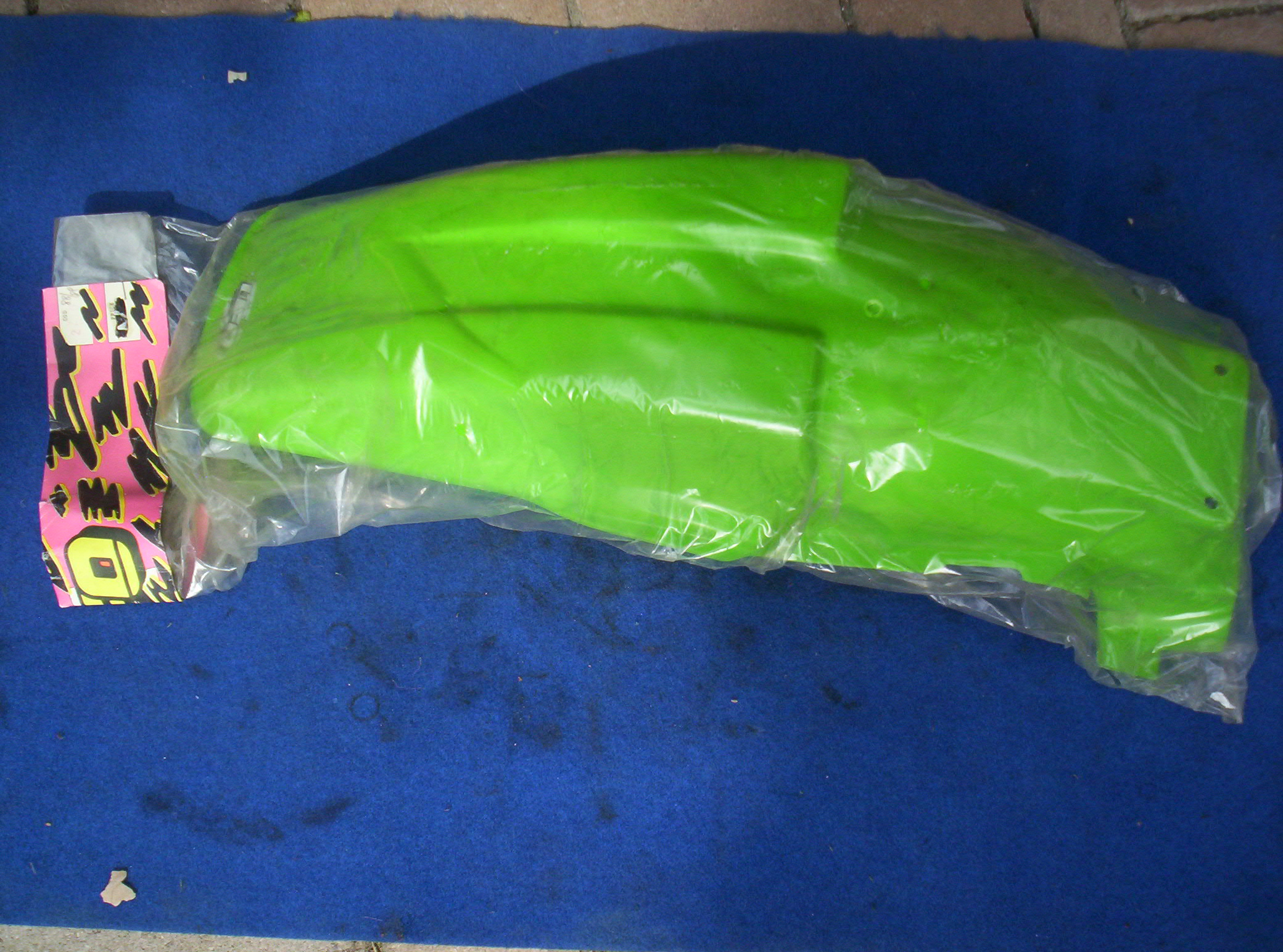

Lukas has ordered parts from all over :D
Lukas 1989 kawasaki kx250 Italy 6.jpg (240.11 KiB) Viewed 11715 times
Lukas 1989 kawasaki kx250 Italy 7.JPG (673.56 KiB) Viewed 11715 times
Test fitting some replacement parts.

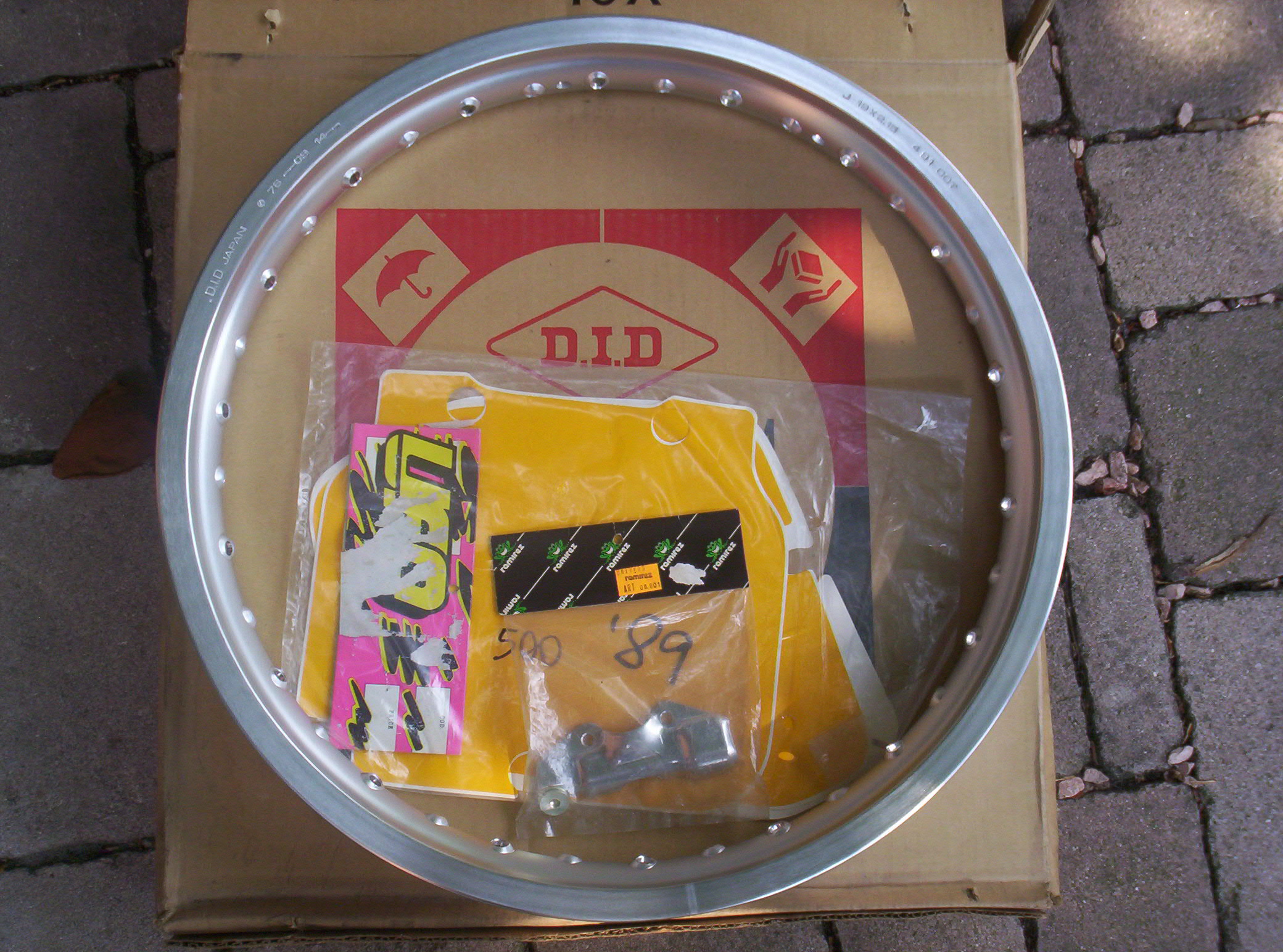

Re: Lukas 1989 Kawasaki KX250 rebuild in Italy
I wonder where this box came from :?: :D

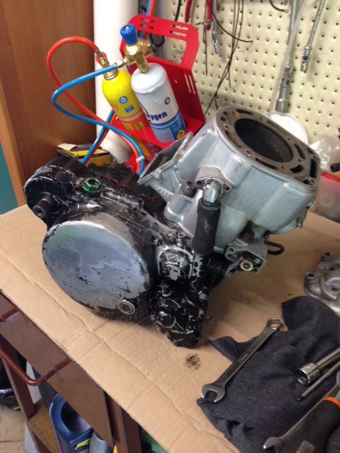

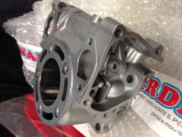

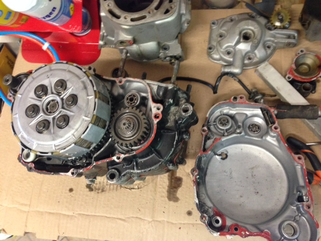

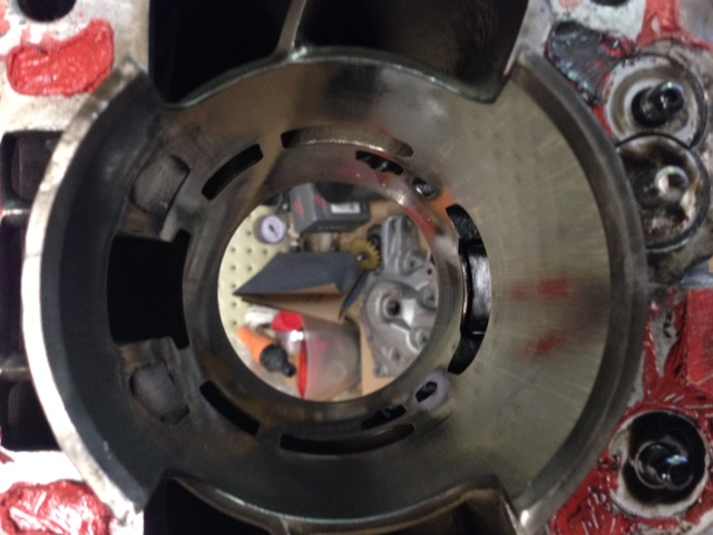

ok, during these days I worked hard on other items that need maintenace and repairs.
The cylinder is in working progress, re-plating, sanblasted. I would like as new. I asked a diameter of 86,00 for use a Pro-X piston A (85,94mm) the oem replica.
For example this is the picture of the my Cr125R 1993 cylinder. Re-plated, sandblasted cylinder and head togheter. As new.

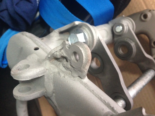

Some days ago I've bought a welding torch (is correct?) so I can make some repairs in my garage without spend money.
For first job I welded a flanged nut on the main frame where the original part lost.
Easy job but a mechanic takes a lot of money.

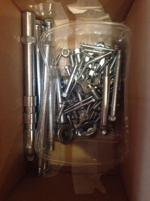

I cleaned up all the screws and pins so I did galvanize all.
foto 1.JPG (112.17 KiB) Viewed 11683 times
Re: Lukas 1990 Kawasaki KX250 rebuild in Italy
Lukas.
I looked at the pics and laughed :lol: You do have a kx500 :lol: :lol: :lol:
Your doing a great job of repair on everything!
Galvanizing your bolts?
That's a great idea.
Did you do that yourself?
The seat repair looks great.

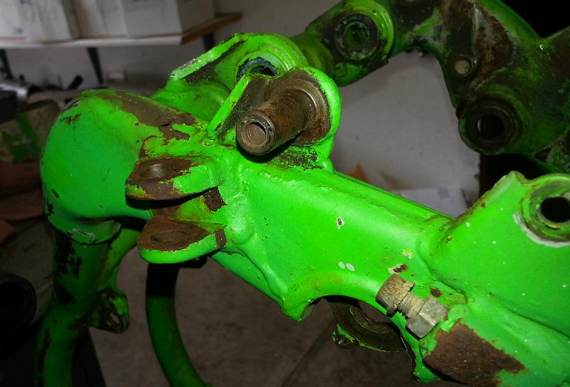

Re: Lukas 1990 Kawasaki KX500 rebuild in Italy
So, what is different in these photos?
