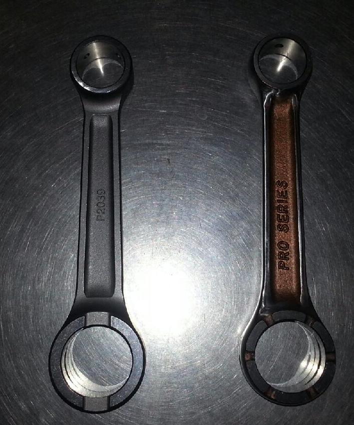

So here is the two culprits..
wossner vs ims pro connecting rod comparison 2.jpg (99.69 KiB) Viewed 17941 times
wossner vs ims pro connecting rod comparison 1.jpg (68.09 KiB) Viewed 17941 times
Initially I threw them on my scale which isn't the most accurate but it found that the Wossner was .7lb and the IMS was .6lb.
I'd like to get that on a better scale to really get down to the nitty gritty.
So, why does the Wossner weigh more?
First off the IMS Pro is polished so all the edges are more rounded whereas the Wossner has sharper edges.

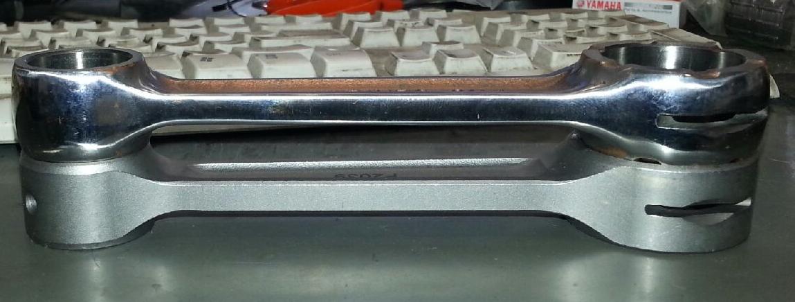

Here is where I think the main weight difference is.
Look at the thickness.
Combine that with the rounded corners of the IMS and it's becoming clear that the Wossner is a little heavier.
wossner vs ims pro connecting rod comparison 4.JPG (76.44 KiB) Viewed 17940 times

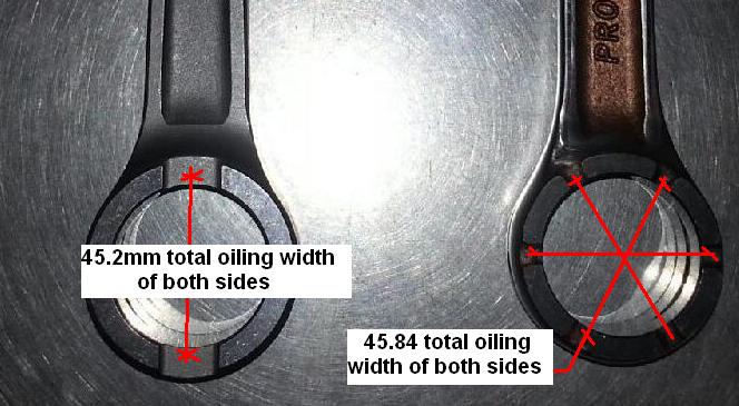

The Wossner has 22.92 SQ MM of oiling area
The IMS Pro has 16.61 SQ MM of oiling area
wossner vs ims pro connecting rod comparison 5.JPG (32.05 KiB) Viewed 17940 times

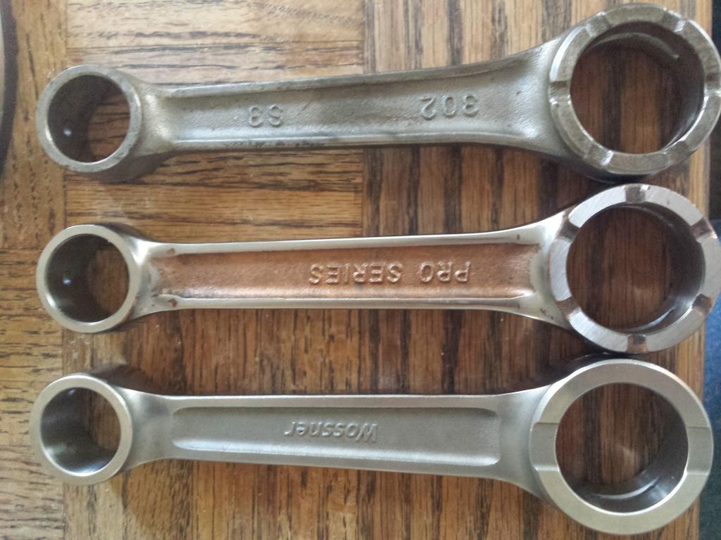

Here is some Motorrad info..
wossner ims pro series stock rod comparison 1.jpg (185.49 KiB) Viewed 17780 times
wossner ims pro series stock rod comparison 2.jpg (185.98 KiB) Viewed 17780 times
Weights
Stock
Total. 268g
Small end. 108g
Big end. 160g
Ims
Total. 276g
Small end. 112g
Big end. 164g
Crank pin. 160g
Thrust washers. Meh..
Wossener
Total. 308g
Small end. 120g
Big end 188g
Crank pin. 158g
Thrust washers. NICE!!
BIG AND small end bearings look the same on both aftermarket kits
