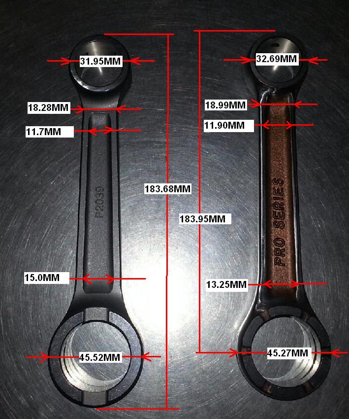

Here's some dimensions

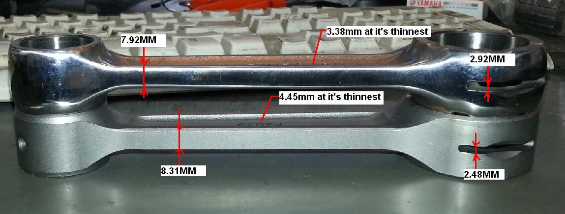

More measurements
Here is where I think the main weight difference is.
Look at the thickness.
Combine that with the rounded corners of the IMS and it's becoming clear that the Wossner is a little heavier.

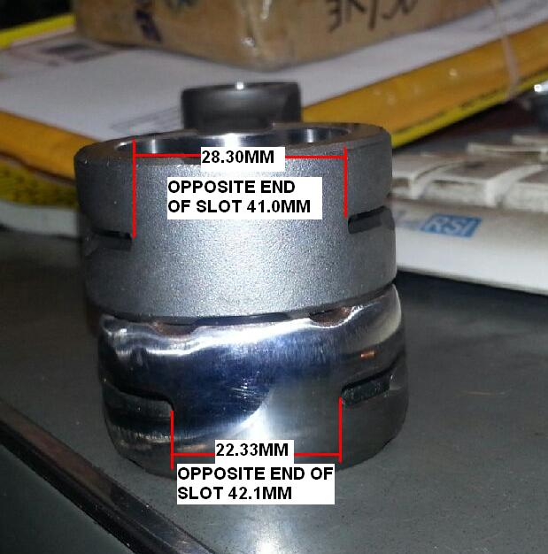

The Wossner has 22.92 SQ MM of oiling area
The IMS Pro has 16.61 SQ MM of oiling area

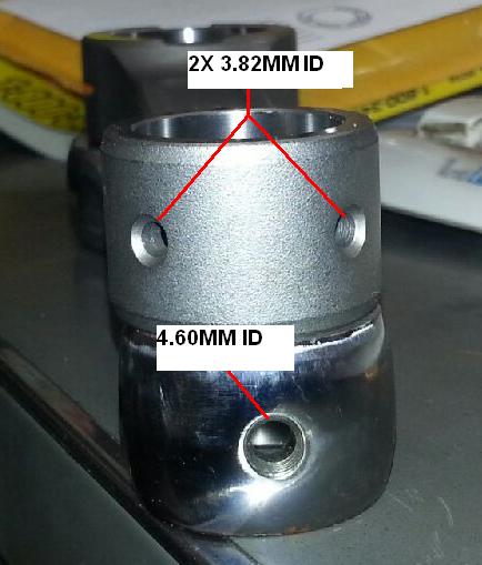

Side oiling
wossner vs ims pro connecting rod comparison 7.JPG (52.57 KiB) Viewed 17937 times
Does anybody have a stock or other rod we can compare to?

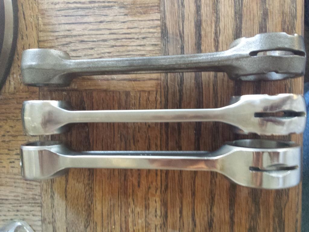

Here is some Motorrad info..
wossner ims pro series stock rod comparison 1.jpg (185.49 KiB) Viewed 17777 times
wossner ims pro series stock rod comparison 2.jpg (185.98 KiB) Viewed 17777 times
Weights
Stock
Total. 268g
Small end. 108g
Big end. 160g
Ims
Total. 276g
Small end. 112g
Big end. 164g
Crank pin. 160g
Thrust washers. Meh..
Wossener
Total. 308g
Small end. 120g
Big end 188g
Crank pin. 158g
Thrust washers. NICE!!
BIG AND small end bearings look the same on both aftermarket kits

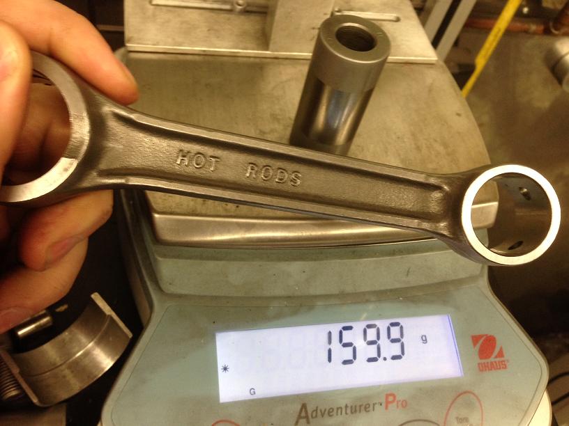

Here is some pics of Roost weighing some rods and how he did it.
