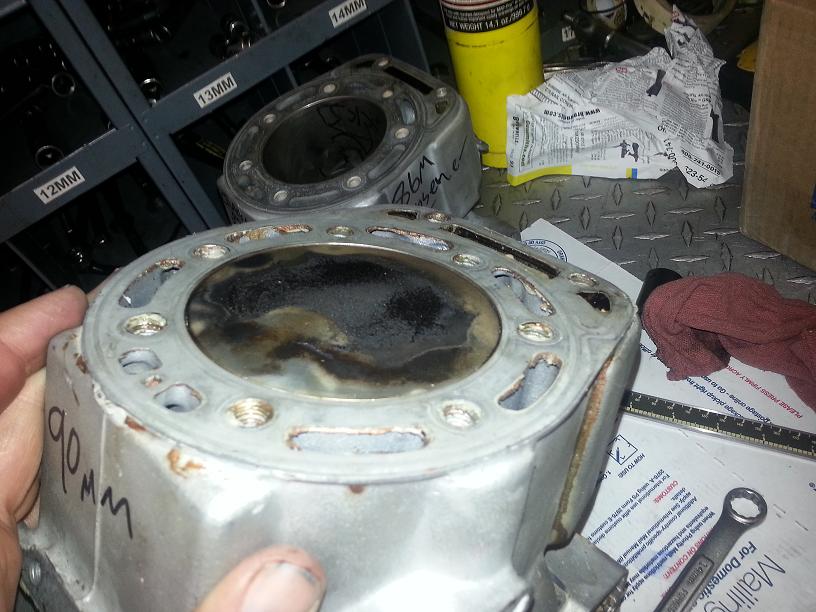

Here is an example of a KX500 engine that shows the intake side of the piston is running way richer then the rest of the piston.
clocking a kx500 cylinder with a window.JPG (89.38 KiB) Viewed 3647 times
As you can see, the intake side of the piston is washed out a lot more then the exhaust side of the cylinder..
