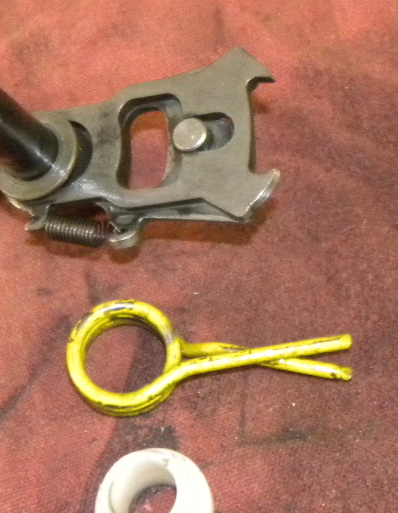

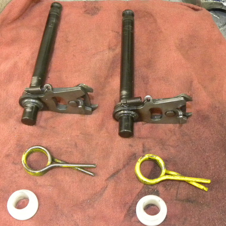

Here is a pic with the shaft removed.
shifting issue 4.PNG (165.59 KiB) Viewed 19566 times
The shaft that came out of the bike is on the right.

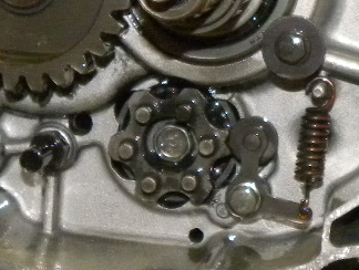

Another view..

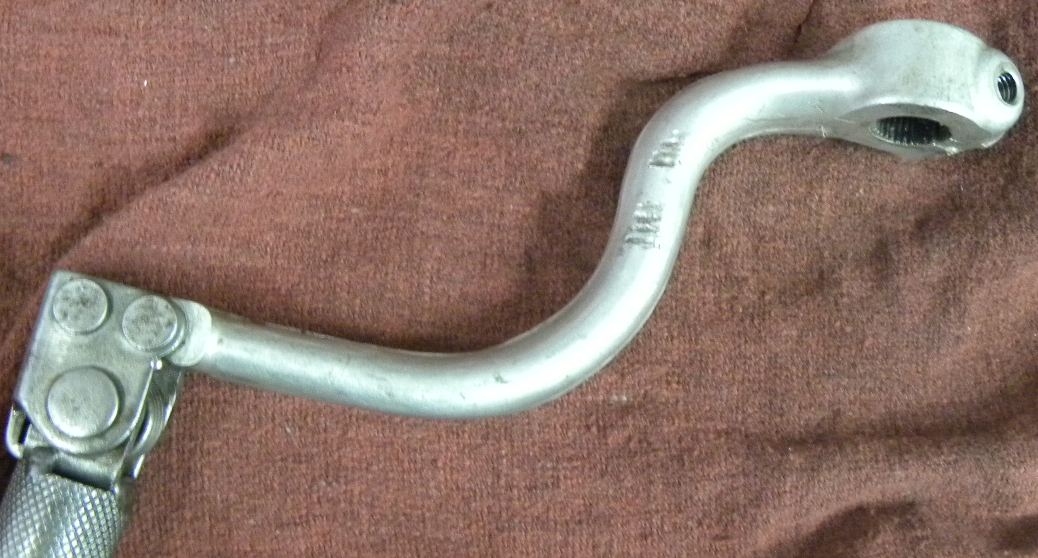

Ok, found the problem....
I have to say that I feel like a real dummy...
Guess where the hang up and grinding was coming from....
SHIFT LEVER.PNG (1.17 MiB) Viewed 19529 times
From the first time I rode the bike to the second time I changed the front sprocket to a 15T from a 14T.
My Dad was no mechanic but he always said, if you changed something and now there is a problem, go back and look at what you changed..
I had completely forgot that I changed the sprocket :lol:
Oh well, at least I can laugh at myself and perhaps someone will learn a valuable lesson :geek:
