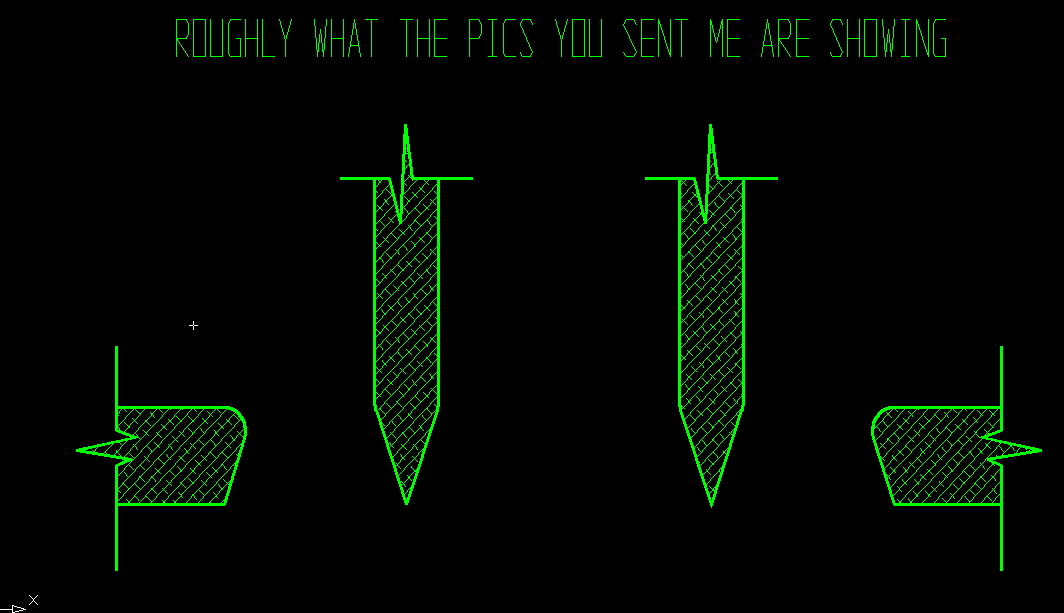

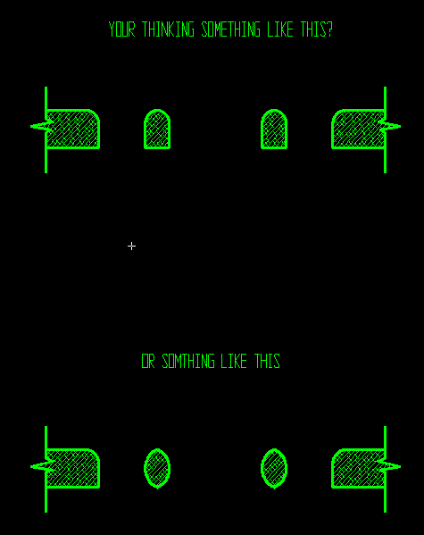

Just stuff I'm scratching my head over, Please ignore :-)
motorrads porting.PNG (13.05 KiB) Viewed 16734 times
motorrads porting 2.PNG (10.44 KiB) Viewed 16734 times

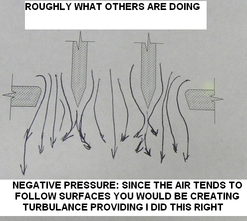

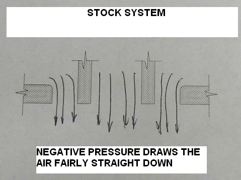

Re: Just stuff I'm scratching my head over
No, those were wrong.
This is a better representation..

I dont even know what im looking at.

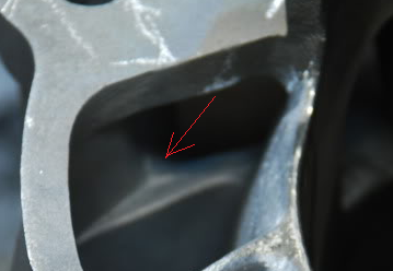

This is the area I'm looking at but in a section view and at 90 degrees to what is shown.

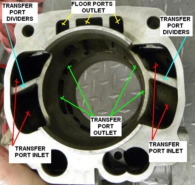

TRANSFER PORTS.JPG (72.5 KiB) Viewed 16676 times
