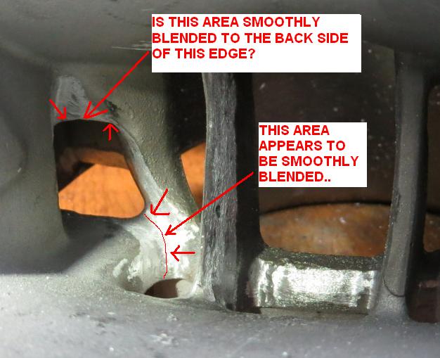

More nail biting... :D
more clean up.JPG (20.54 KiB) Viewed 14734 times
more clean up 2.JPG (24.09 KiB) Viewed 14734 times

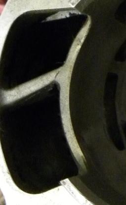

Since it's hard to see in the photo's I thought this might help
CROSS SECTION A.JPG (16.98 KiB) Viewed 14733 times
CROSS SECTION B.JPG (27.4 KiB) Viewed 14733 times

Perhaps this needs more work as well...
more clean up 3.JPG (21.84 KiB) Viewed 14731 times
Seems there is a lot of casting flaws back in that area...
This reminds me of playing Operation when I was a kid... Touch the edges... EEEEEEE!!!!!! :lol:

dont forget to take pics of half a case bolted to the jug ......
the port that edge hits the CYL wall .. you want that pretty sharp... and blend it down into the port.
