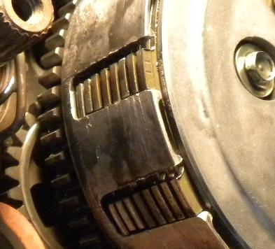

I figured that I would start this off with a clutch basket from a 01 CR250 :D
Yes, it was still working although the clutch pull was a bit hard.

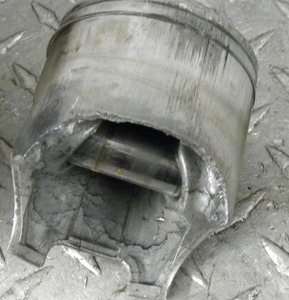

A customer comes in with a 91 YZ250.
He says there is a weird rattling noise.
So he starts is up, Rattle, Rattle, Rattle.
Yep, it sounds like you need a new top end.
Couldn't be, he says, the guy I bought it from says he put a new top end in it last summer and it only has 10 hours on it.
Well, let's take a look, I said...
91 YZ250 Piston 2.JPG (37.56 KiB) Viewed 13680 times
91 YZ250 Piston.JPG (48.96 KiB) Viewed 13680 times
The customer was blown away...... ;)
