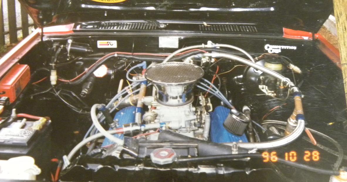

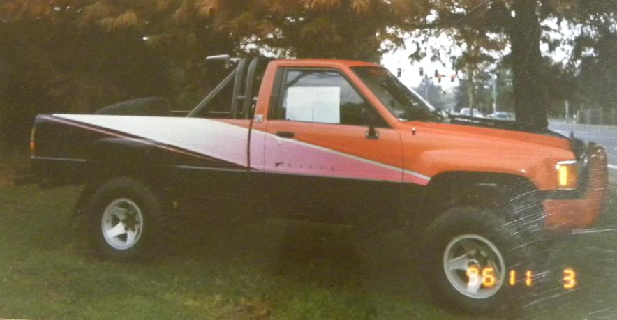

Here is a pic of my old ride.
84 Toyota 4x4 with a 85 Chevy 4.3 V6 built by RHS.
Trans was by TCI.
Santini paint.
Auburn in the front diff and a detroit locker in the rear.
All custom VDO gauges and dash.
It was in over 10 issues of 4 wheeler magazine.
I had to rebuild that engine 4 times in the 8 years I had it.
I guess i was a bit abusive.

Nice!
I had that engine in a 4X Blazer, didn't get great mpg but I guess that wasn't the point. That RHS built engine must'a motorvated that Yota right on down the line!

Back then Toyota didn't even have a V6 in these trucks so it was a big deal at the time.
RHS built a very respectable engine but they were still experimenting with the 4.3.
The heads were nicely built but they were not the vortec heads which I later installed after some porting and matching ect.
Besides the intake ramps, the vortec heads had much better flow characteristics due to greatly enlarged ports.
They used a comp cam 260 degree which was fine for the heads they used but I had comp cam grind me a 280.
Also at that rebuild I took out the GM HEI and installed the full MSD set up.
All of that combined would light up those 12.50 rear tires :D
Before that rebuild I could barely get them to bark.
I sure surprised a lot of Camaro's and Mustangs in that truck :shock:
Couldn't take them on the top end but 0-100 was a riot!
