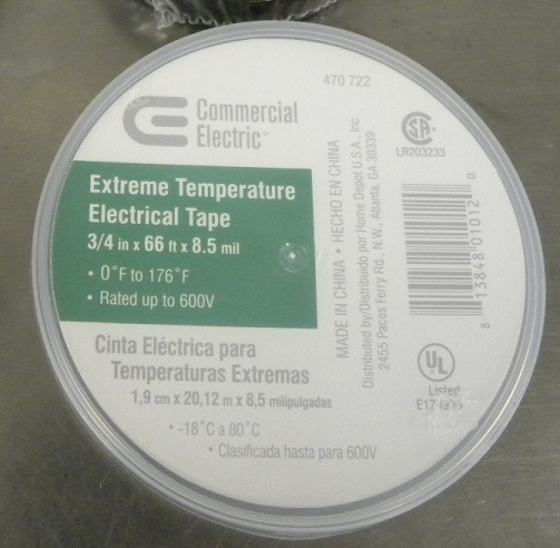

$.59 Frost king PVC Vinyl Electrical tape (Made in China). 3/4" x 60' x 7mil (or .007").
$1.97 Commercial Electrical Extreme Temperature tape (made in China). 3/4" x 66' x 8.5mil (or .0085").

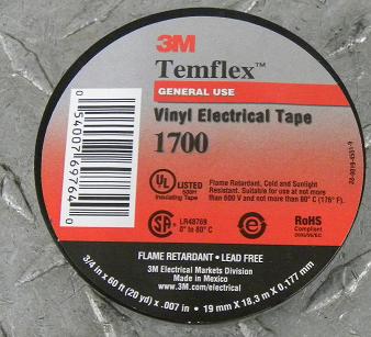

(cost?) Scotch 1700 Temflex (Made in the USA) Vinyl Electrical Tape (General Use) 3/4" x 60' x .007"

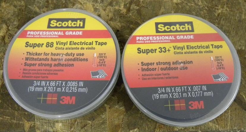

$3.79 Scotch Vinyl Electrical Tape Super 33+ (Made in the USA). 3/4" x 66' x .007"
$3.95 Scotch Vinyl Electrical Tape Super 88 (Made in the USA). 3/4" x 66' x .0085"

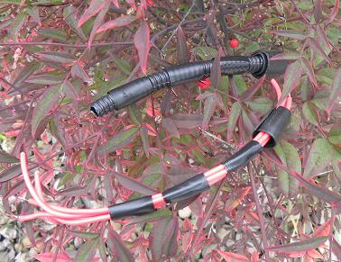

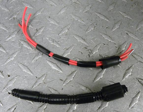

To test the different tapes adhesion qualities I will wrap the same amount of wraps around some wire loom and wires, stick it out in the weather and see what happens.
After all, if the tape won't stick for any time out in the real world, do you want it on your bike?
My testing methods are not laboratory perfect.
In fact they are downright crude.
But, this is how I will be using them so why not test how I will use them?
First I took some wire loom and 4 strands of wire.
I wrapped them left to right from least expensive to most expensive.
When I wrapped them I did not stretch the tape, or I should say that the tape was stretched as little as possible.
I did not pull the tape to break it from the roll but I used a pair of scissors to cut it.
My goal is to make sure there is as little resistance or pulling action as possible on the end of the tape cut.
The loom and the wires all received 4 wraps of the tape.
Here is the results:
Then I took the pieces and stuck them outside to let them sit in the weather.
I will check the pieces every day to see which if any starts to experience edge raveling.

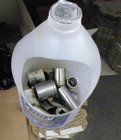

What we did was take a bottle, cut out the top so we could add weight, and taped it onto a square as shown.
We could easily add weight as required:
Then we added weight and waited for 30 seconds to add more weight.
We did this until the tape let go in under 30 seconds from adding the weight.
The square had the least surface area so we fully expected it to let go from there first and it did in every test except the very last because the tape broke before it let go.
The square was wiped down after every test with acetone to prevent contamination of the square.

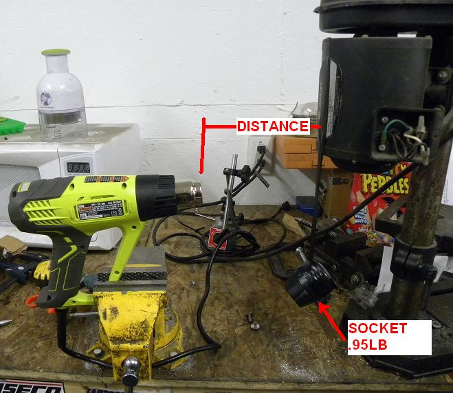

Heat Test
So here's the set up.
Simple Ryobi heat gun.
The fan is set on low.
HEAT GUN
HEAT GUN
heat gun.JPG (66.92 KiB) Viewed 19107 times
First up:
Distance from the face of the heat gun to the face of the tape 6".
Temperature: 200 deg F.
Burn through in 11 sec.
Next up:
Distance from the face of the heat gun to the face of the tape 4.5".
Temperature: 600 deg F.
Burn through in 4 sec.
Next:
Next:
Burn through in 12 sec.
Next:
$3.98 Scotch Vinyl Electrical Tape 700 (Made in the USA). 3/4" x 66' x .007"
Burn through in 13 sec.
Last:
Burn through in 15 sec.
As you can see, all the American tape was fairly close in heat resistance.

Remember this?
After 3 weeks in the weather most everything is looking really good.
Although the $.59 Frost king PVC Vinyl Electrical tape (Made in China). 3/4" x 60' x 7mil (or .007") seems to be just starting to curl.
I can't be absolutely sure just yet because it is very slight...
