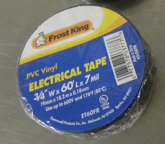

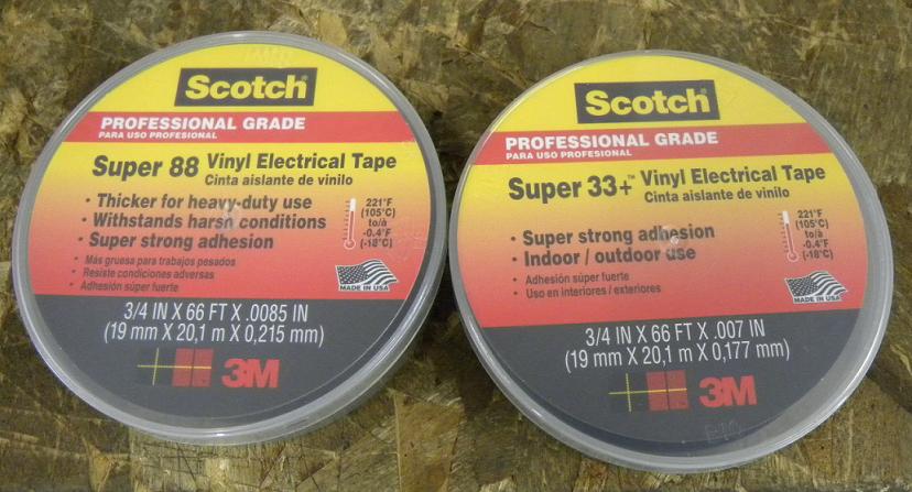

I went down to the lumber yard to pick up black electrical tape.
It was priced from 59 cents a roll up to 4.28 a roll.
I asked the sales clerk what was the difference and he picked up the roll and started reading.
Obviously he didn't know either.
So, I bought 5 different types from 3 different manufactures and had one donated by Foxx4Beaver so I could test the usability of each one.
Here is a pic of the 6 different types.
Here is what we have:
$.59 Frost king PVC Vinyl Electrical tape (Made in China). 3/4" x 60' x 7mil (or .007").
$1.97 Commercial Electrical Extreme Temperature tape (made in China). 3/4" x 66' x 8.5mil (or .0085").
(cost?) Scotch 1700 Temflex (Made in the USA) Vinyl Electrical Tape (General Use) 3/4" x 60' x .007"
$3.79 Scotch Vinyl Electrical Tape Super 33+ (Made in the USA). 3/4" x 66' x .007"
$3.95 Scotch Vinyl Electrical Tape Super 88 (Made in the USA). 3/4" x 66' x .0085"
$3.98 Scotch Vinyl Electrical Tape 700 (Made in the USA). 3/4" x 66' x .007"
Without all kinds of cool equipment, fancy lab coats, or PHD's, we will see how accurate we can get on this.
Since all the tape will be equally tested we should get fairly accurate results.
All of these tests except the weather test will be conducted in our shop which we keep at about 68 degrees.

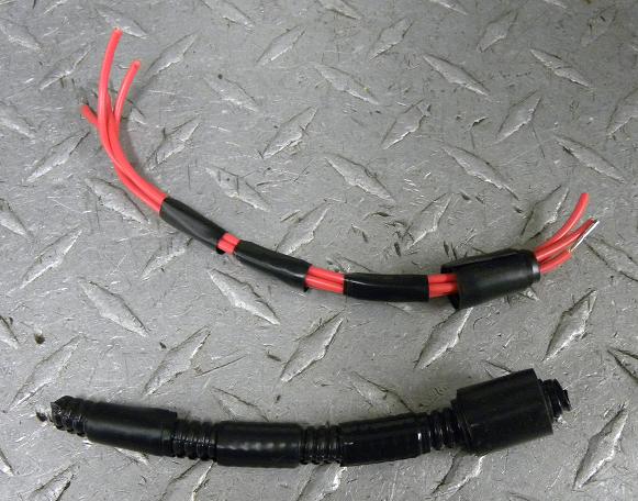

Re: So what's the story with electrical tape?
So, out of the 6 rolls the US made Scotts is the most dimensionally accurate.
But, what do we care? We are going to put it on our motorcycle and ride it and hopefully never have to deal with it again, right?
To test the different tapes adhesion qualities I will wrap the same amount of wraps around some wire loom and wires, stick it out in the weather and see what happens.
After all, if the tape won't stick for any time out in the real world, do you want it on your bike?
My testing methods are not laboratory perfect.
In fact they are downright crude.
But, this is how I will be using them so why not test how I will use them?
First I took some wire loom and 4 strands of wire.
I wrapped them left to right from least expensive to most expensive.
When I wrapped them I did not stretch the tape, or I should say that the tape was stretched as little as possible.
I did not pull the tape to break it from the roll but I used a pair of scissors to cut it.
My goal is to make sure there is as little resistance or pulling action as possible on the end of the tape cut.
The loom and the wires all received 4 wraps of the tape.
Here is the results:
Then I took the pieces and stuck them outside to let them sit in the weather.
I will check the pieces every day to see which if any starts to experience edge raveling.
Day one.
None of the tape has come unraveled, is stretched, or has any noticeable problems.
Day two.
Day six.
Up to this point it has been cold and foggy.
Temps as low as 28 deg F.
Temps as high as 42 deg F.
No rain yet, but it's coming
Since this may take a while I will continue with some other tests and continue to monitor the test pieces.
Two weeks and everything is looking good.

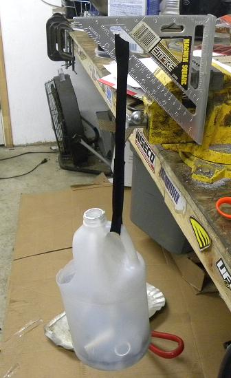

Puncture test.
Without all kinds of cool equipment, fancy lab coats, or PHD's, I will see how accurate I can get on this.
What we will do is take a piece of tape and put it on my vice.
Then we will take a punch that isn't real sharp, place it over the opening on the tape and add weight on it waiting 30 seconds to see if that weight will punch through.
We do this 3 times on different pieces of tape from the same roll.
First up:
It held up fine with .55lb on it.
When we tried .6lb it punched through in about 15 seconds.
Next up:
It held up fine with 1.2lb on it.
When we tried 1.3lb it punched through in about 15 seconds.
Next:

Adhesion
What we did was take a bottle, cut out the top so we could add weight, and taped it onto a square as shown.
We could easily add weight as required:
Then we added weight and waited for 30 seconds to add more weight.
We did this until the tape let go in under 30 seconds from adding the weight.
The square had the least surface area so we fully expected it to let go from there first and it did in every test except the very last because the tape broke before it let go.
The square was wiped down after every test with acetone to prevent contamination of the square.
Broke at 17.25". So it could stretch 3.45 times it's original length before breaking.
Broke at 21". So it could stretch 4.2 times it's original length before breaking.

Although the $.59 Frost king PVC Vinyl Electrical tape (Made in China). 3/4" x 60' x 7mil (or .007") seems to be just starting to curl.
I can't be absolutely sure just yet because it is very slight...
