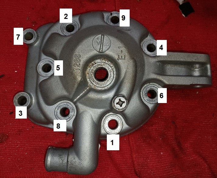

I've been asked many times about how to torque the head...
Below is a picture of the order I use.
But before you get all excited and start twisting wrenches... Get the head and the cylinder mating surfaces flat and clean, clean, clean...
Inspect both surfaces for any defects or cracks...

Re: KX500 HEAD TORQUE SPECS WITH TECH TIPS
Posted: Tue May 24, 2022 8:57 pm
Torque specs:
ft/lb 18
Nm 25
WAIT :o :o :o
Don't start cranking them down.
Look at the torque order below..
Set your torque wrench to 6 ft/lb or 8 Nm and follow the chart.
Now, set your torque wrench to 12 ft/lb or 16 Nm and follow the chart again.
Not done yet... set your torque wrench to 18 ft/lb or 25 Nm and again, follow the chart.
You only wish you were done... leaving the torque wrench set at 18 ft/lb or 25 Nm check them all one more time.
Now you are ready to start your heat cycles.
Before you take your bike on it's maiden voyage, get your torque wrench out again set it at 18 ft/lb or 25 Nm check them all again.
Once you have a full tank of gas through it, check them one last time.
You should be good to go.
