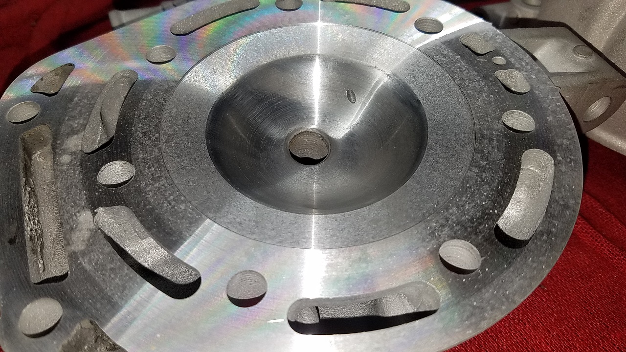

But before you get all excited and start twisting wrenches... Get the head and the cylinder mating surfaces flat and clean, clean, clean...
Inspect both surfaces for any defects or cracks...

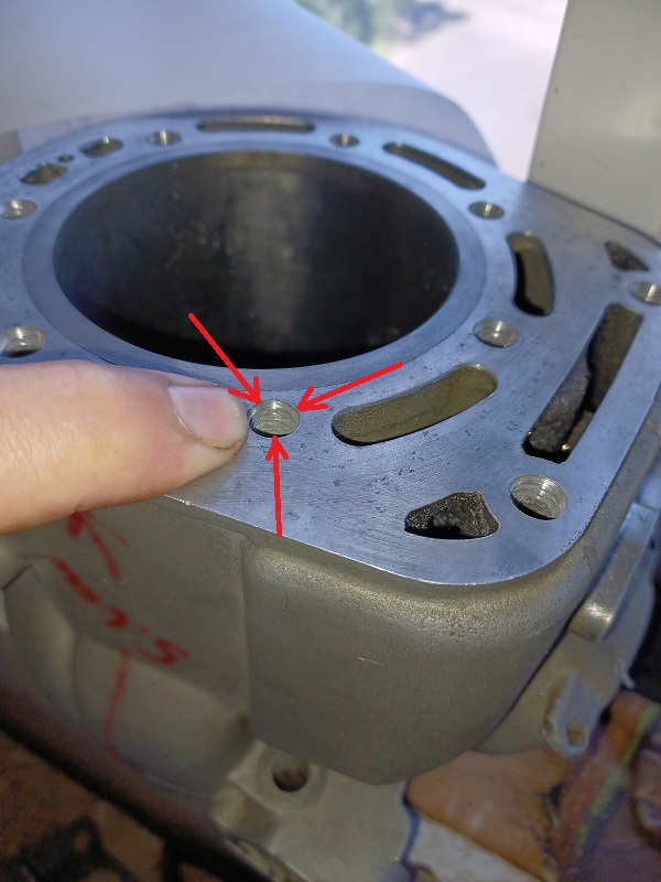

It's hard to see in the above pictures but the stud holes have all been chamfered.
Even though the cylinder was decked the area touching the stud has a tendency to pull slightly upward and can cause the gasket not to seal.
Just a slight bit of chamfer will prevent that from happening.
