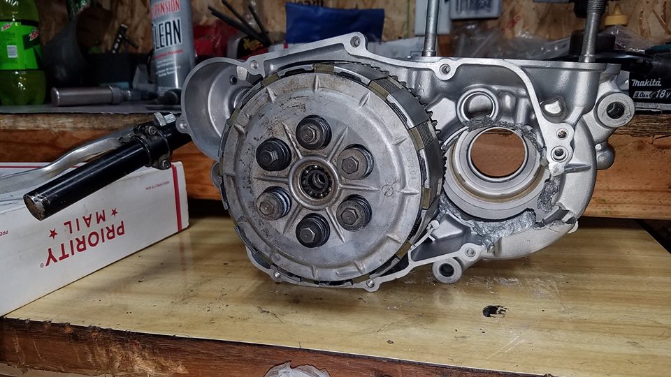

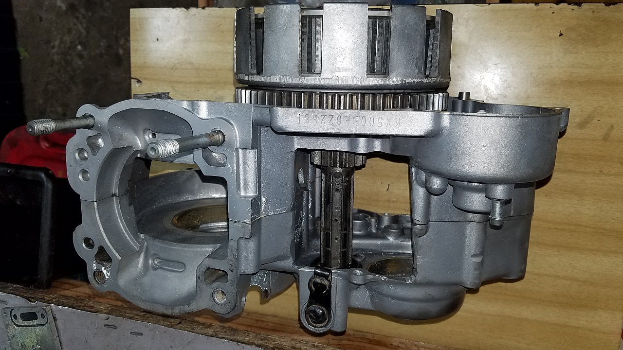

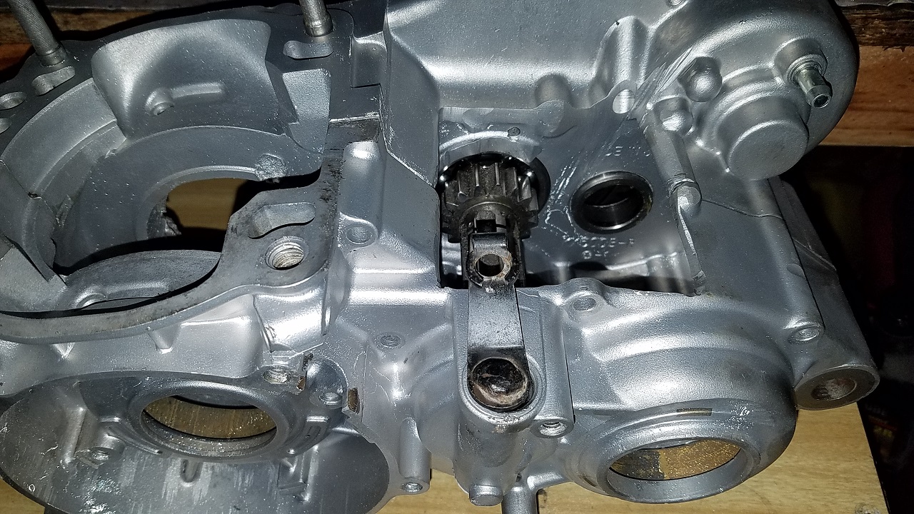

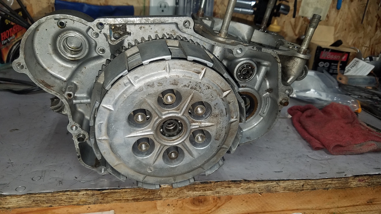

What I need is a very accurate test fixture..
So, I grabbed my best engine cases and set about gettin it done :lol:
JT ENGINE WORKS AND KX GURU RACING KX500 CLUTCH PULL MADE EASIER 101.jpg (465.11 KiB) Viewed 13227 times
Hello MR. Sawsall
JT ENGINE WORKS AND KX GURU RACING KX500 CLUTCH PULL MADE EASIER 102.jpg (493.67 KiB) Viewed 13227 times
JT ENGINE WORKS AND KX GURU RACING KX500 CLUTCH PULL MADE EASIER 103.jpg (415.39 KiB) Viewed 13227 times
JT ENGINE WORKS AND KX GURU RACING KX500 CLUTCH PULL MADE EASIER 104.jpg (411.59 KiB) Viewed 13227 times

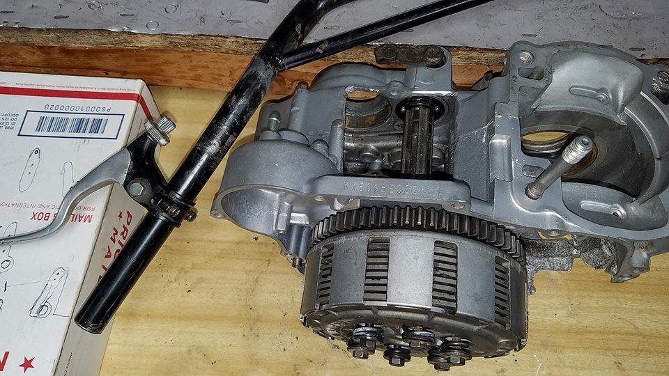

Re: KX500 HEAVY CLUTCH PULL, WHAT CAN BE DONE
Posted: Thu Oct 11, 2018 10:24 pm
JT ENGINE WORKS AND KX GURU RACING KX500 CLUTCH PULL MADE EASIER 105.jpg (370.34 KiB) Viewed 13226 times

Well... let's get rid of that pesky casing that covers the bottom bearing.
This will help later on during testing... 8-)
