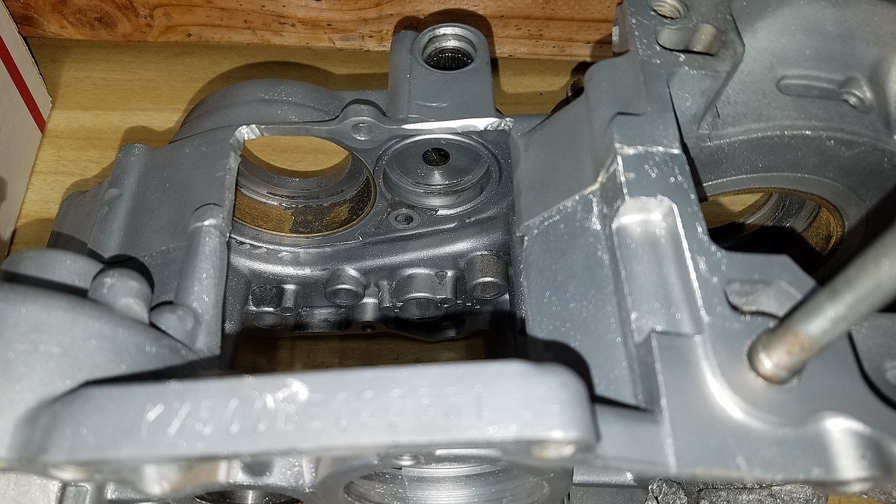

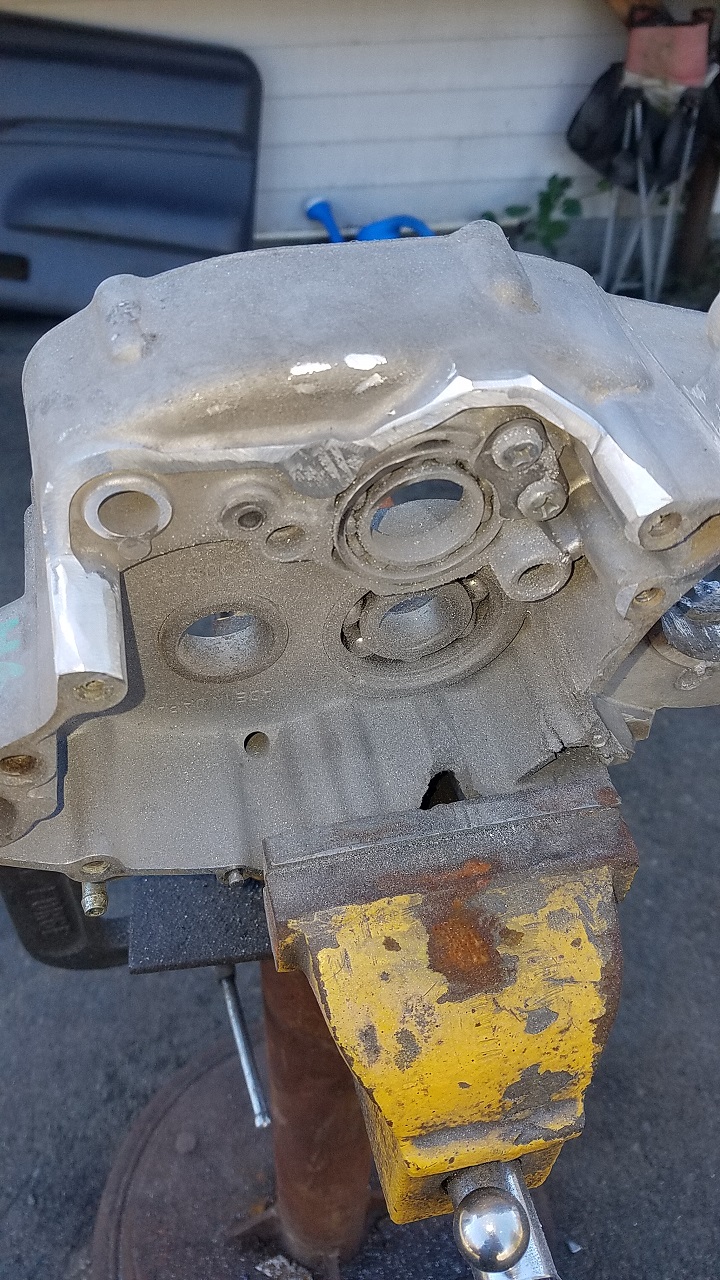

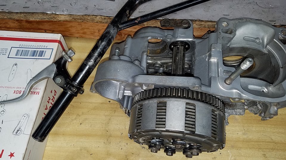

What I need is a very accurate test fixture..
So, I grabbed my best engine cases and set about gettin it done :lol:
JT ENGINE WORKS AND KX GURU RACING KX500 CLUTCH PULL MADE EASIER 101.jpg (465.11 KiB) Viewed 13067 times

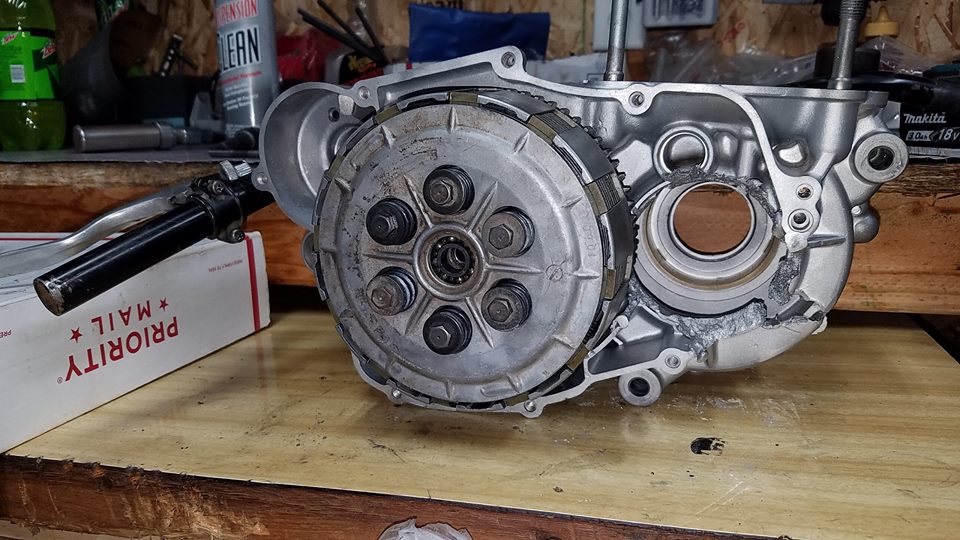

Hello MR. Sawsall
JT ENGINE WORKS AND KX GURU RACING KX500 CLUTCH PULL MADE EASIER 102.jpg (493.67 KiB) Viewed 13067 times

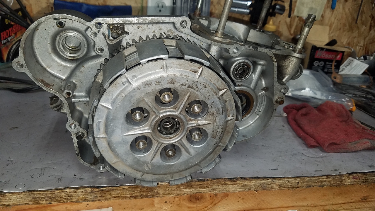

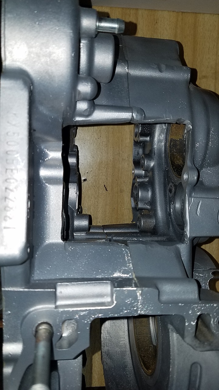

JT ENGINE WORKS AND KX GURU RACING KX500 CLUTCH PULL MADE EASIER 103.jpg (415.39 KiB) Viewed 13067 times

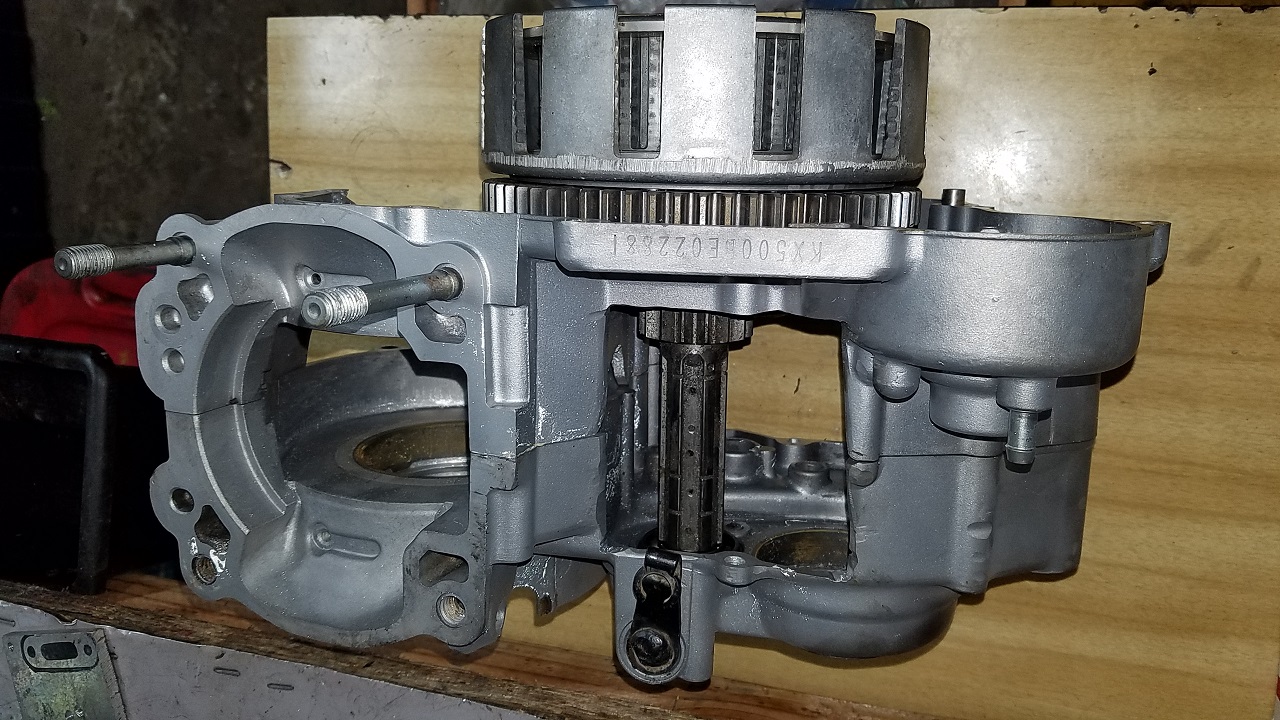

JT ENGINE WORKS AND KX GURU RACING KX500 CLUTCH PULL MADE EASIER 104.jpg (411.59 KiB) Viewed 13067 times

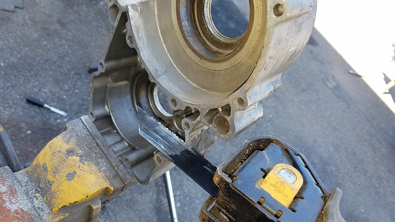

JT ENGINE WORKS AND KX GURU RACING KX500 CLUTCH PULL MADE EASIER 105.jpg (370.34 KiB) Viewed 13066 times

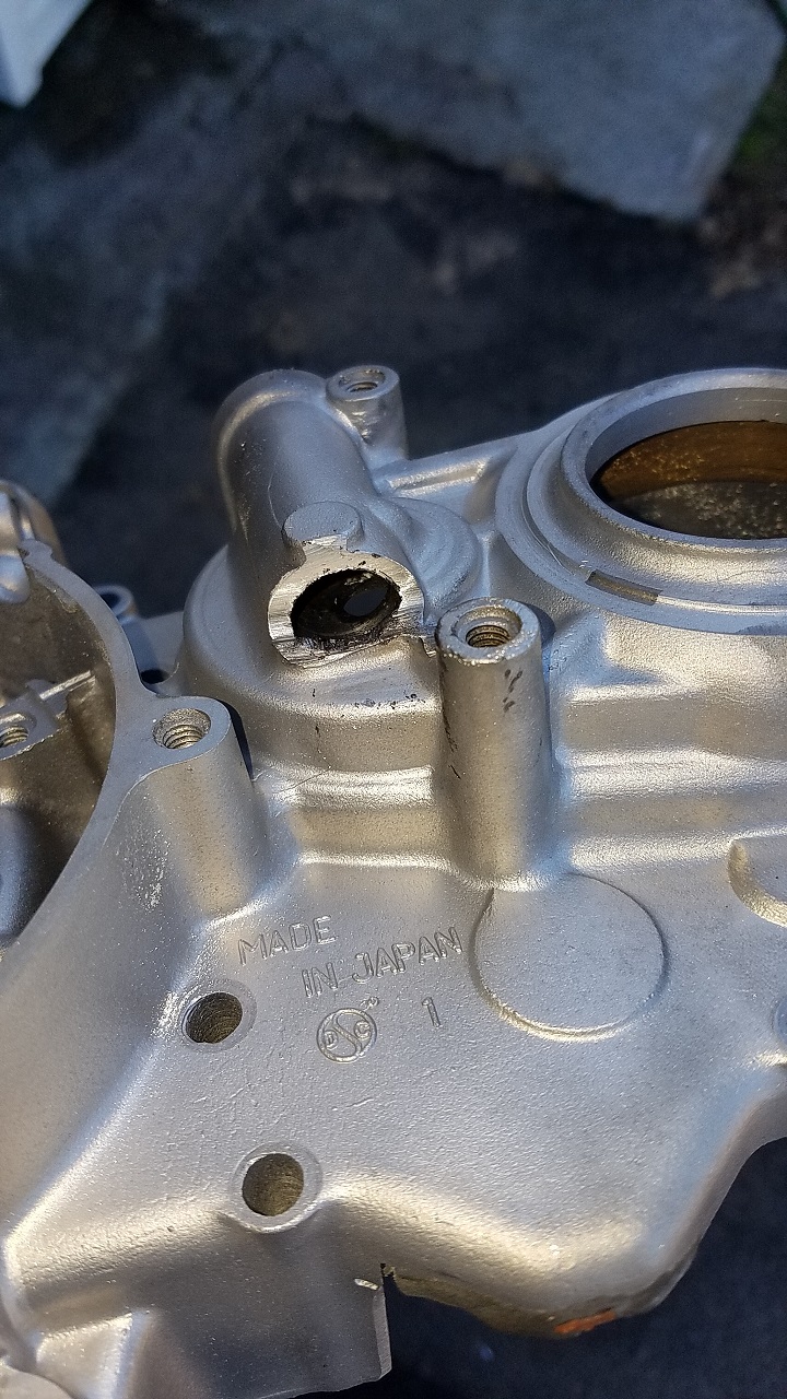

JT ENGINE WORKS AND KX GURU RACING KX500 CLUTCH PULL MADE EASIER 106.jpg (342.54 KiB) Viewed 13066 times
JT ENGINE WORKS AND KX GURU RACING KX500 CLUTCH PULL MADE EASIER 107.jpg (414.76 KiB) Viewed 13066 times

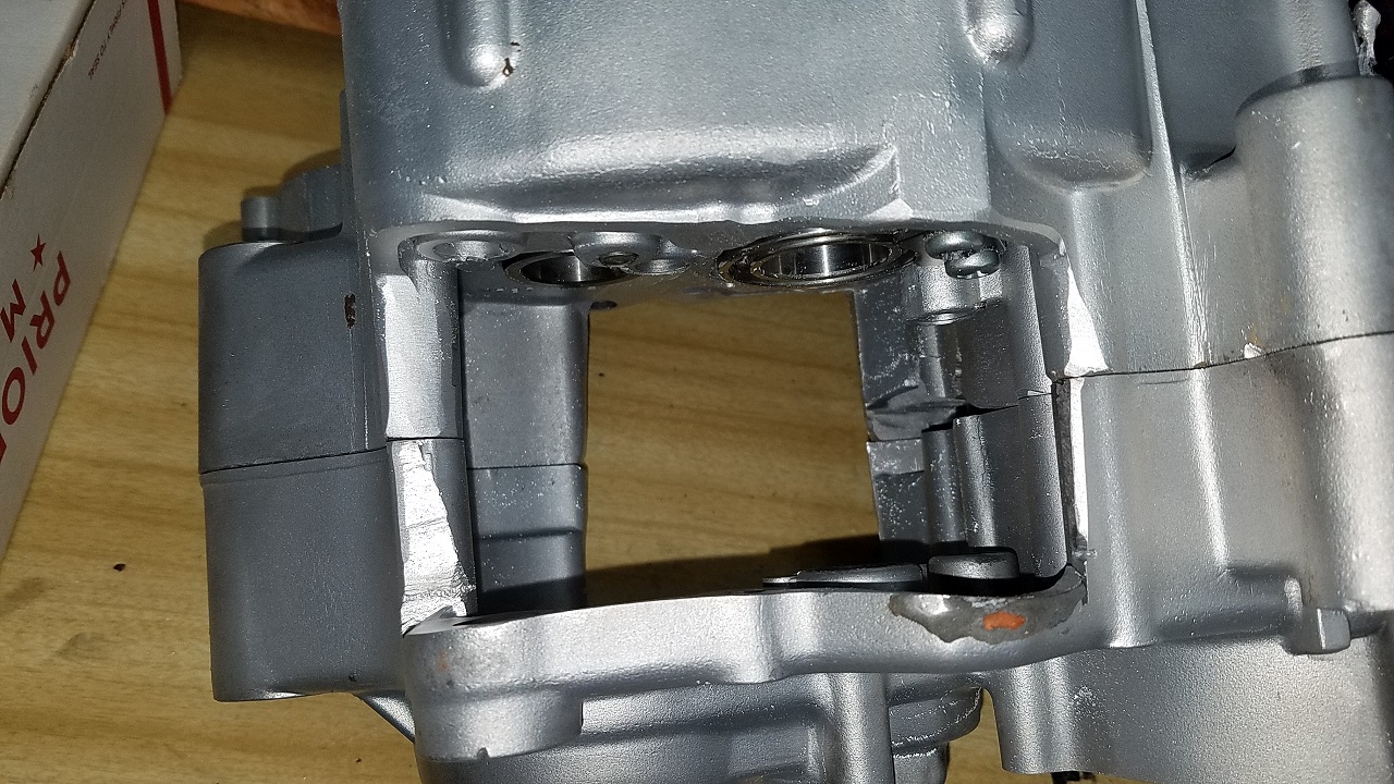

Well... let's get rid of that pesky casing that covers the bottom bearing.
This will help later on during testing... 8-)
JT ENGINE WORKS AND KX GURU RACING KX500 CLUTCH PULL MADE EASIER 108.jpg (394.68 KiB) Viewed 13066 times

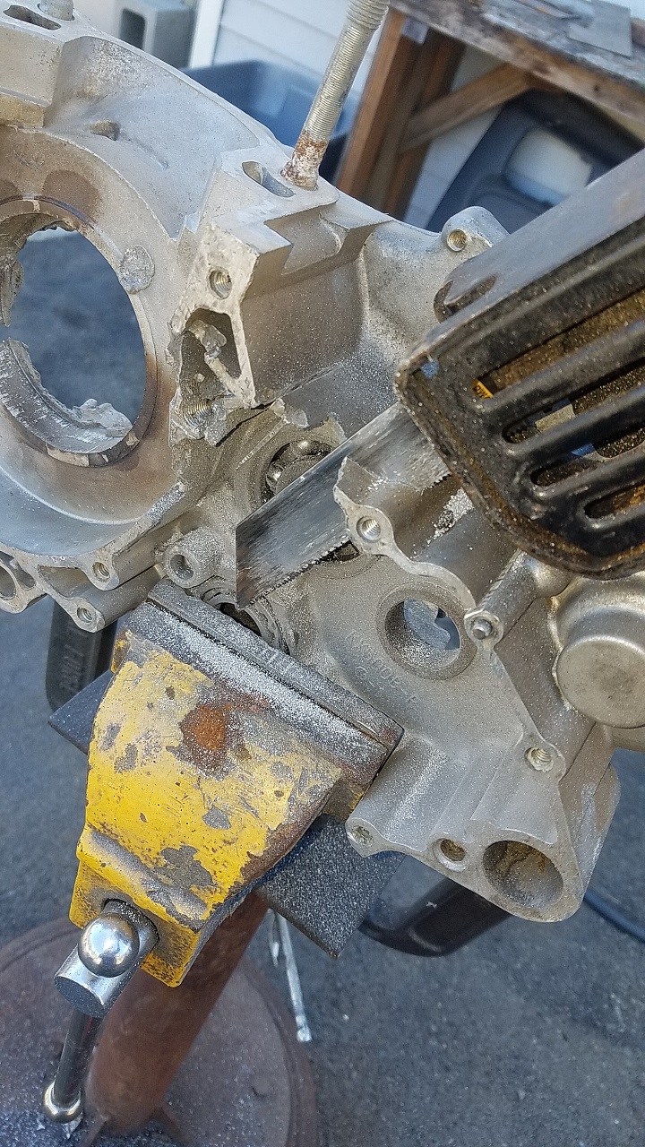

Re: KX500 HEAVY CLUTCH PULL, WHAT CAN BE DONE

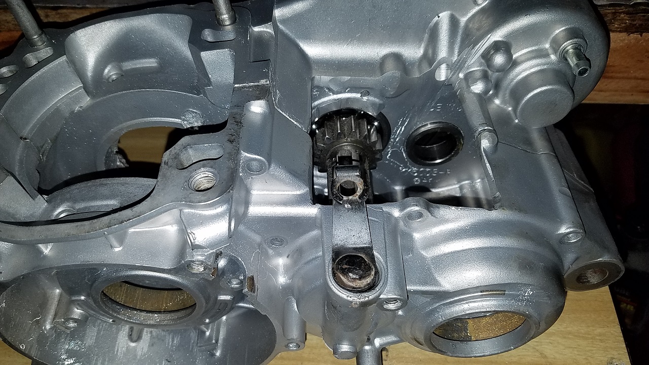

Something like this....
JT ENGINE WORKS AND KX GURU RACING KX500 CLUTCH PULL MADE EASIER 109.jpg (383.21 KiB) Viewed 13064 times
JT ENGINE WORKS AND KX GURU RACING KX500 CLUTCH PULL MADE EASIER 110.jpg (444.13 KiB) Viewed 13064 times
