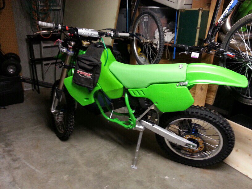

Every KX500 needs a battery box...

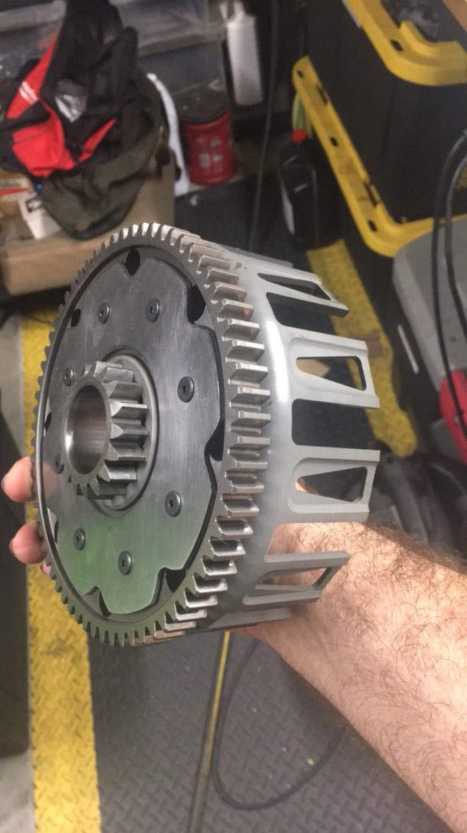

Mitaka billet replacement clutch basket

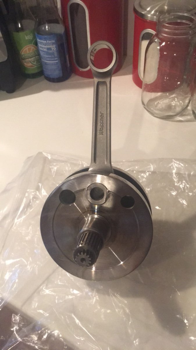

Balanced crank with a Wossner rod

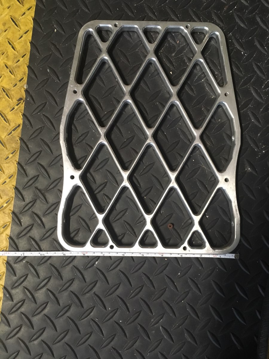

Yes... these should add some comfort..

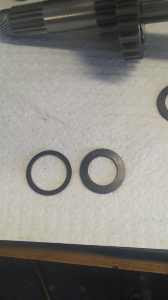

Custom shims for the 5th gear overdrive

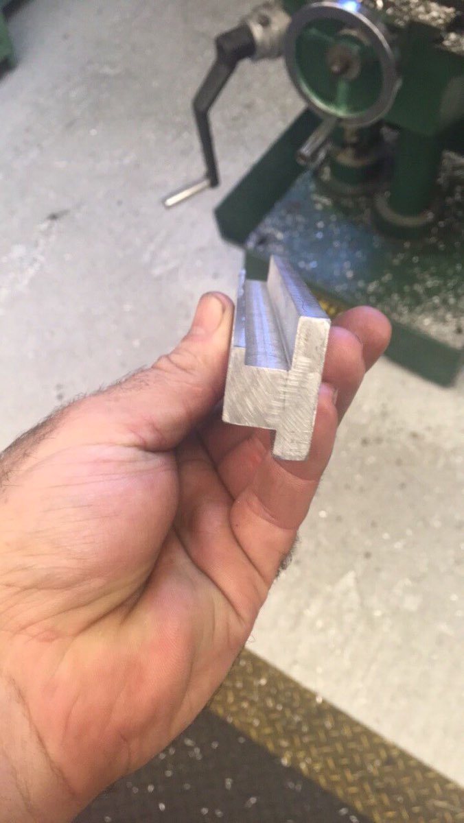

Swing arm conversion to run a KX450F rear brake caliper and brake rotor..
Oversized rotors are good on the street...

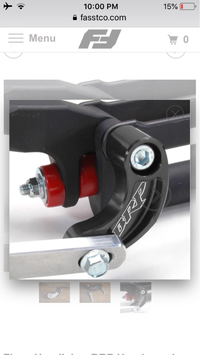

Relocating and changing the style of the caliper hanger.
You will also need to enlarge the slots for the larger rear axle.

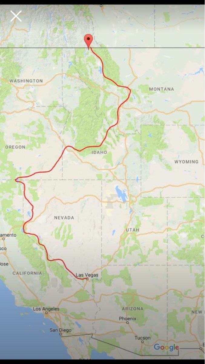

Oh... You wanna see their route???
Not far from my place... I'll be following closely..
Who knows, maybe I'll meet up somewhere along the way...
