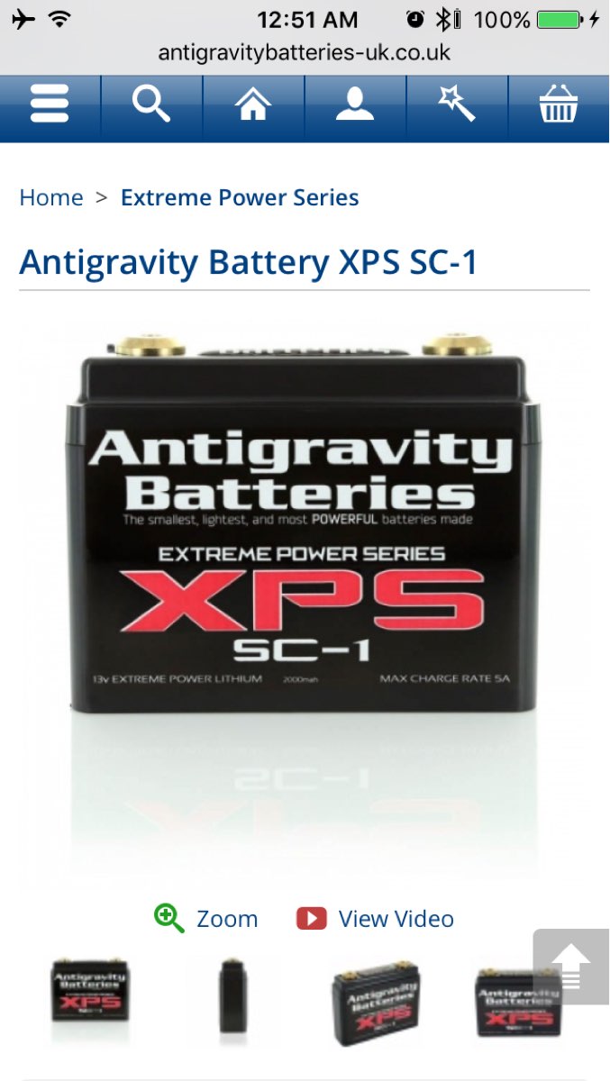

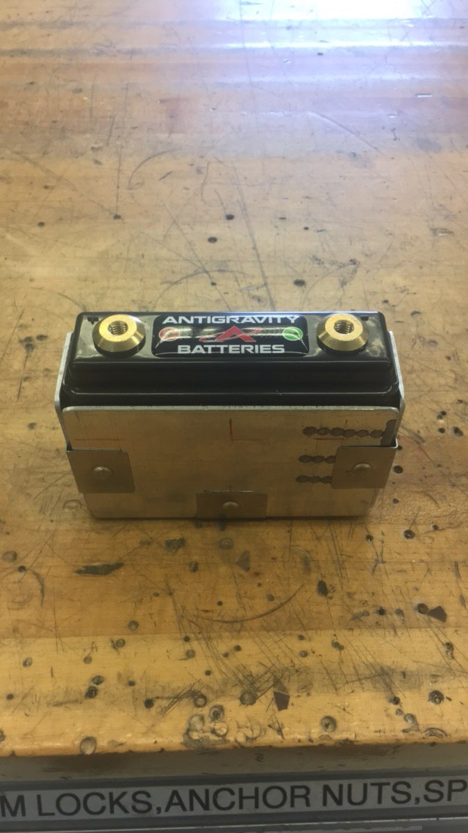

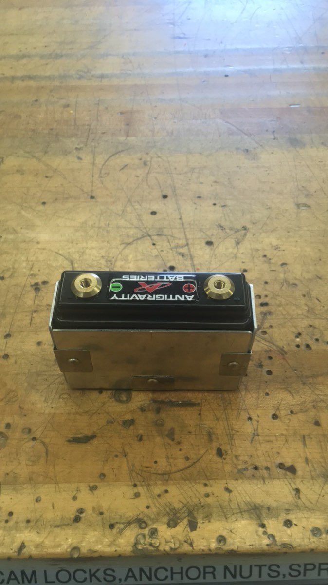

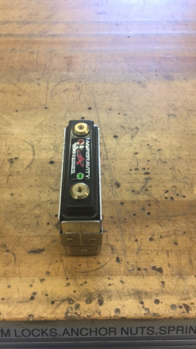

Every KX500 needs a battery box...

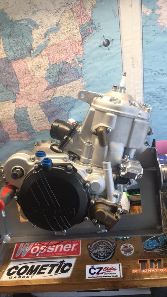

Mitaka billet replacement clutch basket
Balanced crank with a Wossner rod

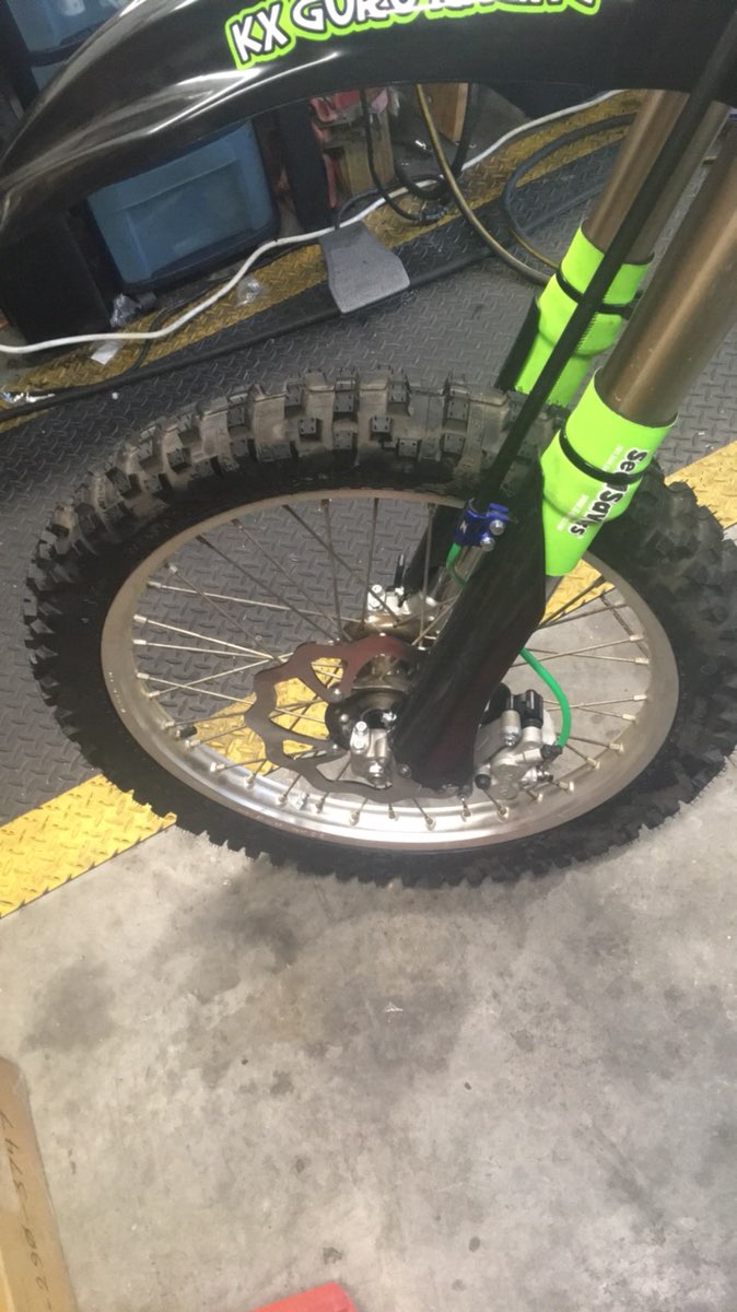

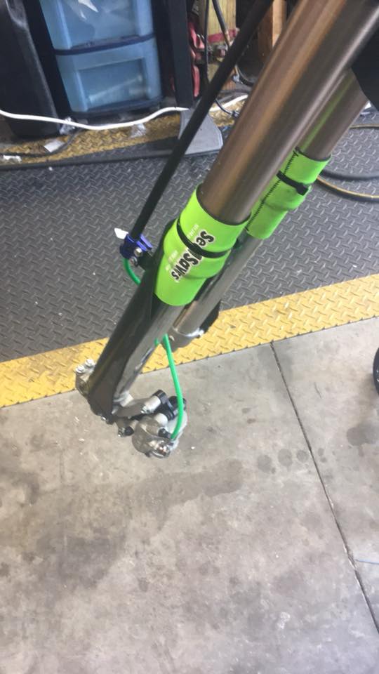

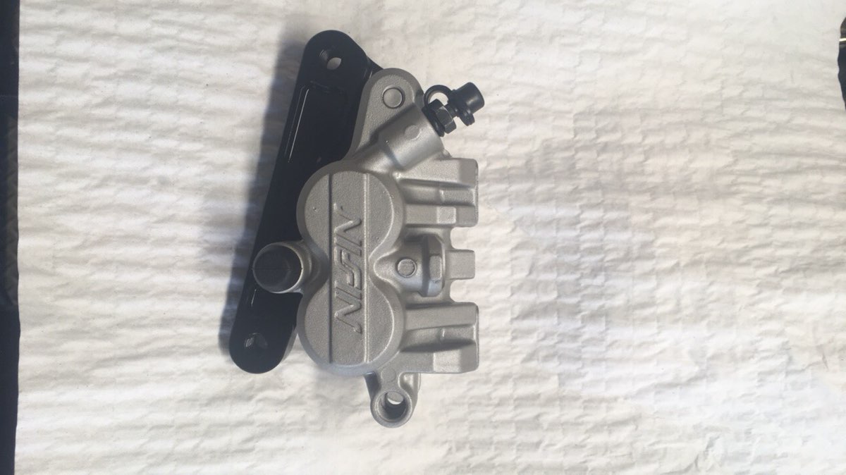

Fully rebuild front brake caliper that has been Cerakoted..

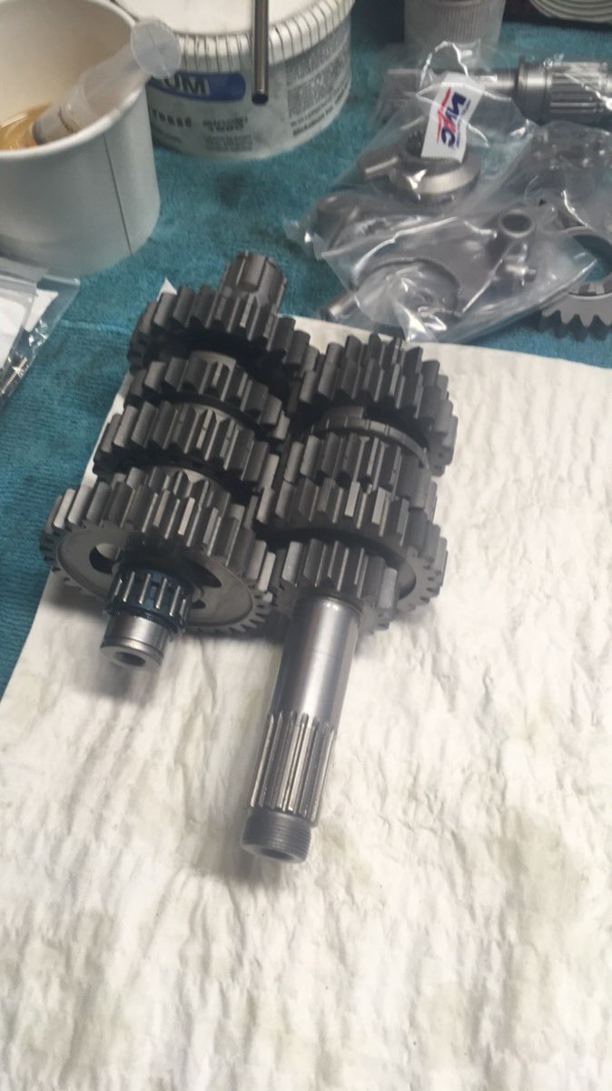

WPC treated trans with Overdrive 5th gear.

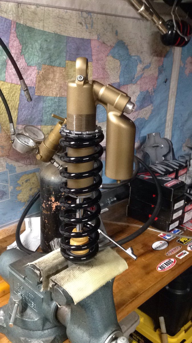

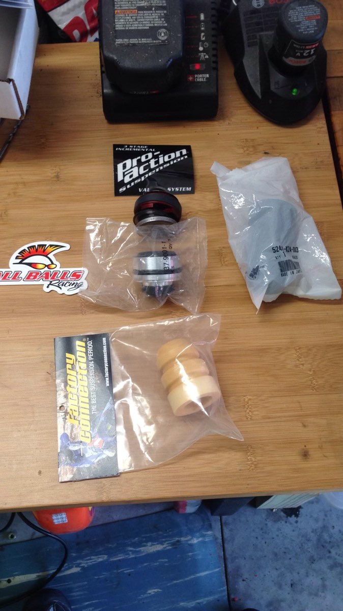

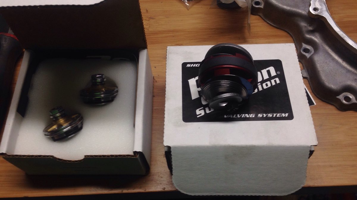

Various goodies for the front end including Pro Action valving....

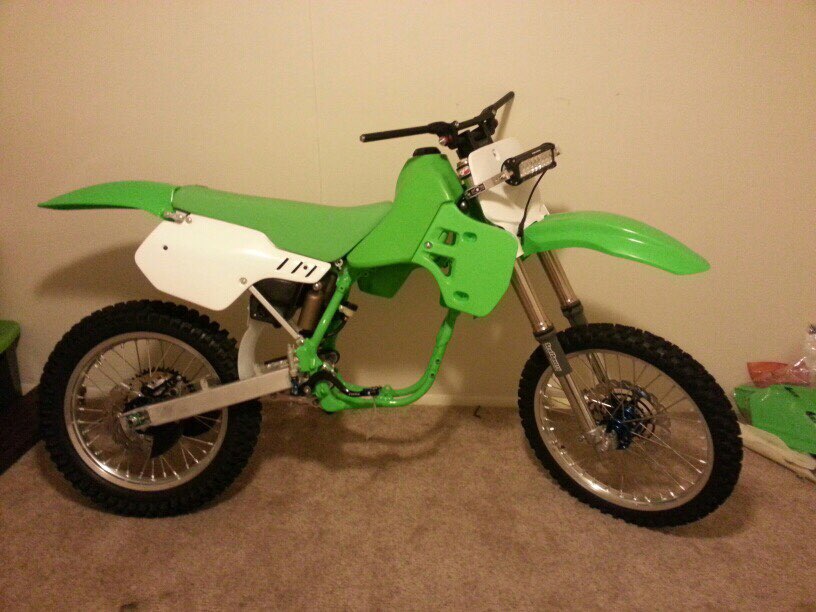

Humble beginnings...
And other humble beginnings... Remember, Alex is prepping two bikes.
Hmmm... Looks like a plan to me.
Rackem..

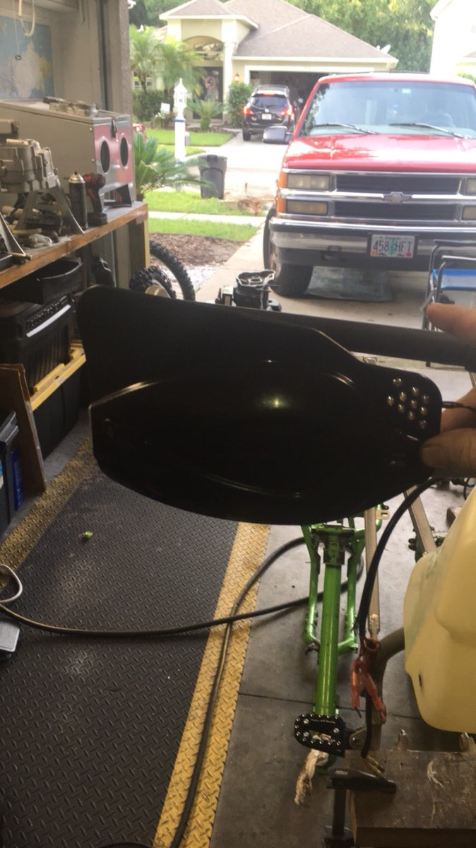

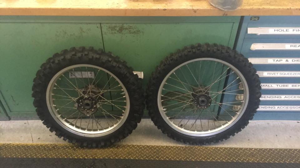

Yes... these should add some comfort..

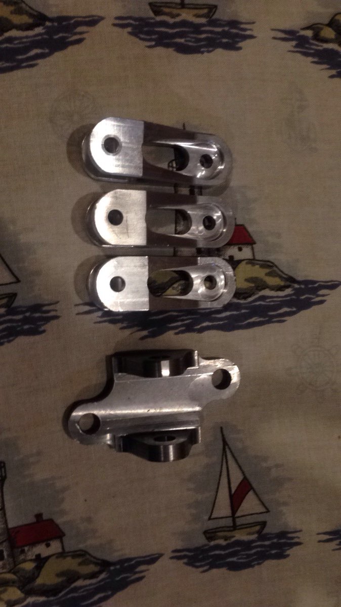

Custom shims for the 5th gear overdrive

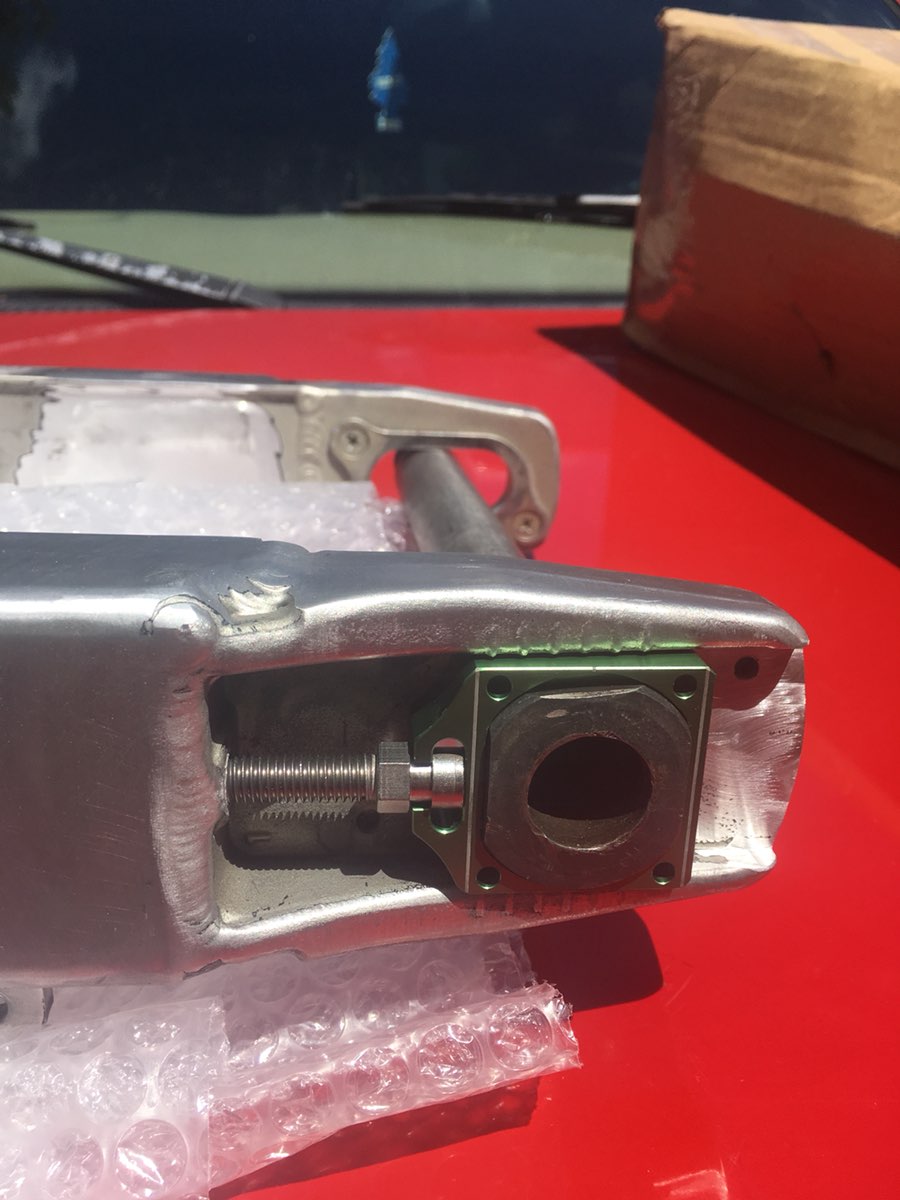

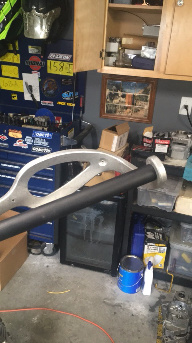

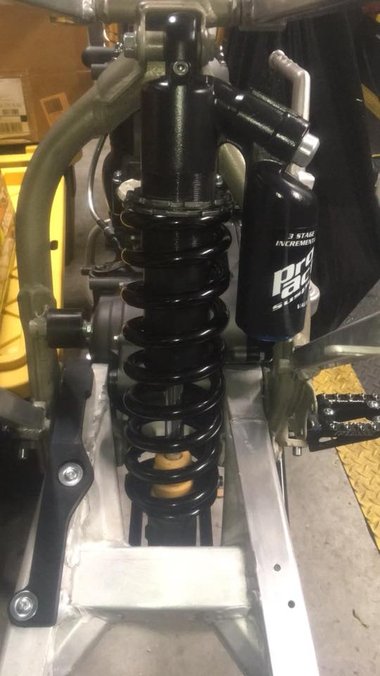

Swing arm conversion to run a KX450F rear brake caliper and brake rotor..
Oversized rotors are good on the street...

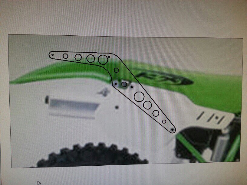

Relocating and changing the style of the caliper hanger.
You will also need to enlarge the slots for the larger rear axle.

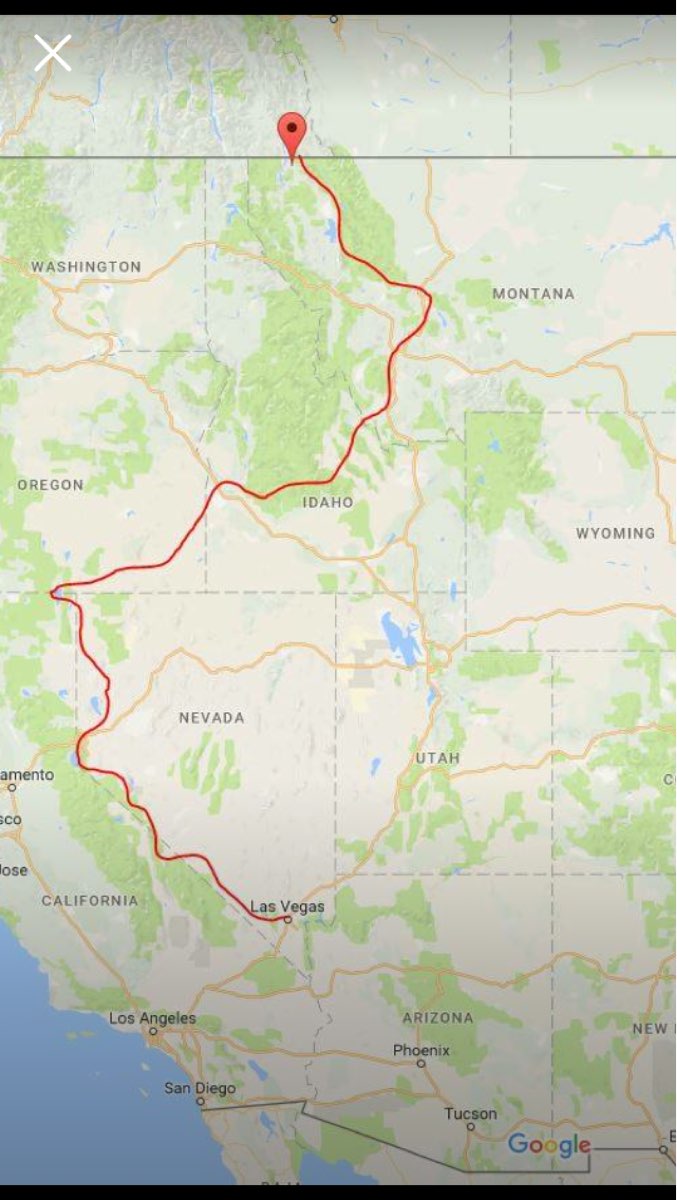

Oh... You wanna see their route???
Not far from my place... I'll be following closely..
Who knows, maybe I'll meet up somewhere along the way...

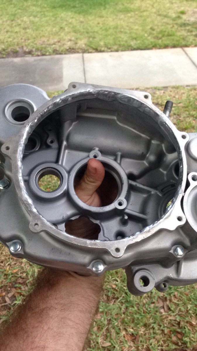

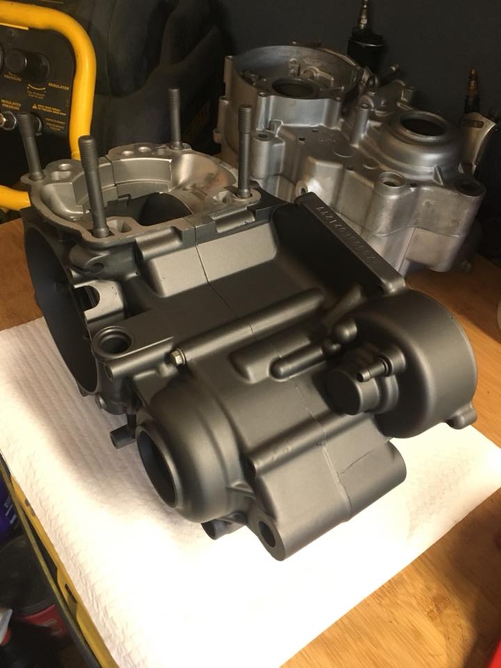

Misc items for discussion... But I'm pooped out so just look at the pics and be happy...

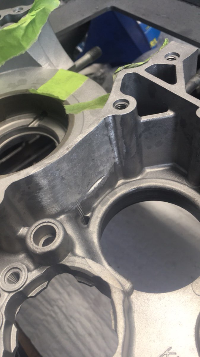

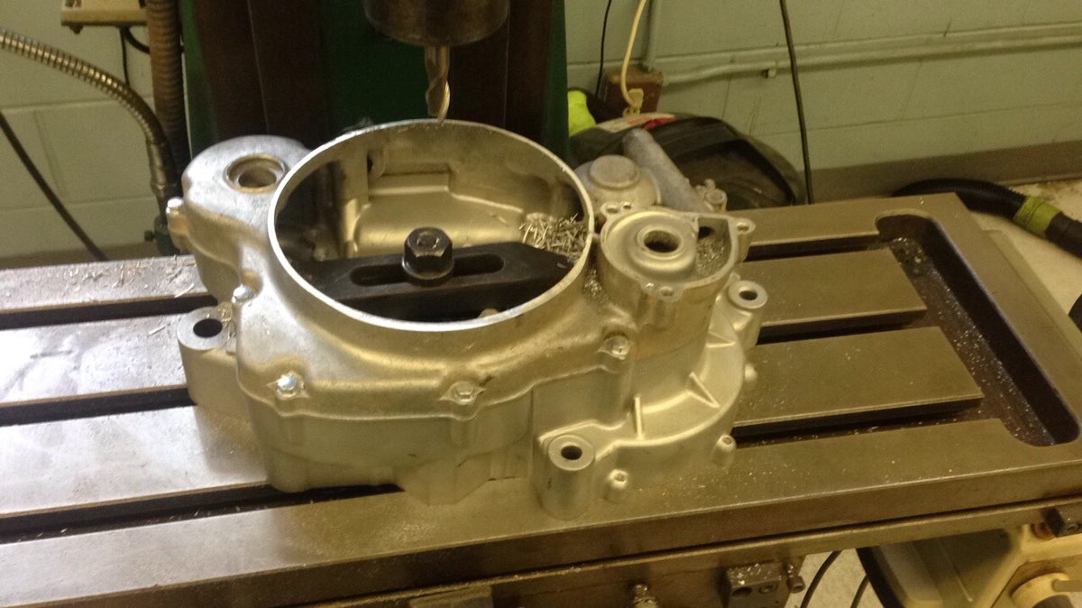

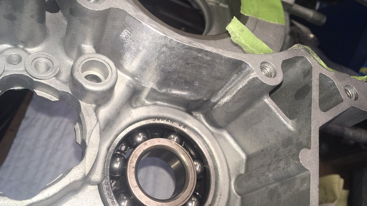

I'll give you a hint on the engine cases... The Overdrive 5th needs a bit of extra clearance...

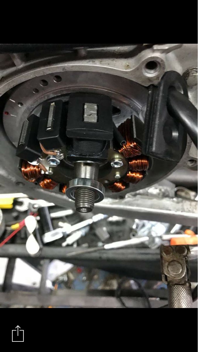

Need power? Get one...
Power Dynamo power... 100 watts of juice so Alex can have his seat warmer :lol:

Two piece clutch cover is just about done..
Just needs to test fit and grind a little from the ID.

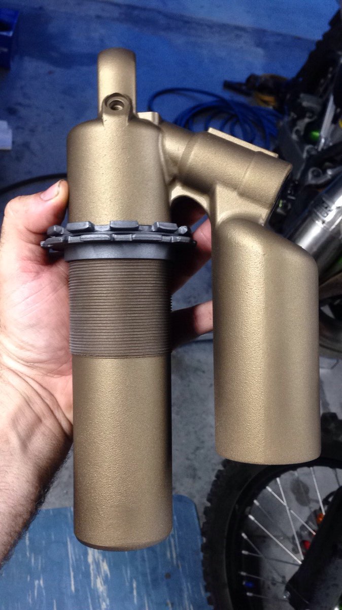

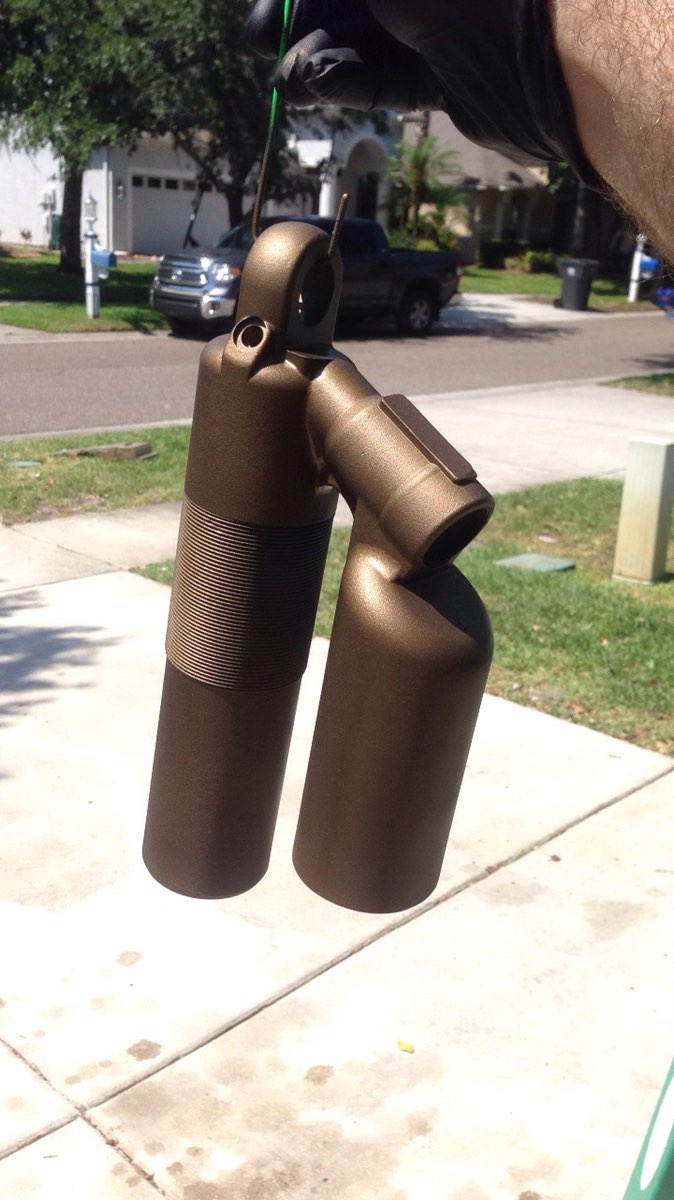

More goodies came in..
Cerakote, Burnt Bronze
