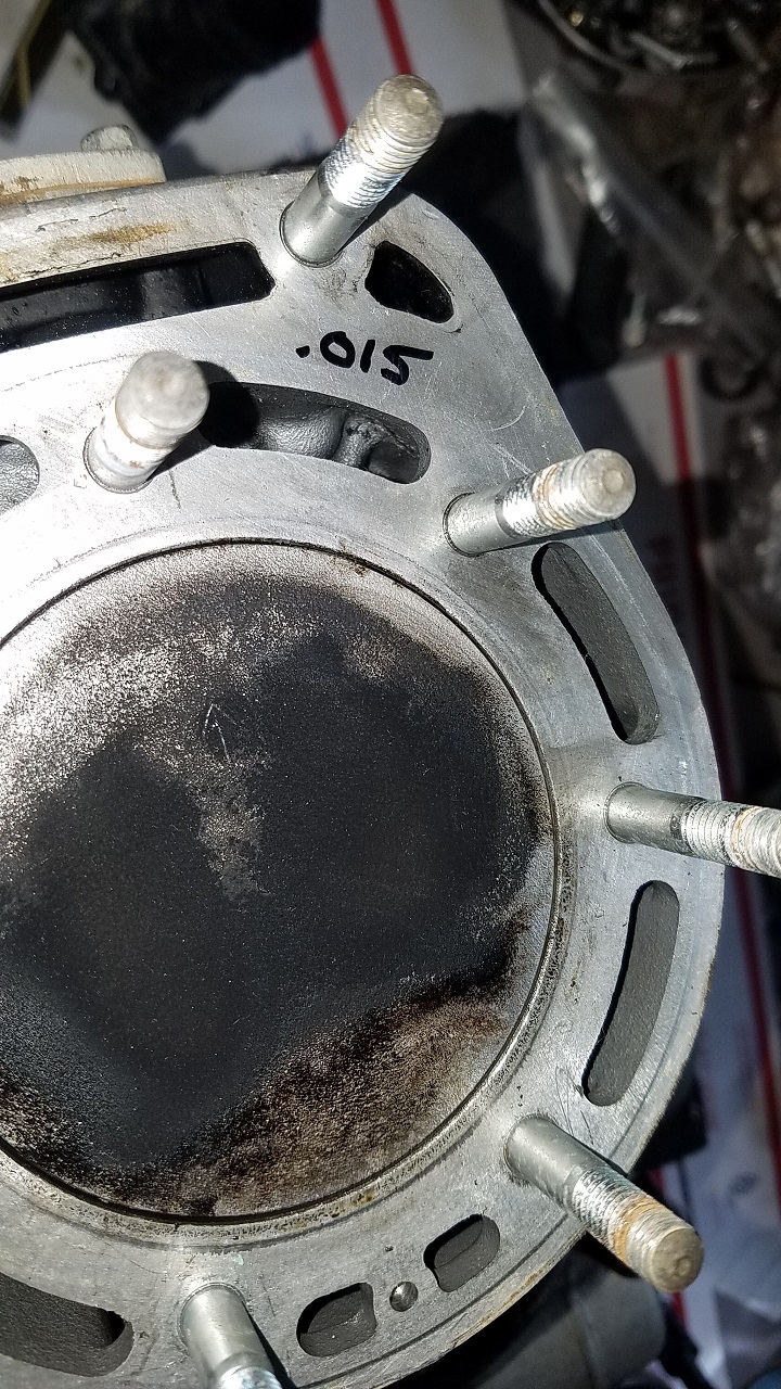

The next step is to pop the head and measure the port timing.
Sunny Garcia KX Guru Racing build 102.jpg (326.19 KiB) Viewed 15963 times
And of course measure and record the head step, overall thickness, gasket thicknesses, ect.
Sunny Garcia KX Guru Racing build 103.jpg (474.01 KiB) Viewed 15963 times
