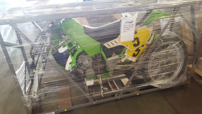

Oscar Picked up the bike today :o
PRO SURFER SUNNY GARCIA KX GURU RACING KX500 101.jpg (204.17 KiB) Viewed 16180 times
PRO SURFER SUNNY GARCIA KX GURU RACING KX500 102.jpg (186.04 KiB) Viewed 16180 times
Re: Sunny Garcia Pro surfer KX Guru Racing KX500 build
The story is the bike sat for years in storage.
I believe it, this thing is clean!!

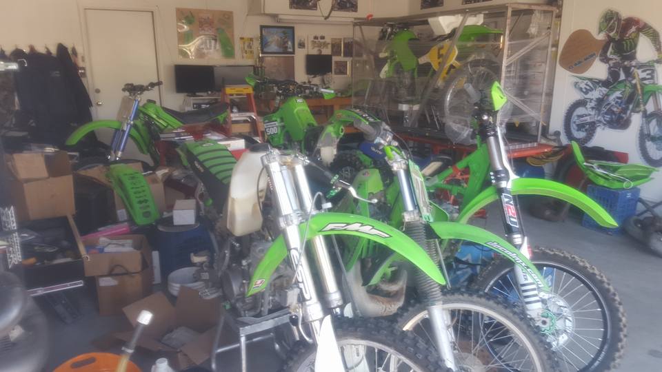

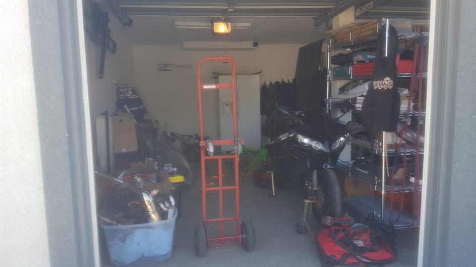

Oscar is getting ready to make room so he can get ready to get more bikes in his garage :lol:
PRO SURFER SUNNY GARCIA KX GURU RACING KX500 106.jpg (55.09 KiB) Viewed 16161 times
PRO SURFER SUNNY GARCIA KX GURU RACING KX500 107.jpg (41.23 KiB) Viewed 16161 times
PRO SURFER SUNNY GARCIA KX GURU RACING KX500 108.jpg (68.6 KiB) Viewed 16161 times

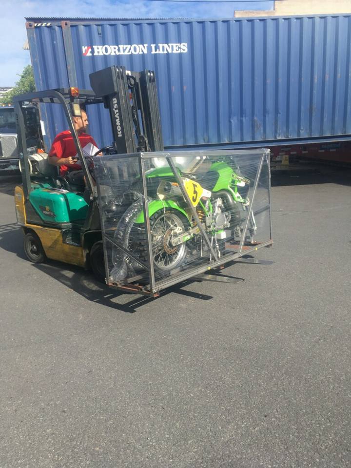

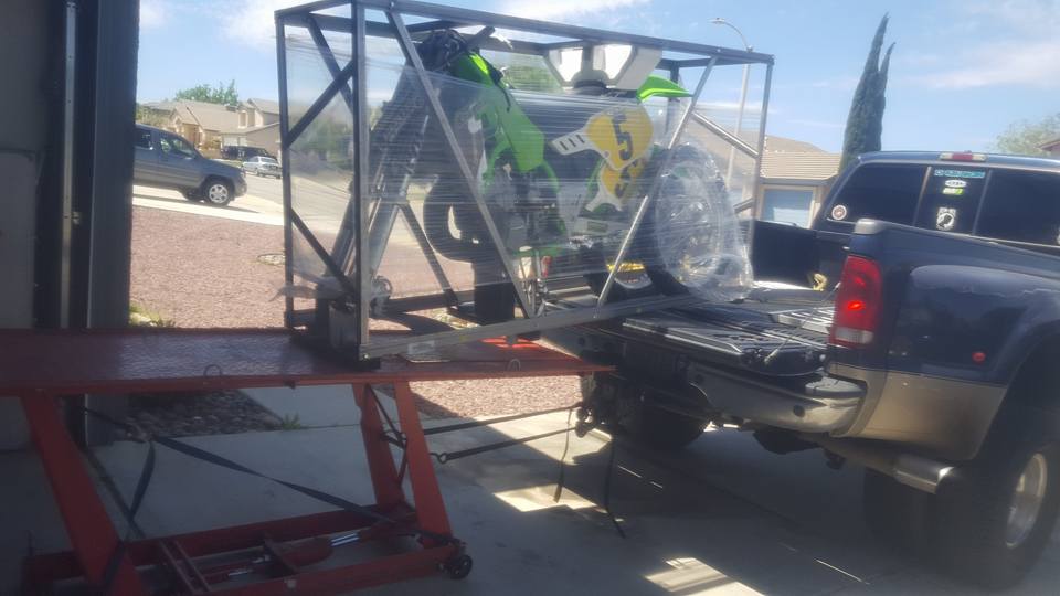

Sunny showed up for a visit at Oscar's garage this morning.
This is what Oscar said, "Got to spend 3 hours this morning shooting the breeze with Surfing legend Sunny Garcia! Super cool easy going dude!! Discussed everything from food to bikes!! We have some amazing ideas on the direction we will be taking with the Hawaiian Beast build!!"

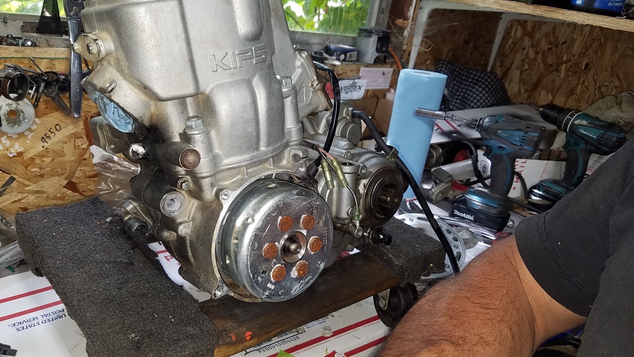

Ok... We got the engine in from Oscar and Jason and I started right in on it.
From the outside it looks about right for the age..

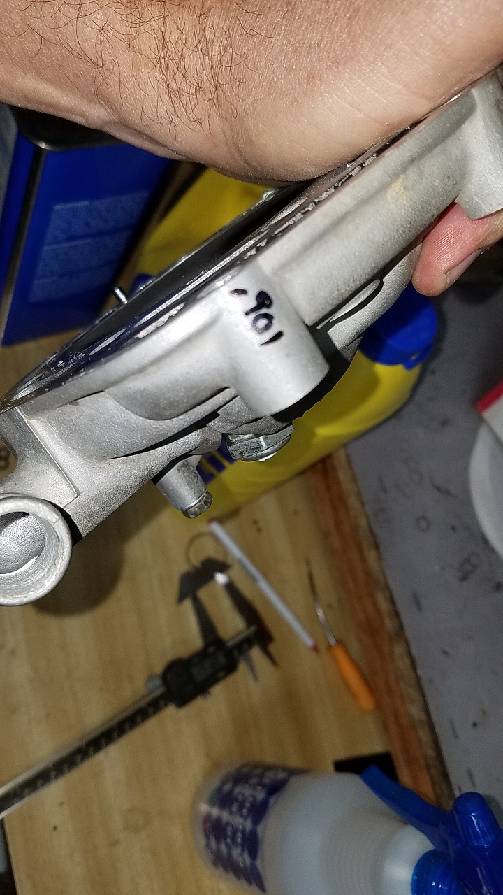

The next step is to pop the head and measure the port timing.

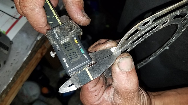

And of course measure and record the head step, overall thickness, gasket thicknesses, ect.
Sunny Garcia KX Guru Racing build 103.jpg (474.01 KiB) Viewed 15947 times

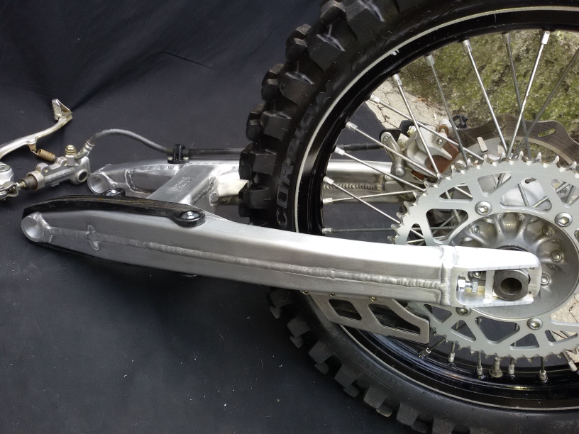

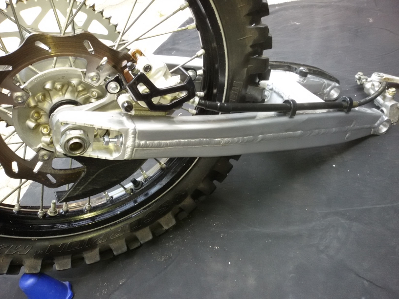

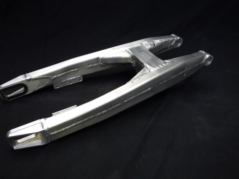

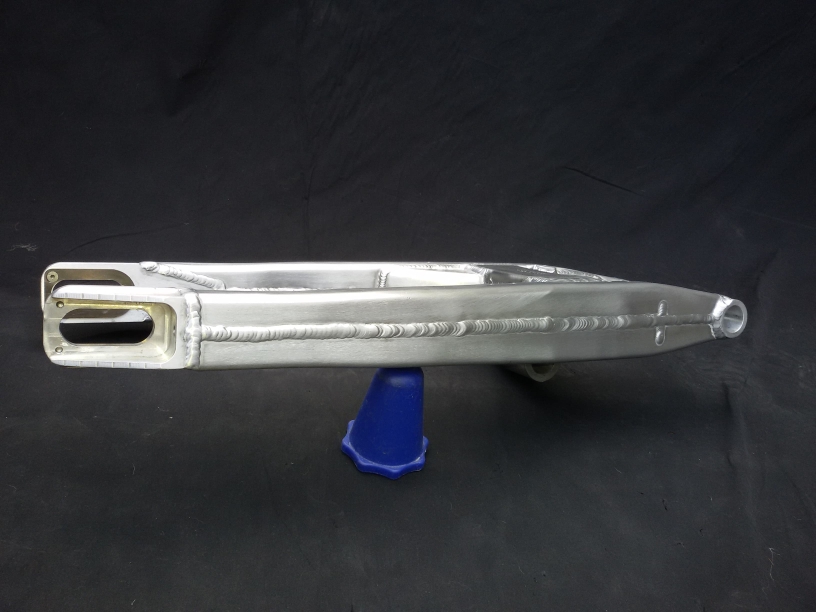

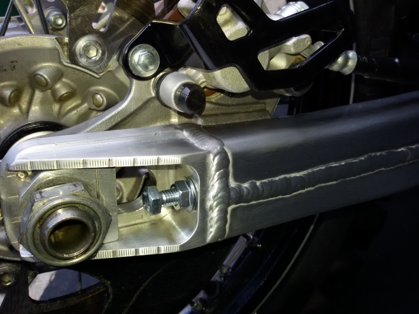

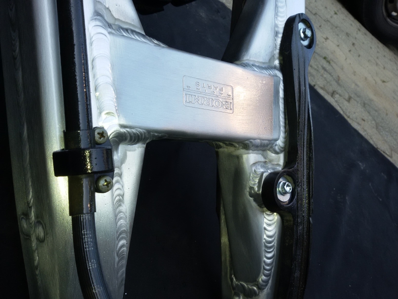

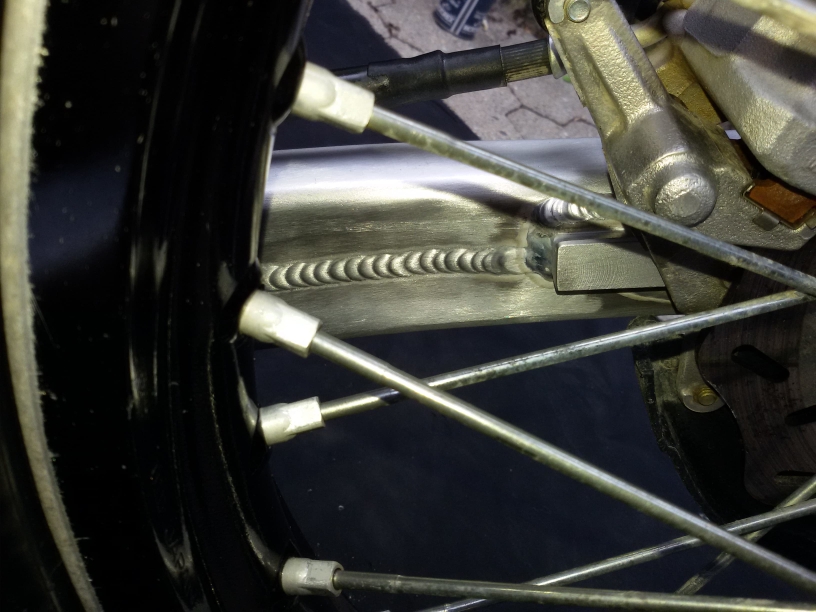

More Sunny Garcia hardware...
How about a Bormi Parts KX500 swingarm ready for a 450 rear wheel and brake set up 8-)
