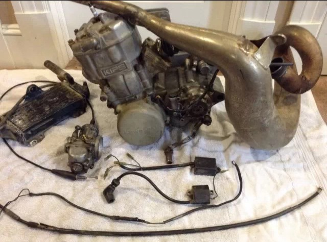

You will need the following list of stuff to convert your bike to a 500.
Donor 250 - Sell the motor, electronics, pipe, and silencer
500 motor, electronics, pipe
Service Honda conversion pipe (search on eBay) OR
KX 500 pipe, CR 500 Pipe to splice together
CR 500 silencer from a later model bike (2000s)
If you using a 2003 KX 250, you will need a 2004-2007 airbox (more on that later)
KDX 250 intake boot. It fits the 500 bolt pattern and turns the carb to go around the shock
Later model (89 and up) KX 500 airboot and airbox internals
1993-1998 KX 125 Carb top. It allows the cable to bend and fit under the tank
1993-1998 KX 125 throttle cable
KX500 clutch cable
One set of swingarm bearings - you will be cutting the swingarm, and the old bearings will get full of debris
Metal to make the front motor mounts
aluminum to put on the airbox and mount your filter

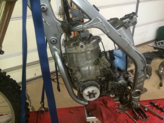

Step Four - cut the front motor mounts and head stay off
In order to fit the engine in the frame, you will need to cut off the front motor mounts and fabricate new ones. You will also need to cut the head stay mount loose from the frame. It will need to be centered in the frame (it is offset to the left side of the bike from the factory) for gas tank clearance. Be careful when cutting and don't nick the frame. It is better to leave a part of the motor mount on the frame and grind it off, than weakening the frame.

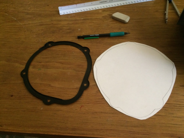

I fabricated my motor mounts like Kawasaki did: in two parts that meet at the motor. In fact I made cardboard templates based off the stock motor mounts that I cut off. I attached a picture below.
The head stay is pretty simple. Just straighten the 250 head stay aluminum brackets and tighten them to the head. Straightening the head stays brackets will center them in the frame. Measure how far it is back to the frame and cut your head stay frame piece that you removed earlier to that length. Weld it all around and you're good to go.

Step 5 - put the motor in the frame and modify the swingarm
Once you have cut the front motor mounts and head stay off, you can fit the motor to the chassis. Be aware that some years of K5 use smaller motor mount bolts than the 250, so you may have to use the 500 bolts or head to your local Fastenal to get the motor secured. The bottom motor mount and the swingarm pivot will locate the motor in the chassis, allowing you to measure and cut the swingarm to fit the more narrow opening. You should have to remove material equally from each side of the swingarm in order for it to fit. Remove the races from the swingarm before you cut, as they are hardened and will not cut with a normal bandsaw blade. You will trash the installed bearings, but you already purchased a new set of races and bearings that you can use once you have the swingarm adjusted to fit. Remember that you will need a little extra room for the lip of the race, so measure the race thickness before you start cutting. I cut my swingarm on a bandsaw a little large, and then slowly adjusted with a belt sander. Remember you will need to cut the races down as well so that they fit in the narrower opening. I wrapped mine in tape until the tape was level with the lip of the race so I could cut it with my carbide cut off saw. Once you get the swingarm fitting, cut your new races and install the new bearings. You're getting closer.
As we talked about in Step 4, now is a good time to fab your mounts and weld them up. You will need to do a little more welding, but the mounts are the major part.

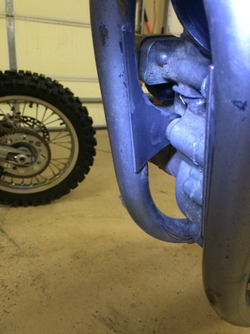

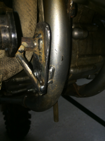

Step 8 - Pipe
Of all the steps, this one is the most difficult or simple. It's simple if you can purchase a Service Honda (no longer being made, but available on eBay), DynoPort, or any other pipe made for conversions. They are bit more expensive, but may be a break even when you consider the price of buying multiple pipes to craft together, welding time, frustration, years off your life, etc. If for some reason we are in an apocalyptic future where these pipes are no longer available, then your only option is combining a KX 500 pipe with a CR 500 pipe. This sounds simple, but be aware that the CR pipe hugs very tightly to the KX engine and will need lots of hammer adjustments to make it fit. Be prepared to do mean things to your pipe. Your main area of interference is the coolant transfer from the water pump to the cylinder head. You will need to dent the pipe pretty heavily in this area. I have seen people use a trick Service Honda employed where they flip the fitting and use a special hose to come in from the top. You will need to do search of the site to find this trick.
When you get your pipe finished, do yourself a favor and spend some time on the mounting bracket. It will need to be beefy to handle all the vibration. While you have the motor apart or the electronics safely out of the motor, you have the opportunity to weld on some beef to the mount. It doesn't need to support a tank's weight, but it does need to be beefier than the 250 mount. You don't want your pipe coming off. I used some 3/16" plate and a solid rod that I threaded to accept the 03 250 half rubber mount. So far my pipe is still on.
My pipe was a KX 500 inlet, and parts from a trashed CR pipe and a good CR pipe. I used the trashed CR pipe to add material to push the pipe out near the interference areas (ignition cover, transfer pipe). I added about 1 1/2" in the front bottom, and a 1 1/2" to 1/2" wedge in the front right above the engine exhaust port (the thickest part faced mostly forward). The wedge turned the pipe out a little bit as it came around, giving me a little more space in the transfer pipe area. Even with all that I still had to dent my pipe. This is a trial and error part, and will require some decent fabrication skills. Did I mention that people make pipes for this conversion?

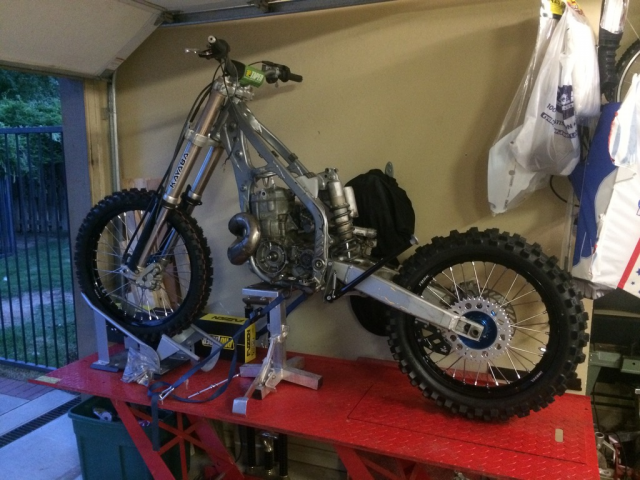

Now you are really close to getting finished. All you need is the gas tank and you are ready to ride this beast. In step four, we talked about centering the head stay in the chassis. This step is critical in fitting a gas tank. I'm going to assume that you are like every other 500 rider, and want as much fuel on board as possible. Thankfully there is a solution that gets you very close to 3 gallons of fuel. Not enough for Baja, but plenty for normal riding. The key to the gas tank is buying the right tank. You must buy the Clarke 2007 KX250 tank. No other tank will work! I know I tried them all for you. I bought mine in black from justgastanks.com. Before you start, remove the little rubber tank mounting strips from your frame. The oversize tanks usually don't use them. Mounting the tank may require you to break out the heat gun and do a little forming, but it shouldn't be too bad. Just remember to go slowly and don't keep the heat gun on your tank for too long. Start slowly and you should get the hang of it. You will need to fabricate a new front mounting hole, as the old one will be about 1/2-3/4" too far back to get the tank to fit. I used a rivnut instead of a bracket, and after I had installed it, the lip of the rivnut touched the top of the old mounting hole.
