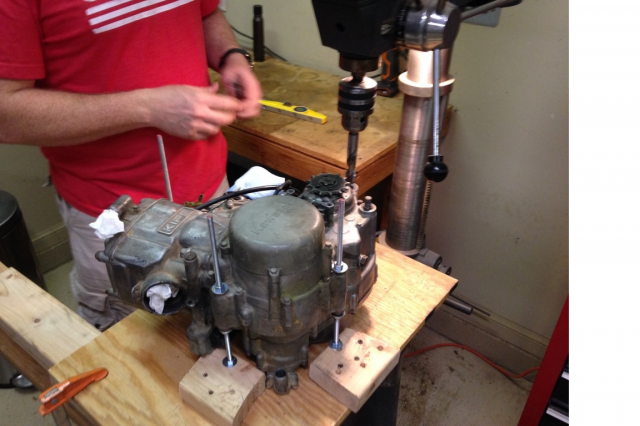

The KX500 uses a smaller swingarm pivot than the 250s and later aluminum framed bikes. You will need to drill the cases on your KX 500 in order to even get it in to the frame. The good news is that once your drill the cases, the lower motor mounts line right up and allow you to mount the motor in the frame where it needs to be while you make your other motor mounts. The not as good news is that the head stay and front motor mounts will need to be redone.
There are two ways to drill the motor cases to fit the larger pivot bolt. The preferred method is to drill each case separately while the motor is apart, but obviously this is not possible if your motor is already together. If your motor is together, you can build a jig to hold the motor perfectly level and drill both sides at once. Make sure you motor is level in every direction, and take your time. You can really screw up cases if you get off center. I built a jig using plywood and all thread that allowed me to drill the motor in one piece. I attached a picture below.
The drilling of the cases will need to be done with a 43/64 (17mm) drill bit. You will only be drilling a little bit on each case at the edge, not all the way through, so it goes fairly quickly. Be sure to use plenty of lubricant and check your level every chance you get.
motor drilling.jpg_thumb.png (403.65 KiB) Viewed 11182 times

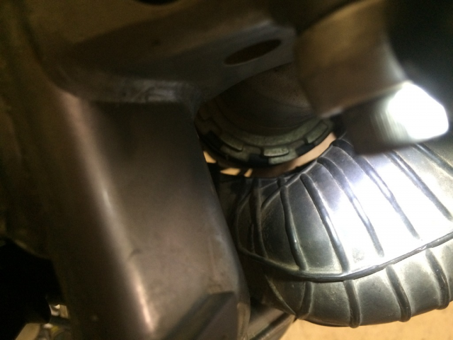

Step 7 - Airbox
The most critical step to this rather easy process is to have the right parts. As I mentioned earlier, you will need the KDX intake to aim your carburetor in the correct direction. I used a 1996 KX 500 airboot and filter parts (cage, mounting rings, etc.). The most important part is to have the 2004-2007 airbox, which will bolt in to the 2003 subframe without any issues. The reason you need this airbox is because it has it is stepped back just enough to allow you to mount the KX 500 airboot without compressing it (see picture one below). You will need to make an aluminum plate to go over the entire front of the airbox. I used the securing ring from the 250 and added 1" all around to cover the hole (see picture two below). Install that on the existing airbox with some RTV and rivets. Install your intake, carb, airboot, and airbox on your bike. Mark as many of the airboot holes on the aluminum as you can. Take everything off and put the airboot on the airbox. Mark the final holes and use the mounting ring to trace the hole. Cut that hole out and mount the KX 500 airbox parts in the 250 airbox.
Re: 2003-2007 Steel Frame Cookbook by Umberto
Airboot clearance

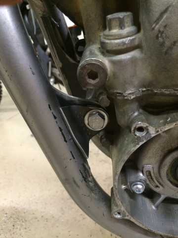

Step 8 - Pipe
Of all the steps, this one is the most difficult or simple. It's simple if you can purchase a Service Honda (no longer being made, but available on eBay), DynoPort, or any other pipe made for conversions. They are bit more expensive, but may be a break even when you consider the price of buying multiple pipes to craft together, welding time, frustration, years off your life, etc. If for some reason we are in an apocalyptic future where these pipes are no longer available, then your only option is combining a KX 500 pipe with a CR 500 pipe. This sounds simple, but be aware that the CR pipe hugs very tightly to the KX engine and will need lots of hammer adjustments to make it fit. Be prepared to do mean things to your pipe. Your main area of interference is the coolant transfer from the water pump to the cylinder head. You will need to dent the pipe pretty heavily in this area. I have seen people use a trick Service Honda employed where they flip the fitting and use a special hose to come in from the top. You will need to do search of the site to find this trick.
When you get your pipe finished, do yourself a favor and spend some time on the mounting bracket. It will need to be beefy to handle all the vibration. While you have the motor apart or the electronics safely out of the motor, you have the opportunity to weld on some beef to the mount. It doesn't need to support a tank's weight, but it does need to be beefier than the 250 mount. You don't want your pipe coming off. I used some 3/16" plate and a solid rod that I threaded to accept the 03 250 half rubber mount. So far my pipe is still on.
My pipe was a KX 500 inlet, and parts from a trashed CR pipe and a good CR pipe. I used the trashed CR pipe to add material to push the pipe out near the interference areas (ignition cover, transfer pipe). I added about 1 1/2" in the front bottom, and a 1 1/2" to 1/2" wedge in the front right above the engine exhaust port (the thickest part faced mostly forward). The wedge turned the pipe out a little bit as it came around, giving me a little more space in the transfer pipe area. Even with all that I still had to dent my pipe. This is a trial and error part, and will require some decent fabrication skills. Did I mention that people make pipes for this conversion?

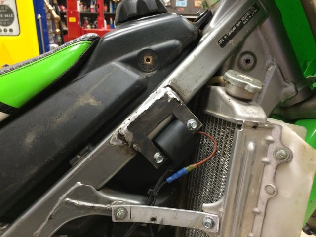

Step 10 - Electronics
This is the step to add back your electronics that you took off before fabrication began. There isn't a lot to a 500's electronics, so you are in for a bit easier step than if you were wiring a 250. There are a couple of things to keep in mind. You will need to lengthen the wires coming from the motor to the CDI box. I mounted my CDI box on the left side of the bike in the hole where the 250 had its resistor. I made a tab to mount my coil on the right side of the frame behind the radiator (see picture below). I initially put it in front of the motor, but it kept frying coils. The new location is safer and has lasted a year and a half. Once you have everything mounted, you will need to solder extensions to the middle of the motor wires. Be sure to use heat shrink tubing over the solder connections, and consider a longer heat shrink to hold the wires coming from the engine. This will protect the wires from the elements and wear and tear.

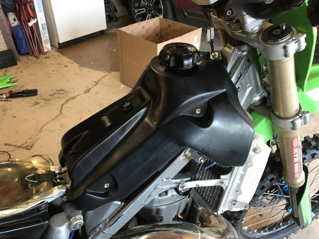

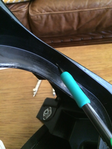

Step 12 - Gas tank
Now you are really close to getting finished. All you need is the gas tank and you are ready to ride this beast. In step four, we talked about centering the head stay in the chassis. This step is critical in fitting a gas tank. I'm going to assume that you are like every other 500 rider, and want as much fuel on board as possible. Thankfully there is a solution that gets you very close to 3 gallons of fuel. Not enough for Baja, but plenty for normal riding. The key to the gas tank is buying the right tank. You must buy the Clarke 2007 KX250 tank. No other tank will work! I know I tried them all for you. I bought mine in black from justgastanks.com. Before you start, remove the little rubber tank mounting strips from your frame. The oversize tanks usually don't use them. Mounting the tank may require you to break out the heat gun and do a little forming, but it shouldn't be too bad. Just remember to go slowly and don't keep the heat gun on your tank for too long. Start slowly and you should get the hang of it. You will need to fabricate a new front mounting hole, as the old one will be about 1/2-3/4" too far back to get the tank to fit. I used a rivnut instead of a bracket, and after I had installed it, the lip of the rivnut touched the top of the old mounting hole.
