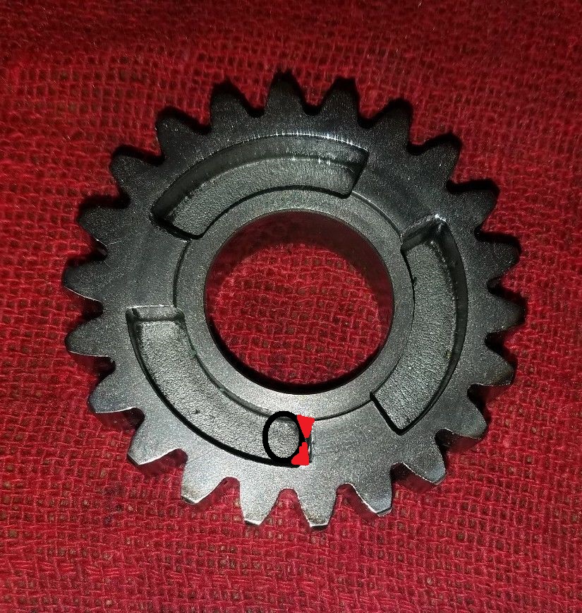

Yes, you can repair them by hand.
It takes a bit of work but we have done it several times with good results.
Take a look at this gear.
See the circle?
You drill a hole through the gear right next to the damage.
Then you get a small square file and go to town.
Since the material is hardened it takes a while but it is doable..
gear repair.jpg (369.26 KiB) Viewed 354865 times
Any questions?
Post them up 8-)

So how do you ensure that each dog is making contact, sort of seat-of-pants, or is there some procedure? I watched a couple videos showing back-cutting the dogs on a milling machine, but that defeats my goal of trying to get by as cheaply as possible. I like your idea of drilling the hole to give the file room to work. :)

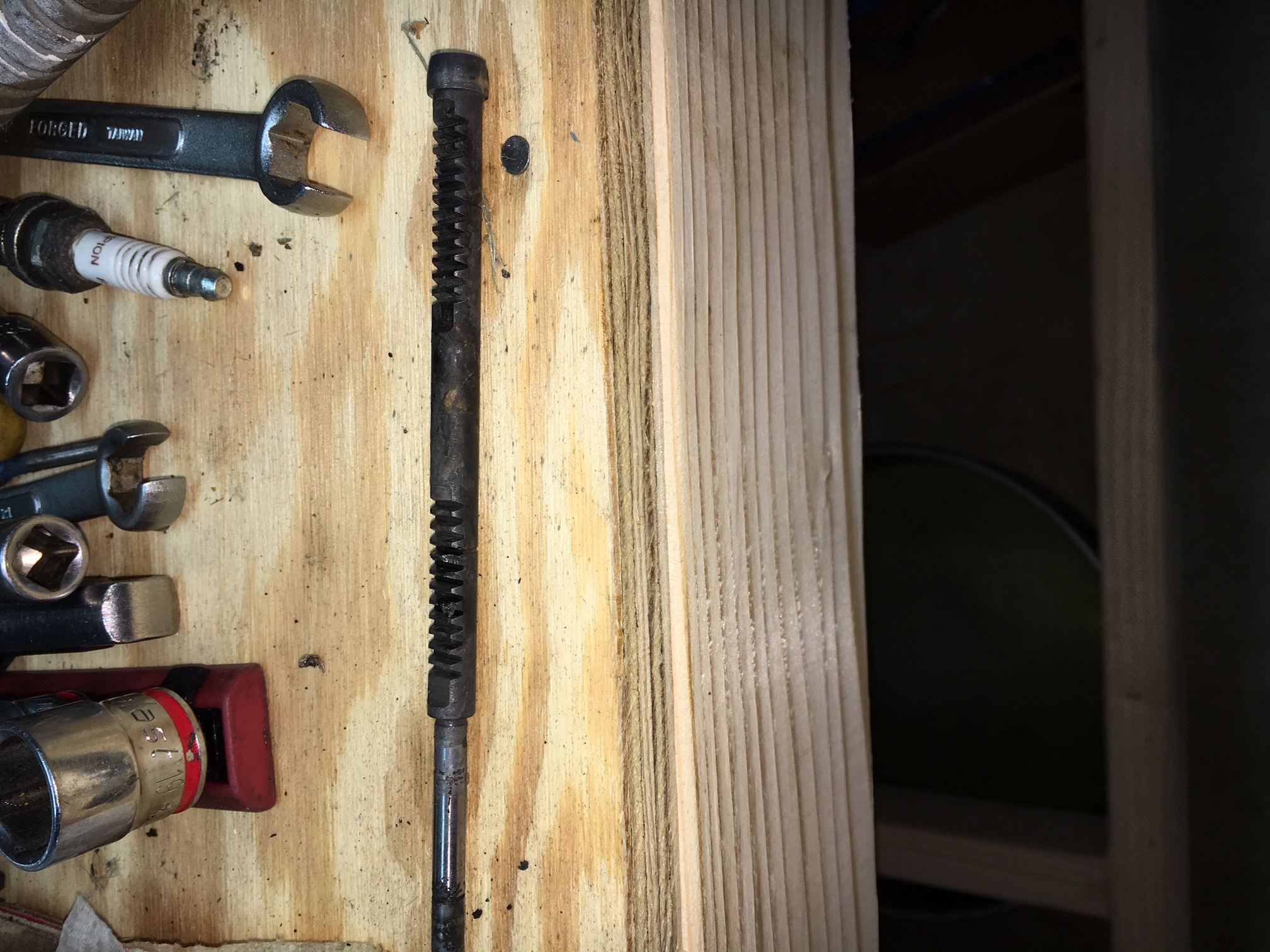

Sort of on the same topic, the power valve rack gear (or rod) on the same bike (‘87) has a tooth that’s chipped. I haven’t found a replacement anywhere yet. I was wondered if that could be repaired somehow by brazing and reshaping the tooth with a Dremel or something. The metal looks kinda cheap; not sure brazing would even work. Loctite makes a metal repair epoxy, I wonder if that would work?

60something wrote: Wed Mar 07, 2018 3:29 pm So how do you ensure that each dog is making contact, sort of seat-of-pants, or is there some procedure? I watched a couple videos showing back-cutting the dogs on a milling machine, but that defeats my goal of trying to get by as cheaply as possible. I like your idea of drilling the hole to give the file room to work. :)
If your doing it by hand... and on the cheap... You can use some contact paper which will leave a mark if it makes contact... Or other products such as some plasitgauge. Whittle a little at a time...
I liked the diamond files the best for the hardened gear surface.

60something wrote: Wed Mar 07, 2018 3:45 pm Sort of on the same topic, the power valve rack gear (or rod) on the same bike (‘87) has a tooth that’s chipped. I haven’t found a replacement anywhere yet. I was wondered if that could be repaired somehow by brazing and reshaping the tooth with a Dremel or something. The metal looks kinda cheap; not sure brazing would even work. Loctite makes a metal repair epoxy, I wonder if that would work?
KX500 power valve rod.JPG (978.85 KiB) Viewed 354855 times
Regarding the power valve rod, I've posted a pic...a few of the teeth are chipped. Any ideas on repair? I haven't located one just yet. Kinda hard to conceive of how they get chipped like that, as the power valves themselves are aluminum, and it doesn't seem like there'd be that much force applied with the governor arrangement :?:

Oh, as a follow-up, the power valves themselves are in great shape with no damage to the gears.

The part number for the 1987 power valve rod is: 49046-1057 ROD-GOVERNOR
