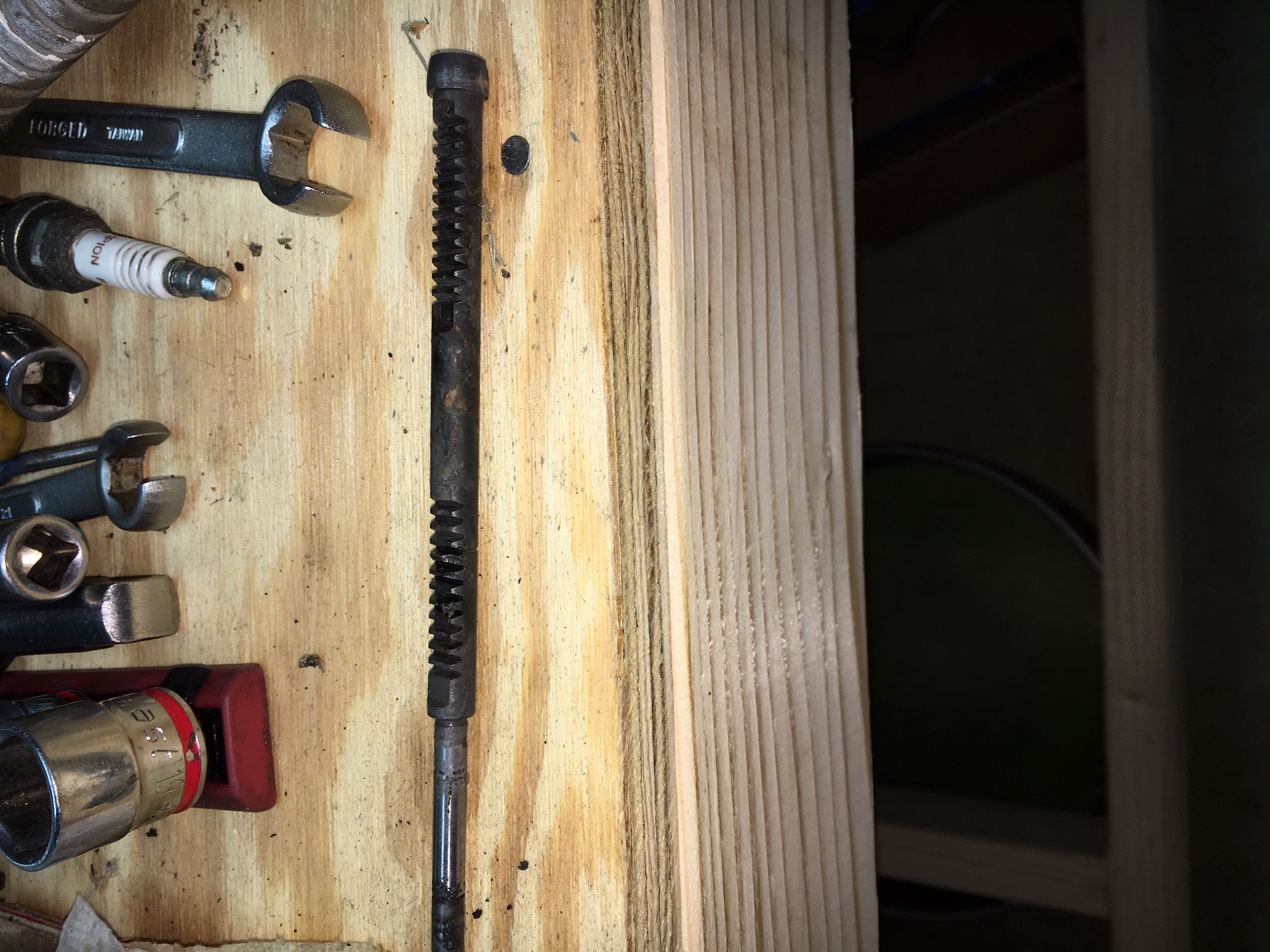

Sort of on the same topic, the power valve rack gear (or rod) on the same bike (‘87) has a tooth that’s chipped. I haven’t found a replacement anywhere yet. I was wondered if that could be repaired somehow by brazing and reshaping the tooth with a Dremel or something. The metal looks kinda cheap; not sure brazing would even work. Loctite makes a metal repair epoxy, I wonder if that would work?

60something wrote: Wed Mar 07, 2018 3:45 pm Sort of on the same topic, the power valve rack gear (or rod) on the same bike (‘87) has a tooth that’s chipped. I haven’t found a replacement anywhere yet. I was wondered if that could be repaired somehow by brazing and reshaping the tooth with a Dremel or something. The metal looks kinda cheap; not sure brazing would even work. Loctite makes a metal repair epoxy, I wonder if that would work?
Get me the part number you need..
I'll see what I can find for you.
KX500 power valve rod.JPG (978.85 KiB) Viewed 346078 times
Regarding the power valve rod, I've posted a pic...a few of the teeth are chipped. Any ideas on repair? I haven't located one just yet. Kinda hard to conceive of how they get chipped like that, as the power valves themselves are aluminum, and it doesn't seem like there'd be that much force applied with the governor arrangement :?:

Oh, as a follow-up, the power valves themselves are in great shape with no damage to the gears.

The part number for the 1987 power valve rod is: 49046-1057 ROD-GOVERNOR
