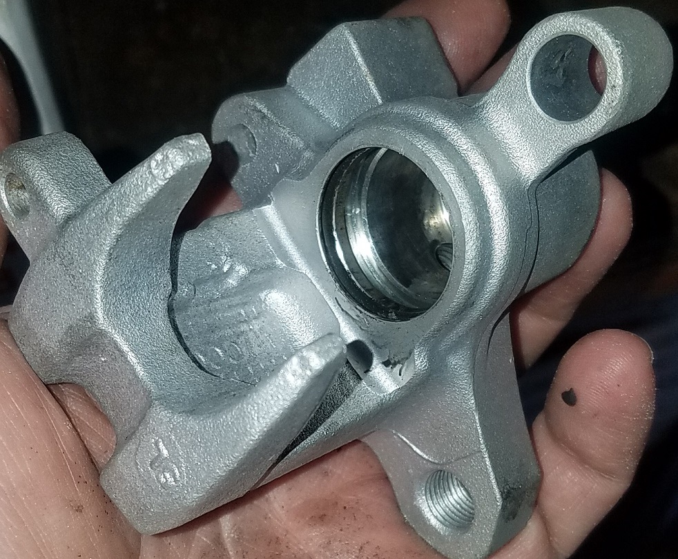

First things first you will need a KX450F rear brake caliper... Any year will do up to at least 2012 :o
Next, strip it bare..
KX GURU RACING MODIFIED KX450F REAR BRAKE CALIPER 101.jpg (357.92 KiB) Viewed 10977 times
{TIP} Use a air nozzle to blow the seals out... Most of the time you can re-use them.
Or just buy new ones as they are cheap..

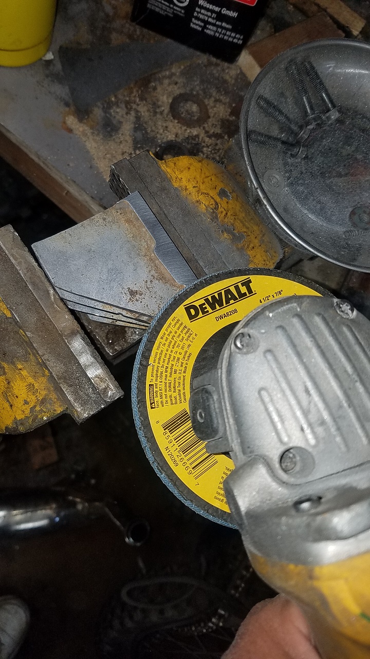

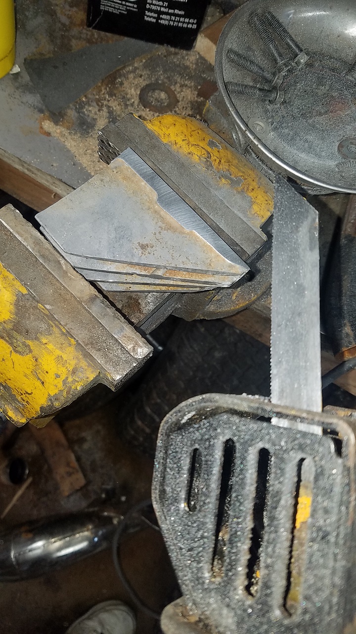

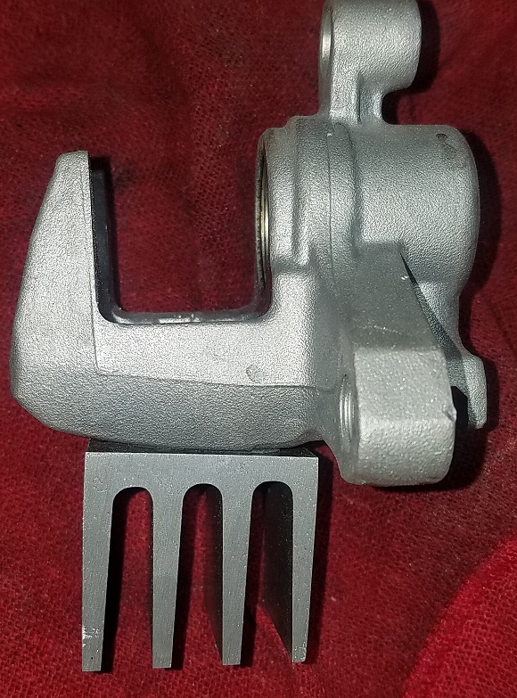

No fancy mills or lathes.
I haven't even measured anything... All eyeball :shock:
KX GURU RACING MODIFIED KX450F REAR BRAKE CALIPER 105.jpg (349.93 KiB) Viewed 10973 times
KX GURU RACING MODIFIED KX450F REAR BRAKE CALIPER 106.jpg (365.35 KiB) Viewed 10973 times
KX GURU RACING MODIFIED KX450F REAR BRAKE CALIPER 107.jpg (343.4 KiB) Viewed 10973 times

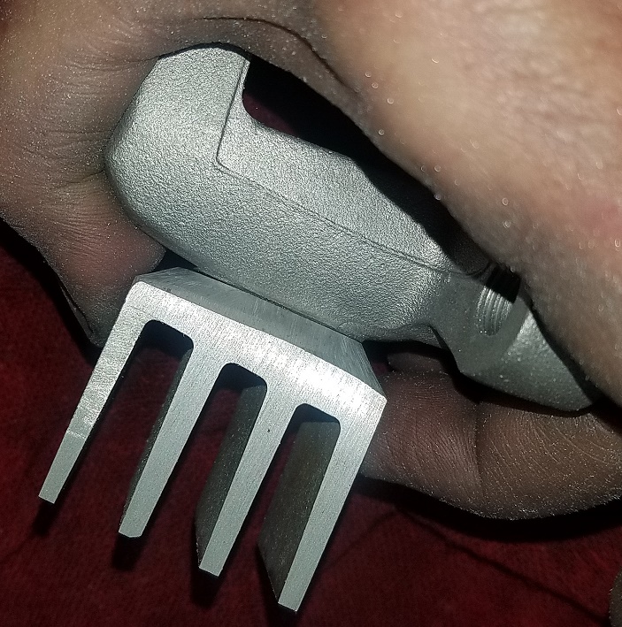

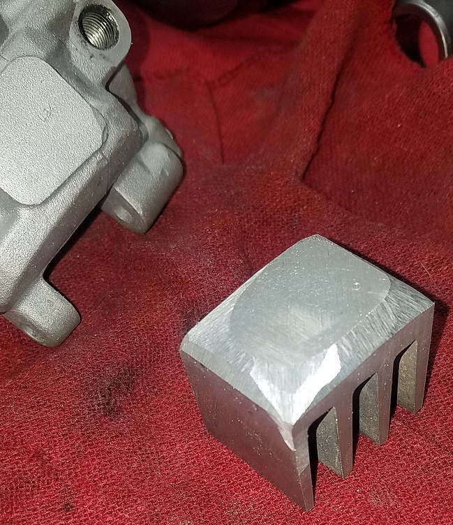

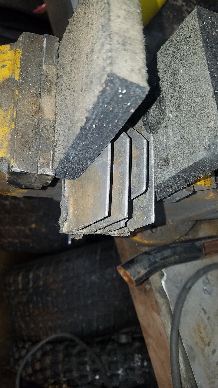

It's starting to take shape..
KX GURU RACING MODIFIED KX450F REAR BRAKE CALIPER 108.jpg (252.7 KiB) Viewed 10972 times
KX GURU RACING MODIFIED KX450F REAR BRAKE CALIPER 109.jpg (212.54 KiB) Viewed 10972 times

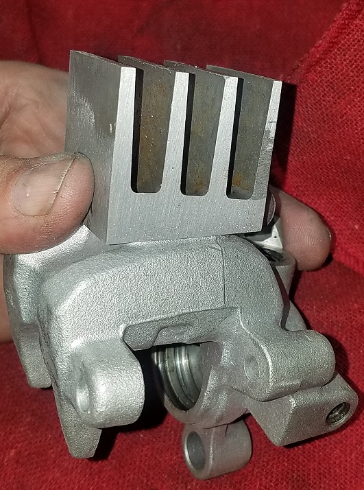

A little grinder work and..
KX GURU RACING MODIFIED KX450F REAR BRAKE CALIPER 111.jpg (280.45 KiB) Viewed 10971 times
KX GURU RACING MODIFIED KX450F REAR BRAKE CALIPER 112.jpg (244.37 KiB) Viewed 10971 times
KX GURU RACING MODIFIED KX450F REAR BRAKE CALIPER 113.jpg (247.85 KiB) Viewed 10971 times

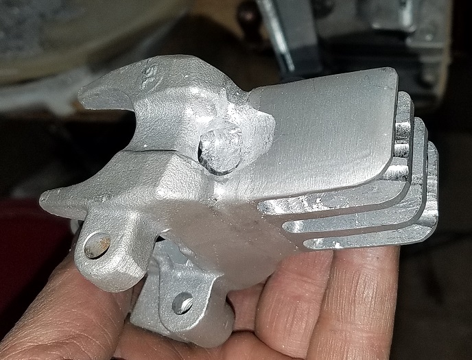

I received it back from the welder and started the clean up..
It's real rough right now but give it some time :-)

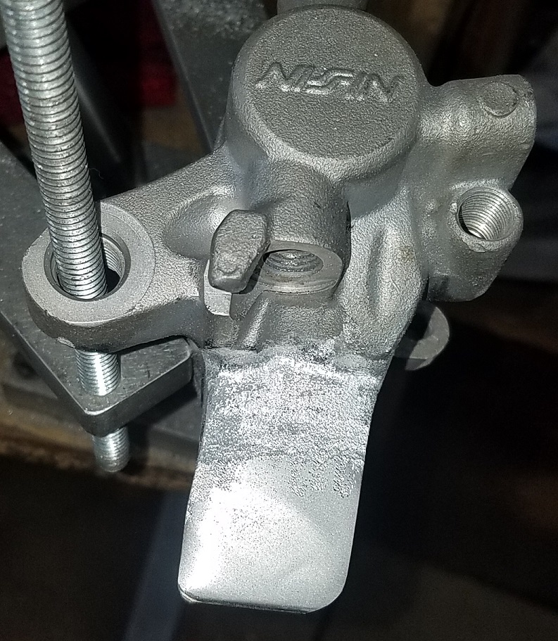

A little more progress..

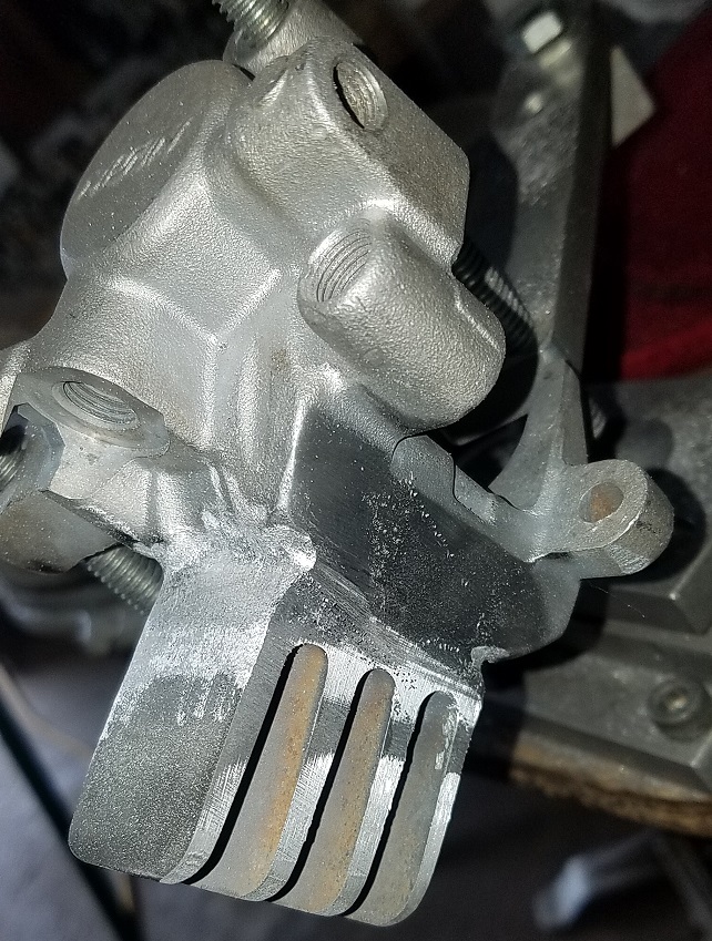

KX GURU RACING rebuilding the beast 124.jpg (168.1 KiB) Viewed 10933 times
KX GURU RACING rebuilding the beast 125.jpg (162.89 KiB) Viewed 10933 times
