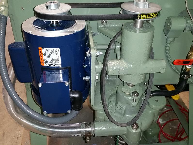

I purchased a Small Vixen Vapor Blaster that has been reconditioned.
Today I drove to Portland and picked up a compressor to run it.
At 600lb it made my Yoda a bit top heavy.
After I get everything installed and running I will do some experimenting and post the results.
If it works as hoped I will start offering vapor blasting services.

Getting closer to being done..
VAPOR BLASTER 2.JPG (86.16 KiB) Viewed 15394 times
VAPOR BLASTER 1.JPG (88.18 KiB) Viewed 15394 times
