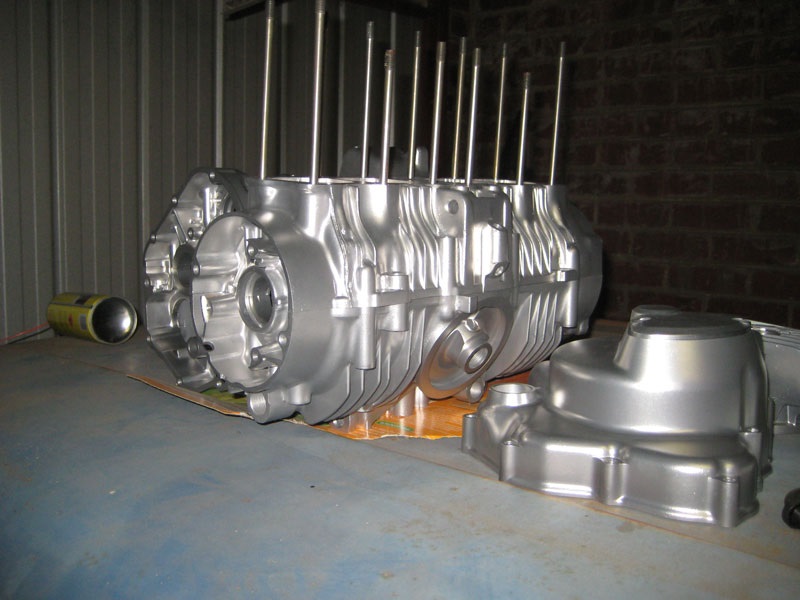

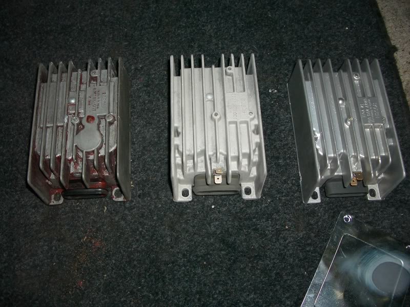

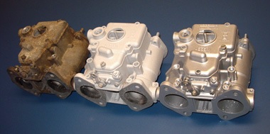

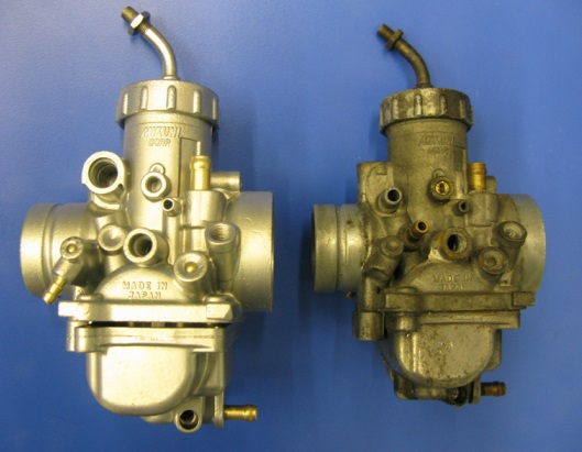

Here's some pics
vapor blasting 2.jpg (166.88 KiB) Viewed 15448 times
vapor blasting 3.jpg (111.17 KiB) Viewed 15448 times
vapor blasting 4.jpg (98.84 KiB) Viewed 15448 times
vapor blasting 5.jpg (157.35 KiB) Viewed 15448 times
What is Vapor or Aqua blasting?
Instead of using just sand or glass beads it also uses water.
So instead of cleaning by impacting media onto the surface to be cleaned, it cleans by flow.
So it does not embed itself onto softer surfaces.
It actually peens the surface :shock:
Because of this cleaning by flow, you get a much smoother surface and also a shinier surface.

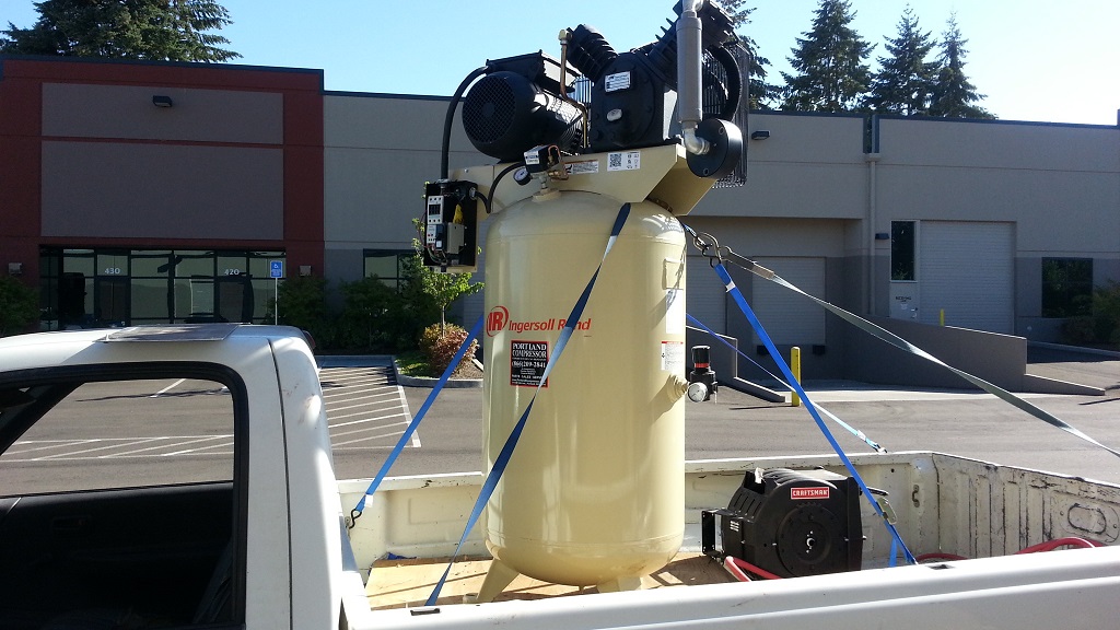

I purchased a Small Vixen Vapor Blaster that has been reconditioned.
Today I drove to Portland and picked up a compressor to run it.
At 600lb it made my Yoda a bit top heavy.

judging by the looks of those pics of the engine pieces, it looks more than "worth the expense" to me...hell, if you find that your set-up works well, I might send you some parts to blast! :D

Got the compressor out of the truck and on to the floor.... But that's all I did :x
Here's my spoiled 15 year old kid standing next to it.

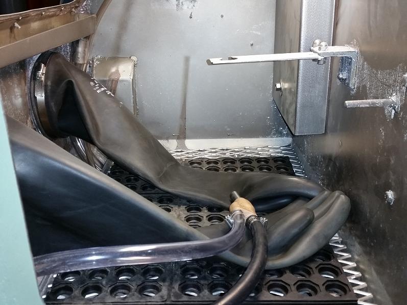

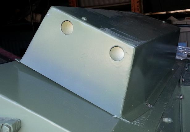

Vapor blasting process is suitable for aluminum, Bronze, Magnesium, Titanium, Brass, Copper etc... It will gently clean the surface without damage and leave a nice satin finish which is very easy to keep clean.
However, any item that rusts can not be done with this process as the item oxidizes instantly.

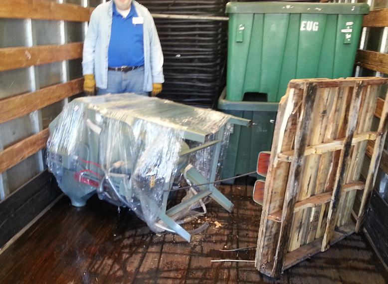

The vapor blaster came in today ... Whoopie!!!!
Opened the back of the truck and found this.
Pic as seen from in the truck.JPG (76.57 KiB) Viewed 15276 times
Damage as noted so far...
Bent leg
bent leg.JPG (37.06 KiB) Viewed 15276 times

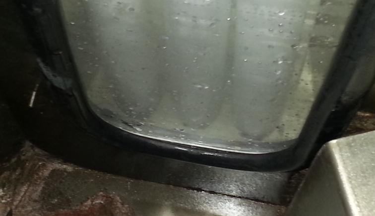

Glass pulled loose from the seal that covers the lights on the lid.
glass has pulled loose from the seal.JPG (29.07 KiB) Viewed 15276 times
The top is bent
top is bent.JPG (23.03 KiB) Viewed 15276 times
top is bent 2.JPG (27.5 KiB) Viewed 15276 times
Wires were pulled loose from the electrical box
wires pulled from the box.JPG (38.09 KiB) Viewed 15276 times
