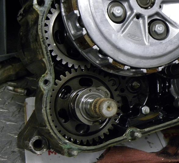

First remove your kick lever and clutch cover.

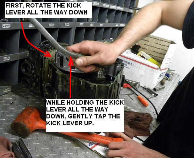

Then, bolt your kick lever back on.

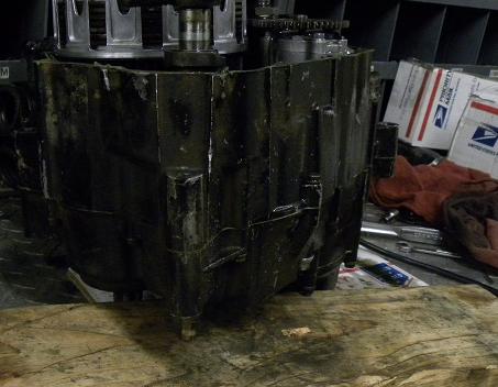

Lay the engine on it's side..

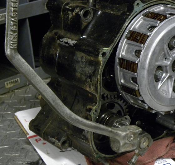

Now, pull the lever all the way down... and tap upward on the bottom of the kick lever.
You don't have to tap very hard.

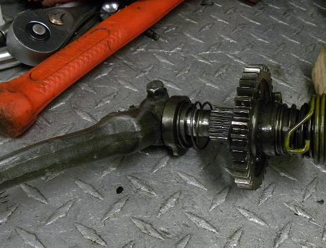

The kick lever shaft will pop out but you will have to move it around a bit to get it out.
