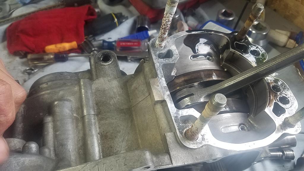

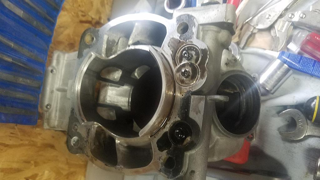

Brents 1992 KX500 engine needs a bit of work before it's ready for his snow bike.
Starting with the cylinder.. It has been ported by Eric Gore.
This cylinder porting would be great for a trail bike but not so good for a Snow bike..
KX GURU RACING 1992 KX500 SNOW BIKE ENGINE BUILD FOR BRENT 101.JPG (96.3 KiB) Viewed 10867 times

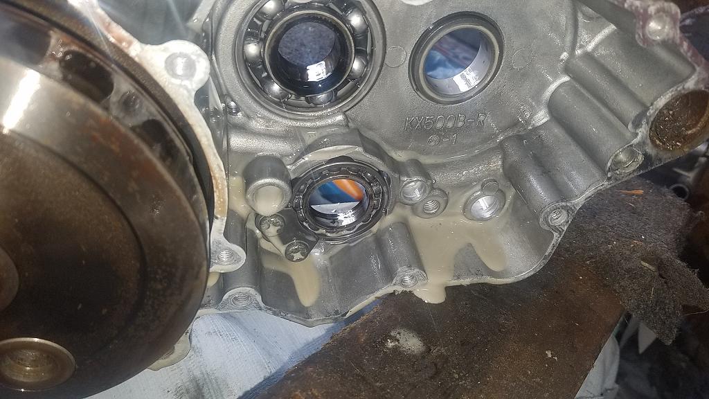

When you see stuff like this on a bike it makes you a bit nervous on what you will find..
KX GURU RACING 1992 KX500 SNOW BIKE ENGINE BUILD FOR BRENT 102.JPG (103.8 KiB) Viewed 10867 times

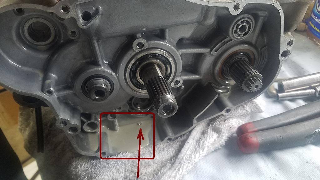

Posted: Fri Dec 09, 2016 10:17 pm

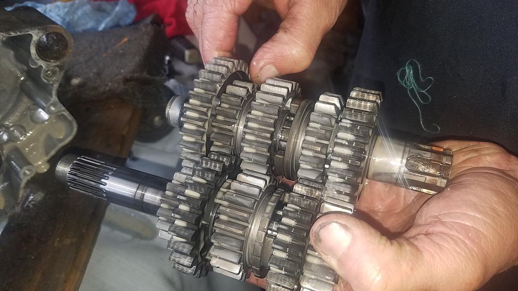

At first glance the transmission didn't look to bad... excluding the milky oil of course..
KX GURU RACING 1992 KX500 SNOW BIKE ENGINE BUILD FOR BRENT 105.JPG (114.98 KiB) Viewed 10865 times
KX GURU RACING 1992 KX500 SNOW BIKE ENGINE BUILD FOR BRENT 106.JPG (122.65 KiB) Viewed 10865 times

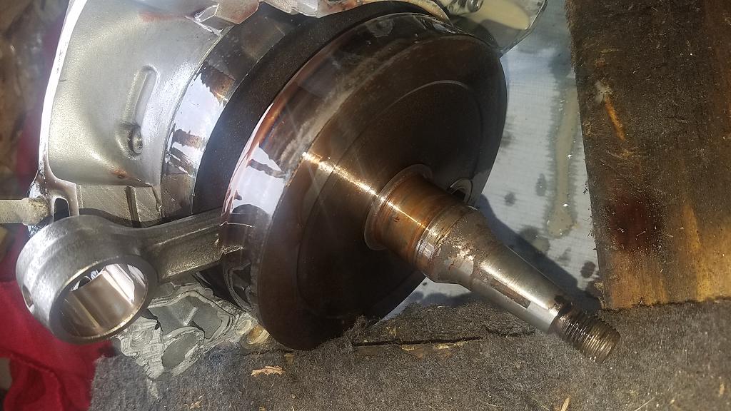

Posted: Fri Dec 09, 2016 10:20 pm
The crank is looking a bit haggard..
KX GURU RACING 1992 KX500 SNOW BIKE ENGINE BUILD FOR BRENT 107.JPG (129.42 KiB) Viewed 10864 times

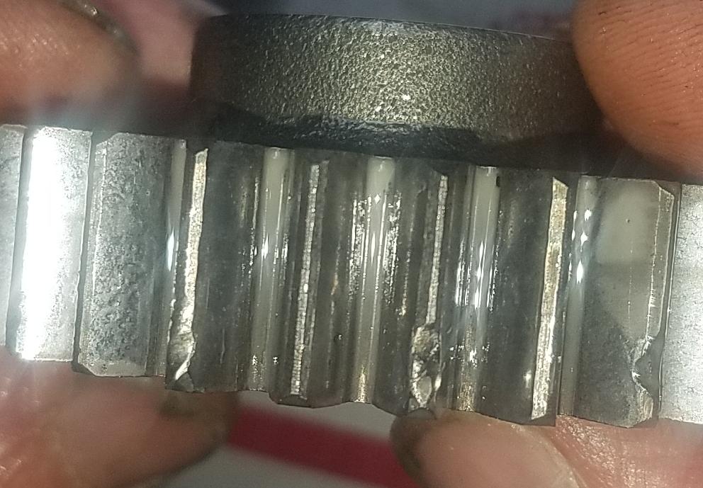

Posted: Fri Dec 09, 2016 10:22 pm
This one has a bit of wear... as to be expected..
KX GURU RACING 1992 KX500 SNOW BIKE ENGINE BUILD FOR BRENT 109.JPG (74.75 KiB) Viewed 10863 times
This one is chipped which is why there was some metal shavings in the bottom of the cases..

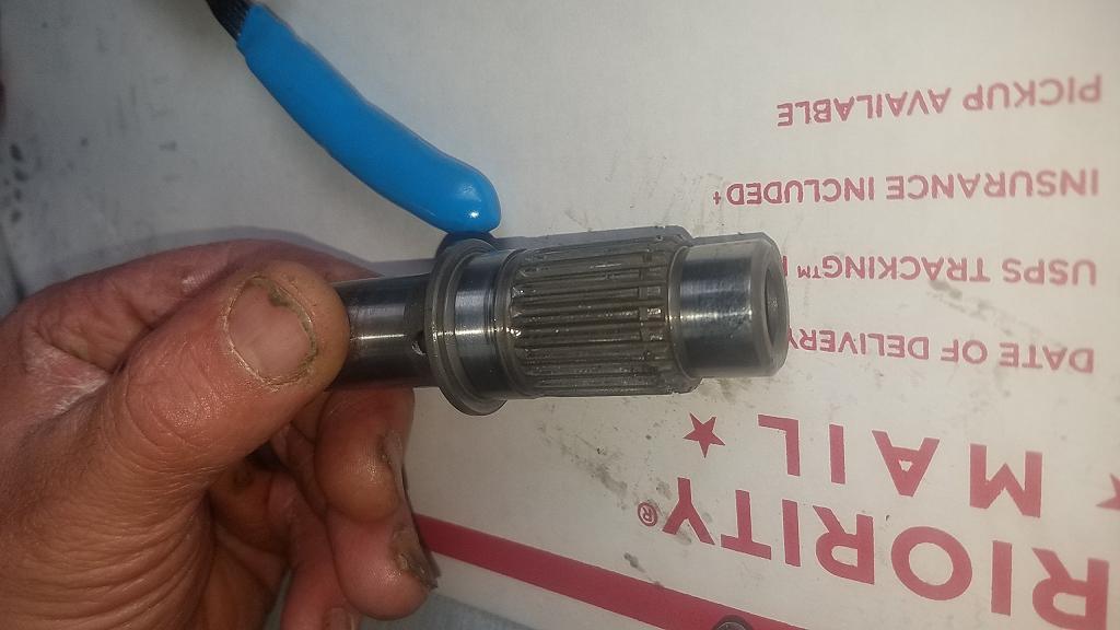

Posted: Fri Dec 09, 2016 10:24 pm
Both these gears have a bit of wear but no worry..
KX GURU RACING 1992 KX500 SNOW BIKE ENGINE BUILD FOR BRENT 111.JPG (66.34 KiB) Viewed 10862 times
KX GURU RACING 1992 KX500 SNOW BIKE ENGINE BUILD FOR BRENT 112.JPG (85.2 KiB) Viewed 10862 times

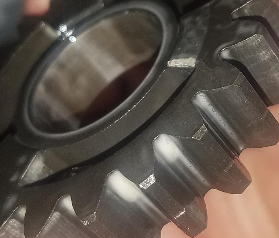

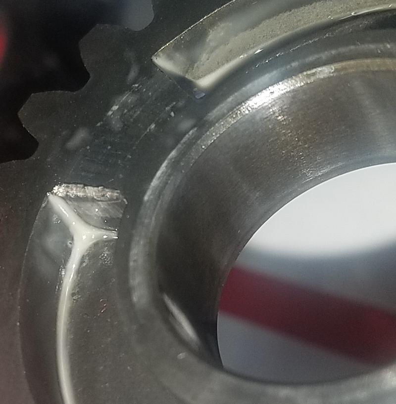

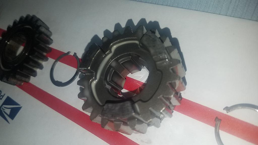

Posted: Fri Dec 09, 2016 10:26 pm

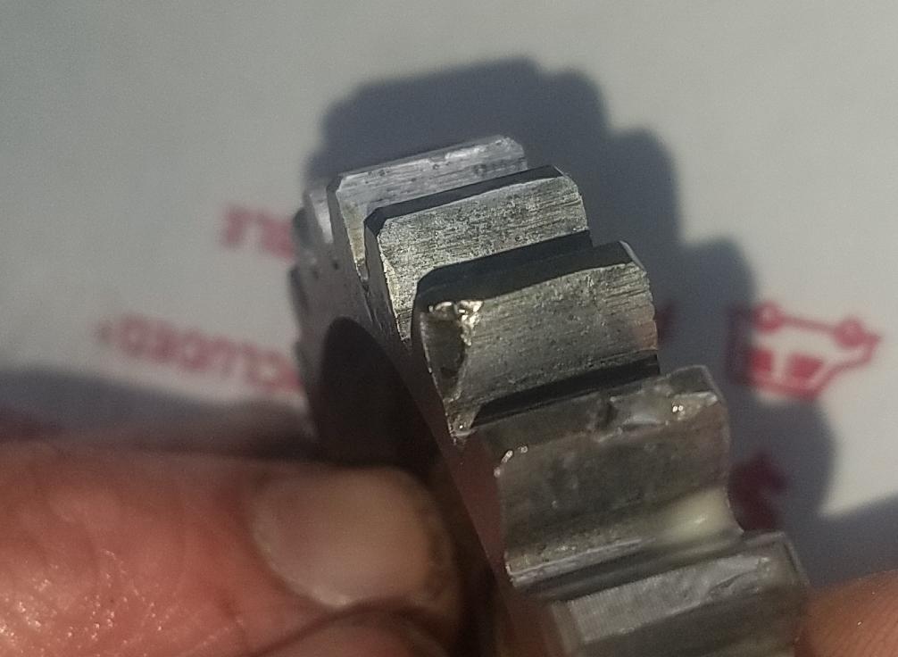

The small clutch basket gear has a chip out of it..
KX GURU RACING 1992 KX500 SNOW BIKE ENGINE BUILD FOR BRENT 113.JPG (69.66 KiB) Viewed 10861 times

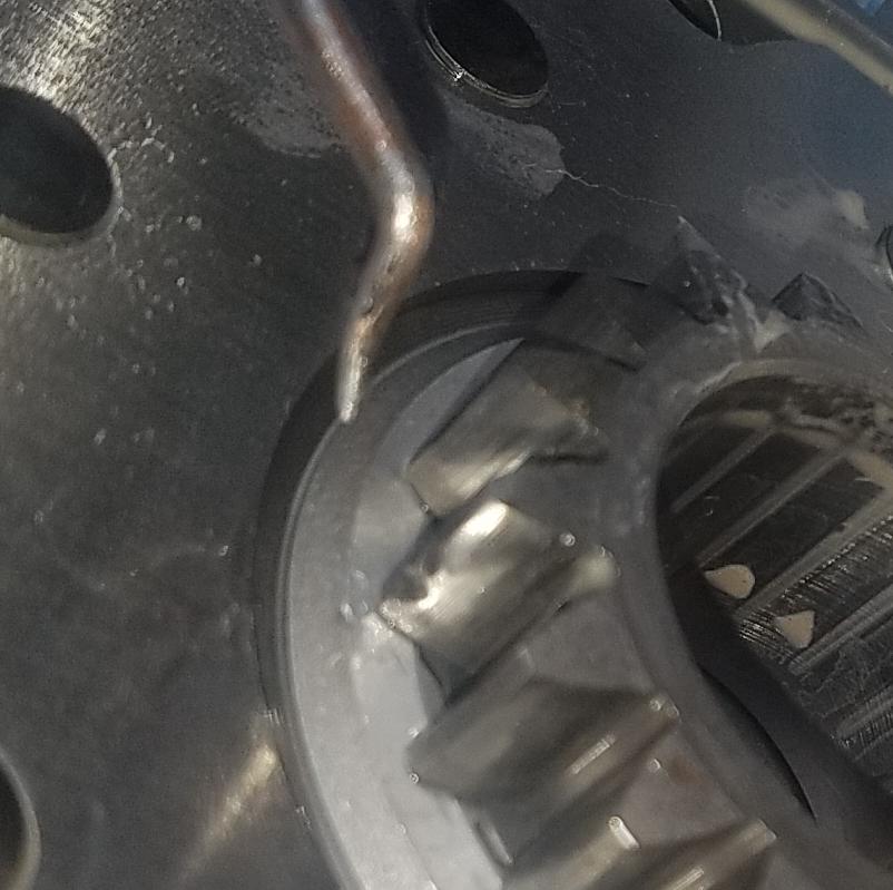

And the big one is bad as well :shock:
KX GURU RACING 1992 KX500 SNOW BIKE ENGINE BUILD FOR BRENT 114.JPG (100.42 KiB) Viewed 10861 times

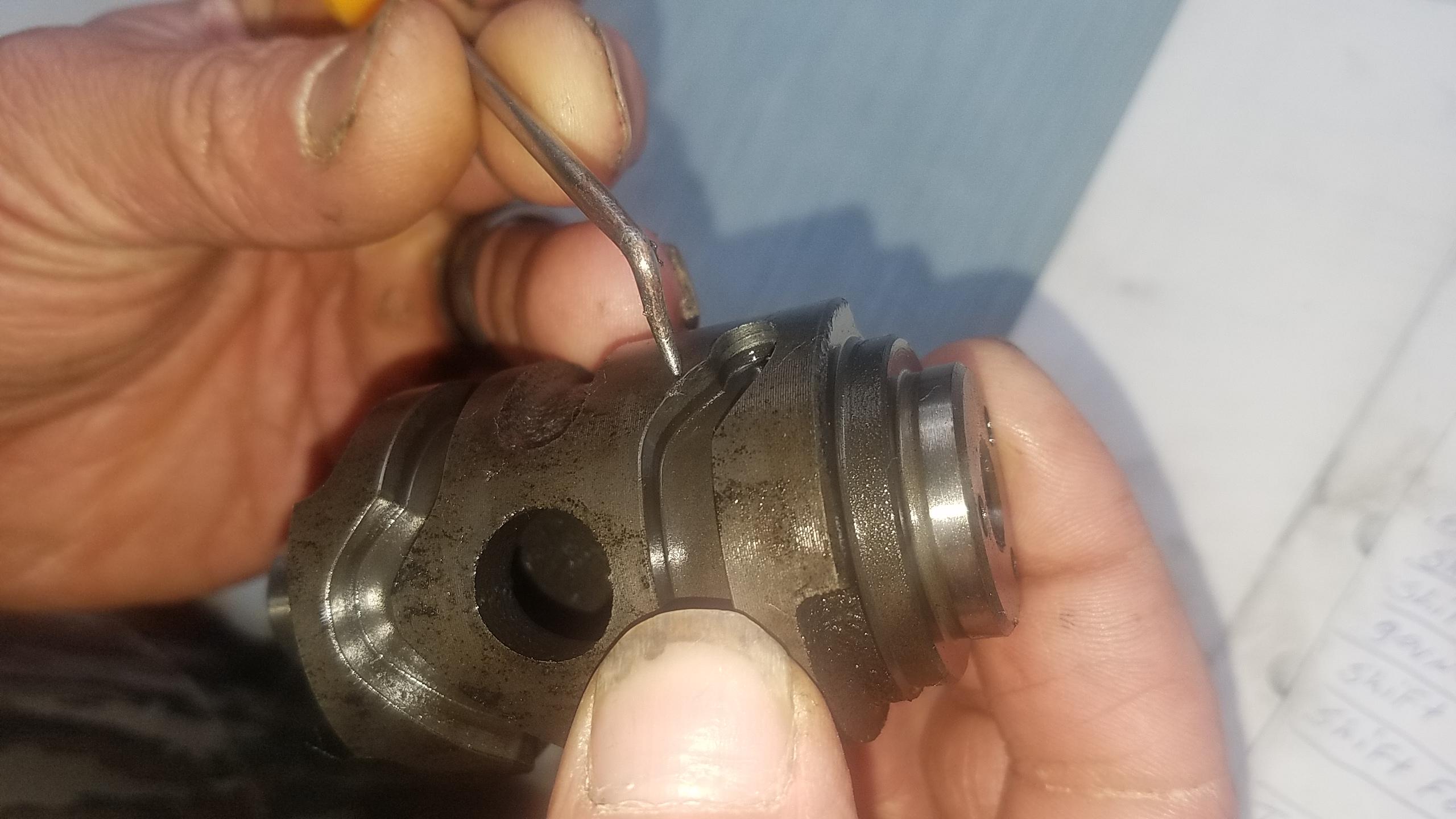

Posted: Sat Dec 10, 2016 3:24 am
More damage...
KX GURU RACING 1992 KX500 SNOW BIKE ENGINE BUILD FOR BRENT 117.JPG (70.16 KiB) Viewed 10845 times
More damage...
KX GURU RACING 1992 KX500 SNOW BIKE ENGINE BUILD FOR BRENT 118.JPG (295.12 KiB) Viewed 10845 times

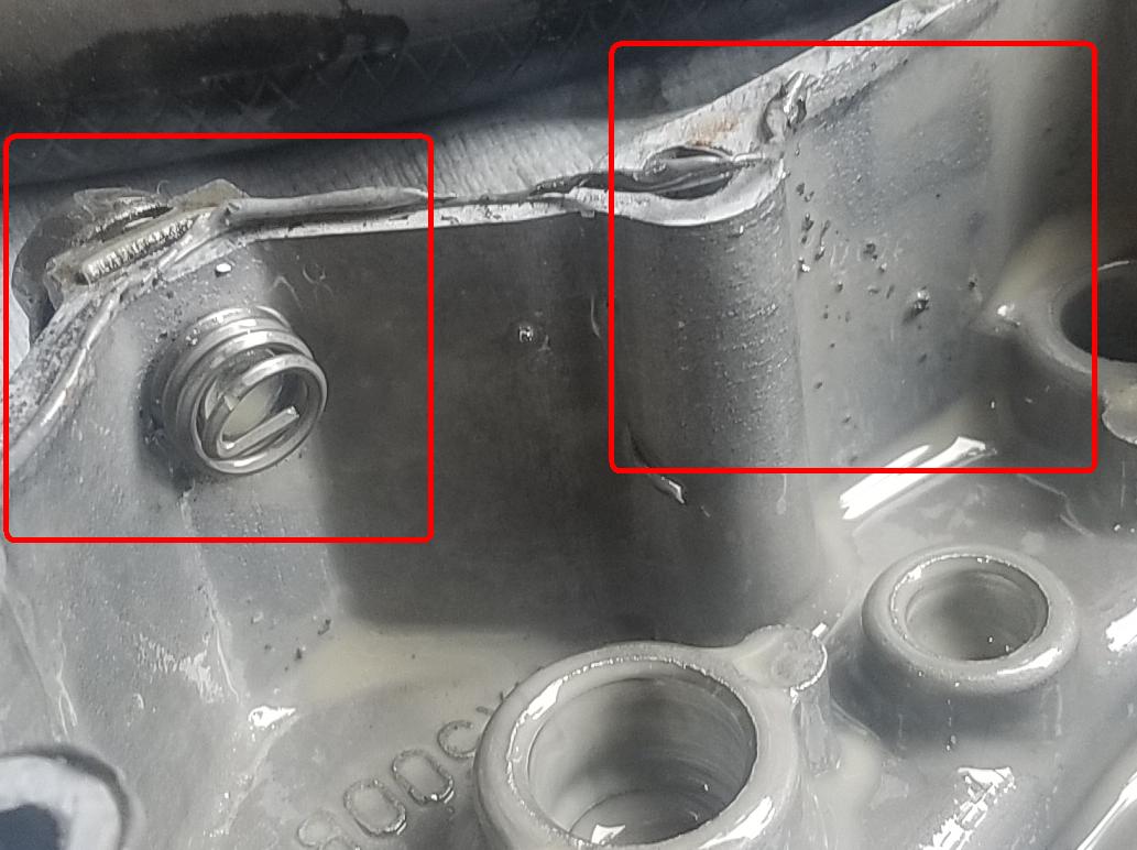

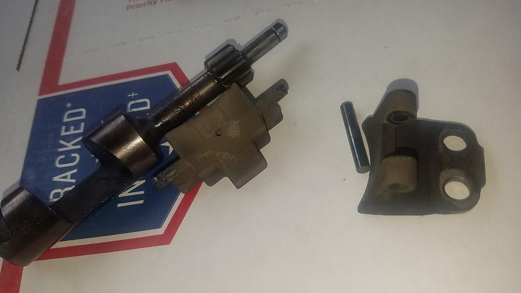

Posted: Sat Dec 10, 2016 3:27 am
Note the 4mm pin for the center flapper?
Can you say Jacked up!!!
KX GURU RACING 1992 KX500 SNOW BIKE ENGINE BUILD FOR BRENT 119.JPG (59.87 KiB) Viewed 10844 times
