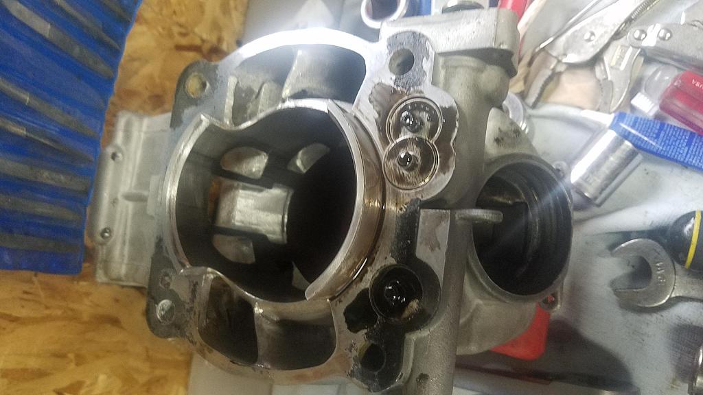

Brents 1992 KX500 engine needs a bit of work before it's ready for his snow bike.

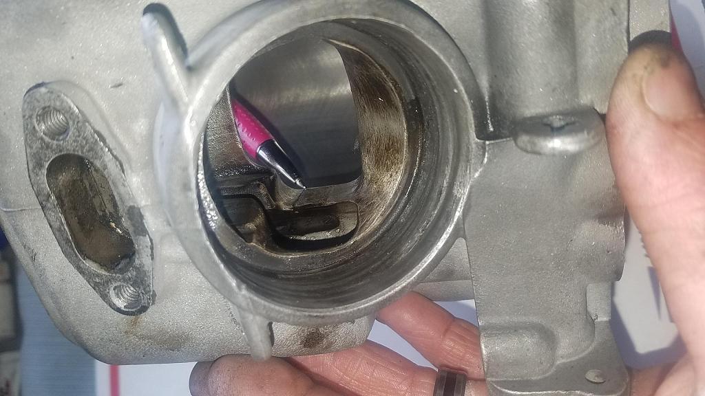

Starting with the cylinder.. It has been ported by Eric Gore.
This cylinder porting would be great for a trail bike but not so good for a Snow bike..
KX GURU RACING 1992 KX500 SNOW BIKE ENGINE BUILD FOR BRENT 101.JPG (96.3 KiB) Viewed 10864 times

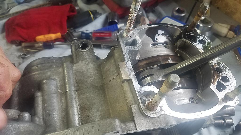

When you see stuff like this on a bike it makes you a bit nervous on what you will find..
KX GURU RACING 1992 KX500 SNOW BIKE ENGINE BUILD FOR BRENT 102.JPG (103.8 KiB) Viewed 10864 times

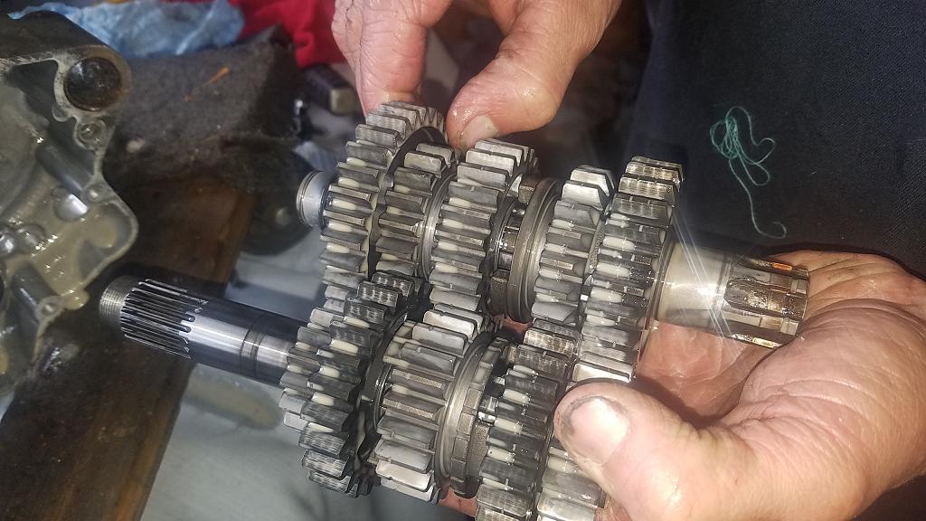

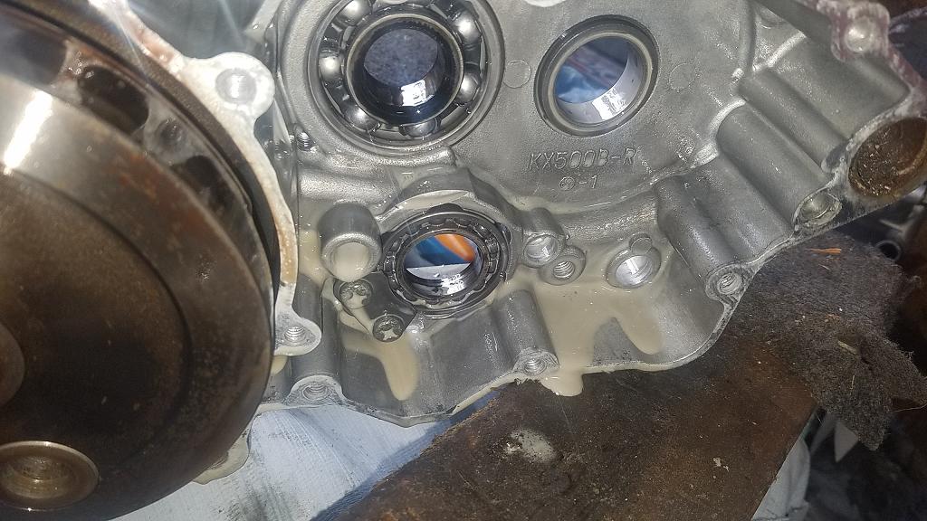

At first glance the transmission didn't look to bad... excluding the milky oil of course..
KX GURU RACING 1992 KX500 SNOW BIKE ENGINE BUILD FOR BRENT 105.JPG (114.98 KiB) Viewed 10862 times
KX GURU RACING 1992 KX500 SNOW BIKE ENGINE BUILD FOR BRENT 106.JPG (122.65 KiB) Viewed 10862 times

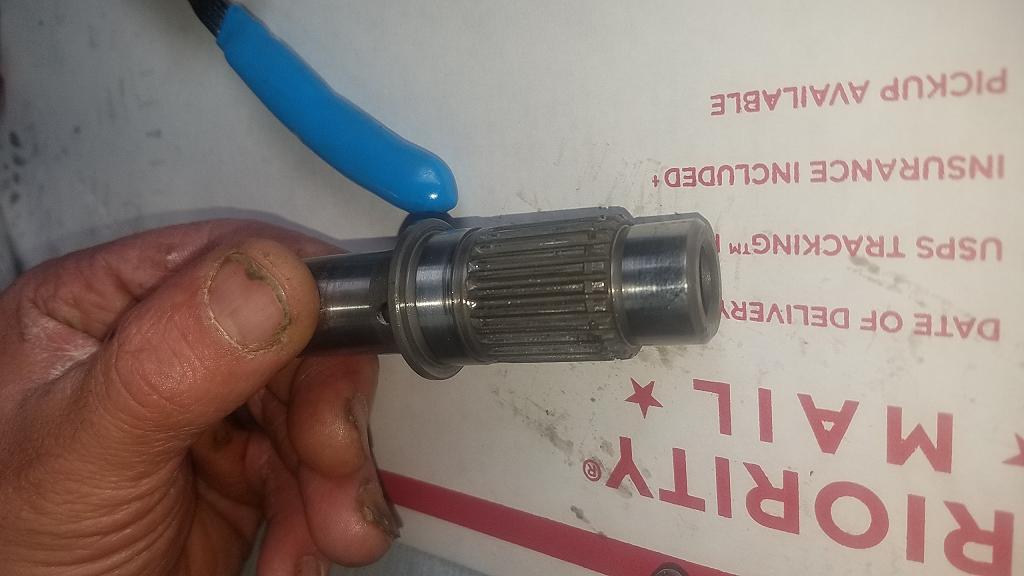

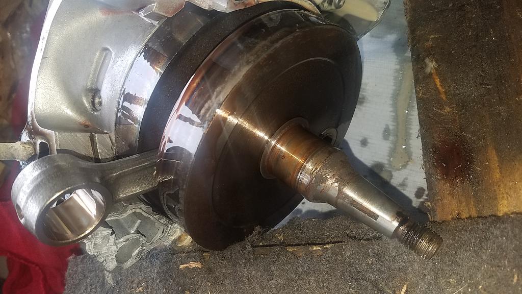

The crank is looking a bit haggard..
KX GURU RACING 1992 KX500 SNOW BIKE ENGINE BUILD FOR BRENT 107.JPG (129.42 KiB) Viewed 10861 times

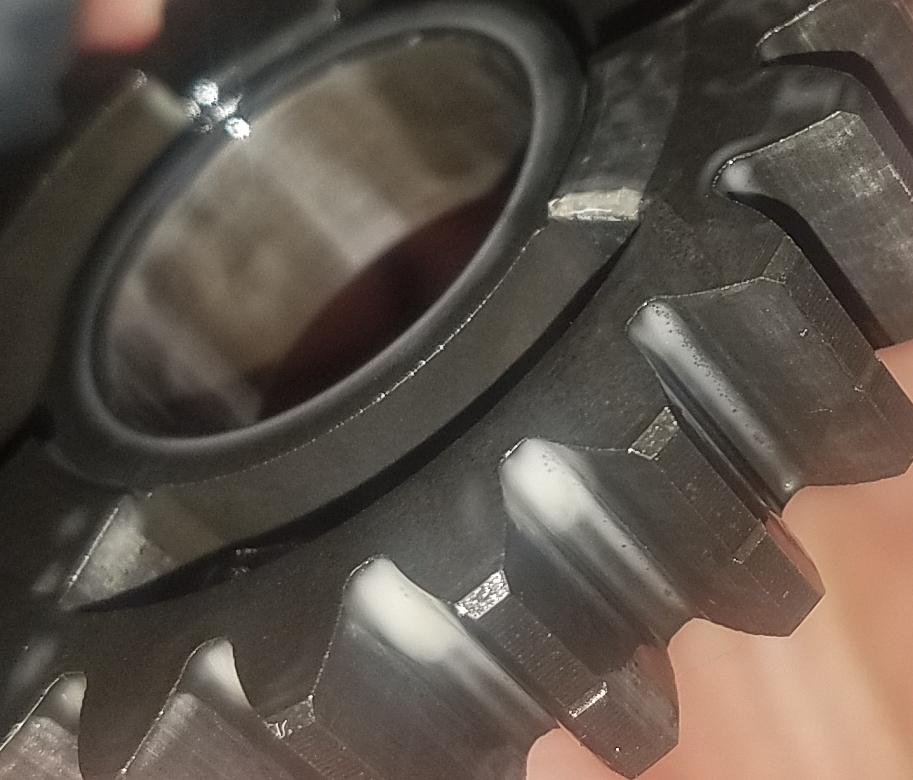

This gear looks pretty good..
KX GURU RACING 1992 KX500 SNOW BIKE ENGINE BUILD FOR BRENT 108.JPG (63.06 KiB) Viewed 10861 times

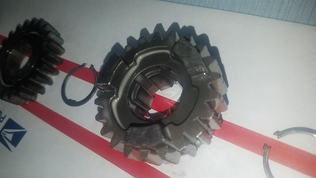

This one is chipped which is why there was some metal shavings in the bottom of the cases..
KX GURU RACING 1992 KX500 SNOW BIKE ENGINE BUILD FOR BRENT 110.JPG (74.97 KiB) Viewed 10860 times

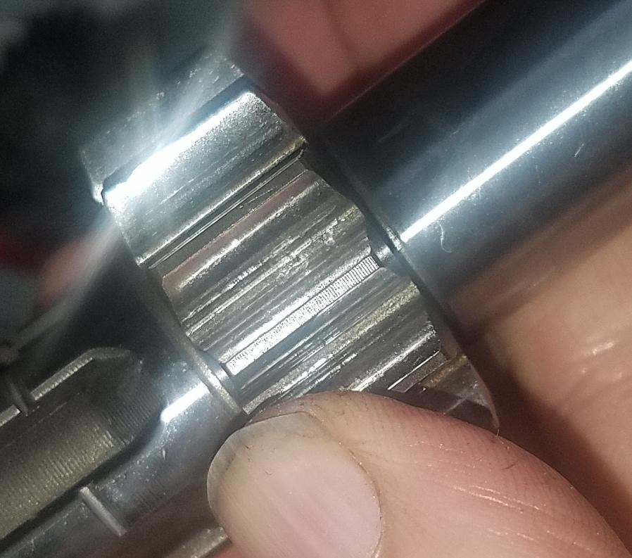

Both these gears have a bit of wear but no worry..
KX GURU RACING 1992 KX500 SNOW BIKE ENGINE BUILD FOR BRENT 111.JPG (66.34 KiB) Viewed 10859 times

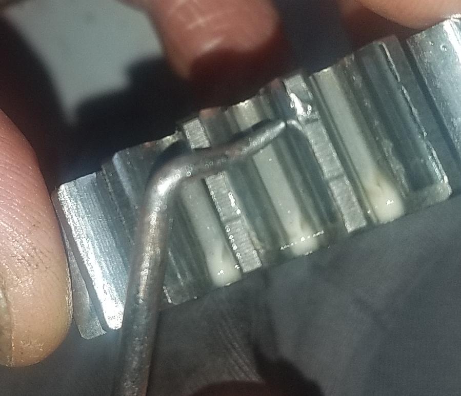

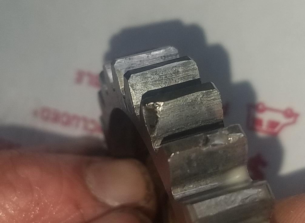

The small clutch basket gear has a chip out of it..
KX GURU RACING 1992 KX500 SNOW BIKE ENGINE BUILD FOR BRENT 113.JPG (69.66 KiB) Viewed 10858 times

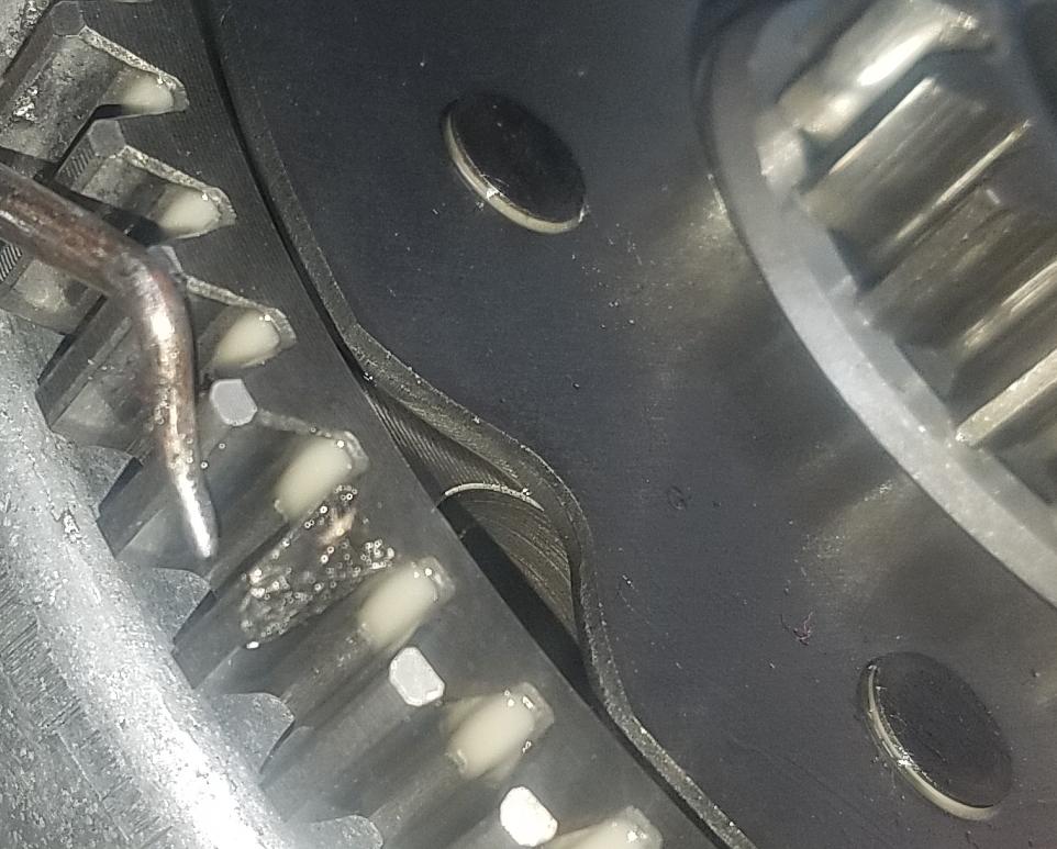

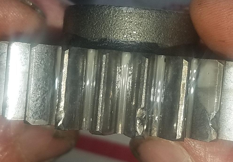

And the big one is bad as well :shock:
KX GURU RACING 1992 KX500 SNOW BIKE ENGINE BUILD FOR BRENT 114.JPG (100.42 KiB) Viewed 10858 times

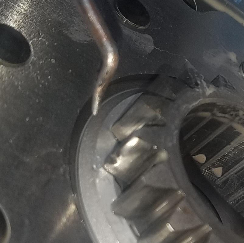

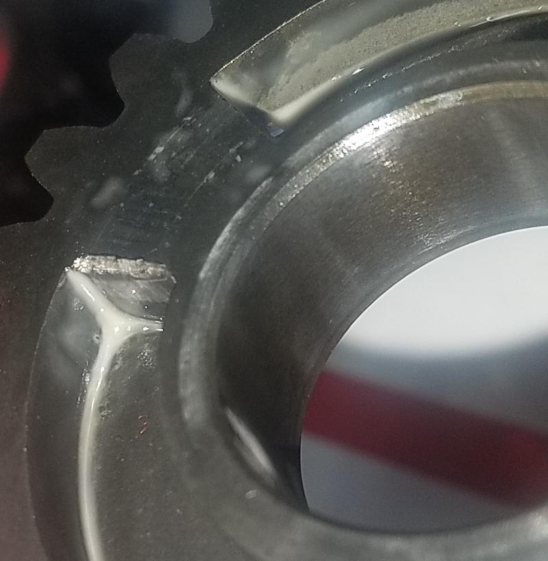

More gear damage..
KX GURU RACING 1992 KX500 SNOW BIKE ENGINE BUILD FOR BRENT 115.JPG (61.93 KiB) Viewed 10857 times
KX GURU RACING 1992 KX500 SNOW BIKE ENGINE BUILD FOR BRENT 116.JPG (104.35 KiB) Viewed 10857 times

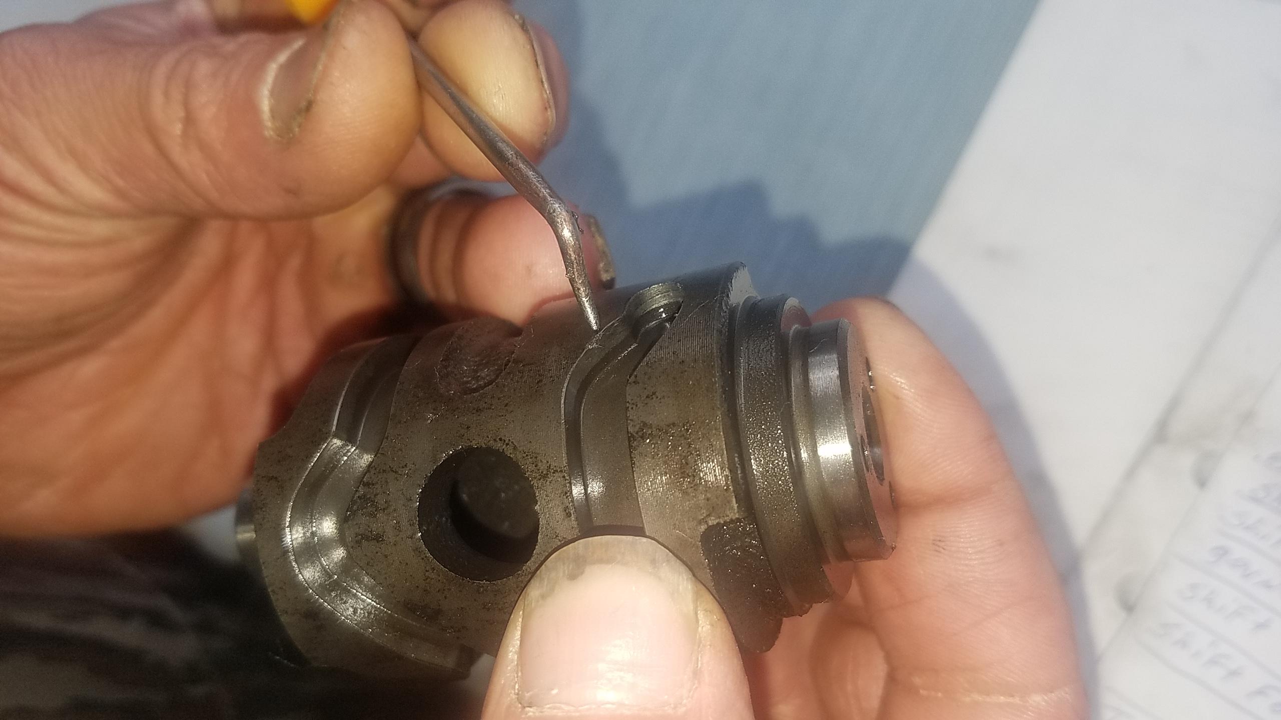

More damage...
KX GURU RACING 1992 KX500 SNOW BIKE ENGINE BUILD FOR BRENT 117.JPG (70.16 KiB) Viewed 10842 times
More damage...
KX GURU RACING 1992 KX500 SNOW BIKE ENGINE BUILD FOR BRENT 118.JPG (295.12 KiB) Viewed 10842 times

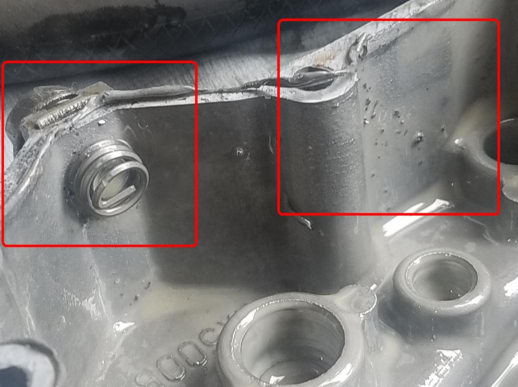

Note the 4mm pin for the center flapper?
Can you say Jacked up!!!
