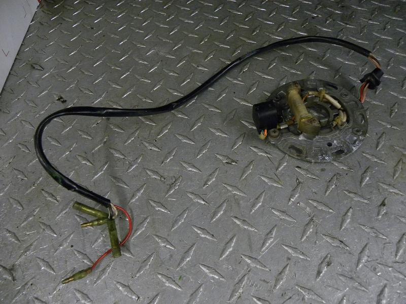

And, does your stator look like this?
- WWW.OEM-CYCLE.COM 1991 KX250 STATOR PIC.JPG (94.49 KiB) Viewed 17323 times

Yh that all looks the same I have red w/g w/r bk/r w coming out the engine and I've got all of the above coming out the cdi plus Orange black/white black/yellow
