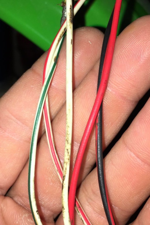

Hi I need some halp I have fully restored my kx 250 1991 and now can't seem to get a spark its bean 2 years since I took my cdi of and can't remember how it was wired up as I got 1 White wire left over halp please thanks

So tell us, where are all your wires going right now?

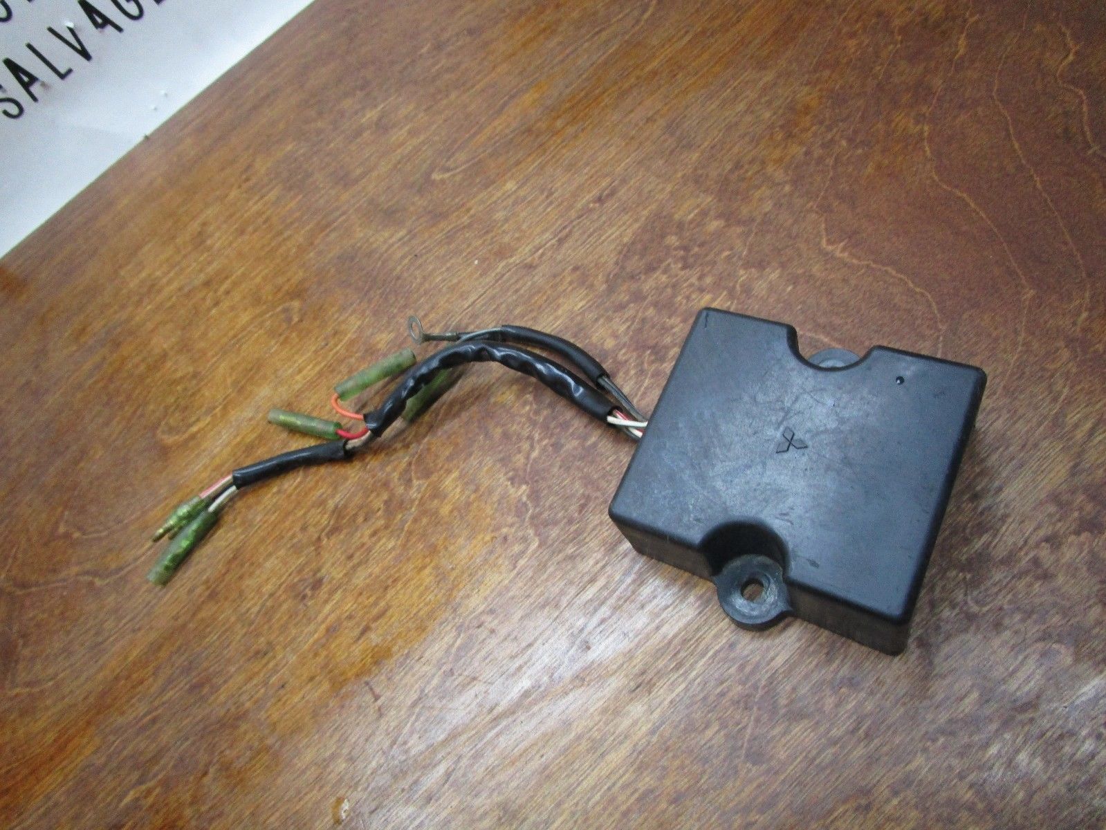

And does your CDI look like this?
WWW.OEM-CYCLE.COM 1991 KX250 STATOR CDI PIC.jpg (326.75 KiB) Viewed 17314 times

Yh that all looks the same I have red w/g w/r bk/r w coming out the engine and I've got all of the above coming out the cdi plus Orange black/white black/yellow

Ok this is what I got
