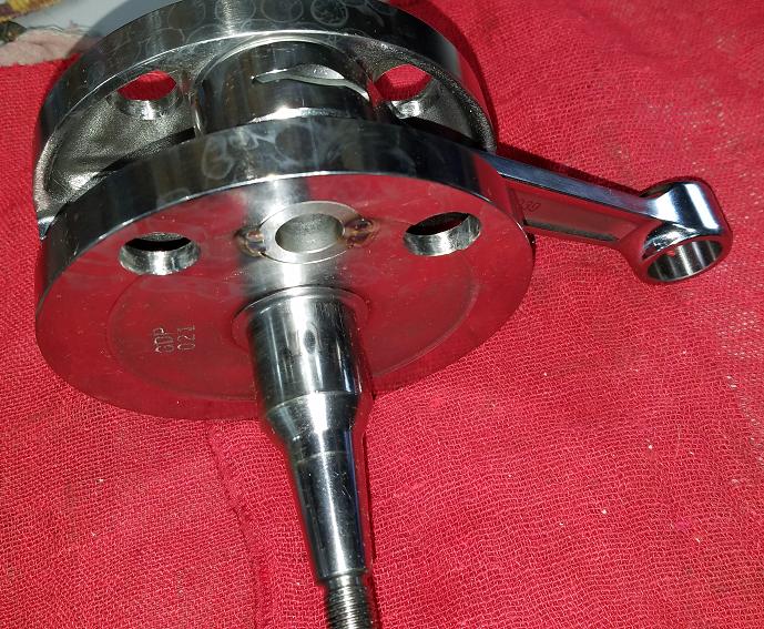

But before I get into that, I already had a KX500 crank on hand and ready to go... Balanced and polished with a Wossner rod...

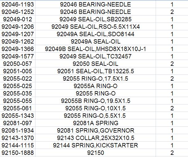

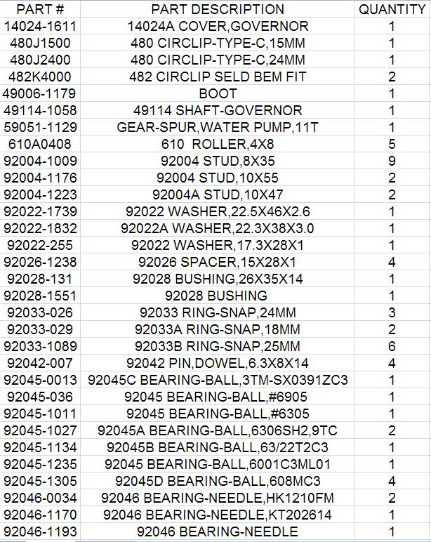

And, I had our basic parts list on order with our local Kawasaki dealer..
kx500 basic parts list 101.JPG (164.42 KiB) Viewed 9400 times
kx500 basic parts list 102.JPG (97.98 KiB) Viewed 9400 times

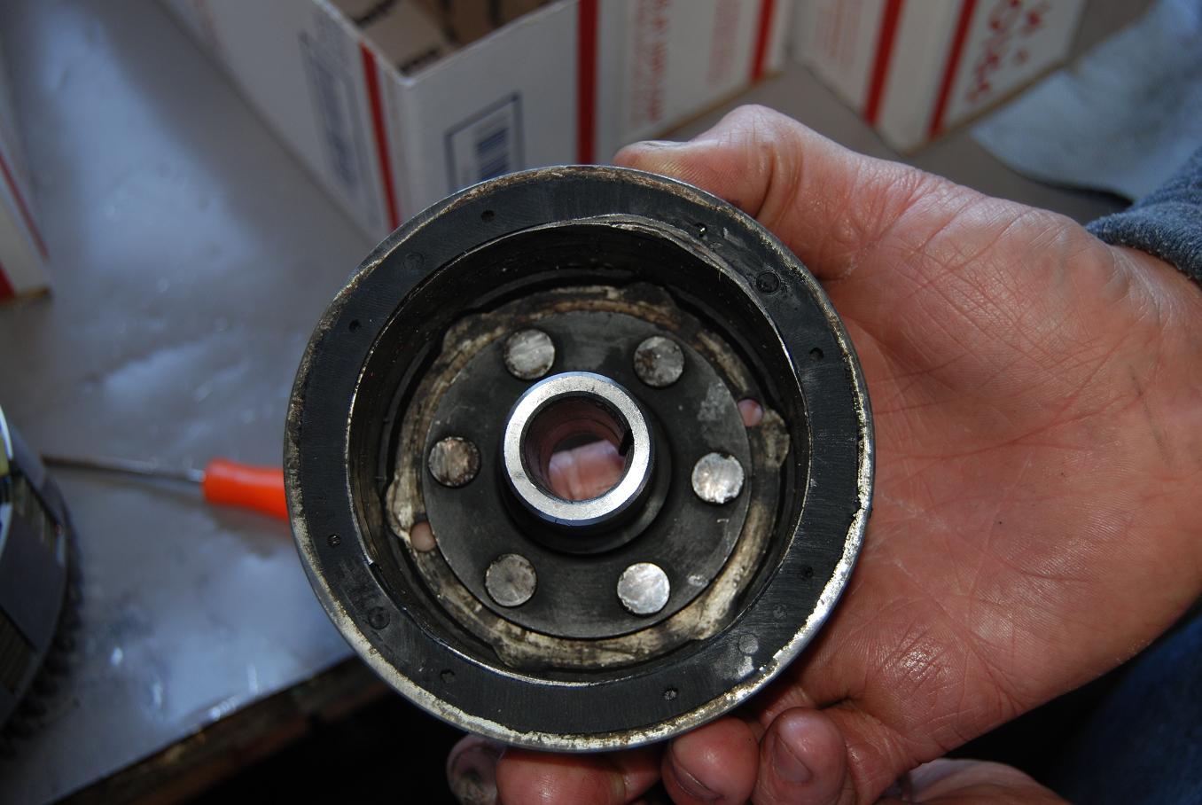

The flywheel had some unexpected damage..
JT ENGINE WORKS AND OEM-CYCLE KX500 BOTTOM END REBUILD 103.JPG (156.25 KiB) Viewed 9399 times
I have never seen one quite like that before..

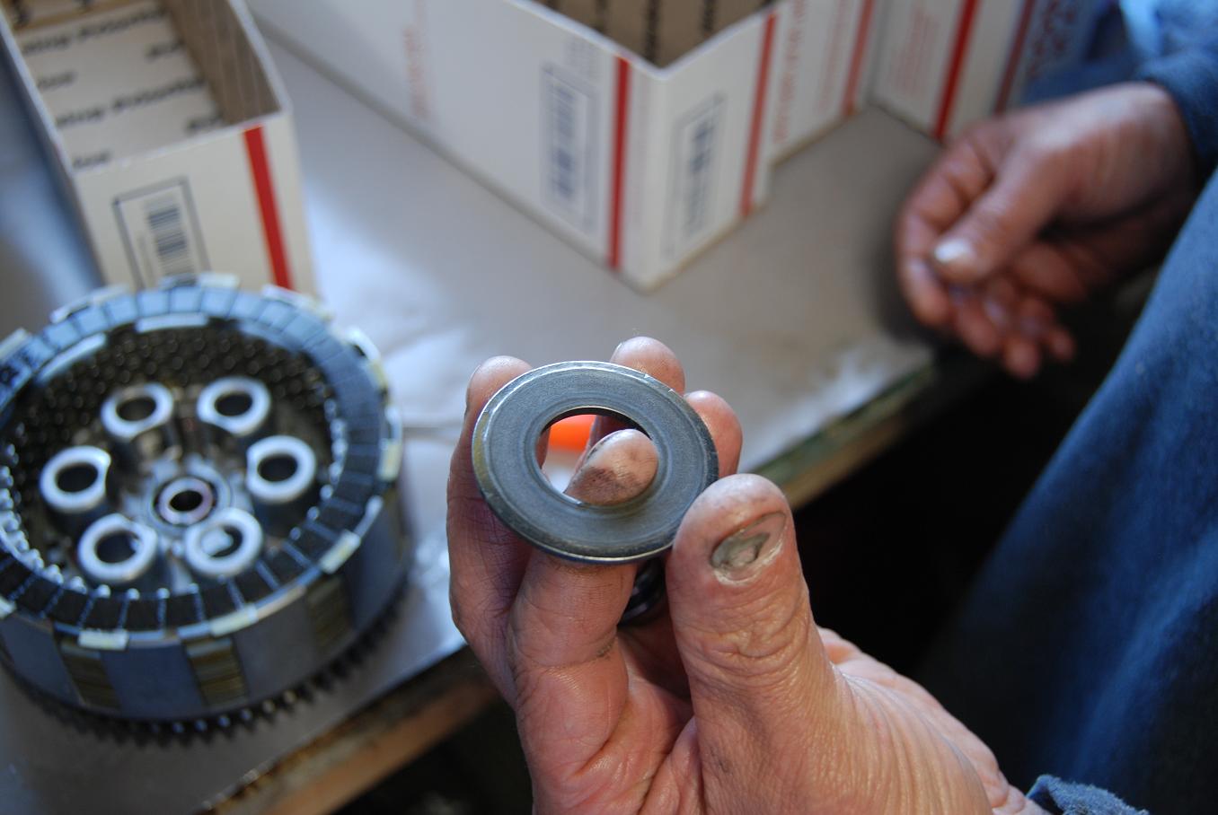

Next I noticed that the clutch washer was really worn..
JT ENGINE WORKS AND OEM-CYCLE KX500 BOTTOM END REBUILD 104.JPG (133.45 KiB) Viewed 9399 times
Something was definitely up on this engine..

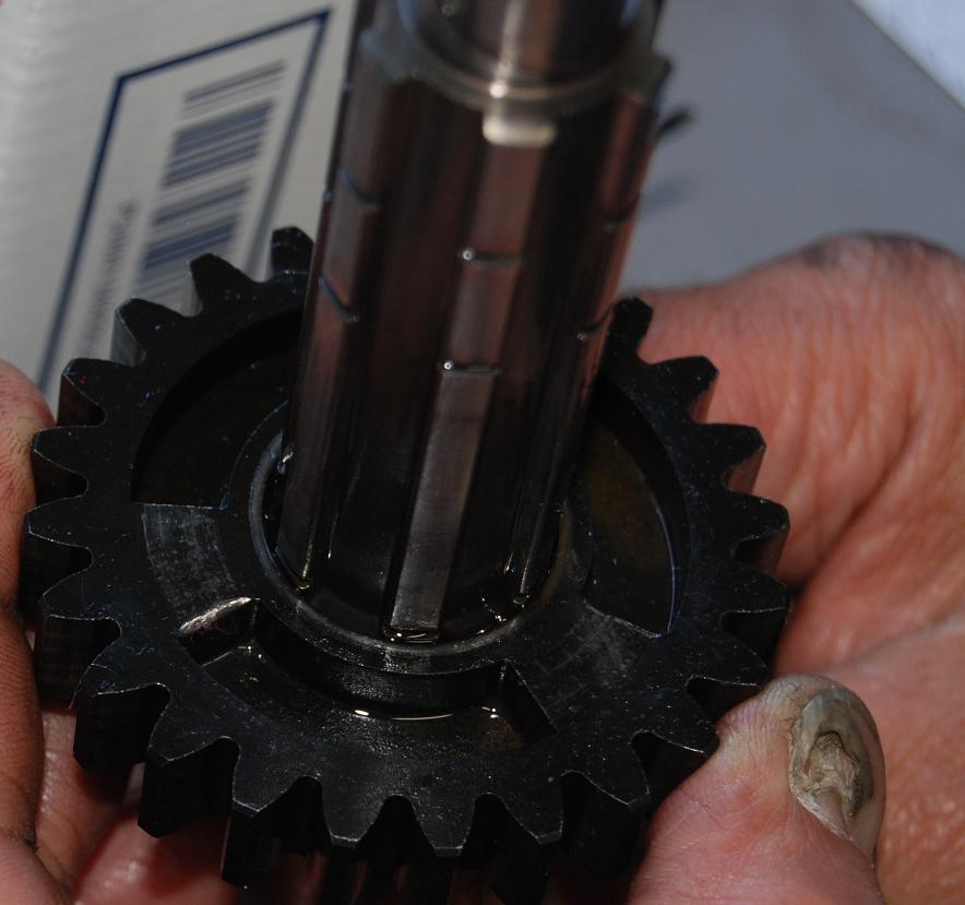

All but three gears are junk... Both shafts are also done for :x
JT ENGINE WORKS AND OEM-CYCLE KX500 BOTTOM END REBUILD 107.JPG (55.32 KiB) Viewed 9386 times
JT ENGINE WORKS AND OEM-CYCLE KX500 BOTTOM END REBUILD 108.JPG (72.89 KiB) Viewed 9386 times

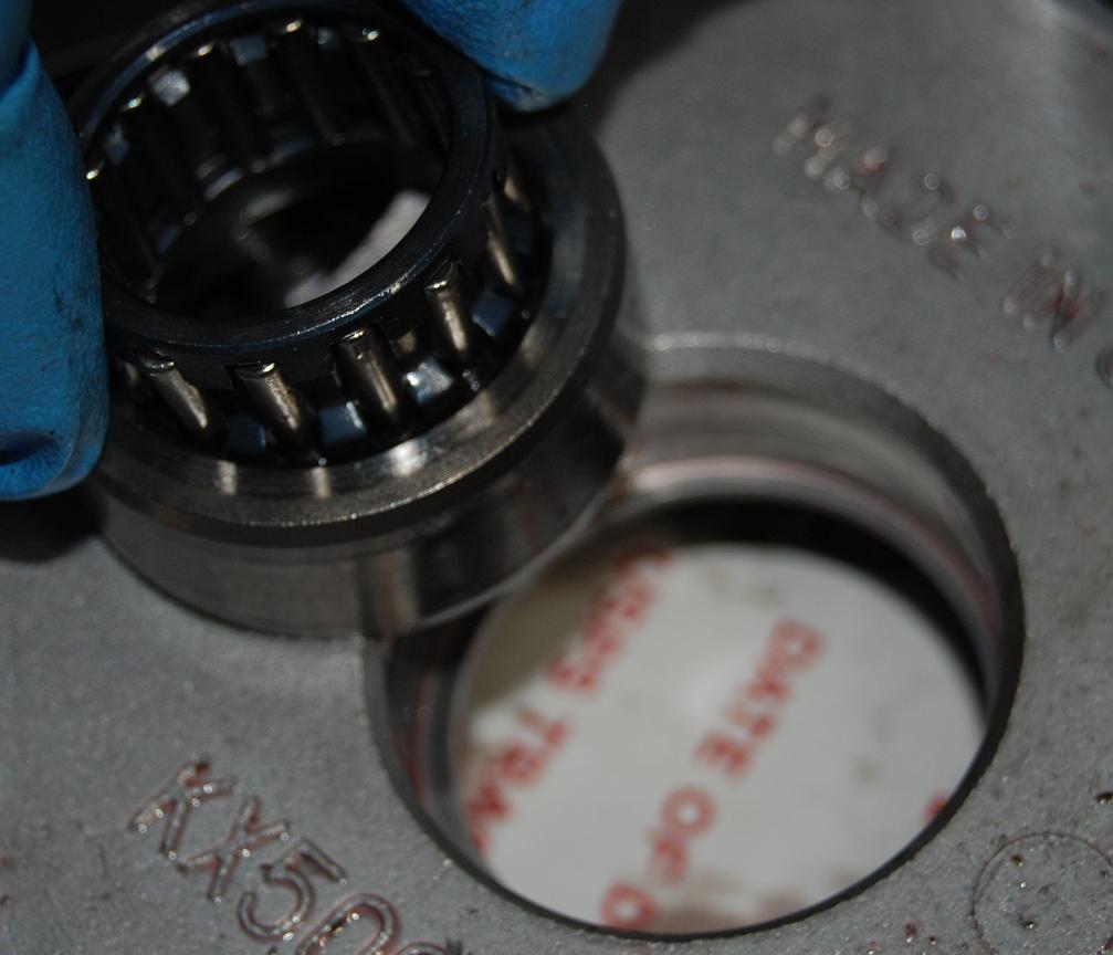

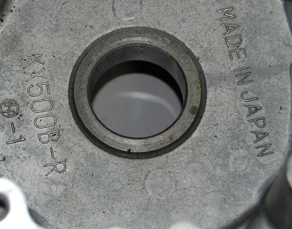

Then we discovered the problem...
Here is another case out of my top secret stash..
See the steel insert where the output trans shaft goes?
JT ENGINE WORKS AND OEM-CYCLE KX500 BOTTOM END REBUILD 110.JPG (137.24 KiB) Viewed 9384 times

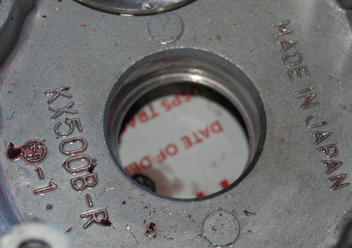

This engine had no insert..
JT ENGINE WORKS AND OEM-CYCLE KX500 BOTTOM END REBUILD 111.JPG (126.15 KiB) Viewed 9384 times
That means that the output shaft was just flopping around in there...
It's a wonder the engine did not grenade... :o
JT ENGINE WORKS AND OEM-CYCLE KX500 BOTTOM END REBUILD 112.JPG (63.92 KiB) Viewed 9384 times

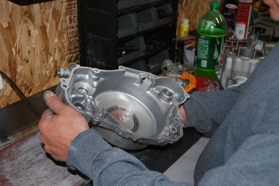

The cases and clutch cover were warped pretty bad.
We had to spend some time on the granite surface plate before we could even lap..
JT ENGINE WORKS AND OEM-CYCLE KX500 BOTTOM END REBUILD 113.JPG (125.42 KiB) Viewed 9383 times
In all fairness, someone had welded the clutch cover fairly extensively..
JT ENGINE WORKS AND OEM-CYCLE KX500 BOTTOM END REBUILD 114.JPG (116.52 KiB) Viewed 9383 times

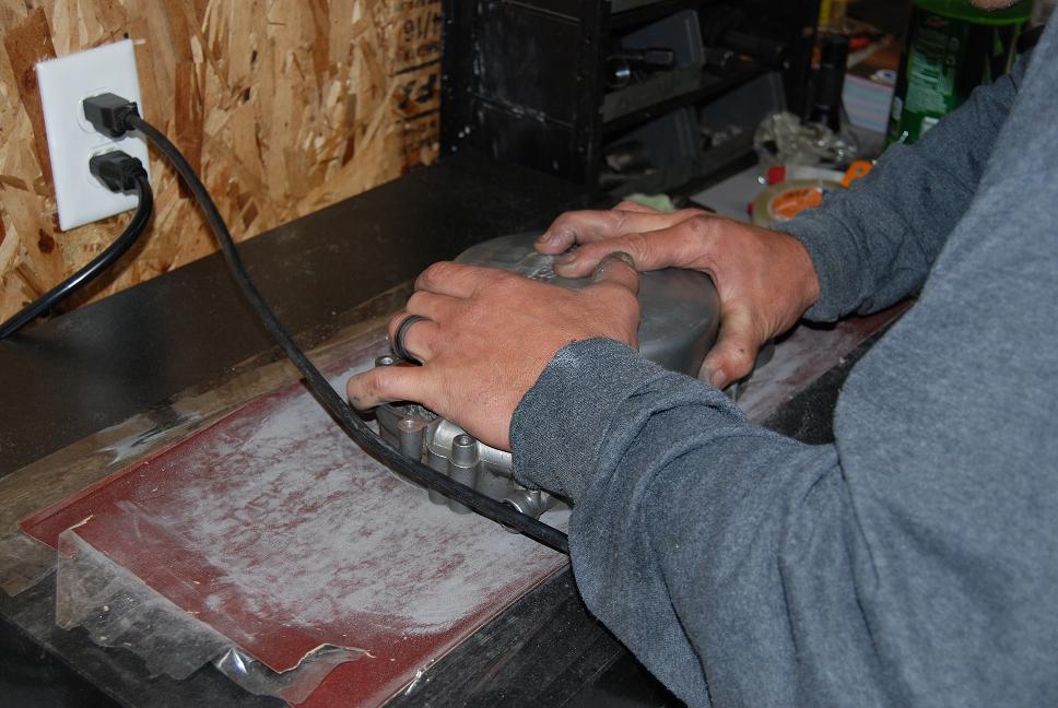

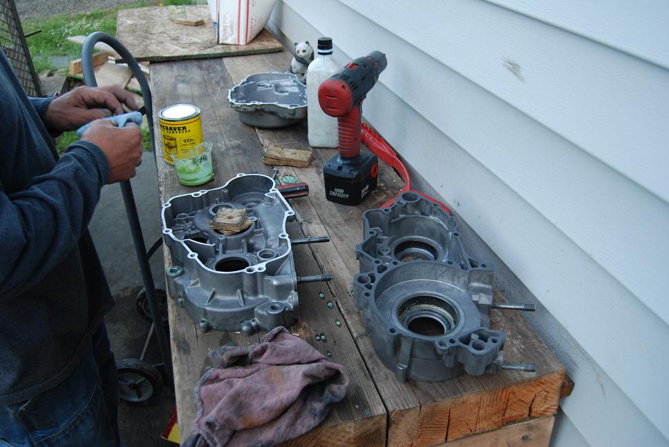

Once that was done Jason mixed up some Timesaver, 100 grit (Very fine) and started lapping the cases to insure a positive fit with no air leaks..
JT ENGINE WORKS AND OEM-CYCLE KX500 BOTTOM END REBUILD 115.JPG (132.47 KiB) Viewed 9383 times
Timesaver is so amazing... I thank Motorrad every time I use this stuff..
Bolt one case to the table so it doesn't walk around on you and go to town
JT ENGINE WORKS AND OEM-CYCLE KX500 BOTTOM END REBUILD 116.JPG (122.39 KiB) Viewed 9383 times
Re: KX500 BOTTOM END REBUILD FOR SCOT By JT Engine Works & OEM-CYCLE
Posted: Wed May 11, 2016 12:53 am
Back and forth, side to side, swirl and swirly.. Repeat..Repeat..Repeat..Repeat..Repeat..Repeat..Repeat..Repeat..Repeat..Repeat.. ect...

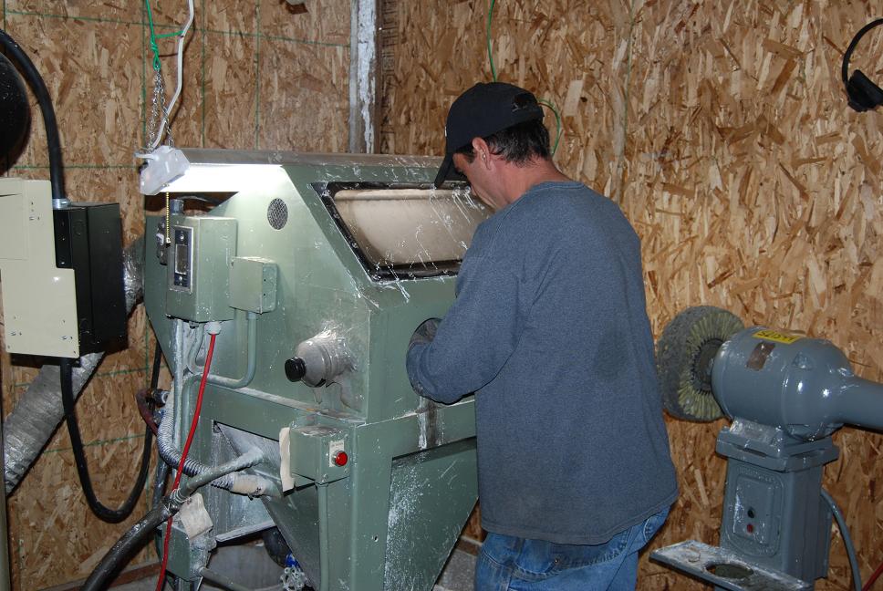

Jason on the Vapor Blaster..
JT ENGINE WORKS AND OEM-CYCLE KX500 BOTTOM END REBUILD 119.JPG (149.11 KiB) Viewed 9381 times

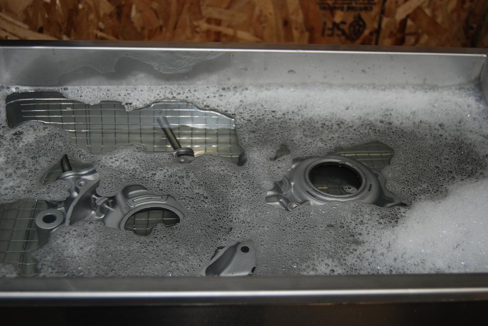

Then into the Ultrasonic cleaner
JT ENGINE WORKS AND OEM-CYCLE KX500 BOTTOM END REBUILD 120.JPG (106.32 KiB) Viewed 9381 times
JT ENGINE WORKS AND OEM-CYCLE KX500 BOTTOM END REBUILD 121.JPG (121.01 KiB) Viewed 9381 times
Posted: Wed May 11, 2016 12:59 am
The results are amazing..

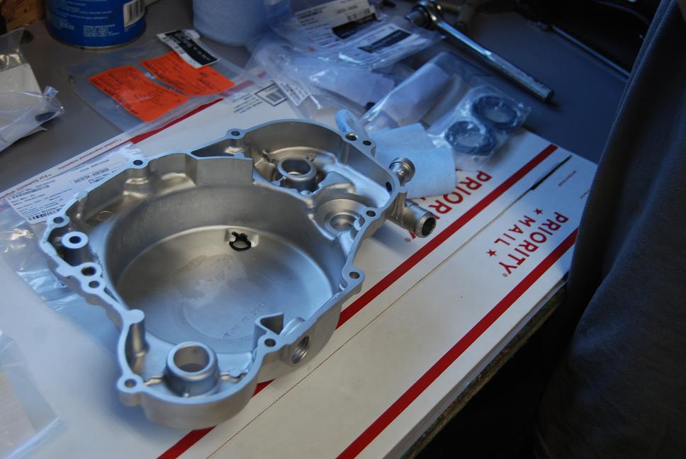

New parts..
JT ENGINE WORKS AND OEM-CYCLE KX500 BOTTOM END REBUILD 125.JPG (90.59 KiB) Viewed 9378 times
More new parts..
JT ENGINE WORKS AND OEM-CYCLE KX500 BOTTOM END REBUILD 126.JPG (110.36 KiB) Viewed 9378 times
Waiting... waiting...
JT ENGINE WORKS AND OEM-CYCLE KX500 BOTTOM END REBUILD 127.JPG (108.92 KiB) Viewed 9378 times

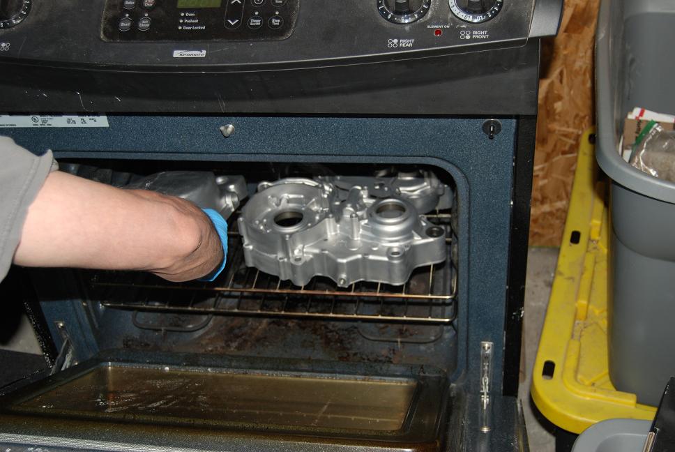

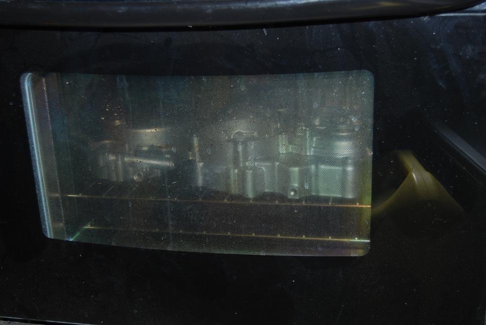

Posted: Wed May 11, 2016 2:00 am
Ready for bearings and seals..
JT ENGINE WORKS AND OEM-CYCLE KX500 BOTTOM END REBUILD 128.JPG (120.64 KiB) Viewed 9377 times
Hot!!!
