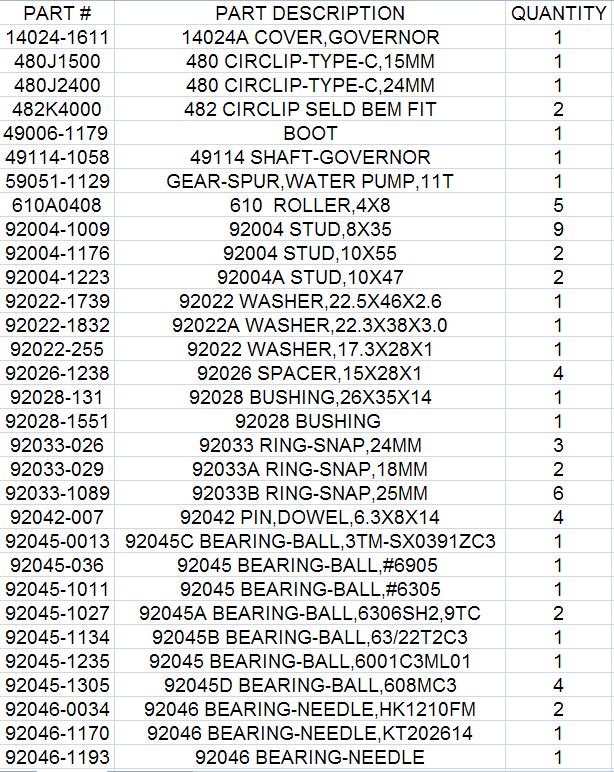

And, I had our basic parts list on order with our local Kawasaki dealer..
kx500 basic parts list 101.JPG (164.42 KiB) Viewed 9397 times
kx500 basic parts list 102.JPG (97.98 KiB) Viewed 9397 times

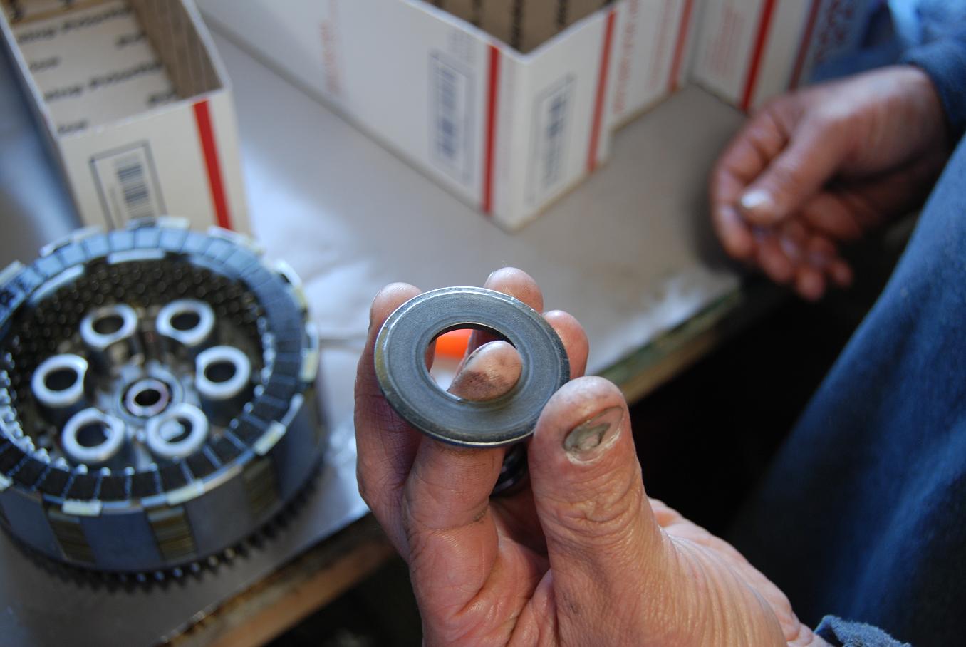

Next I noticed that the clutch washer was really worn..
JT ENGINE WORKS AND OEM-CYCLE KX500 BOTTOM END REBUILD 104.JPG (133.45 KiB) Viewed 9396 times
Something was definitely up on this engine..

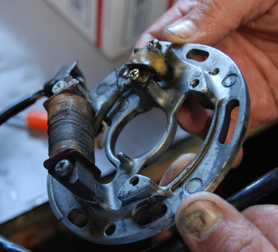

Re: KX500 BOTTOM END REBUILD FOR SCOT By JT Engine Works & OEM-CYCLE
Needless to say, we will be checking the ohm specs on this before it ever goes back into the engine...
There will also be a bit of clean up involved :lol:
JT ENGINE WORKS AND OEM-CYCLE KX500 BOTTOM END REBUILD 105.JPG (78.25 KiB) Viewed 9383 times

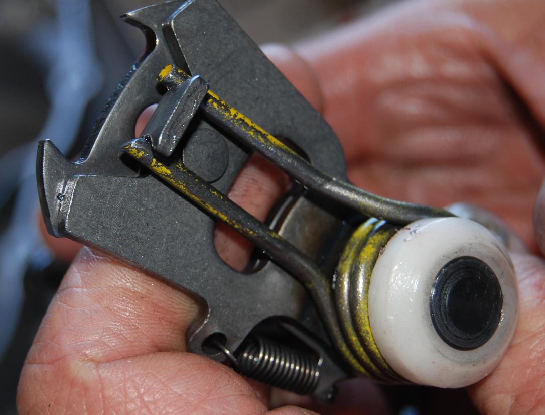

Man, even the shift shaft spring is worn out :?:
JT ENGINE WORKS AND OEM-CYCLE KX500 BOTTOM END REBUILD 106.JPG (90.58 KiB) Viewed 9383 times

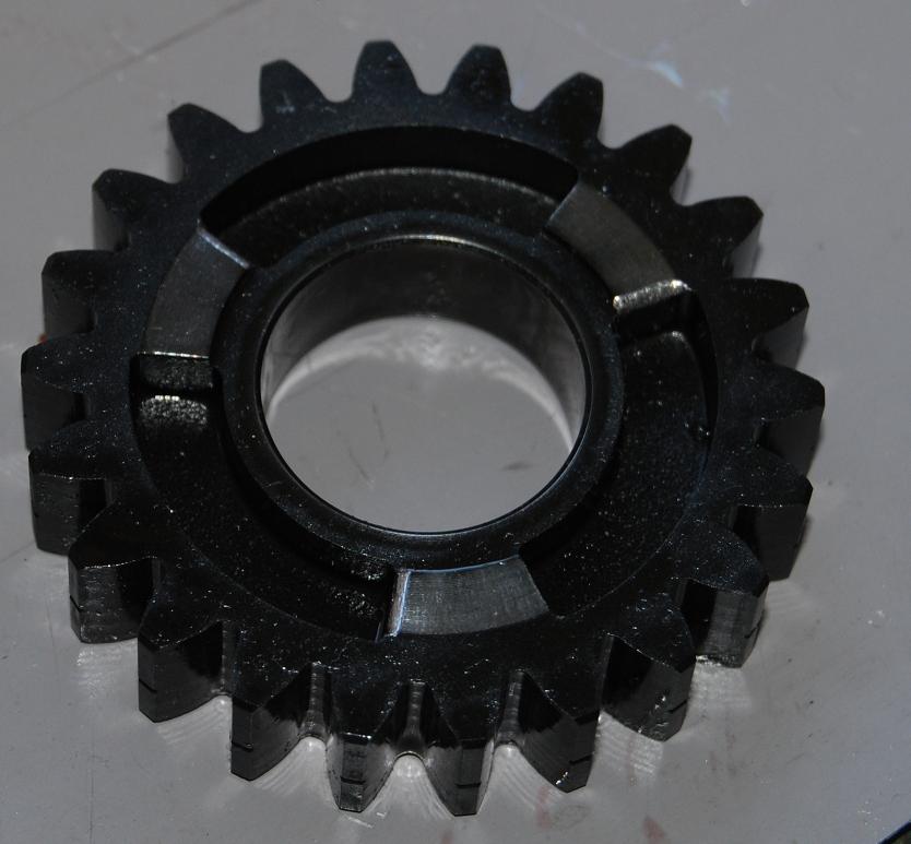

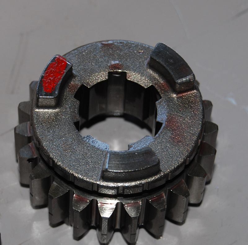

All but three gears are junk... Both shafts are also done for :x
JT ENGINE WORKS AND OEM-CYCLE KX500 BOTTOM END REBUILD 107.JPG (55.32 KiB) Viewed 9383 times
JT ENGINE WORKS AND OEM-CYCLE KX500 BOTTOM END REBUILD 108.JPG (72.89 KiB) Viewed 9383 times
Now you might be saying... Wait a minute, can't you get the gear dogs undercut?
Normally yes, however, the splines that the gears attach to the shafts on are worn out.
And the snap rings that hold the gears in their relative positions are completely wallered out....
Definitely something bad happened here..

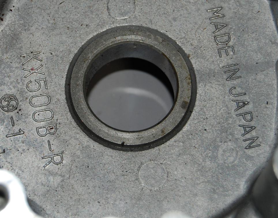

Then we discovered the problem...
Here is another case out of my top secret stash..
See the steel insert where the output trans shaft goes?
JT ENGINE WORKS AND OEM-CYCLE KX500 BOTTOM END REBUILD 110.JPG (137.24 KiB) Viewed 9381 times
This engine had no insert..
JT ENGINE WORKS AND OEM-CYCLE KX500 BOTTOM END REBUILD 111.JPG (126.15 KiB) Viewed 9381 times
That means that the output shaft was just flopping around in there...
It's a wonder the engine did not grenade... :o
JT ENGINE WORKS AND OEM-CYCLE KX500 BOTTOM END REBUILD 112.JPG (63.92 KiB) Viewed 9381 times

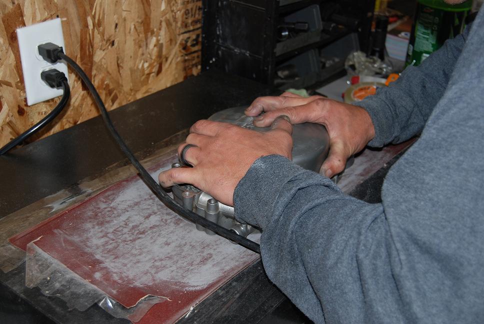

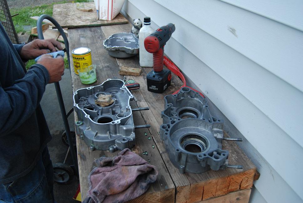

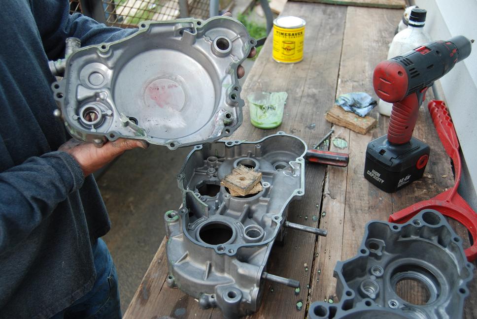

Once that was done Jason mixed up some Timesaver, 100 grit (Very fine) and started lapping the cases to insure a positive fit with no air leaks..
JT ENGINE WORKS AND OEM-CYCLE KX500 BOTTOM END REBUILD 115.JPG (132.47 KiB) Viewed 9380 times
Timesaver is so amazing... I thank Motorrad every time I use this stuff..

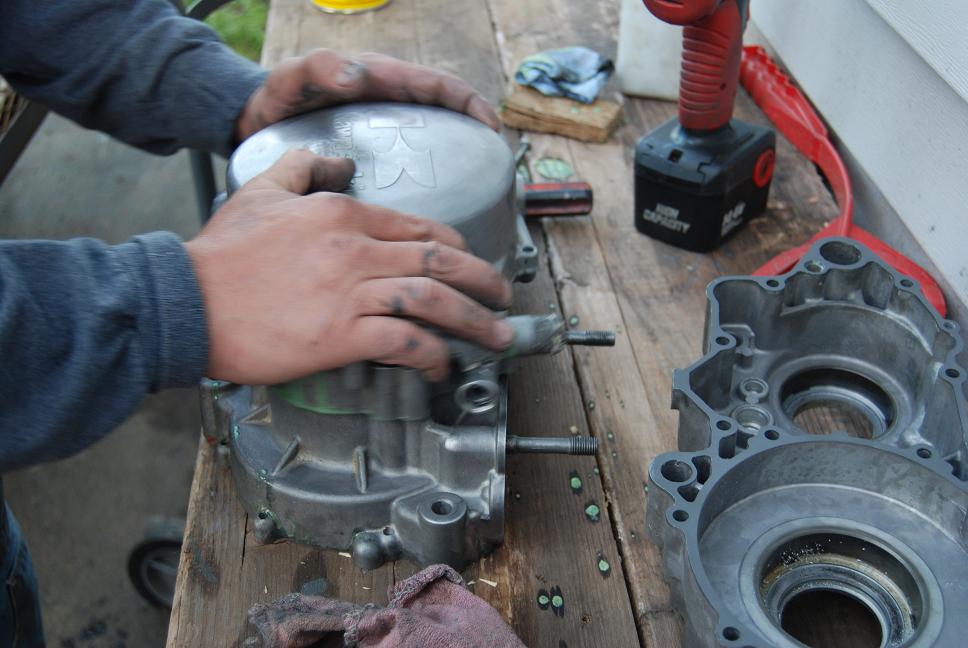

Bolt one case to the table so it doesn't walk around on you and go to town
JT ENGINE WORKS AND OEM-CYCLE KX500 BOTTOM END REBUILD 116.JPG (122.39 KiB) Viewed 9380 times
Back and forth, side to side, swirl and swirly.. Repeat..Repeat..Repeat..Repeat..Repeat..Repeat..Repeat..Repeat..Repeat..Repeat.. ect...

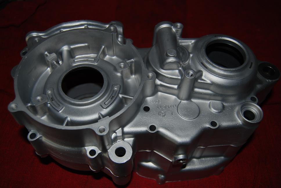

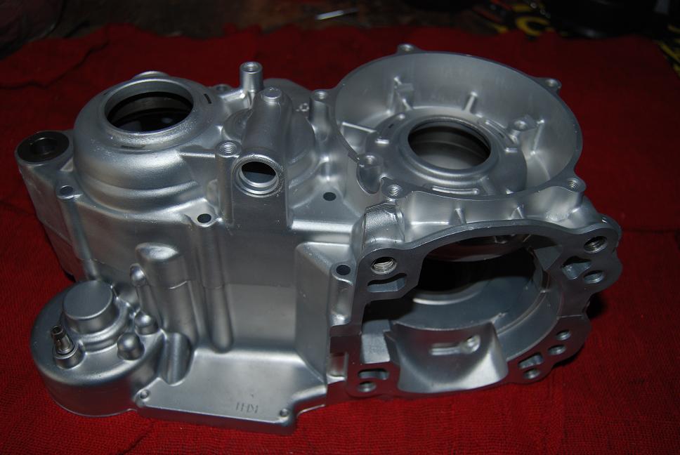

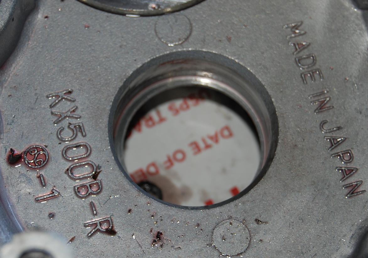

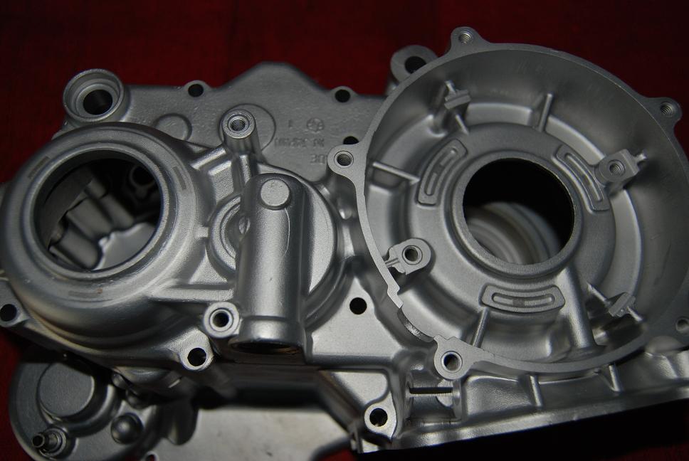

The results are amazing..
JT ENGINE WORKS AND OEM-CYCLE KX500 BOTTOM END REBUILD 122.JPG (95.87 KiB) Viewed 9377 times
JT ENGINE WORKS AND OEM-CYCLE KX500 BOTTOM END REBUILD 123.JPG (105.15 KiB) Viewed 9377 times
JT ENGINE WORKS AND OEM-CYCLE KX500 BOTTOM END REBUILD 124.JPG (99.42 KiB) Viewed 9377 times

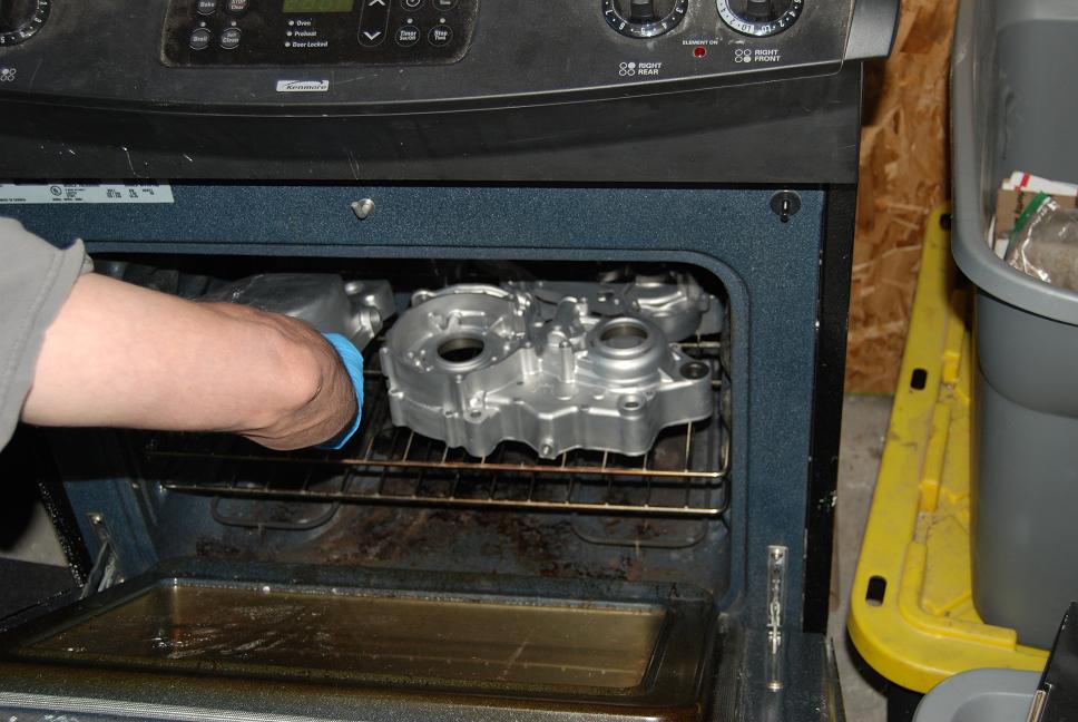

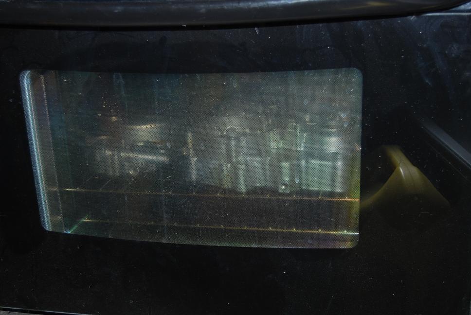

Ready for bearings and seals..
JT ENGINE WORKS AND OEM-CYCLE KX500 BOTTOM END REBUILD 128.JPG (120.64 KiB) Viewed 9374 times
Hot!!!
JT ENGINE WORKS AND OEM-CYCLE KX500 BOTTOM END REBUILD 129.JPG (104.71 KiB) Viewed 9374 times
