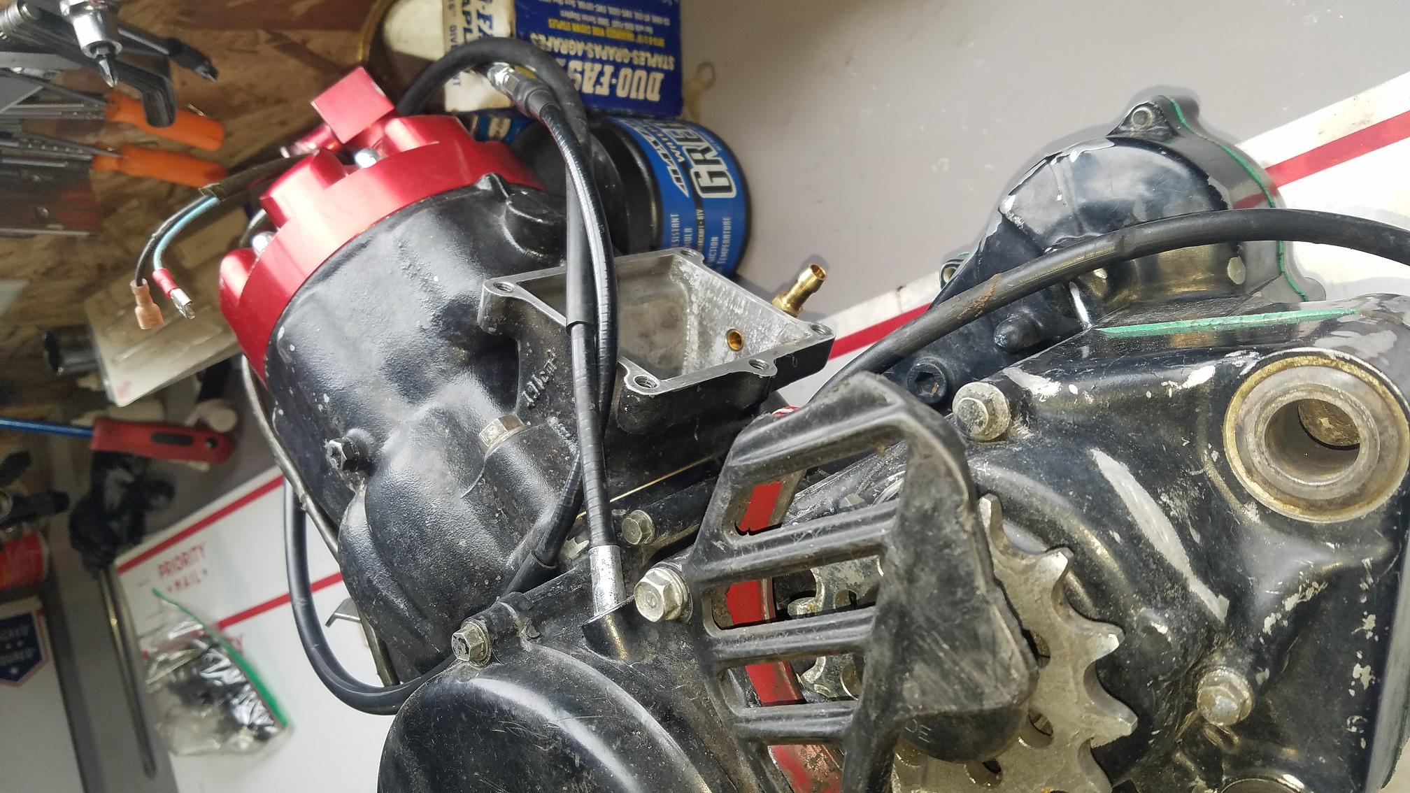

Posted: Wed Apr 27, 2016 2:36 am
This is what we are starting with..
JT ENGINE WORKS 89 CR500 CART ENGINE BUILD 10.JPG (388.85 KiB) Viewed 11041 times
JT ENGINE WORKS 89 CR500 CART ENGINE BUILD 11.JPG (360.21 KiB) Viewed 11041 times
JT ENGINE WORKS 89 CR500 CART ENGINE BUILD 12.JPG (385.6 KiB) Viewed 11041 times

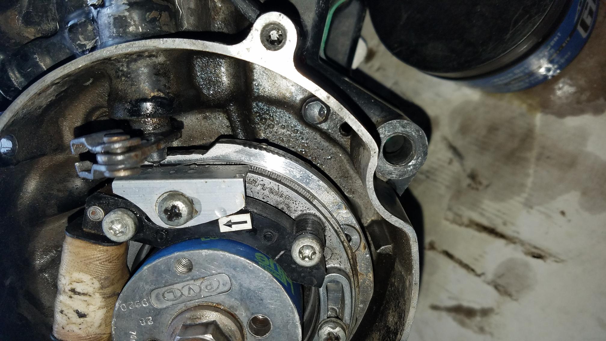

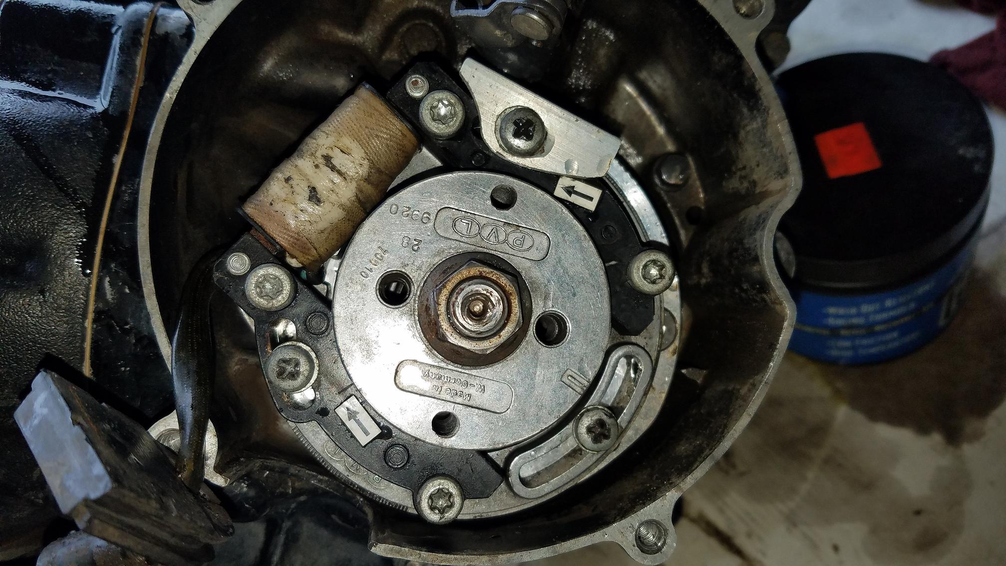

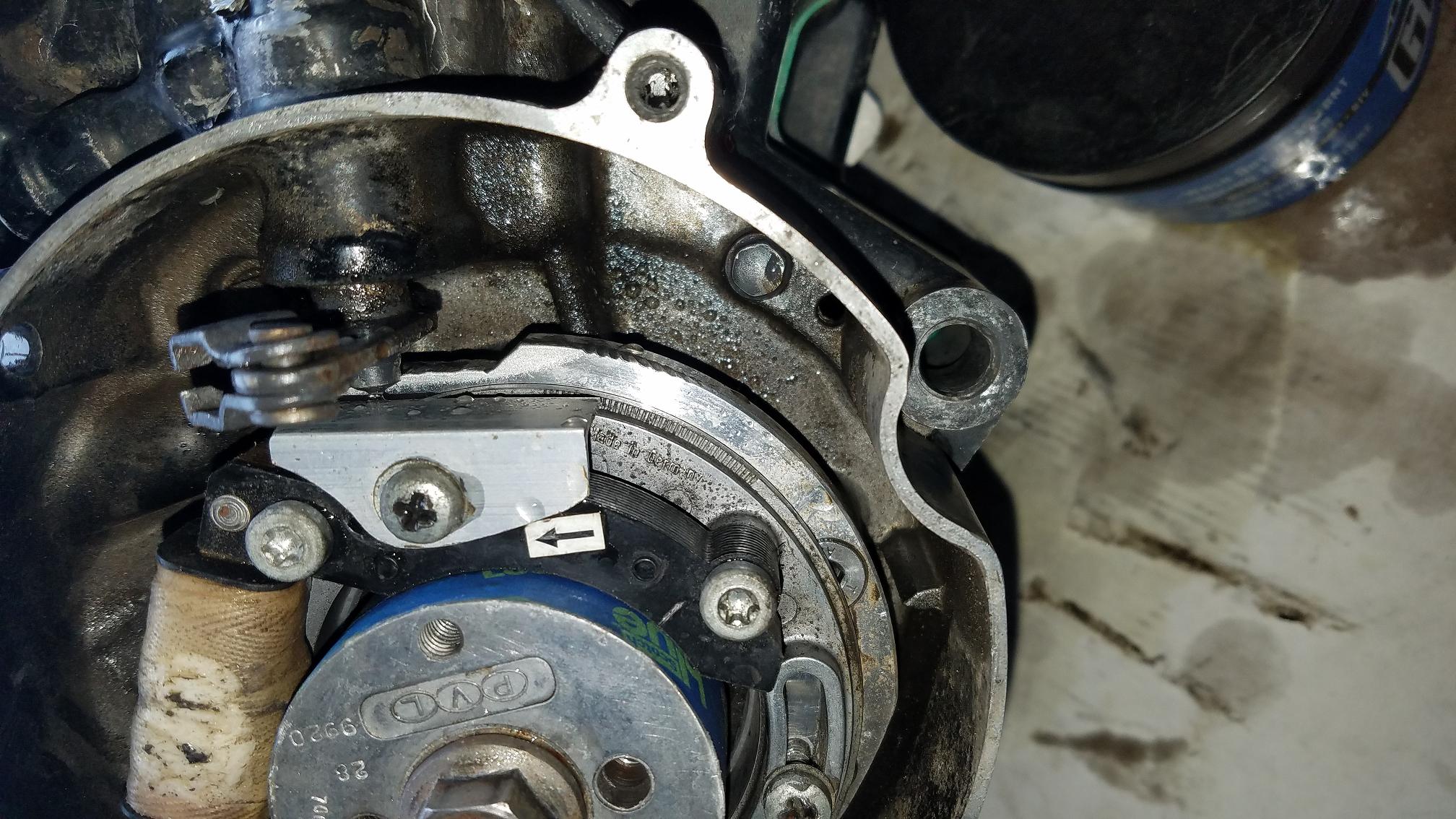

Cracked open the stator cover and found a nice little surprise! :lol:
Light weight fly wheel... Yes!! and other goodies...
JT ENGINE WORKS 89 CR500 CART ENGINE BUILD 14.JPG (382.92 KiB) Viewed 11040 times
JT ENGINE WORKS 89 CR500 CART ENGINE BUILD 15.JPG (386.99 KiB) Viewed 11040 times

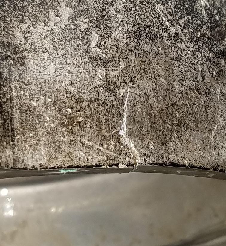

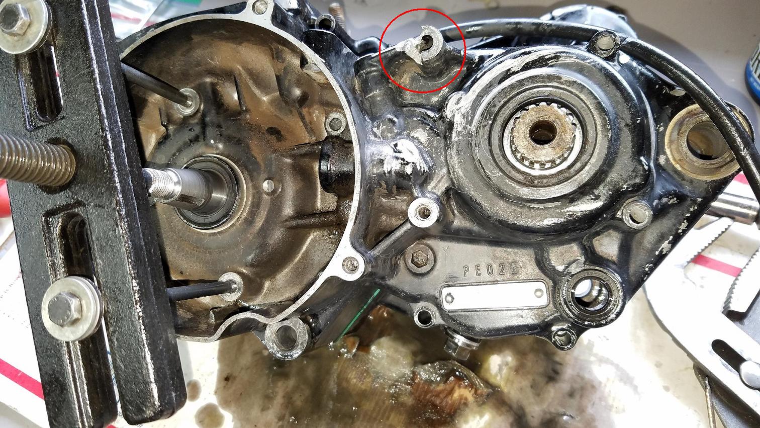

Posted: Wed Apr 27, 2016 2:41 am

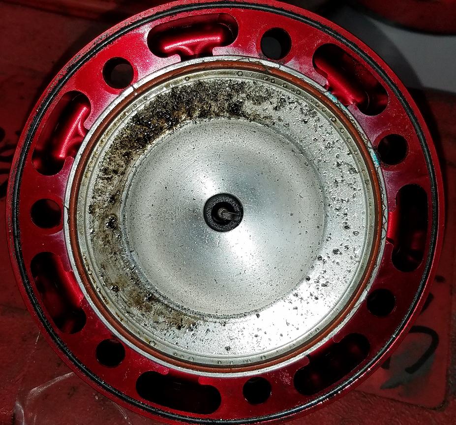

Cool head!
JT ENGINE WORKS 89 CR500 CART ENGINE BUILD 16.JPG (106.36 KiB) Viewed 11039 times

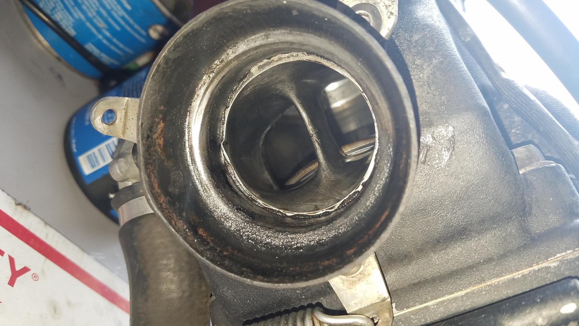

Ugh! Not so cool..
JT ENGINE WORKS 89 CR500 CART ENGINE BUILD 17.JPG (209.77 KiB) Viewed 11039 times

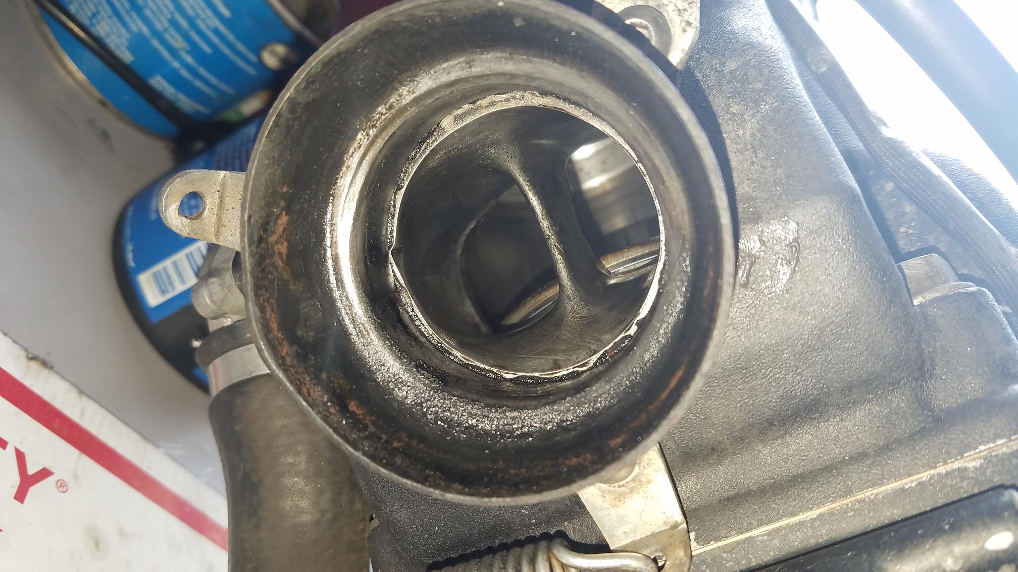

Oh no... A crack...
JT ENGINE WORKS 89 CR500 CART ENGINE BUILD 101.JPG (338.63 KiB) Viewed 11039 times

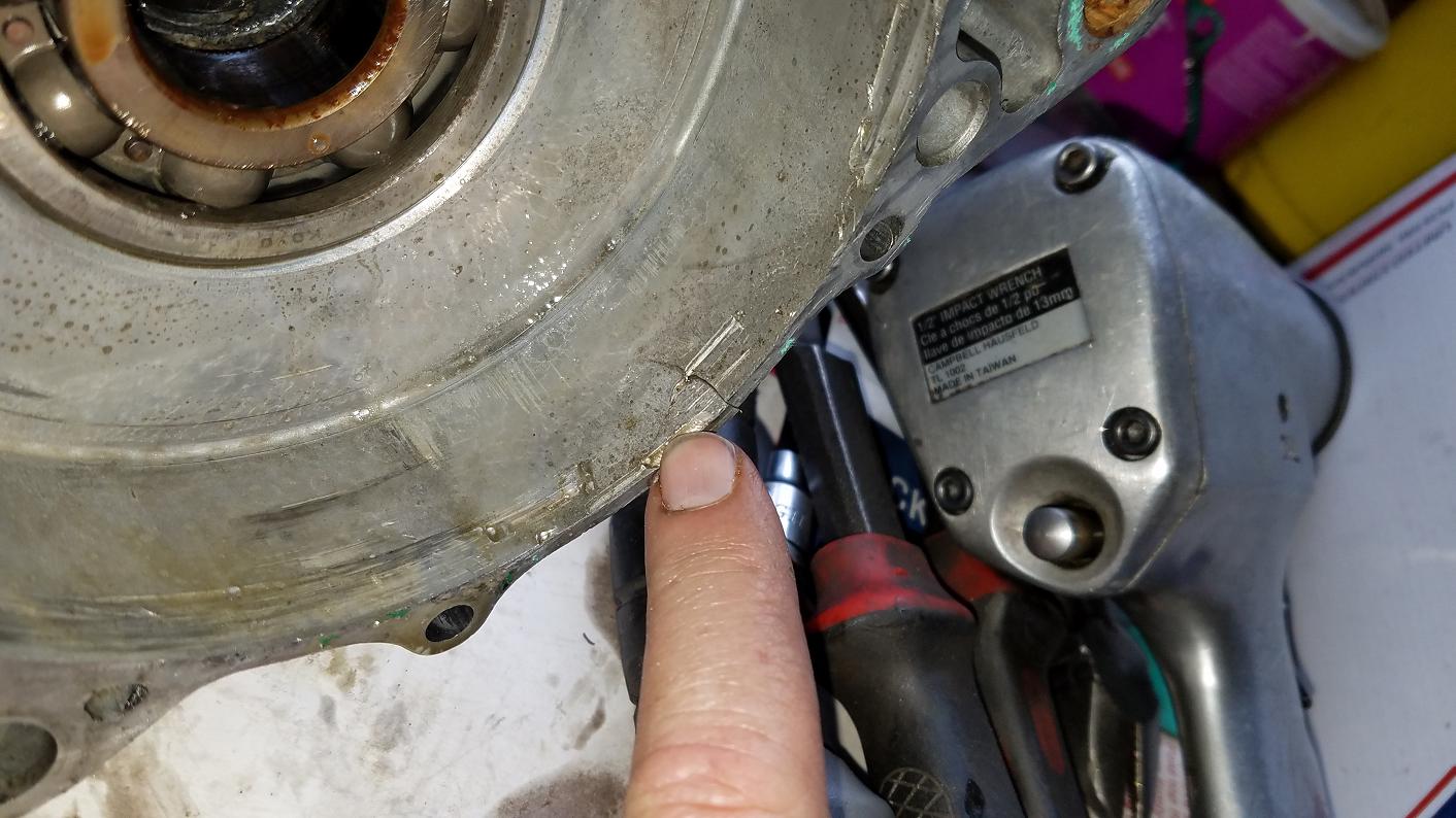

Posted: Wed Apr 27, 2016 2:43 am
I see some improvement to be had..
JT ENGINE WORKS 89 CR500 CART ENGINE BUILD 102.JPG (327.75 KiB) Viewed 11037 times
Looks good..
JT ENGINE WORKS 89 CR500 CART ENGINE BUILD 103.JPG (166.51 KiB) Viewed 11037 times
Not so fast...
JT ENGINE WORKS 89 CR500 CART ENGINE BUILD 104.JPG (336.88 KiB) Viewed 11037 times

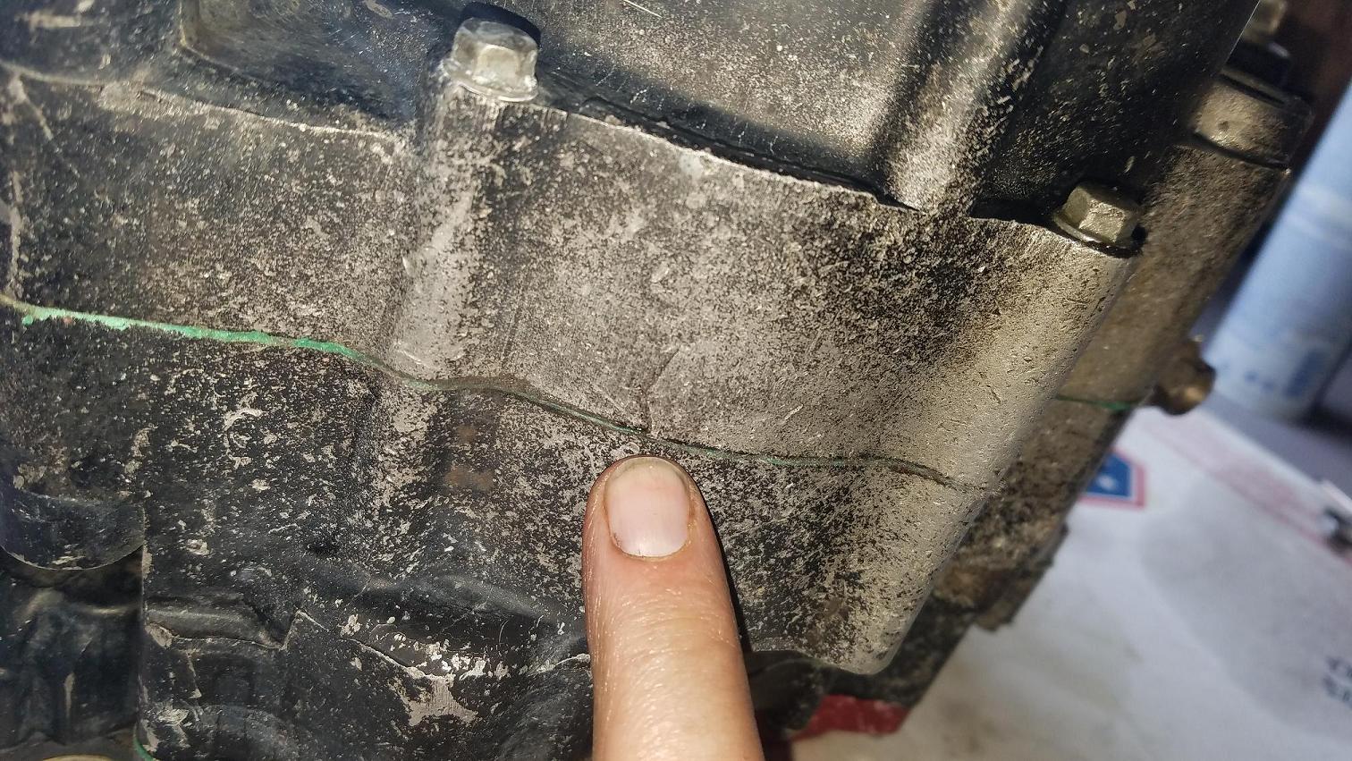

Posted: Fri Apr 29, 2016 12:15 am
Cases are back from weld...
JT ENGINE WORKS 89 CR500 CART ENGINE BUILD 108.JPG (198.5 KiB) Viewed 11015 times
JT ENGINE WORKS 89 CR500 CART ENGINE BUILD 109.JPG (166.65 KiB) Viewed 11015 times
JT ENGINE WORKS 89 CR500 CART ENGINE BUILD 110.JPG (174.47 KiB) Viewed 11015 times
