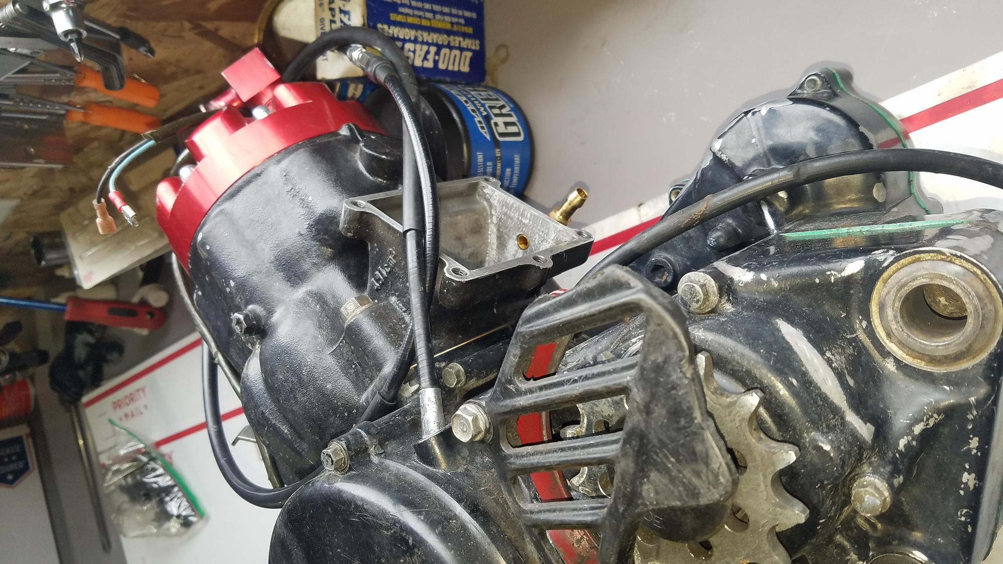

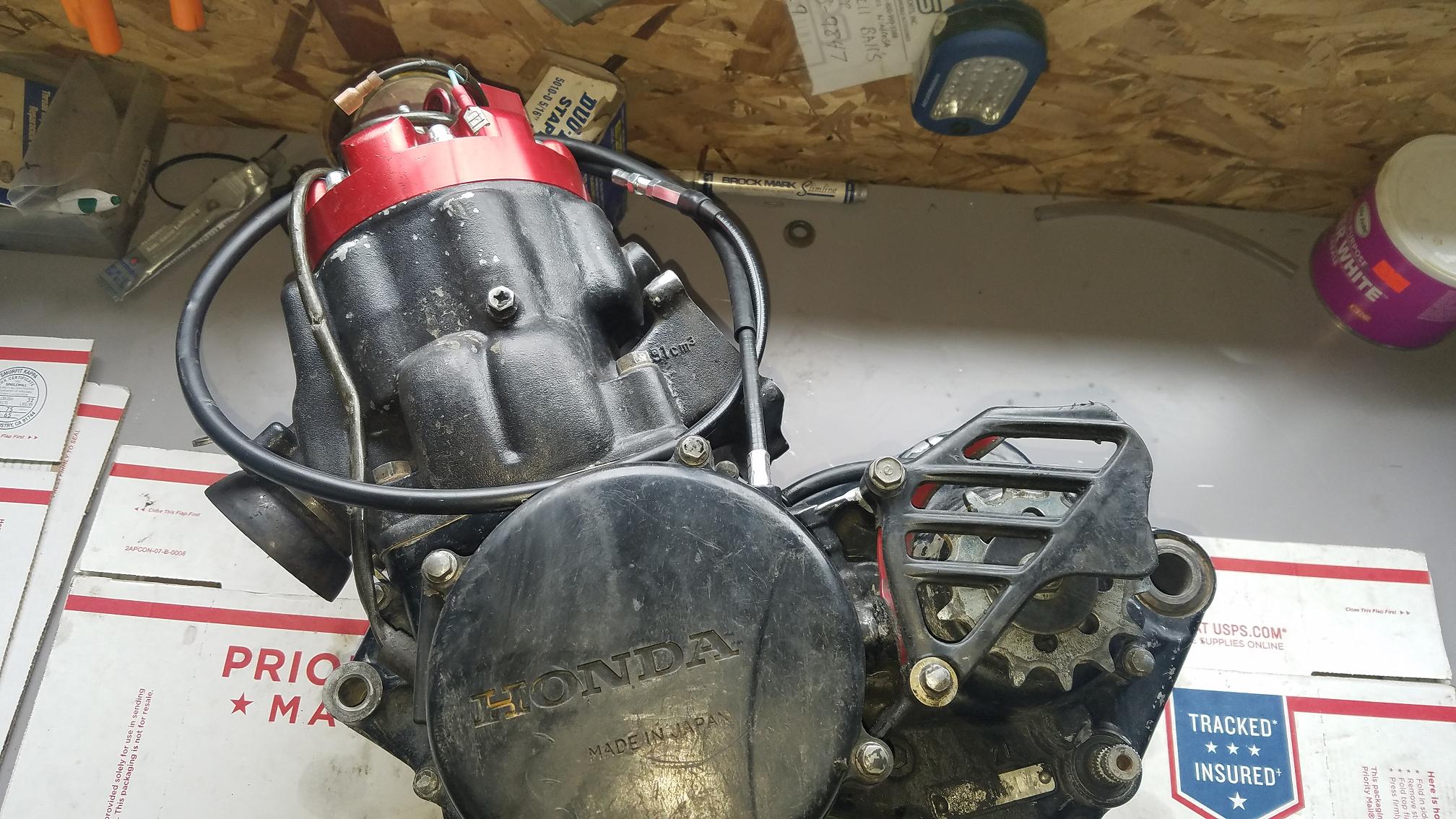

This is what we are starting with..
JT ENGINE WORKS 89 CR500 CART ENGINE BUILD 10.JPG (388.85 KiB) Viewed 11034 times
JT ENGINE WORKS 89 CR500 CART ENGINE BUILD 11.JPG (360.21 KiB) Viewed 11034 times
JT ENGINE WORKS 89 CR500 CART ENGINE BUILD 12.JPG (385.6 KiB) Viewed 11034 times
So, the first thing we did was get out the Hot water pressure washer and get all the dirt and grease off this engine.
I hate cracking open a engine with dirt and grease on it... :)

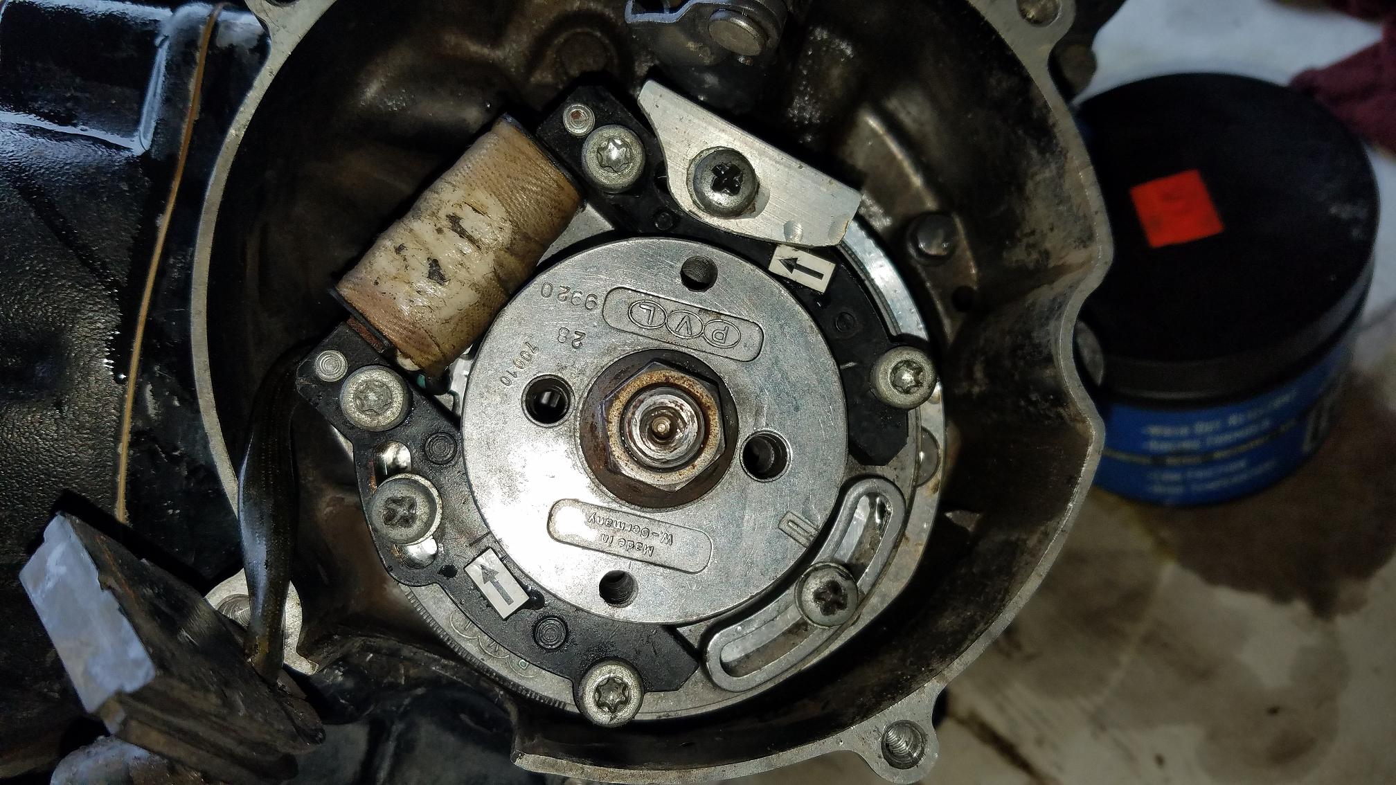

Cracked open the stator cover and found a nice little surprise! :lol:
Light weight fly wheel... Yes!! and other goodies...
JT ENGINE WORKS 89 CR500 CART ENGINE BUILD 14.JPG (382.92 KiB) Viewed 11033 times
JT ENGINE WORKS 89 CR500 CART ENGINE BUILD 15.JPG (386.99 KiB) Viewed 11033 times

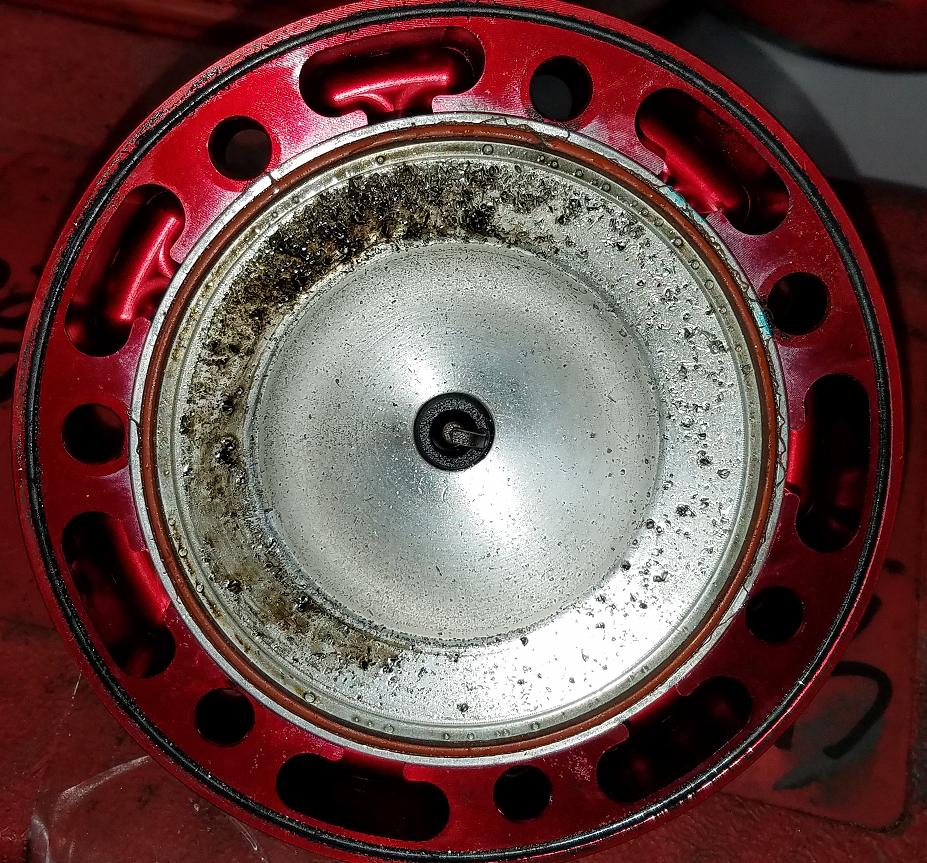

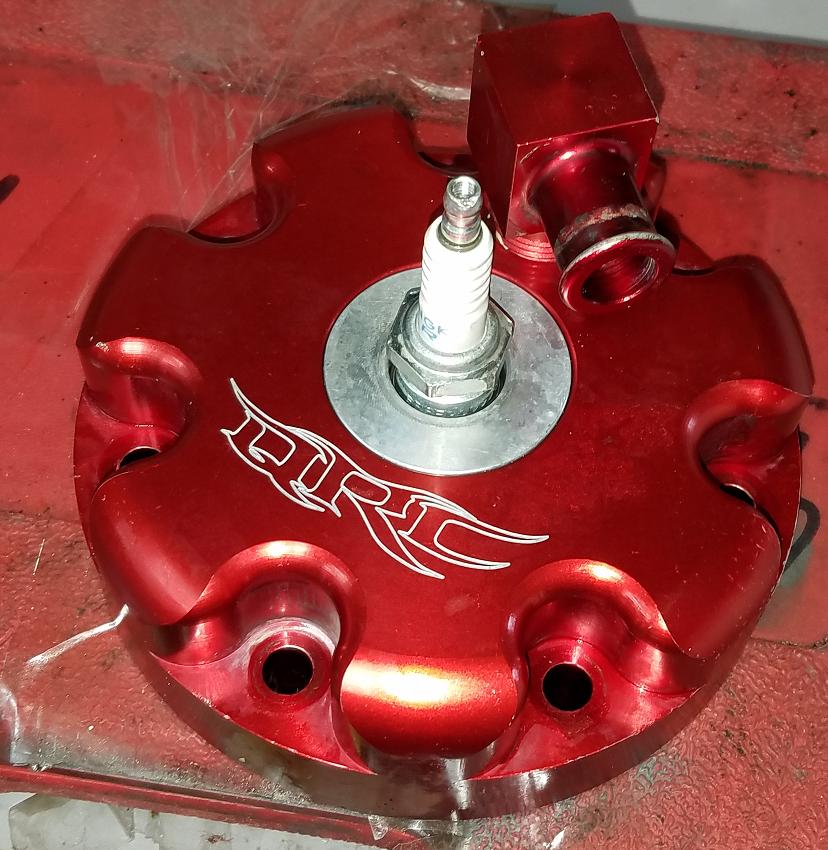

Cool head!
JT ENGINE WORKS 89 CR500 CART ENGINE BUILD 16.JPG (106.36 KiB) Viewed 11032 times

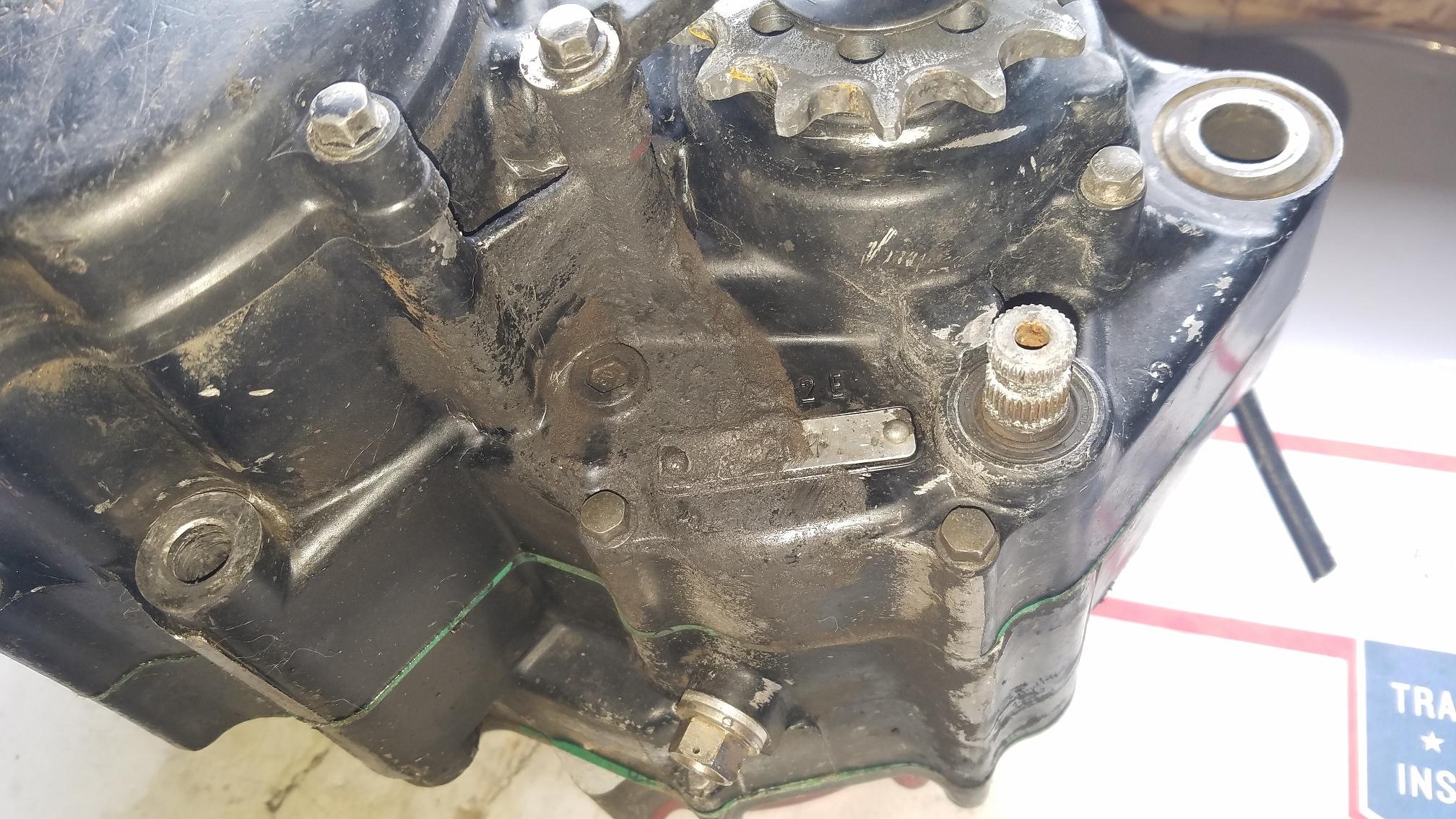

Ugh! Not so cool..
JT ENGINE WORKS 89 CR500 CART ENGINE BUILD 17.JPG (209.77 KiB) Viewed 11032 times

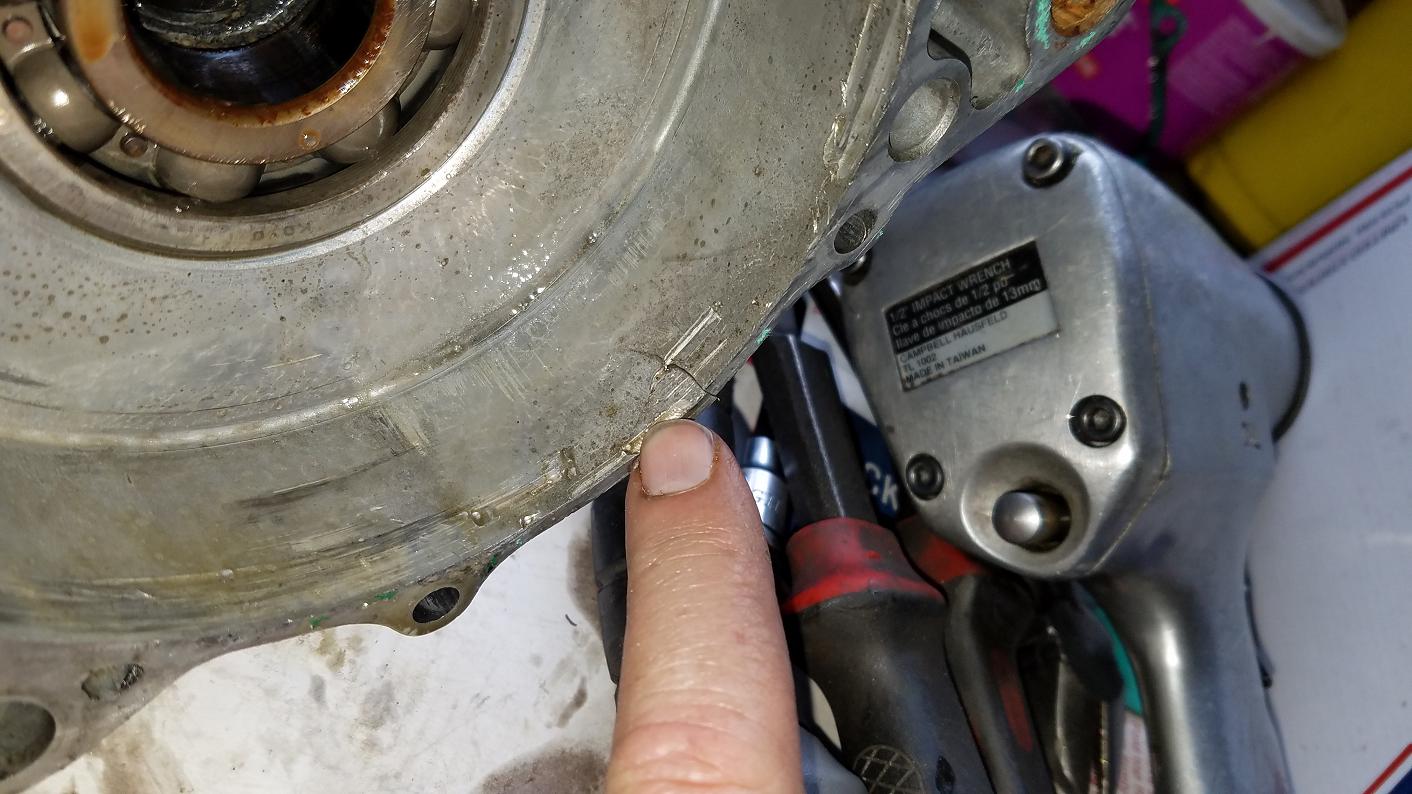

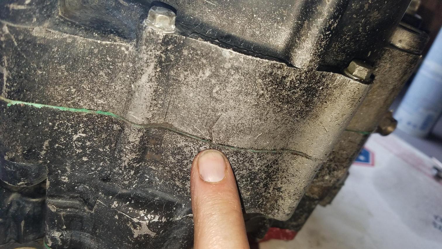

Oh no... A crack...
JT ENGINE WORKS 89 CR500 CART ENGINE BUILD 101.JPG (338.63 KiB) Viewed 11032 times

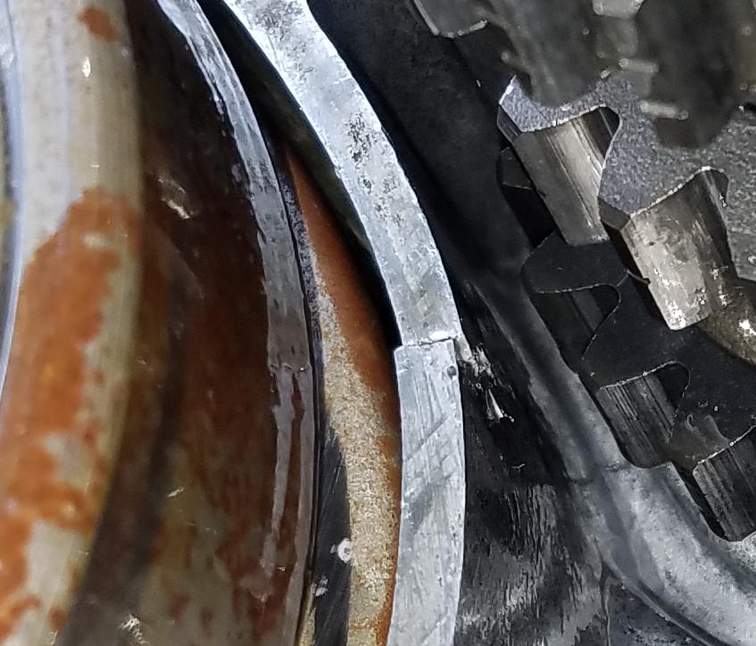

I see some improvement to be had..
JT ENGINE WORKS 89 CR500 CART ENGINE BUILD 102.JPG (327.75 KiB) Viewed 11030 times
Looks good..

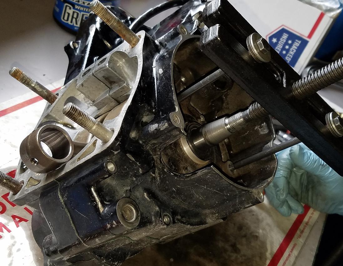

Not so fast...
JT ENGINE WORKS 89 CR500 CART ENGINE BUILD 104.JPG (336.88 KiB) Viewed 11030 times
JT ENGINE WORKS 89 CR500 CART ENGINE BUILD 105.JPG (160 KiB) Viewed 11028 times
JT ENGINE WORKS 89 CR500 CART ENGINE BUILD 106.JPG (156.73 KiB) Viewed 11028 times
JT ENGINE WORKS 89 CR500 CART ENGINE BUILD 107.JPG (87.86 KiB) Viewed 11028 times
So after tear down we know that we have out work cut out for us to get this engine done by the 5th... But we can do it and... Make it a bit faster :ugeek:

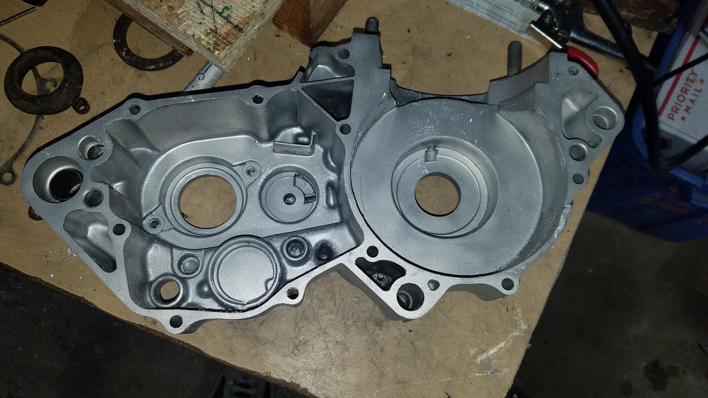

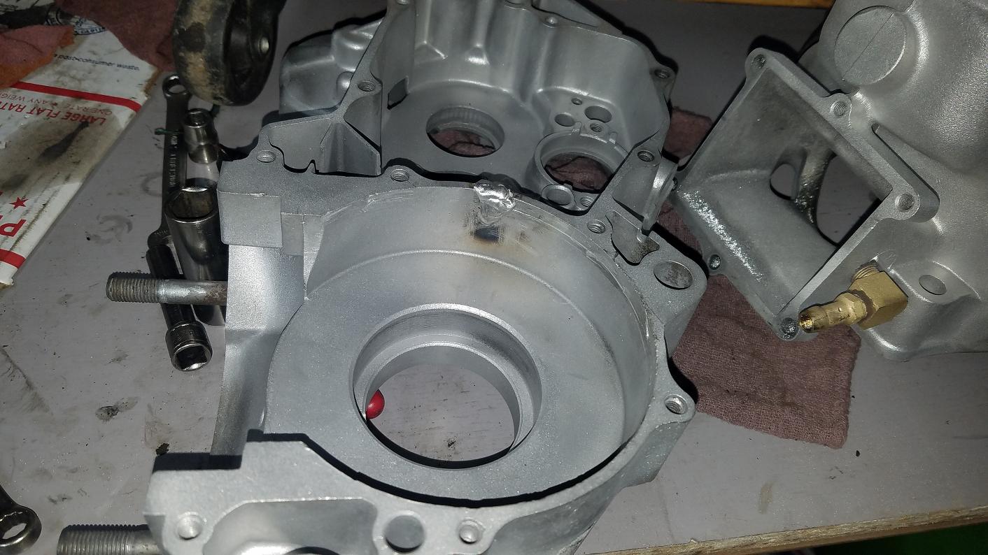

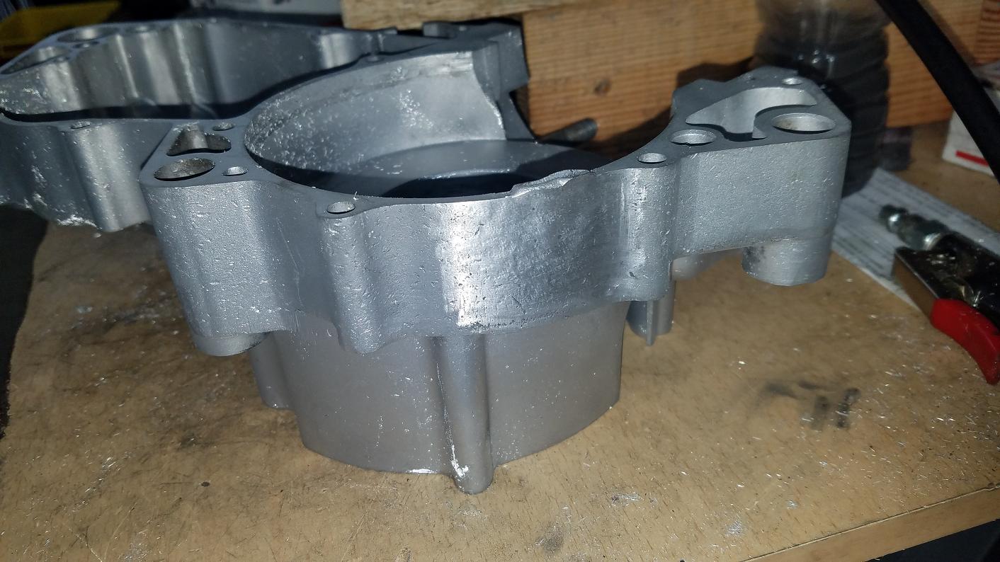

Cases are back from weld...
JT ENGINE WORKS 89 CR500 CART ENGINE BUILD 108.JPG (198.5 KiB) Viewed 11008 times
JT ENGINE WORKS 89 CR500 CART ENGINE BUILD 109.JPG (166.65 KiB) Viewed 11008 times
JT ENGINE WORKS 89 CR500 CART ENGINE BUILD 110.JPG (174.47 KiB) Viewed 11008 times
