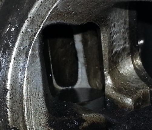

Posted: Thu Jan 21, 2016 10:06 pm
Ok... here is some things to ponder 8-)

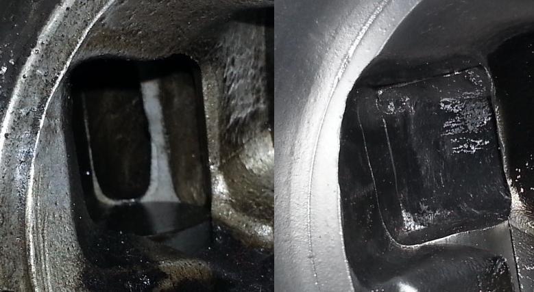

This is your standard KX500 Sub port..
SUB PORT 2.JPG (36.74 KiB) Viewed 10676 times

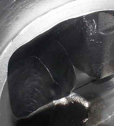

This gives you an idea of what we are doing..
SUB PORT.JPG (18.71 KiB) Viewed 10676 times
Side by side comparison
THIS IS YOUR SUB PORT - THIS IS MINE.JPG (55.19 KiB) Viewed 10676 times
And this is before the final clean up and polish :shock:

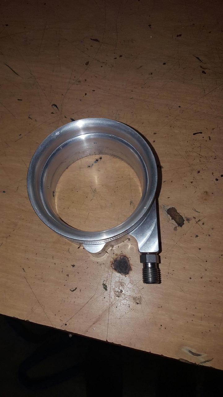

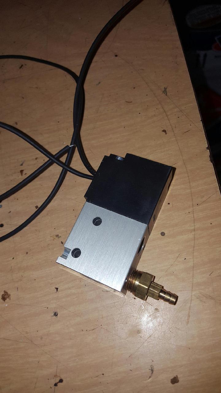

So, Jeff has swapped out his old NOS system for something a bit newer :-)
KXGURU.COM KX500 NOS 1.JPG (231.17 KiB) Viewed 10427 times
KXGURU.COM KX500 NOS 2.JPG (74.55 KiB) Viewed 10427 times
KXGURU.COM KX500 NOS 3.JPG (104.66 KiB) Viewed 10427 times

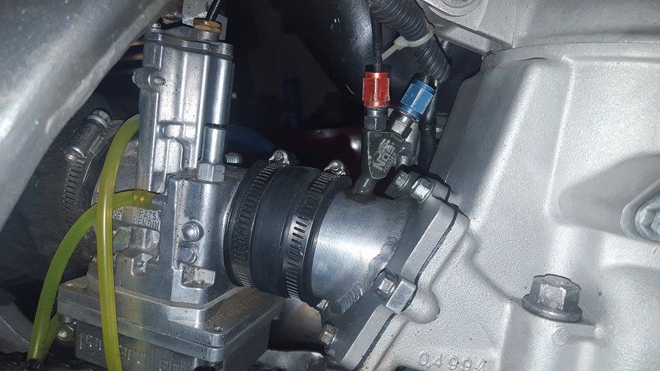

Re: Jeff Grawbarger's KX500 on NOS
Posted: Sat Sep 10, 2016 12:58 am
KXGURU.COM KX500 NOS 4.JPG (149.09 KiB) Viewed 10426 times
KXGURU.COM KX500 NOS 5.JPG (95.15 KiB) Viewed 10426 times
KXGURU.COM KX500 NOS 6.JPG (97.84 KiB) Viewed 10426 times
