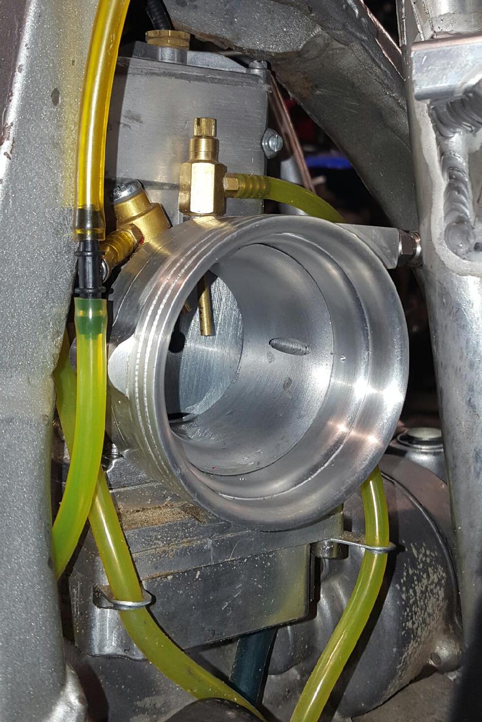

HUGE!!
And his new carb is even bigger :shock:

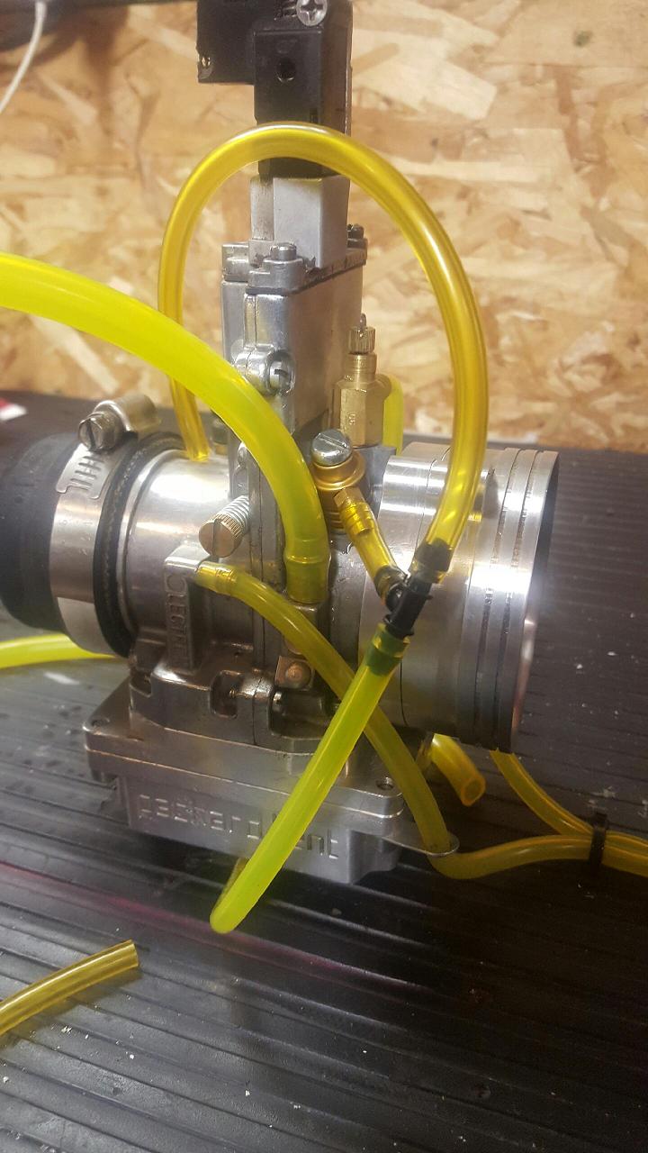

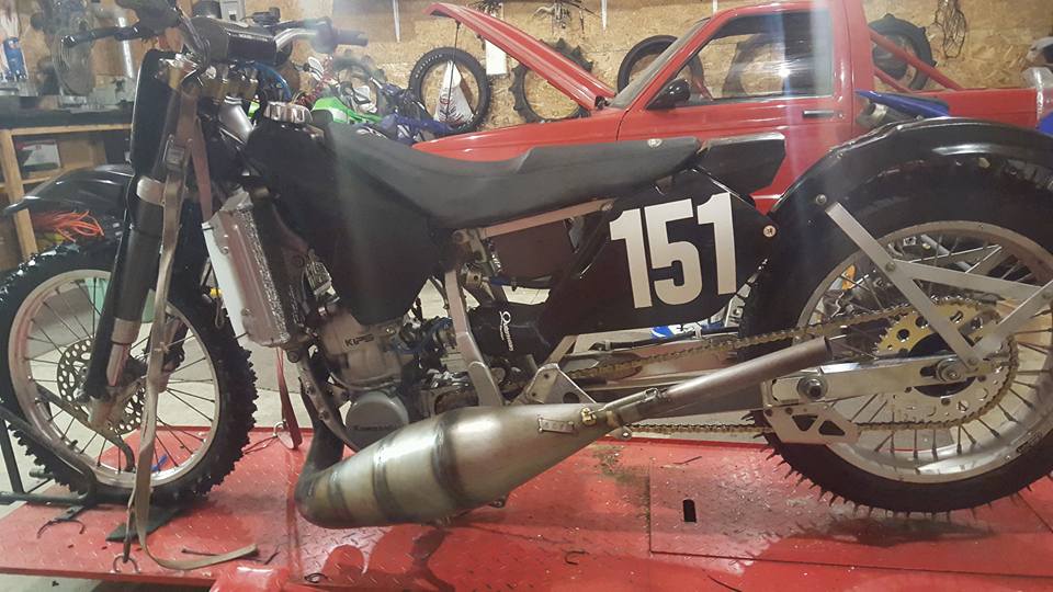

So, Jeff has swapped out his old NOS system for something a bit newer :-)
KXGURU.COM KX500 NOS 1.JPG (231.17 KiB) Viewed 10413 times
KXGURU.COM KX500 NOS 2.JPG (74.55 KiB) Viewed 10413 times
KXGURU.COM KX500 NOS 3.JPG (104.66 KiB) Viewed 10413 times
Re: Jeff Grawbarger's KX500 on NOS
KXGURU.COM KX500 NOS 4.JPG (149.09 KiB) Viewed 10412 times
KXGURU.COM KX500 NOS 5.JPG (95.15 KiB) Viewed 10412 times
KXGURU.COM KX500 NOS 6.JPG (97.84 KiB) Viewed 10412 times
