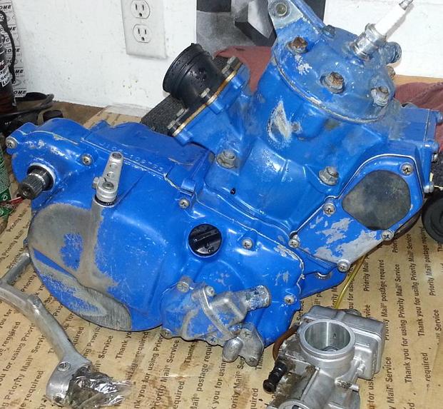

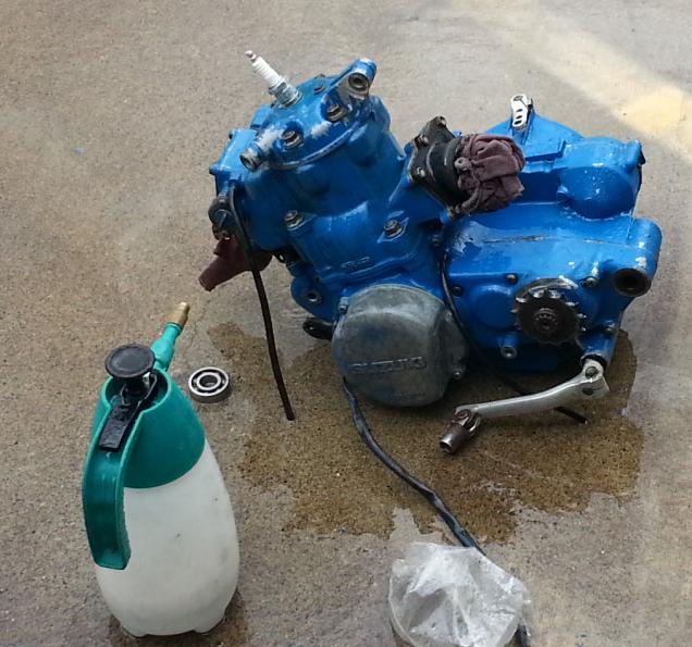

We just received a 1988 RM250 that we are going to most likely do a full rebuild on.
First things first, let's give it a good washing before disassembly.
OEM-CYCLE.COM 1988 RM250 ENGINE REBUILD 101.JPG (65.58 KiB) Viewed 10737 times
There is nothing worse then dropping dirt, sand, grease, and grim into a motor.
Regardless if we are going to clean it all up later, we want to keep it as nice as possible...
Who knows, at this point, it may not be worth rebuilding... :o
Here is what we are starting with..
OEM-CYCLE.COM 1988 RM250 ENGINE REBUILD 102.JPG (78.91 KiB) Viewed 10737 times
At first glance it does not look too bad..

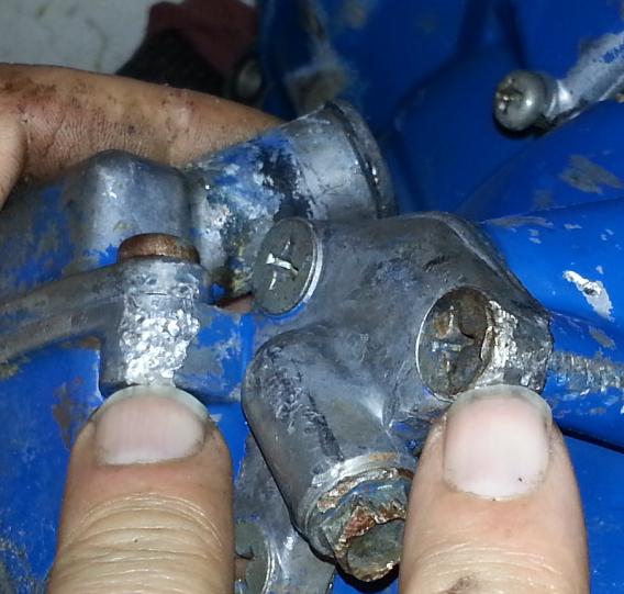

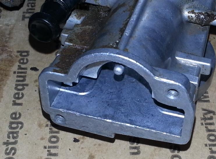

Broken right side exhaust valve cover
OEM-CYCLE.COM 1988 RM250 ENGINE REBUILD 104.JPG (51.42 KiB) Viewed 10737 times

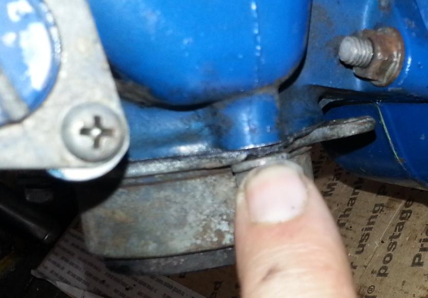

Broken exhaust flange
OEM-CYCLE.COM 1988 RM250 ENGINE REBUILD 105.JPG (46.81 KiB) Viewed 10736 times

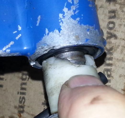

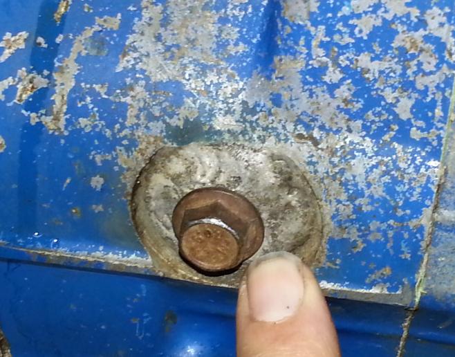

The drain plug has been repaired.
Externally it looks good but we won't know until we get it apart and inspect it.

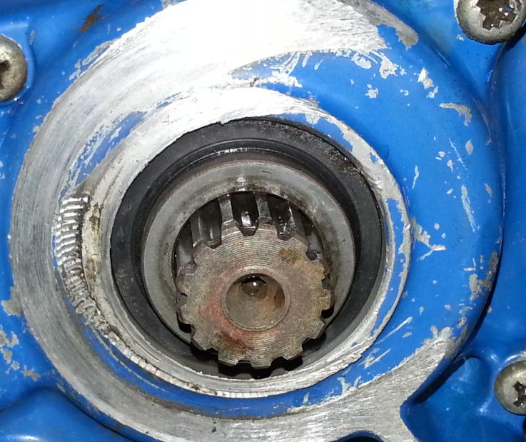

And heavy wear around the engine case..
OEM-CYCLE.COM 1988 RM250 ENGINE REBUILD 109.JPG (81.81 KiB) Viewed 10736 times
Yes, it is repairable but it may be cheaper to get a new case...

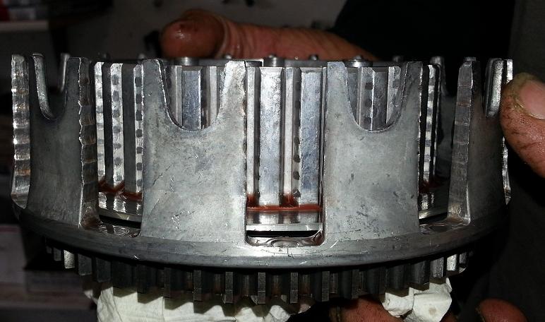

Posted: Wed Sep 16, 2015 10:30 pm
Clutch basket is REALLY worn..

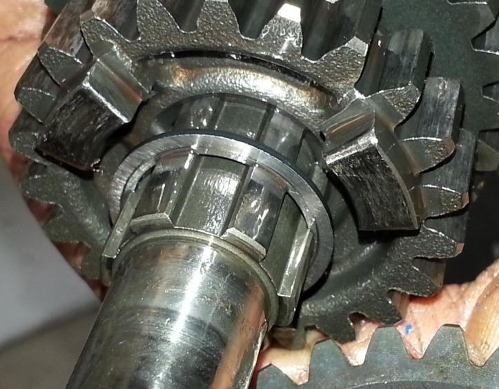

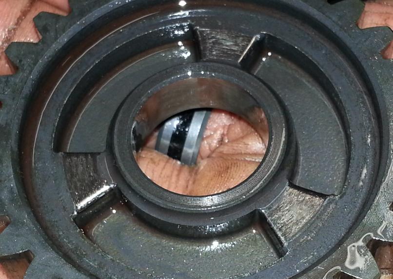

Posted: Wed Sep 16, 2015 11:16 pm
AH HA!
Found the transmission problem...
Rounded dog ears..
The big question is, can we find replacements that are better?
OEM-CYCLE.COM 1988 RM250 ENGINE REBUILD 115.JPG (74.29 KiB) Viewed 10733 times
OEM-CYCLE.COM 1988 RM250 ENGINE REBUILD 116.JPG (71.31 KiB) Viewed 10733 times

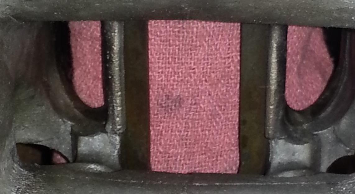

Posted: Mon Oct 19, 2015 11:46 pm
Cylinder issues....
Look at the sleeve.... and cracks in the bridges.
OEM-CYCLE.COM 1988 RM250 ENGINE REBUILD 117.JPG (69.69 KiB) Viewed 10711 times
OEM-CYCLE.COM 1988 RM250 ENGINE REBUILD 118.JPG (84.25 KiB) Viewed 10711 times

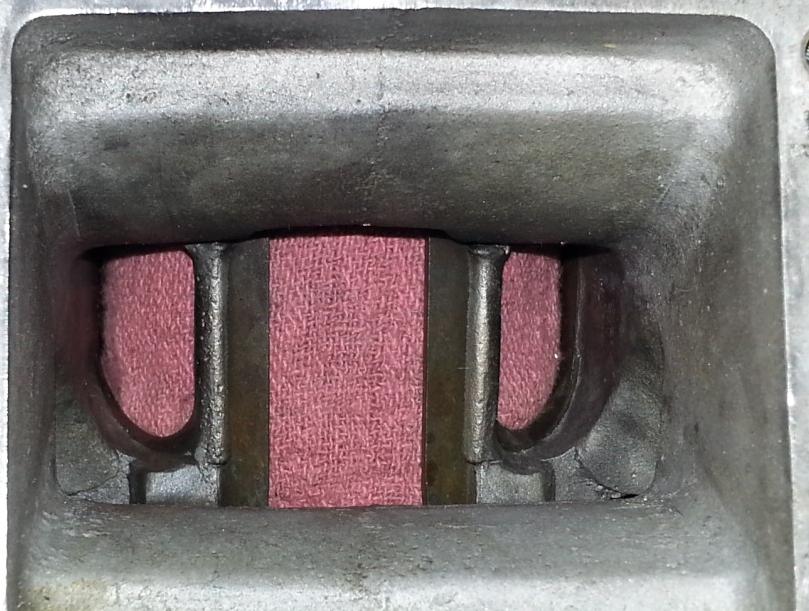

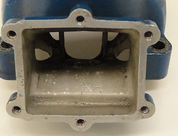

Posted: Mon Oct 19, 2015 11:49 pm
It should look more like this:
OEM-CYCLE.COM 1988 RM250 ENGINE REBUILD 119.JPG (34.97 KiB) Viewed 10711 times
Posted: Mon Oct 19, 2015 11:52 pm
And when we are done it will be better 8-)

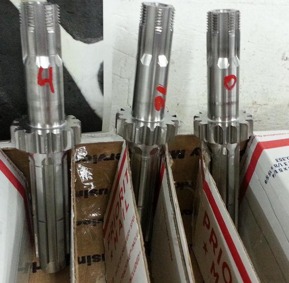

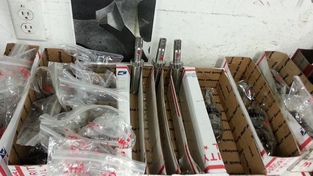

Posted: Thu Oct 22, 2015 9:20 pm
We have parts from 4 different engines to help us in getting the best parts available.
Keeping things organized becomes a priority...
OEM-CYCLE.COM 1988 RM250 ENGINE REBUILD 120.JPG (134.4 KiB) Viewed 10707 times
And how can you decide which part to use unless you have clean parts to inspect?
OEM-CYCLE.COM 1988 RM250 ENGINE REBUILD 121.JPG (53.54 KiB) Viewed 10707 times
I think Jason is OCD sometimes :o :lol:
