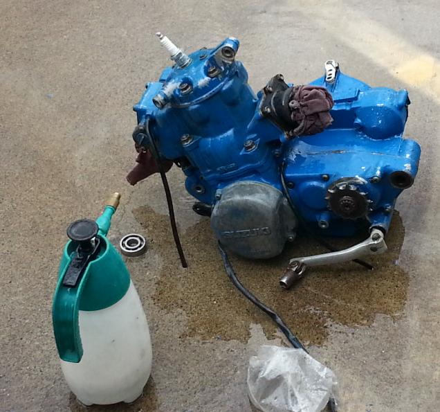

We just received a 1988 RM250 that we are going to most likely do a full rebuild on.
First things first, let's give it a good washing before disassembly.

Here is what we are starting with..
OEM-CYCLE.COM 1988 RM250 ENGINE REBUILD 102.JPG (78.91 KiB) Viewed 10749 times
At first glance it does not look too bad..

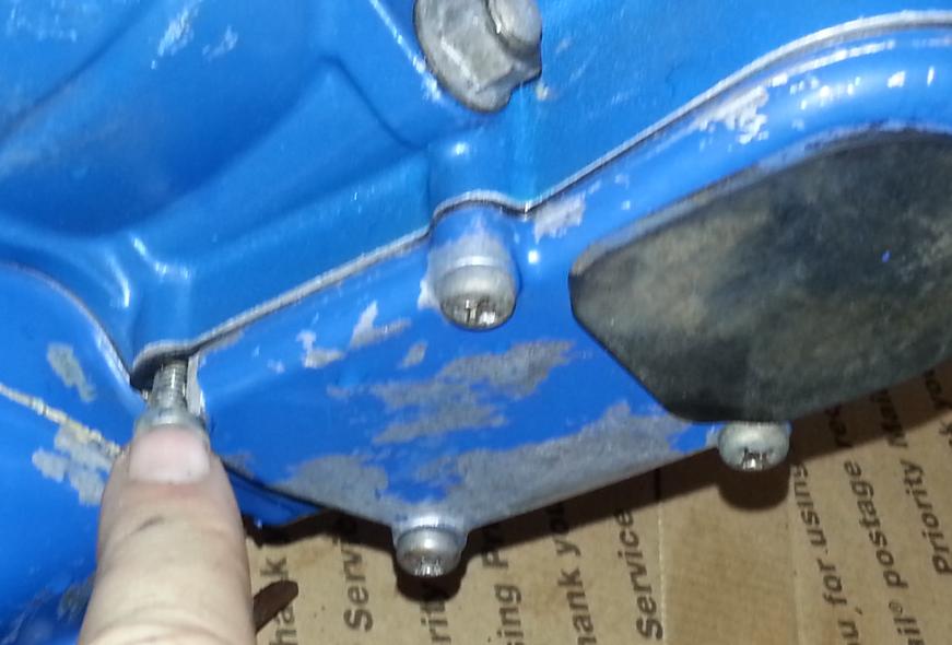

Broken right side exhaust valve cover
OEM-CYCLE.COM 1988 RM250 ENGINE REBUILD 104.JPG (51.42 KiB) Viewed 10749 times

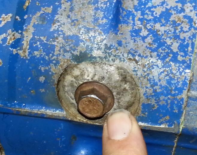

The drain plug has been repaired.
Externally it looks good but we won't know until we get it apart and inspect it.

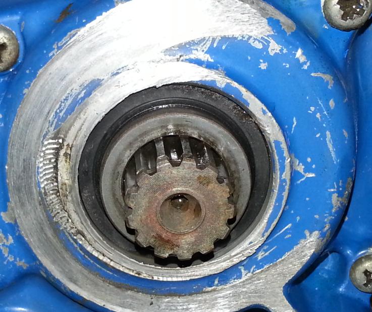

And heavy wear around the engine case..
OEM-CYCLE.COM 1988 RM250 ENGINE REBUILD 109.JPG (81.81 KiB) Viewed 10748 times

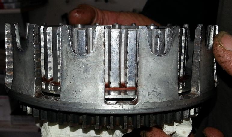

Clutch basket is REALLY worn..

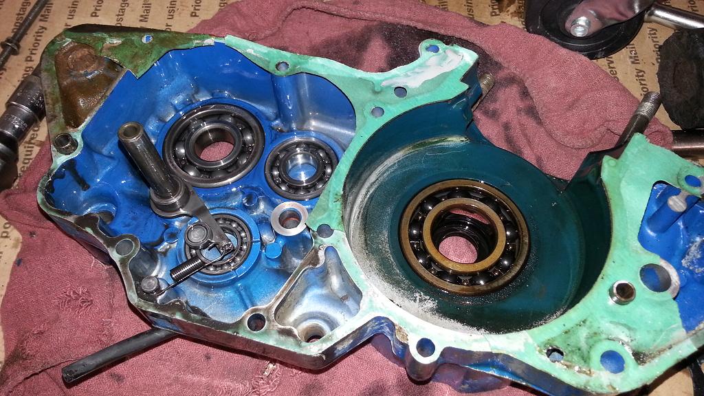

More disassembly..

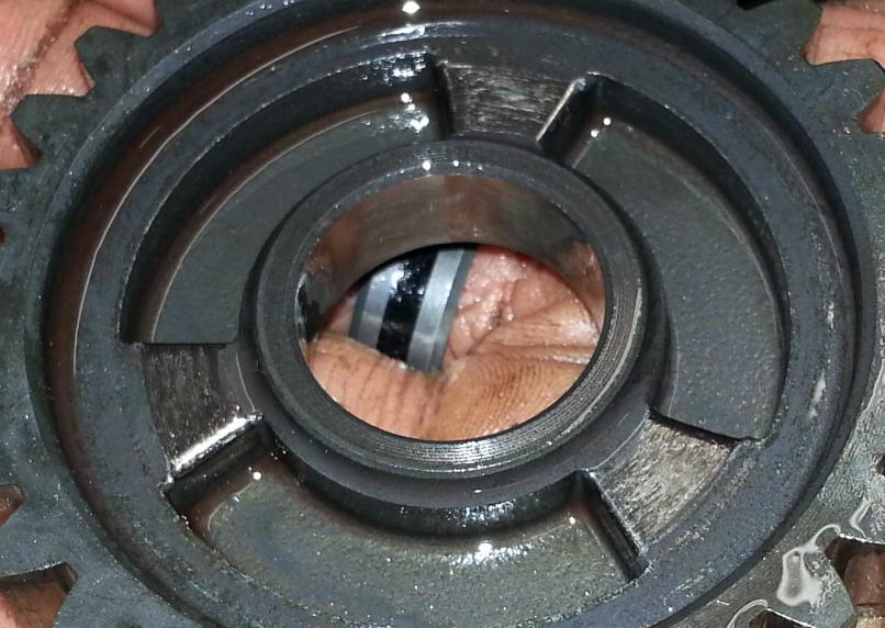

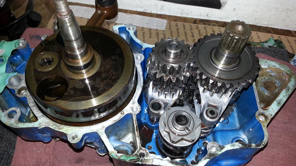

AH HA!
Found the transmission problem...
Rounded dog ears..
The big question is, can we find replacements that are better?

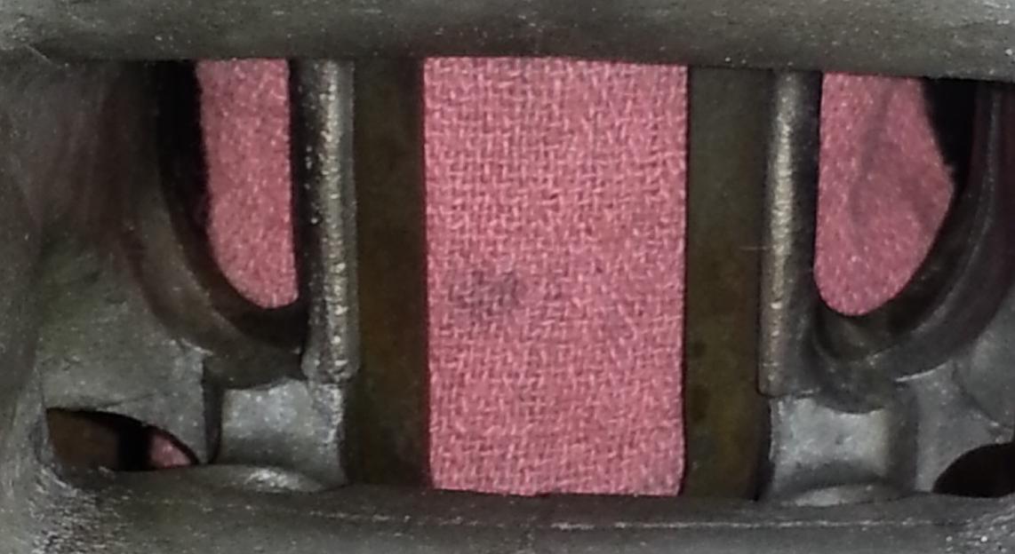

Cylinder issues....
Look at the sleeve.... and cracks in the bridges.

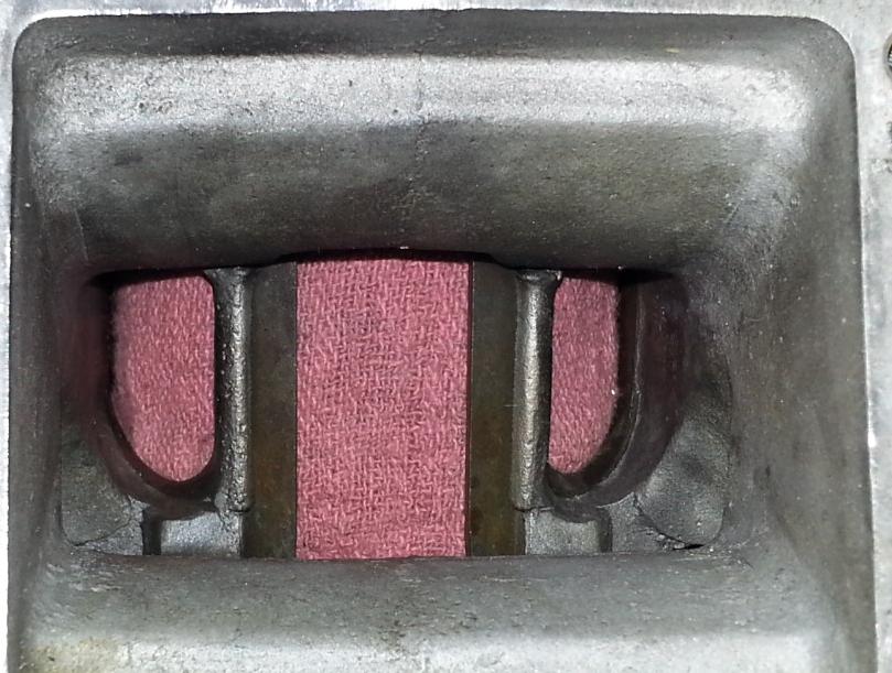

It should look more like this:

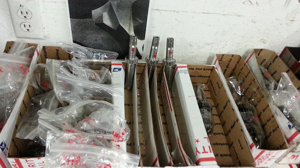

We have parts from 4 different engines to help us in getting the best parts available.
Keeping things organized becomes a priority...

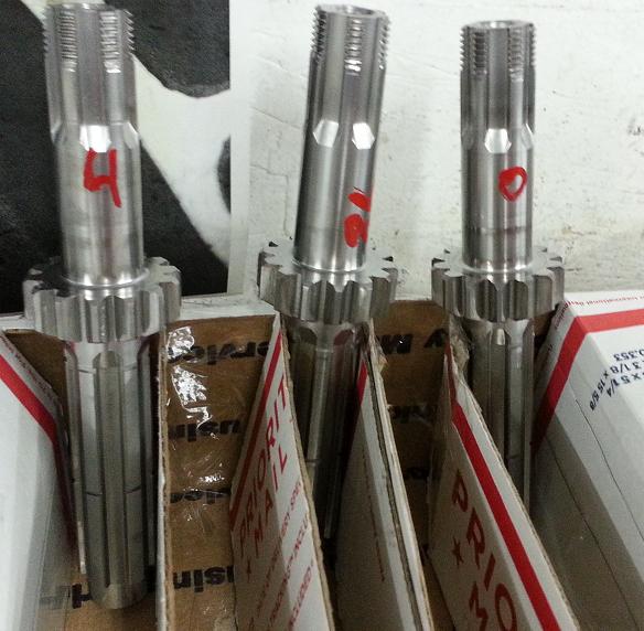

And how can you decide which part to use unless you have clean parts to inspect?
OEM-CYCLE.COM 1988 RM250 ENGINE REBUILD 121.JPG (53.54 KiB) Viewed 10719 times
I think Jason is OCD sometimes :o :lol:
