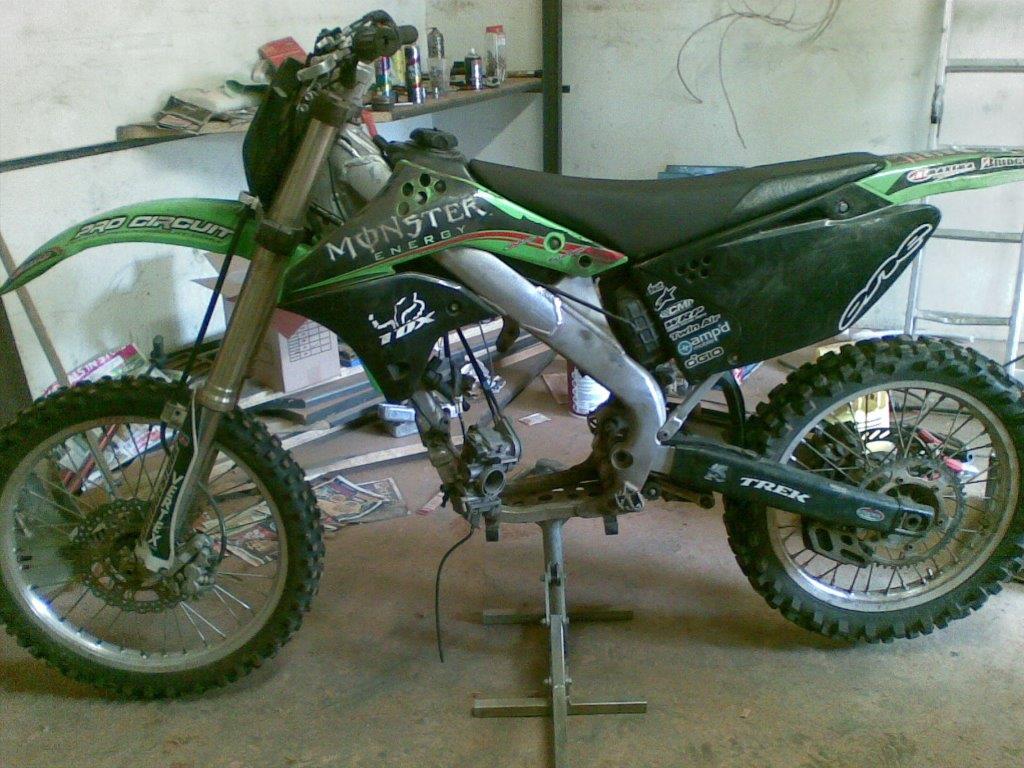

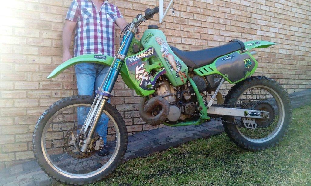

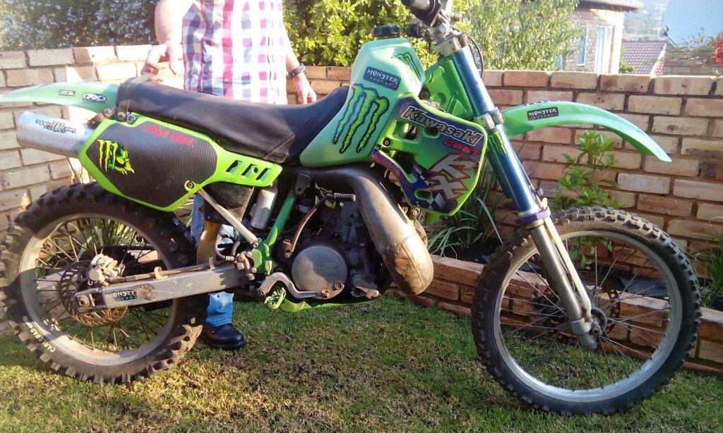

Hi there,
Thanks for giving me access to this mass overload info site on kx500's, glad to be a part of it. I am from South Africa and I am going to attempt building a kx500af.
I have bought a KX500 that needs lots of love and a kx250f with a busted motor.
I have started stripping my 500 motor and found a few issues already. damaged piston. it has excessive piston and cylinder wear at the outlet side. the cooling system is filled with orange gunk and the clutch is completely shot.
so I definitely need a top end overhaul. My question is: while the motor is open, what all needs to be replaced? I will check the clearance measurements on the crank with a feeler gauge set to check the spec. but what is all best to replace without splitting the motor?
Last week by chance I came across a 1996 KX500 and the following day I stumbled on a 2007 KX250F that has motor damage. Surely this must be fate and the universe telling me that I should build it.
So I drove and picked up the bikes. My wife is not very impressed. She says I have enough toys... Really? can one really have too many toys?
Just the fact that I found a KX500 is amazing. They are seriously scarce nowadays, in South Africa that is.
So this is what I have started out with..

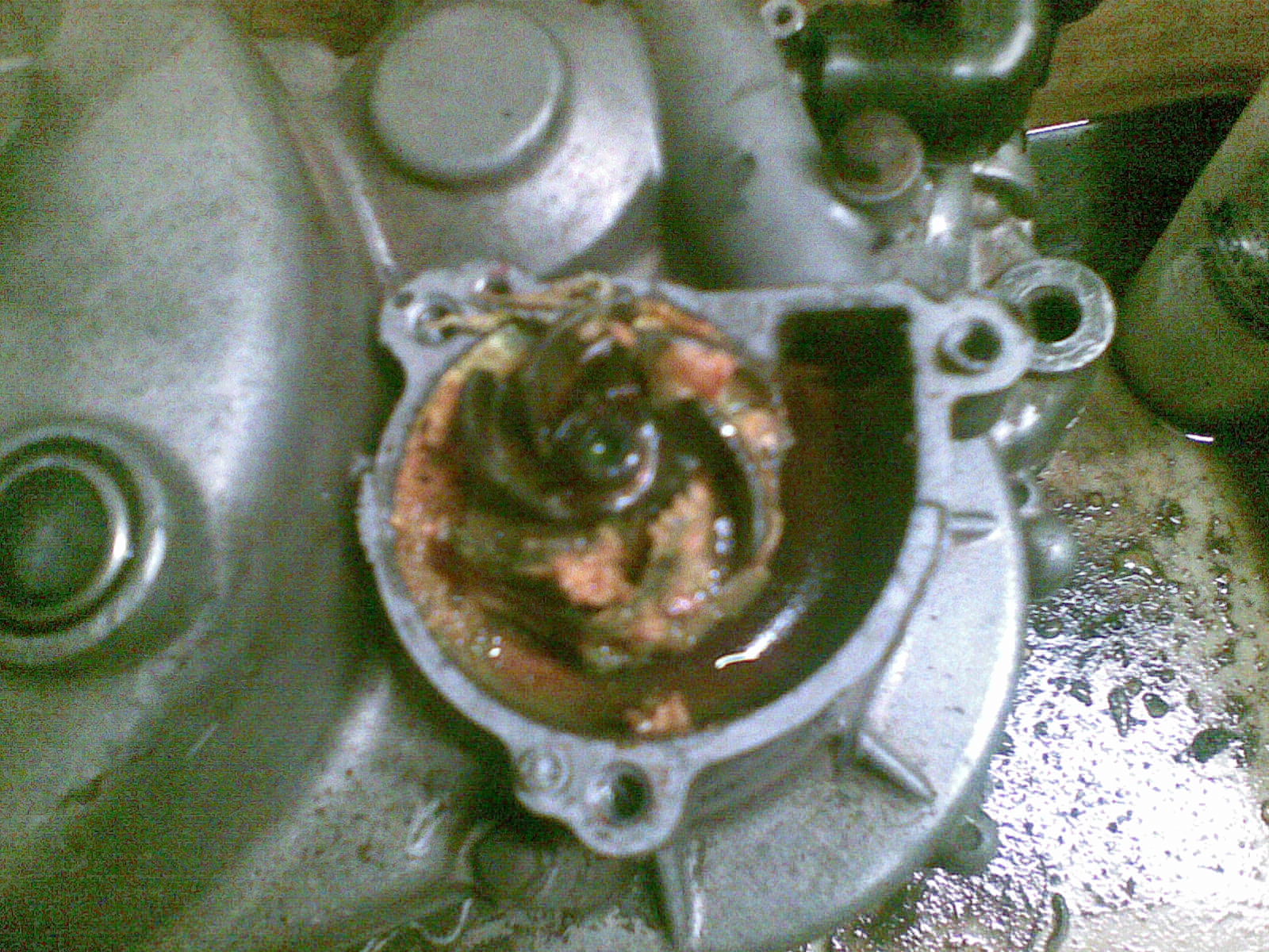

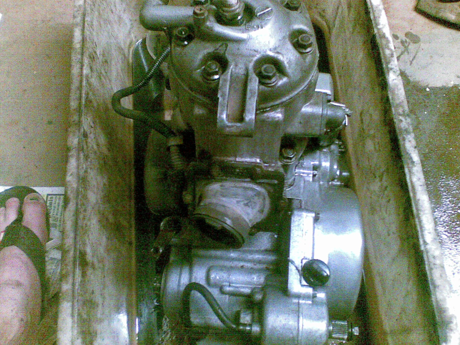

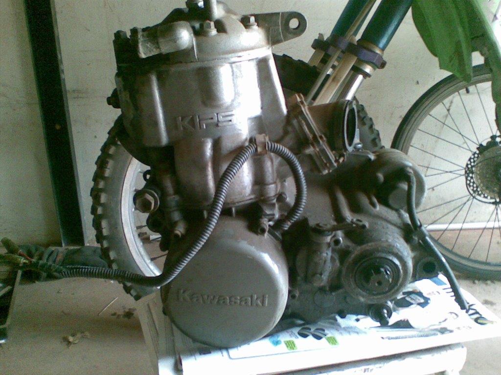

I have cleaned up the KX motor and started stripping it to see what needs to be done.
Problems found so far:
1. Power valve incorrectly connected
2. Piston heavily worn on outlet side
3. Sleeve word on outlet side
3. Clutch plates are missing a lot of small pieces
4. Cooling system is filled with a lot of orange gunk

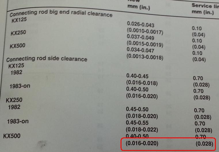

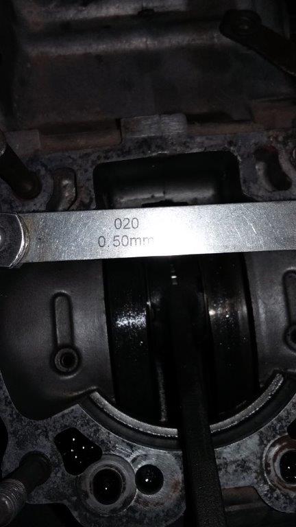

Got the clutch Hub off by heating the nut thanks.
Here are some more pictures.
I have measured the crank and all is within spec. When I rotate the crank it moves with slight resistance and there are no rough spots or any noises.My crank measured 0.020 which is still within new spec.

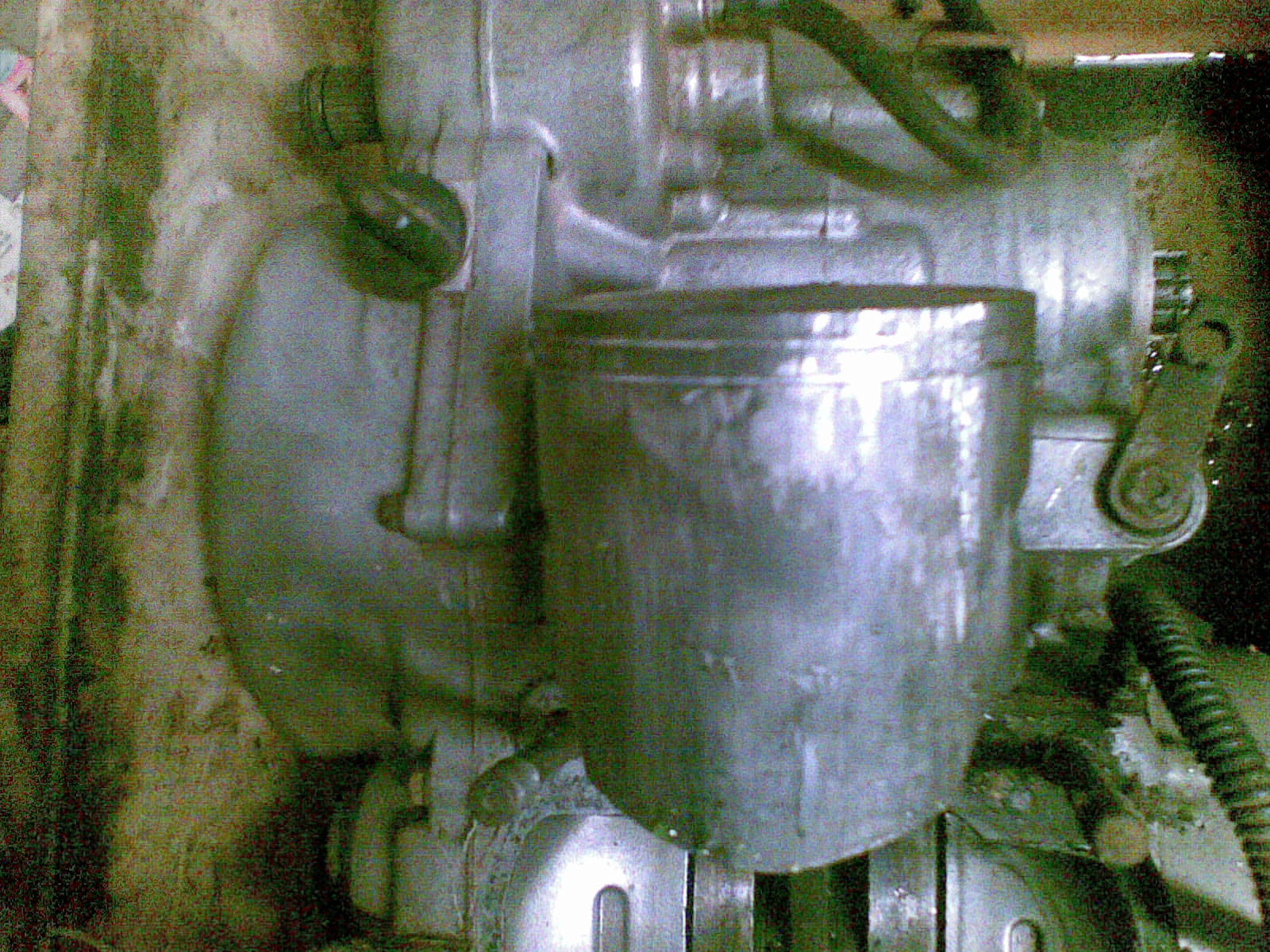

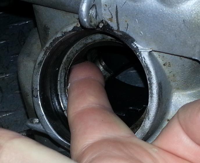

Here are some close up pictures of my piston and cylinder. It actually looks like there is a piece of the piston stuck to the cylinder wall.
Here is also a picture of one of the clutch plates and a couple of them look like this.

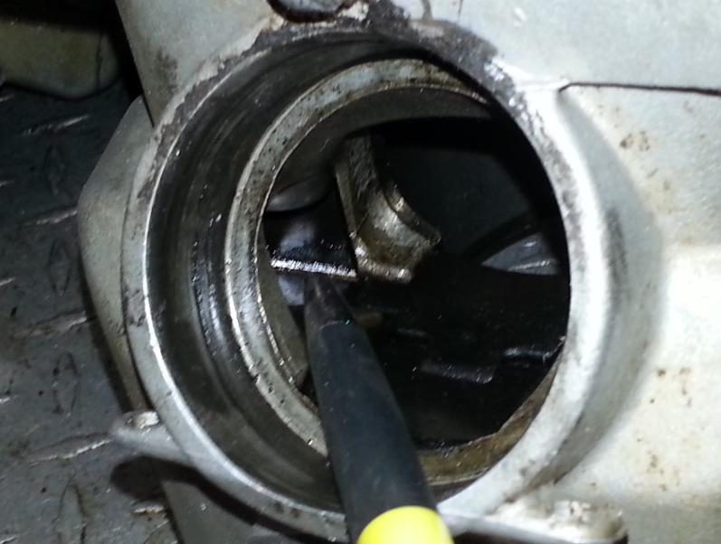

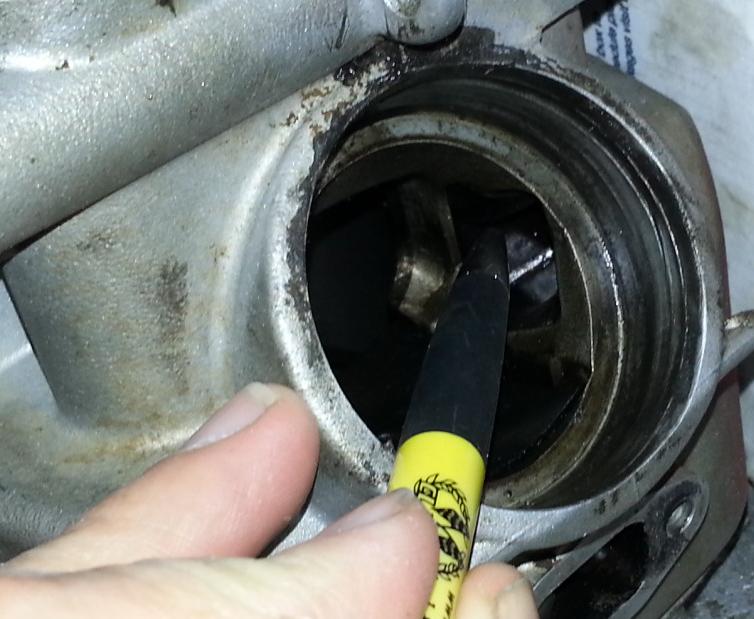

My Cylinder needs to go in for Nikasil plating. So I need to remove everything from the cylinder.
I am battling to remove the KIPS system.
I am following the manual but the idle gear moves slightly up and down but does not pull out. Not sure if I am missing something?
Re: KX500 AF Build
Posted: Tue Sep 15, 2015 4:08 pm
Sorry for the delayed answer, my lap top bit the big one and I've been stuck with no internet access at home so I got to work early to get this done.
The Kips valves often get very sticky.
You need to get some penetrating oil and really soak them through the exhaust port.
Here:

After soaking try to move the valve a little up and down:
OEM-CYCLE.COM STICKY EXHAUST VALVE REMOVAL 103.JPG (44.84 KiB) Viewed 10288 times
