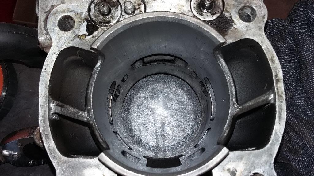

I have started stripping my 500 motor and found a few issues already. damaged piston. it has excessive piston and cylinder wear at the outlet side. the cooling system is filled with orange gunk and the clutch is completely shot.

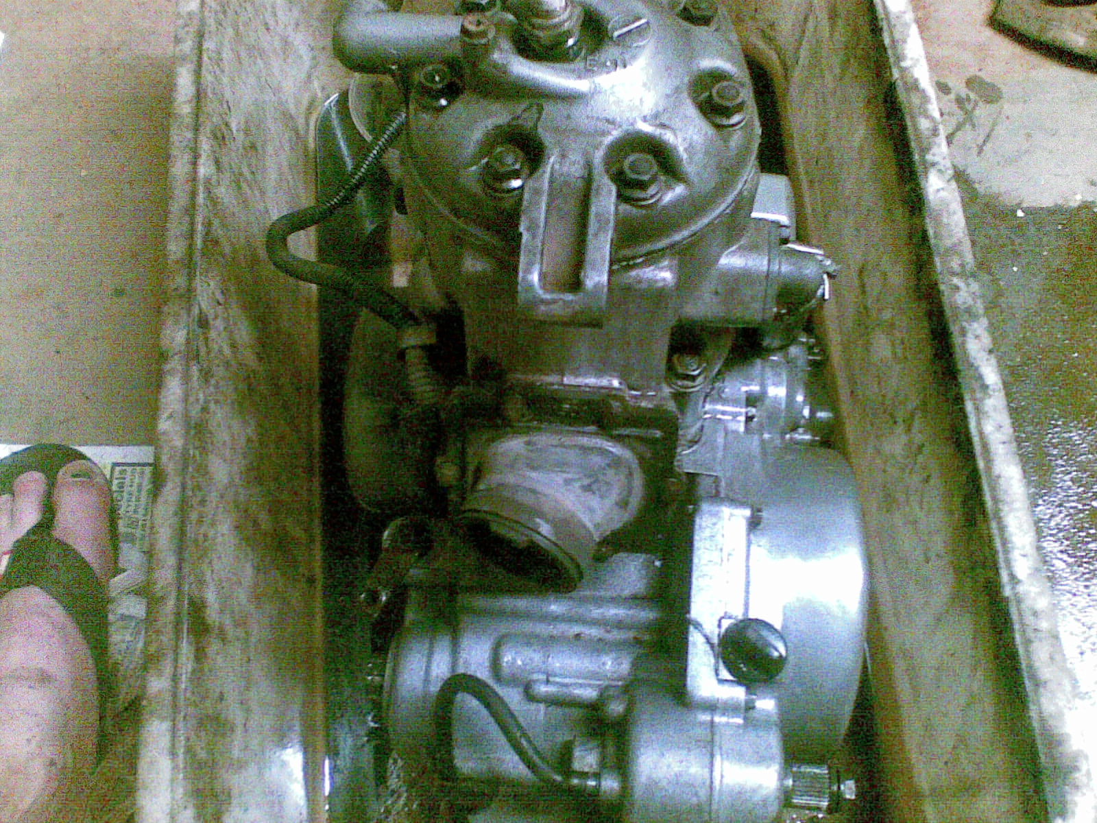

So this is what I have started out with..

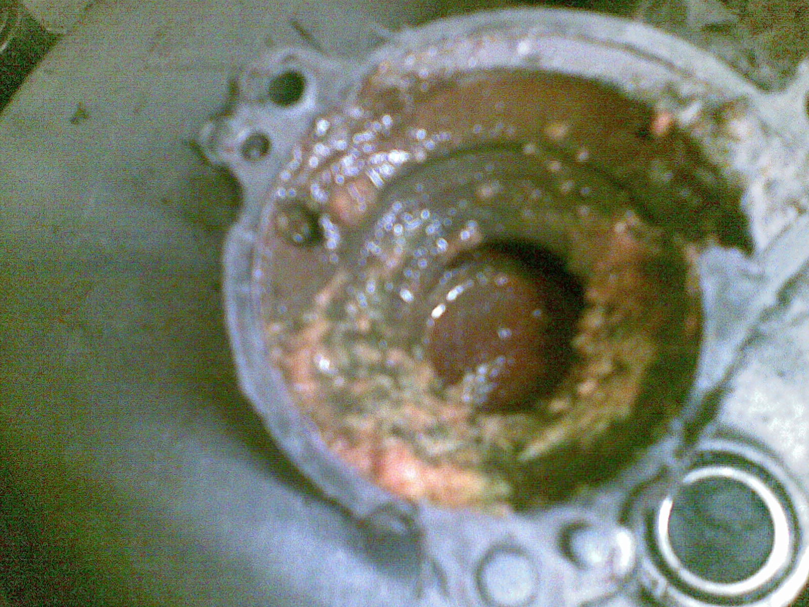

I have cleaned up the KX motor and started stripping it to see what needs to be done.
Problems found so far:
1. Power valve incorrectly connected
2. Piston heavily worn on outlet side
3. Sleeve word on outlet side

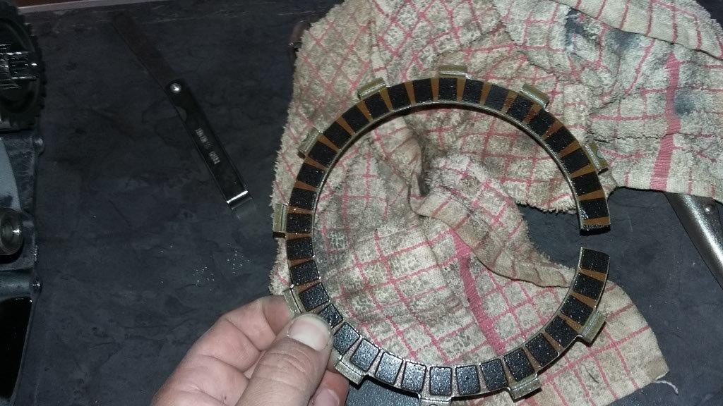

3. Clutch plates are missing a lot of small pieces
4. Cooling system is filled with a lot of orange gunk

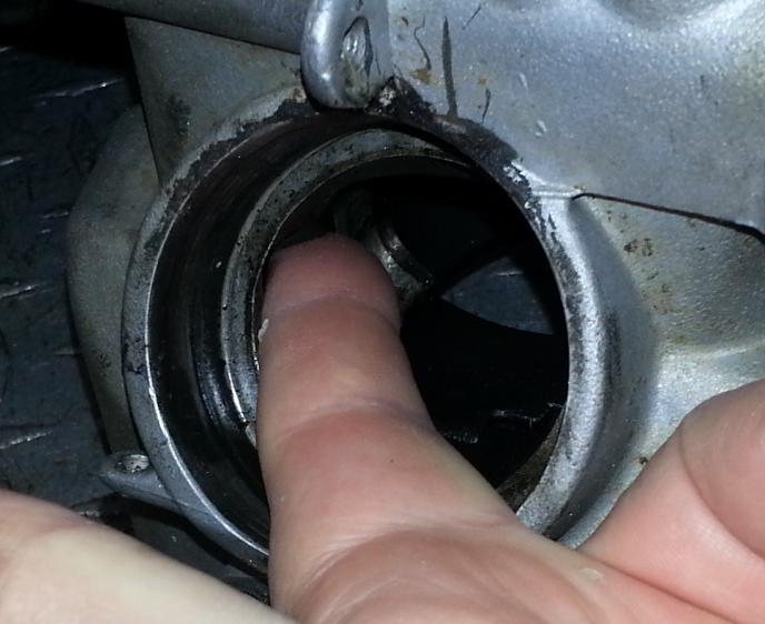

Re: KX500 AF Build
Look at the inside of your clutch cover close to the window.
Typically they are cracked.
Now would be a good time to repair it.
Also, look at your cylinder carefully.... you want to inspect around the tops and bottoms of the intake bridges as well as the exhaust ports.
There is where you will find the majority of cracks.

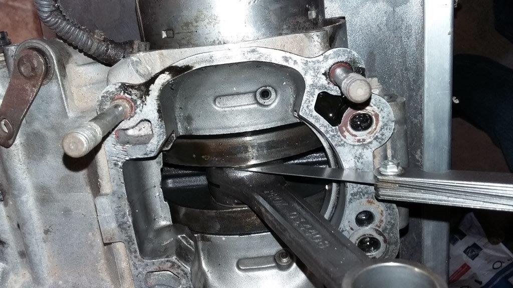

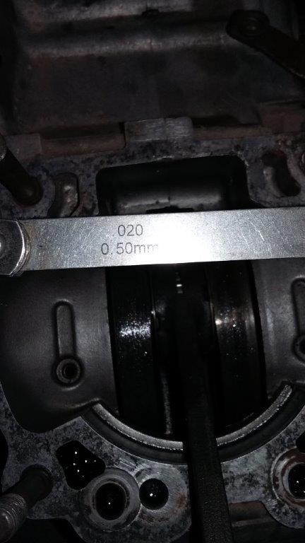

Got the clutch Hub off by heating the nut thanks.
Here are some more pictures.
I have measured the crank and all is within spec. When I rotate the crank it moves with slight resistance and there are no rough spots or any noises.My crank measured 0.020 which is still within new spec.

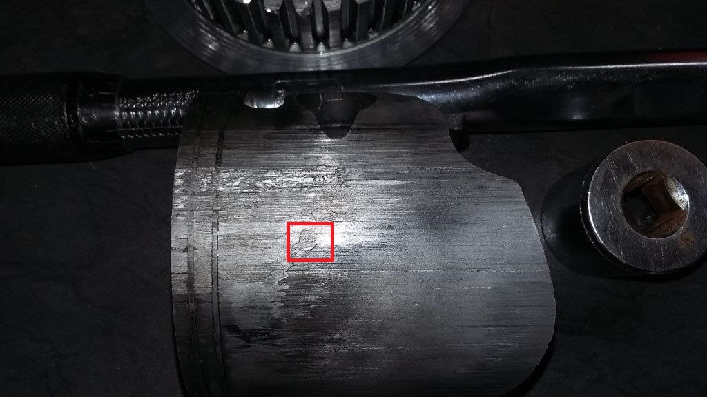

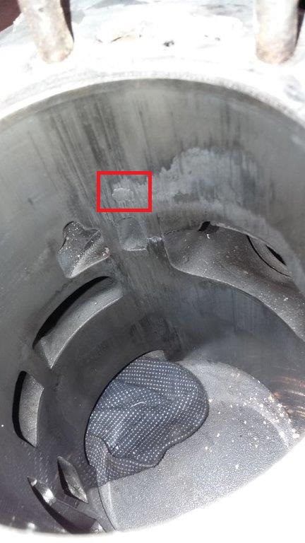

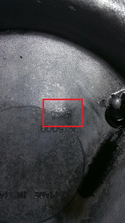

Here are some close up pictures of my piston and cylinder. It actually looks like there is a piece of the piston stuck to the cylinder wall.
Here is also a picture of one of the clutch plates and a couple of them look like this.

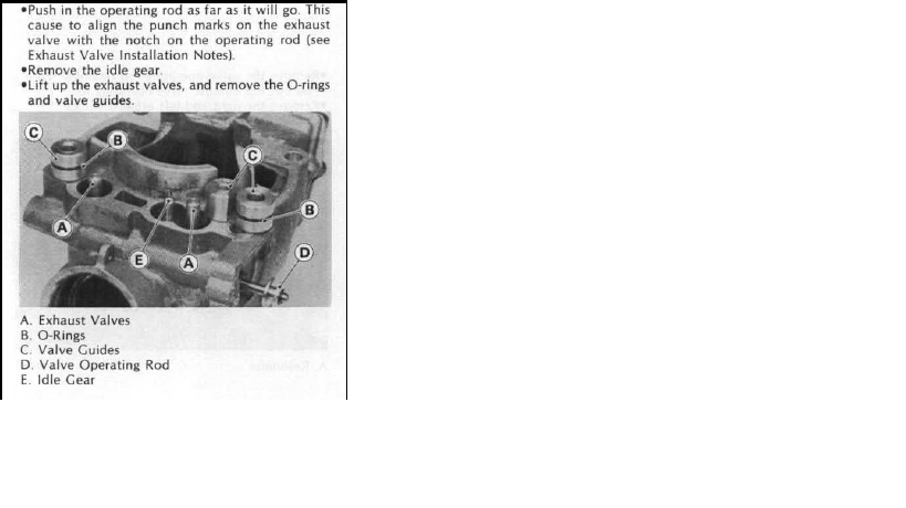

My Cylinder needs to go in for Nikasil plating. So I need to remove everything from the cylinder.
I am battling to remove the KIPS system.
I am following the manual but the idle gear moves slightly up and down but does not pull out. Not sure if I am missing something?

Re: KX500 AF Build
Sorry for the delayed answer, my lap top bit the big one and I've been stuck with no internet access at home so I got to work early to get this done.
The Kips valves often get very sticky.
You need to get some penetrating oil and really soak them through the exhaust port.
Here:
Here:
After soaking try to move the valve a little up and down:
Here:
Here:
