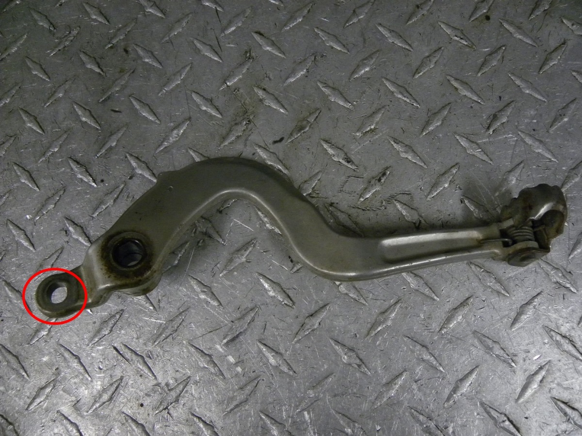

I have 6 KX500 rear brake levers in inventory.
Every one of them has the same issue.
2000 kx500 kawasaki rear brake lever mod oem-cycle.com 101.JPG (400.43 KiB) Viewed 11343 times
The attachment point for the master cylinder gets wallered out and make for a sloppy rear brake :shock:
I'm gonna fix mine once and for all...

Fixed!

To fix it I drilled out the existing hole to make it round again.
Then I cleaned it extremely good.
Next, my welder filled in the hole and added a bit of material around the outside edge where the bearing is as it would be a little too small for the bearing to fit.
Then I drilled a 16mm hole for the bearing.
Slipped the bearing in with a bit of bearing retainer.
DONE!
Oh! Bearing size:
16mm OD x 8mm ID x 5mm wide
Next I need to give it a good ride and see how it holds up.
